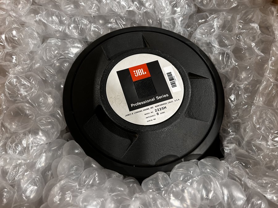

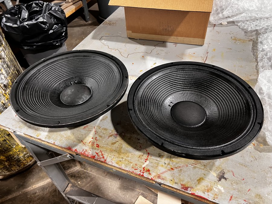

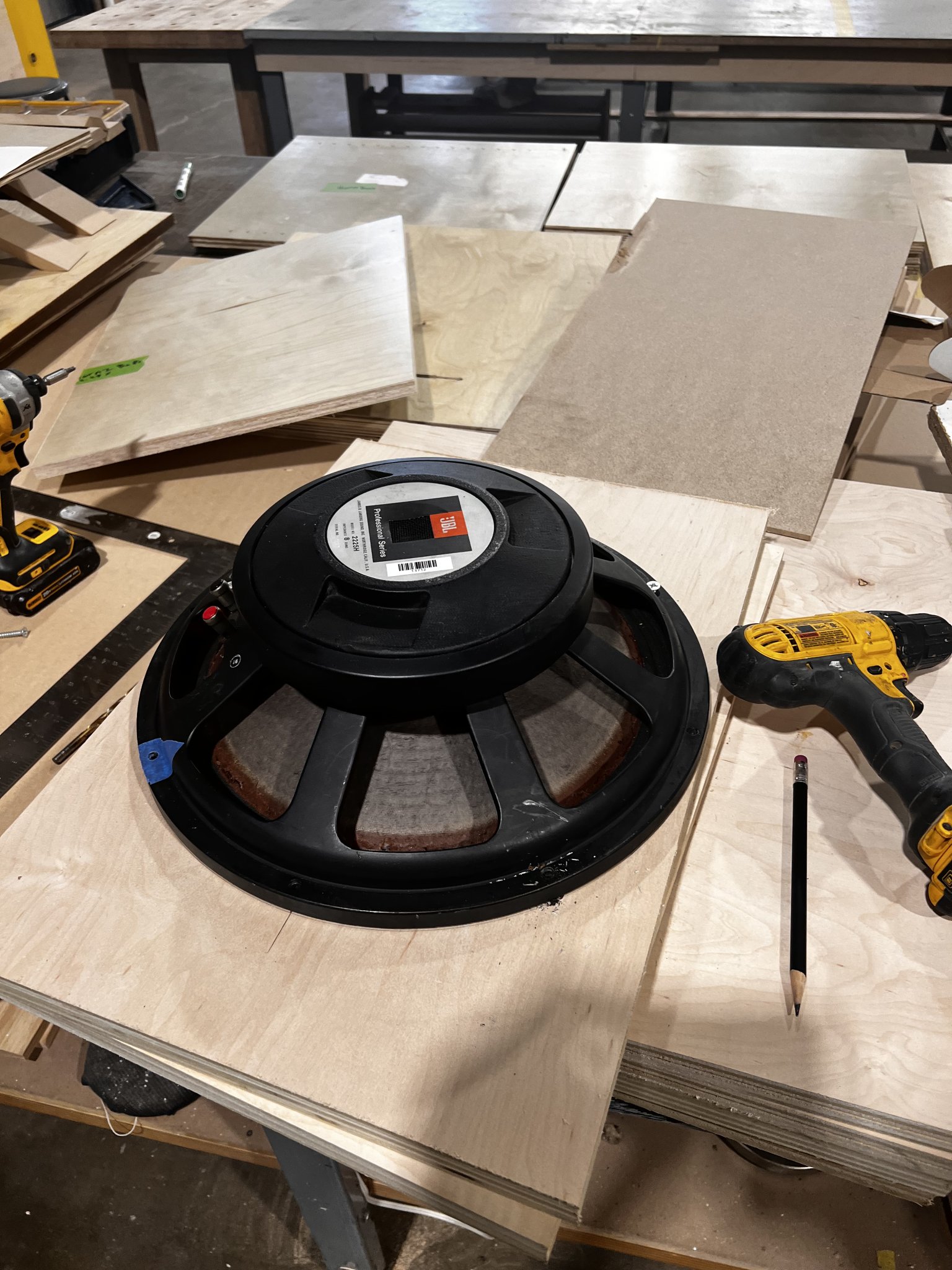

the build will be using the following drivers:
Bass will havre a pair of JBL 2225H:

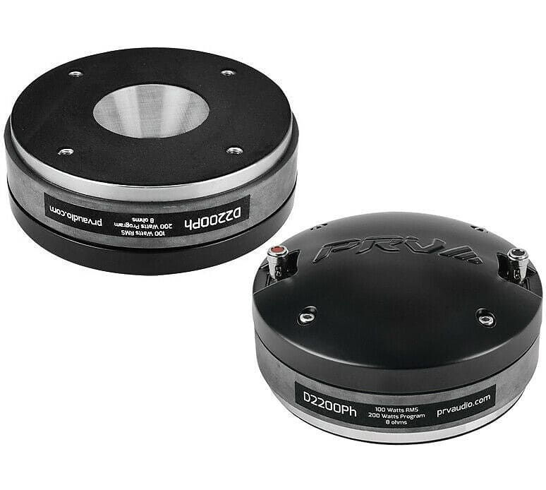

Mids will feature the vaunted and much ballyhoo'd combination of the PRV Audio D-2200PH and PRV Audio's iteration of the 18 x 10 horn, their WG 45-50:

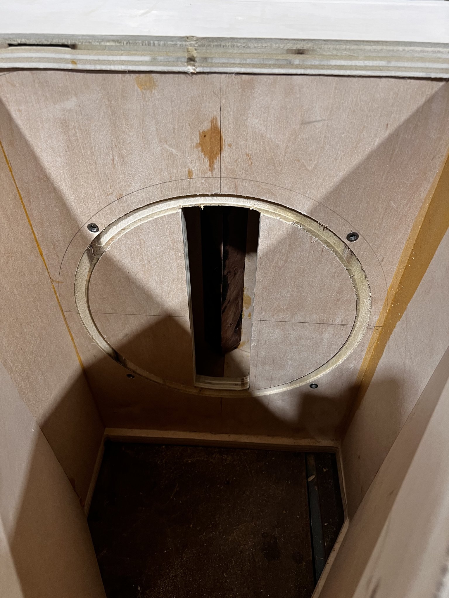

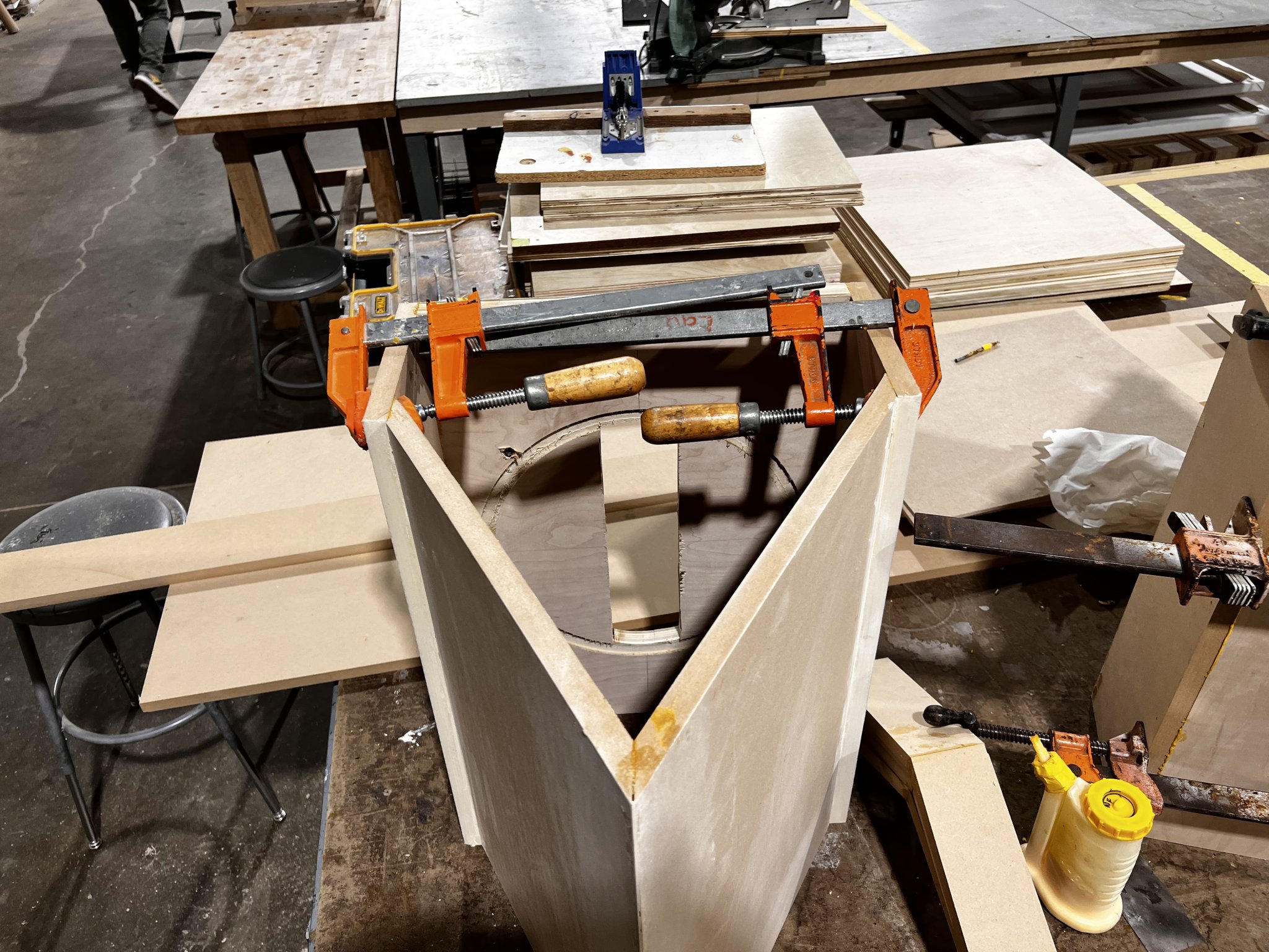

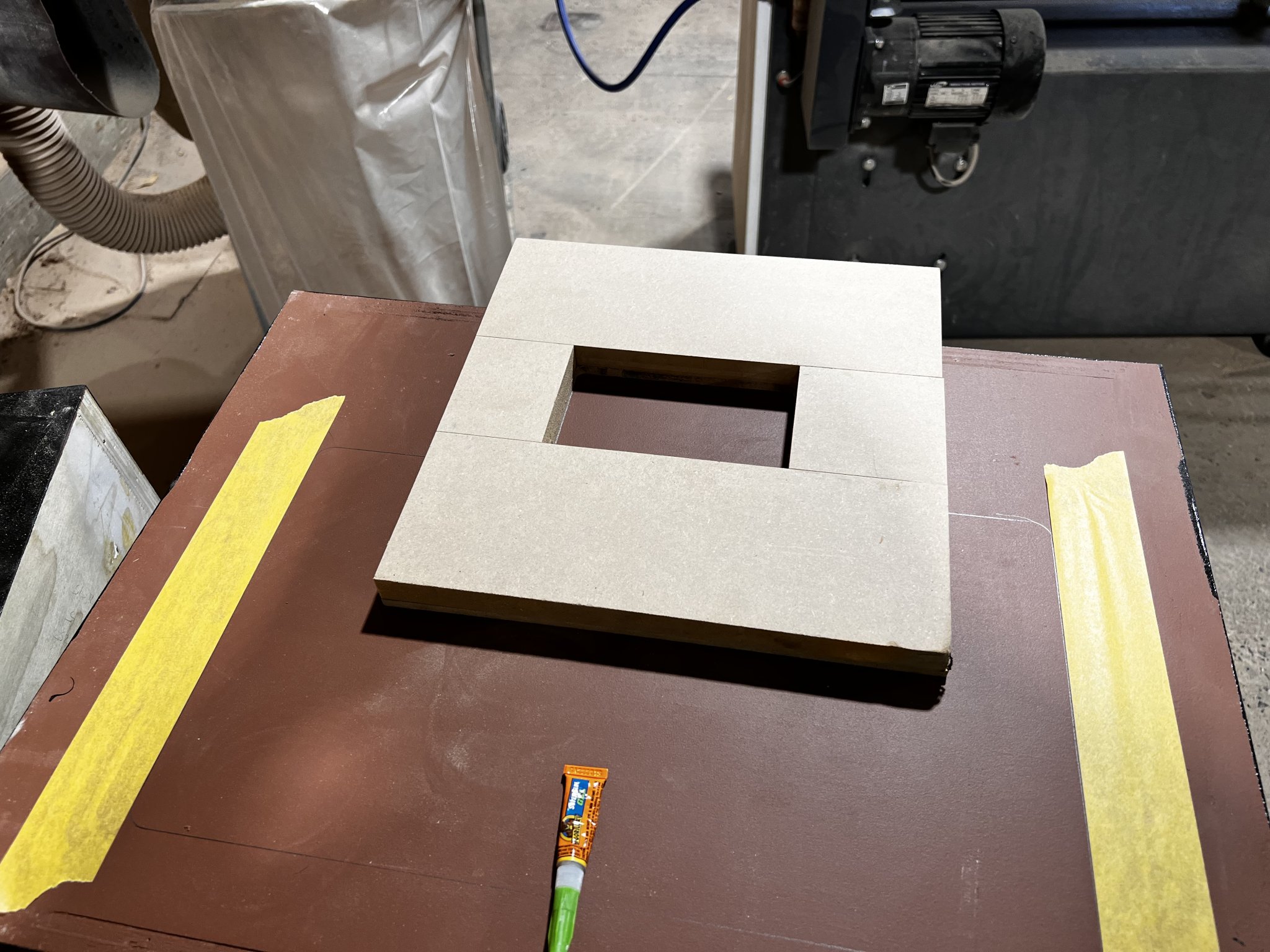

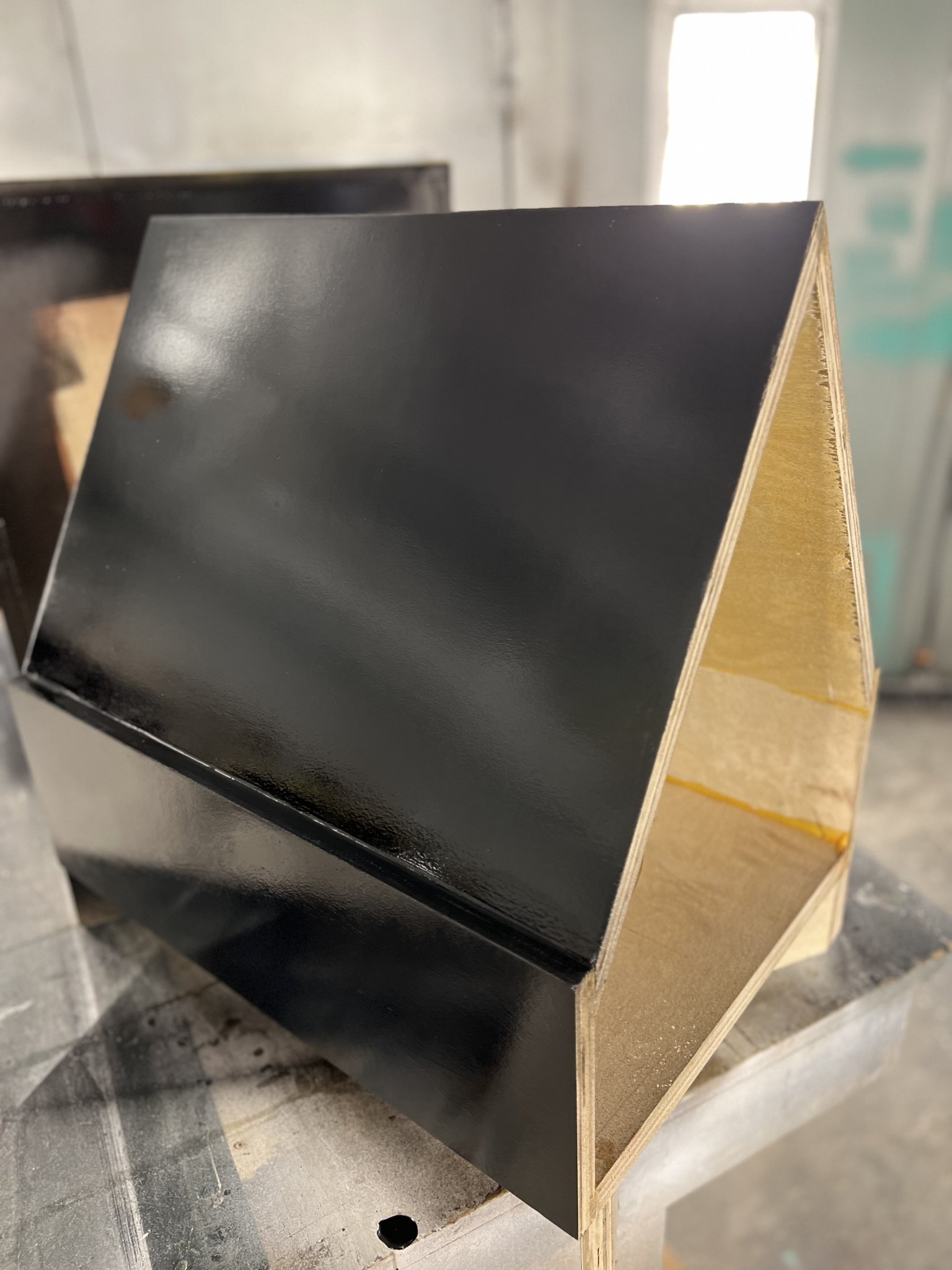

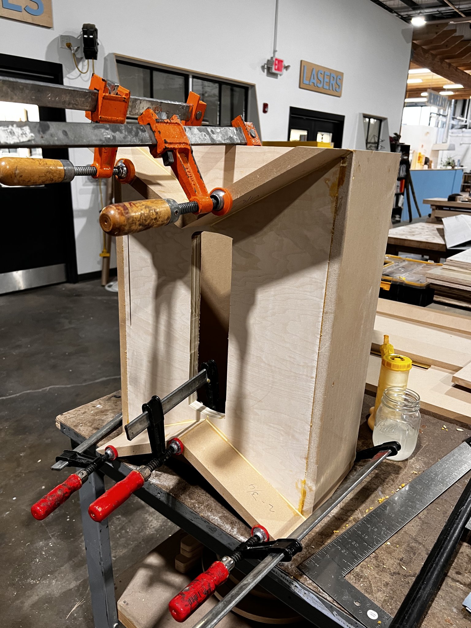

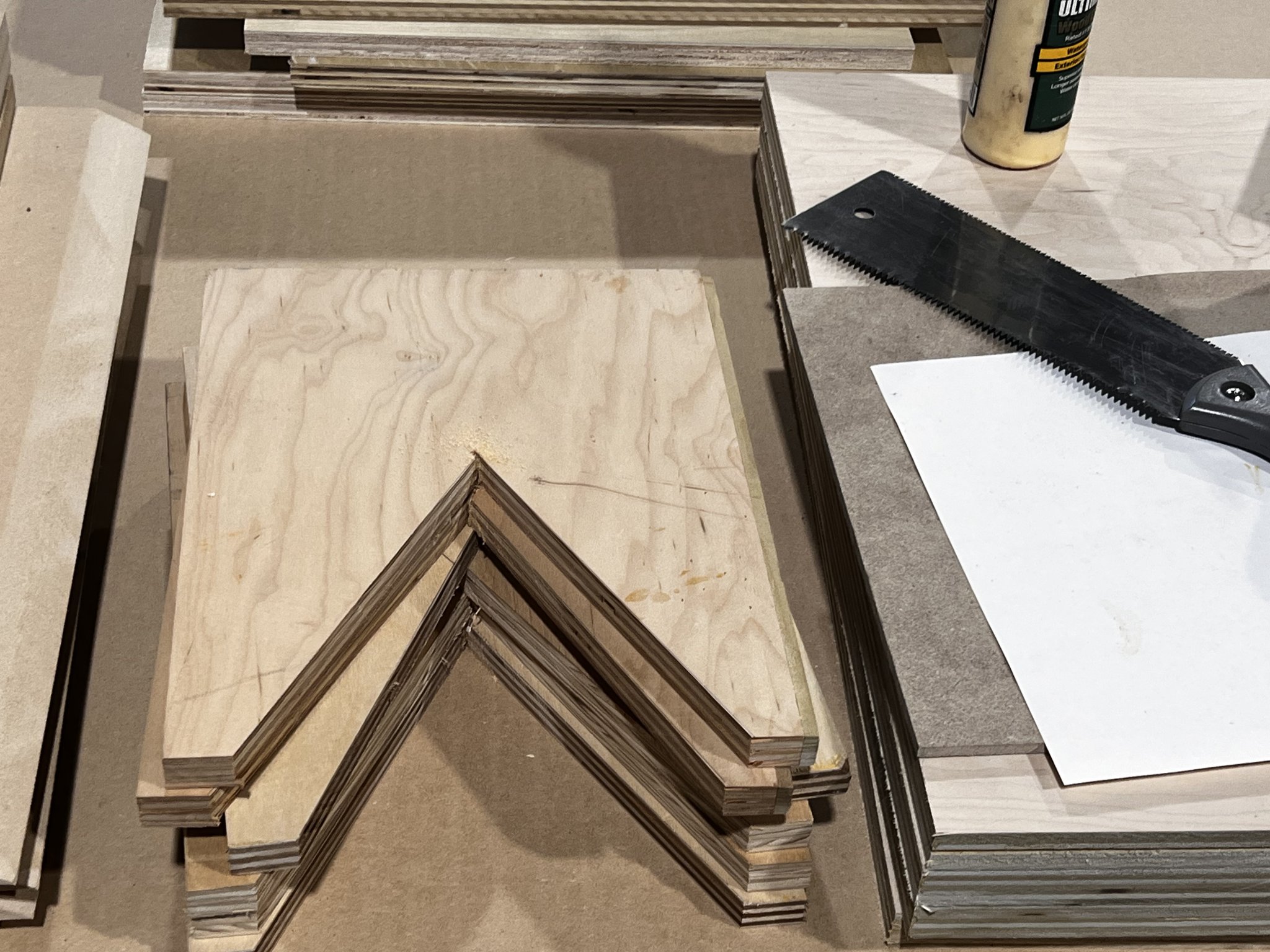

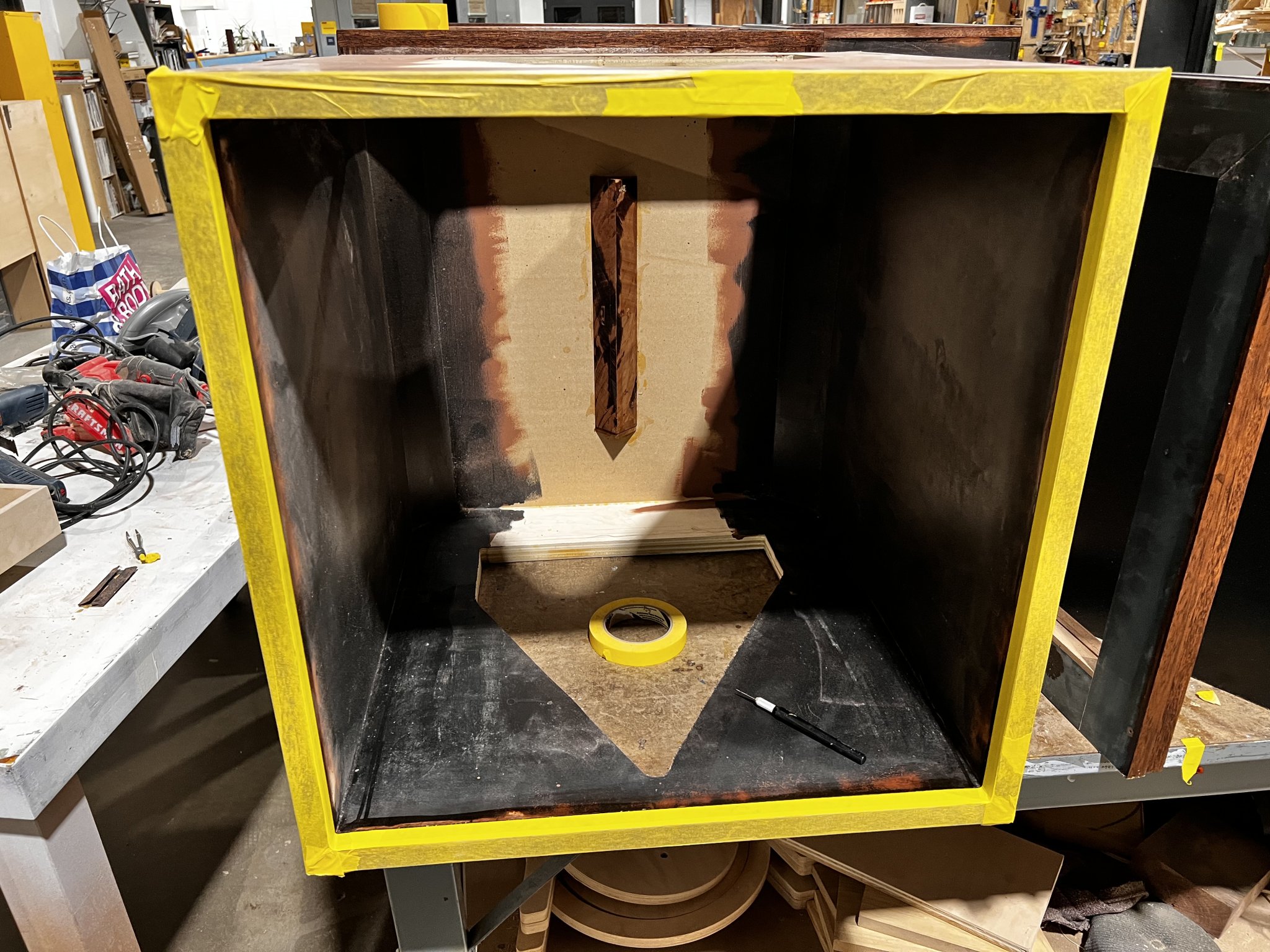

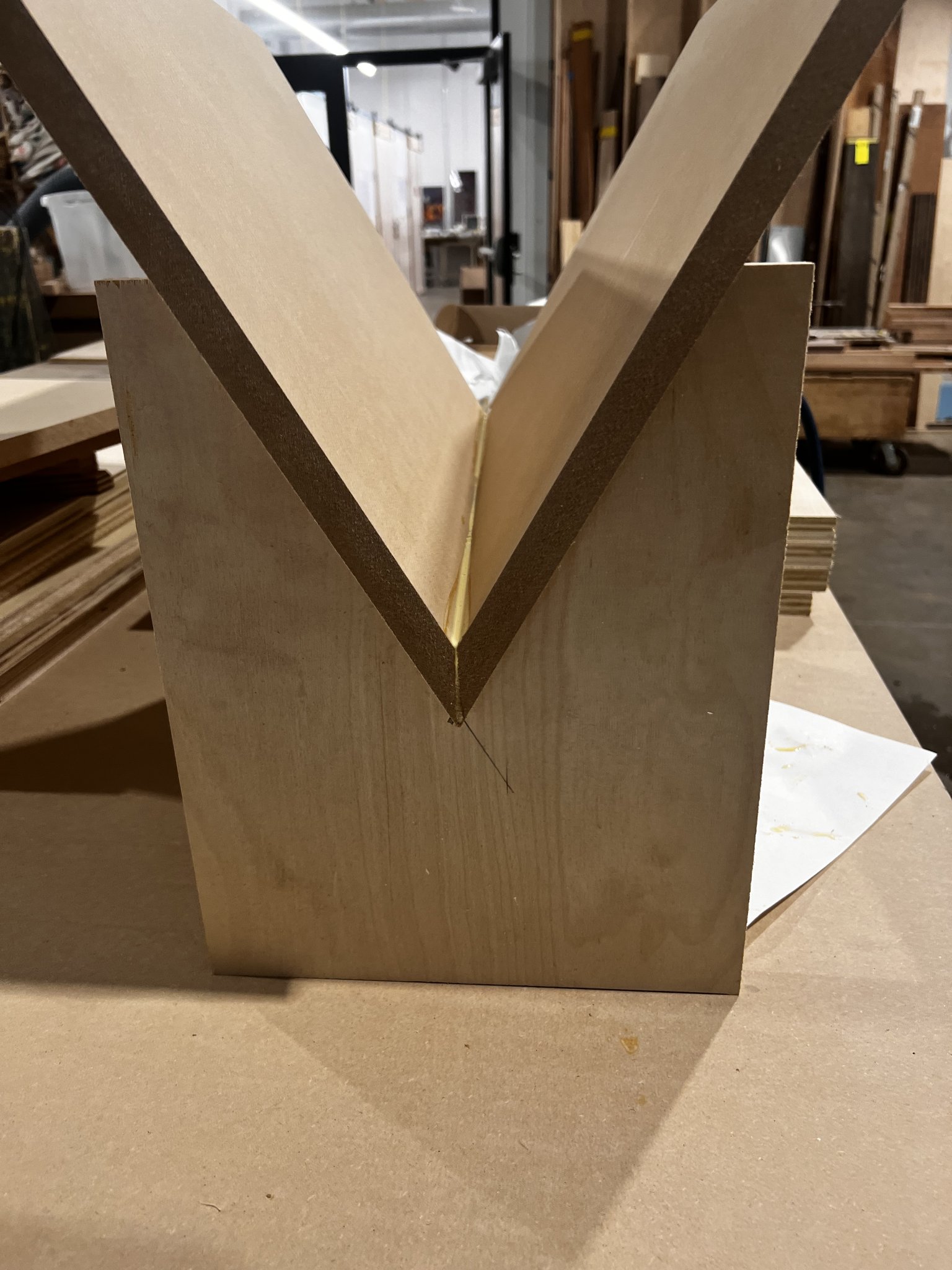

making the doghouse jigs:
Forming one of the doghouses; I used MDF for the doghouses, partly for its alleged damping qualities, but mostly because it's a cheap material and despite my woodworking experience, I was a bit daunted by cutting and forming them due to the acute 60º angles. This turned out to be a good move, as my first attempts were not perfect, but I got them right in the end:

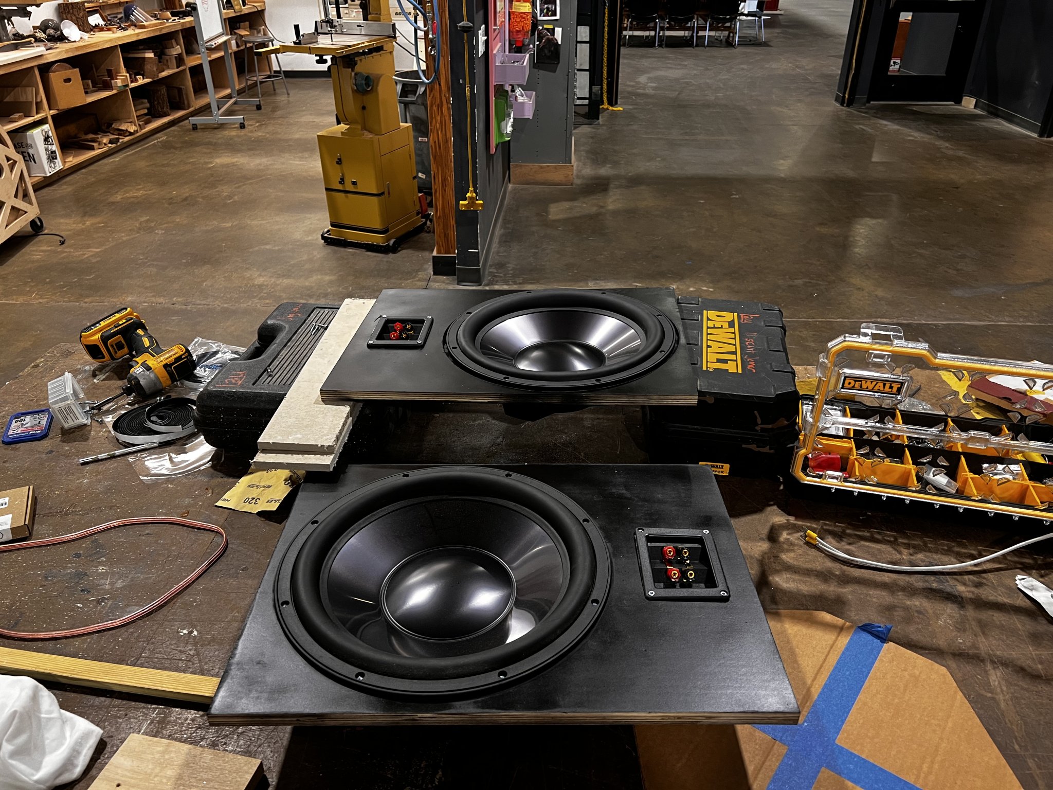

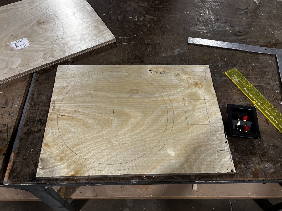

Next I began the motorboards:
doghouses, glued up:

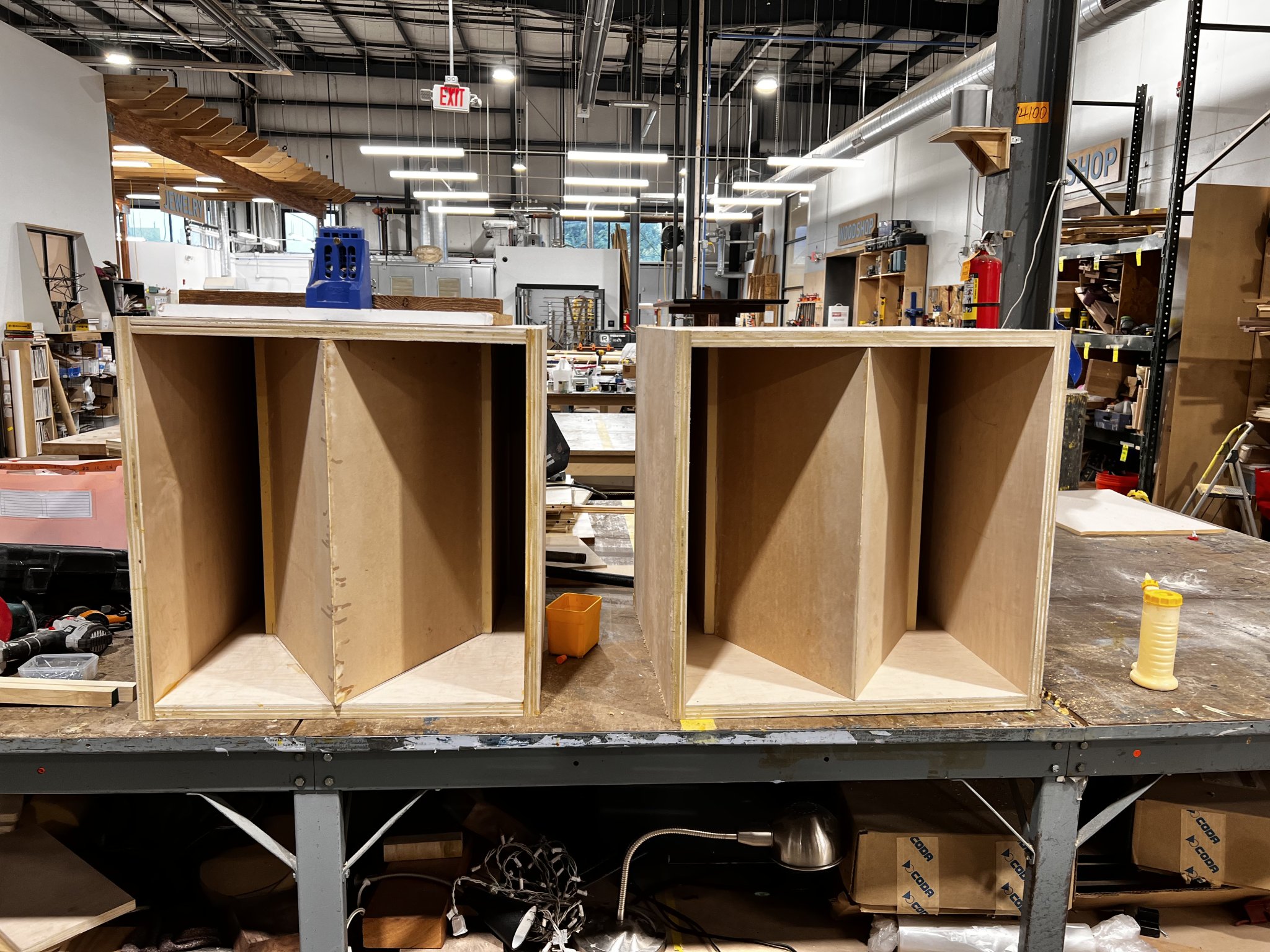

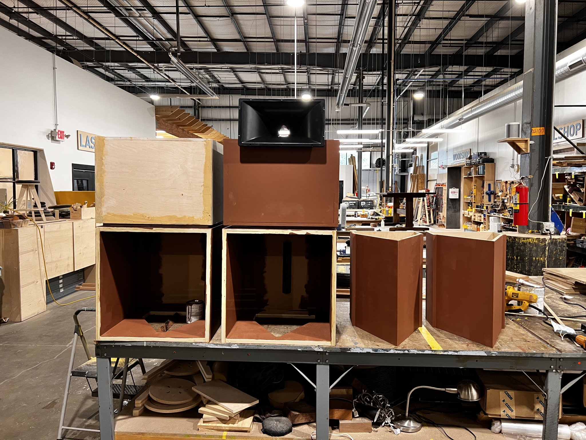

A little more progress, all of the cabinets are constructed and almost everything is primed. At this point, a little more prep is needed before applying the enamel and building my router jigs. After a couple coats, I’ll route for the horns, assemble the bins, install mahogany trim, stain and clear coat everything. After that, it will be assembly and time to rock the house.

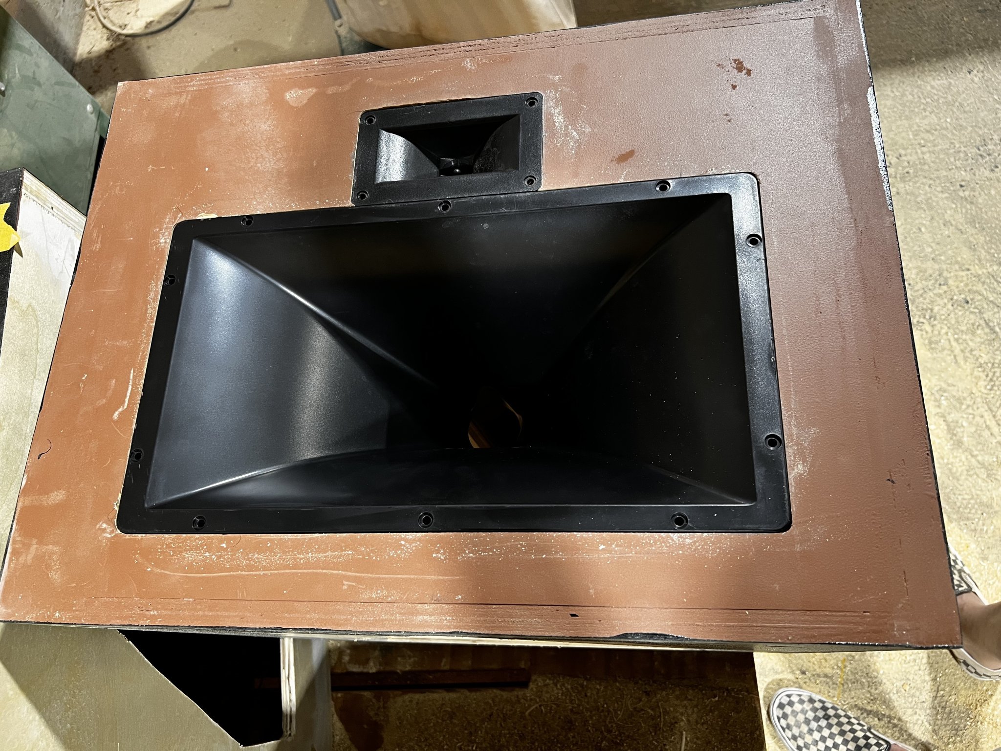

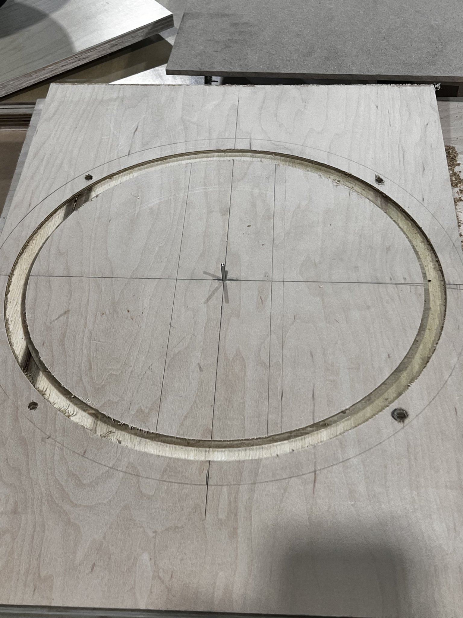

These are going to be really big. With the PRV 18r x 10 and L-MAHLs, the horn enclosure is 18” tall. With casters, they will be about 4 feet tall. I may be pushing the WAF.

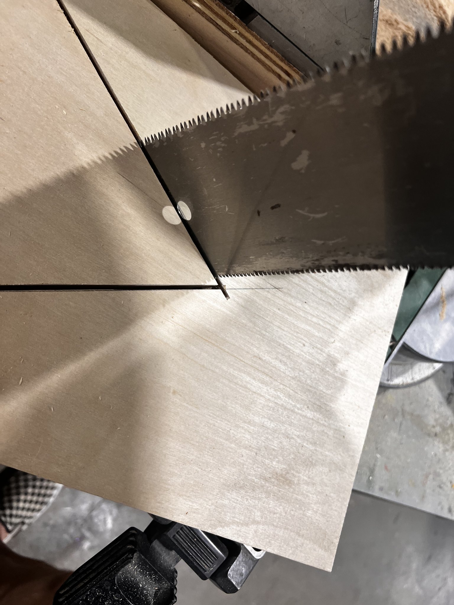

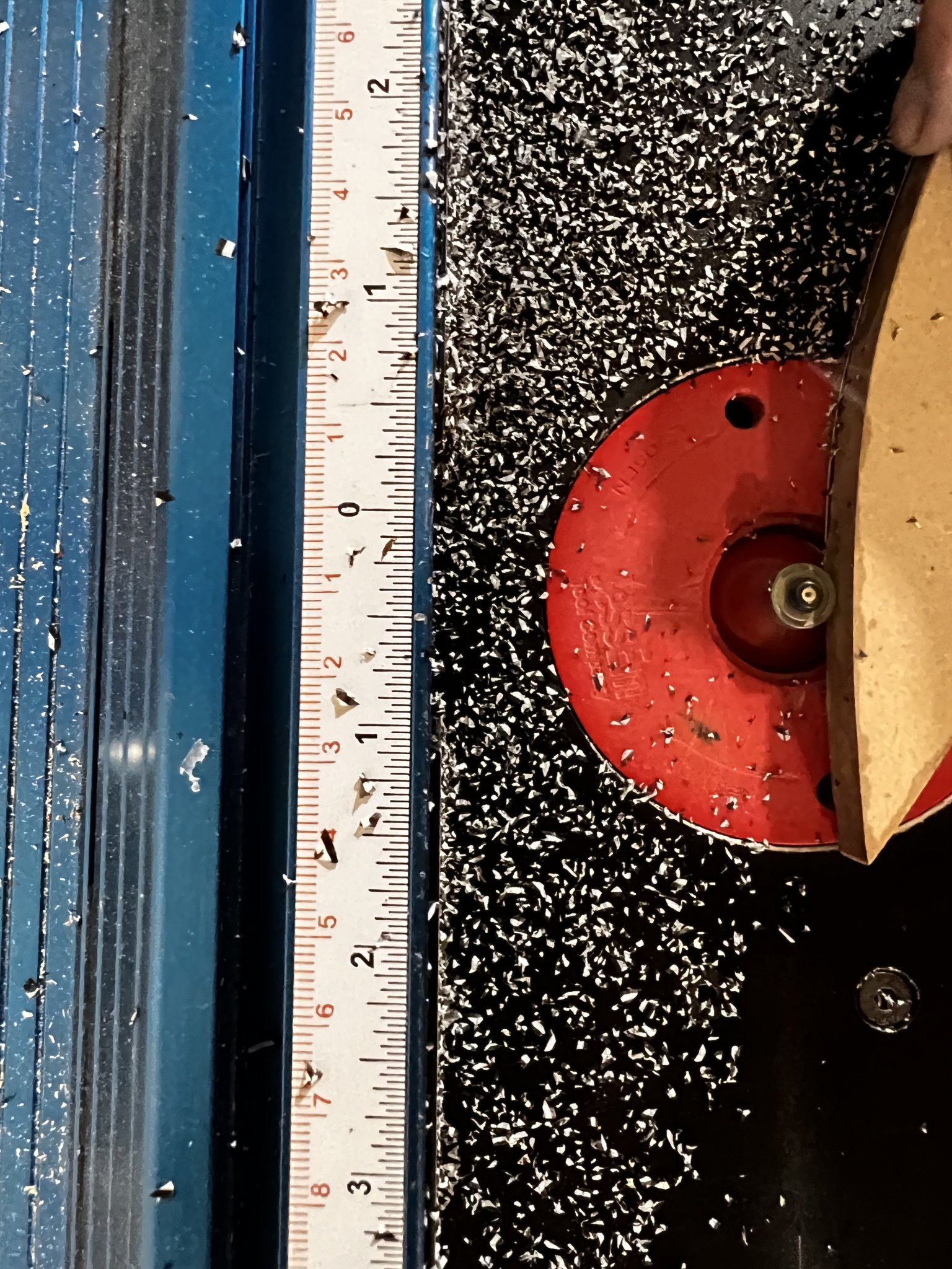

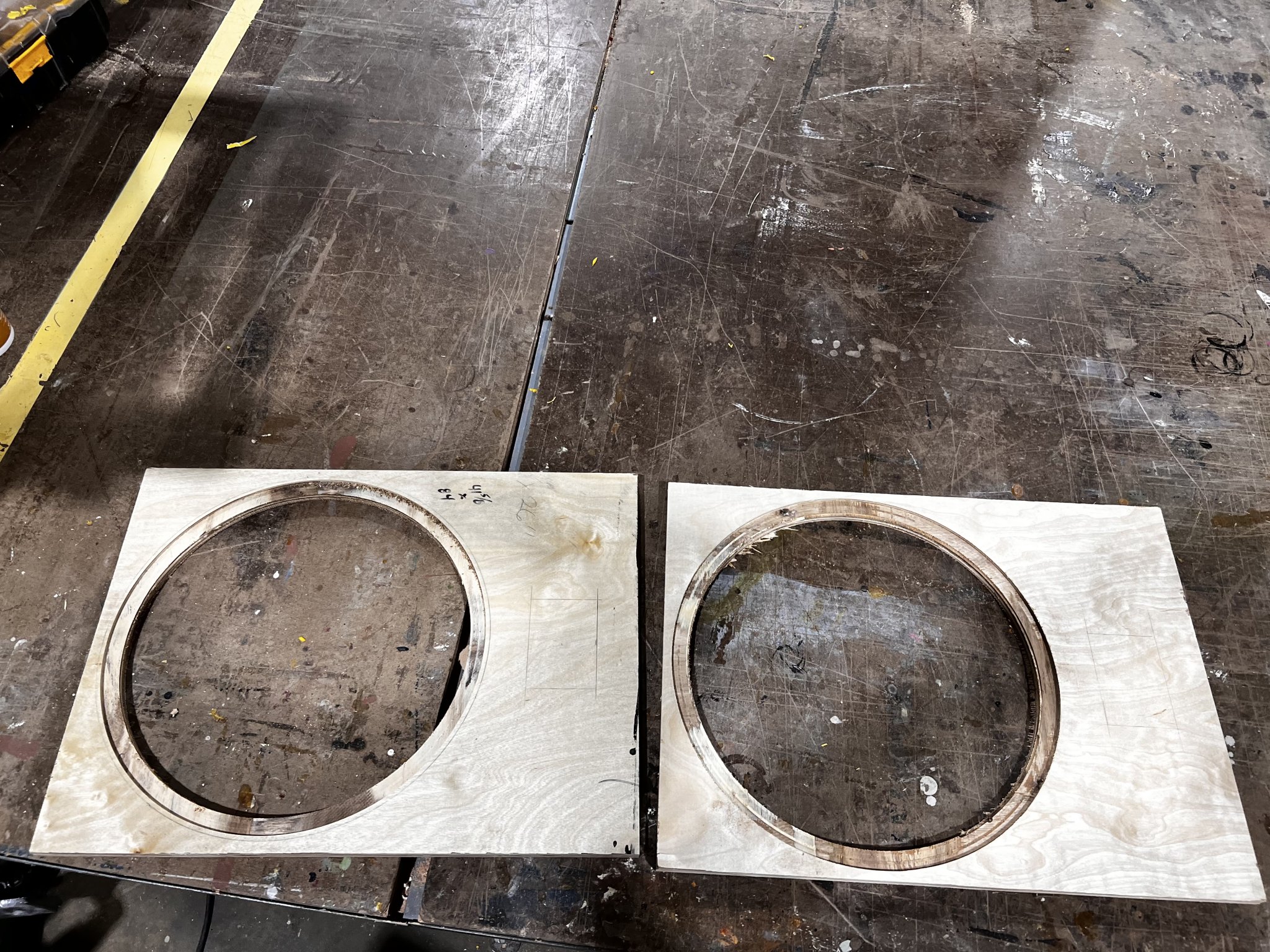

making the router jigs:
Routing the baffles:

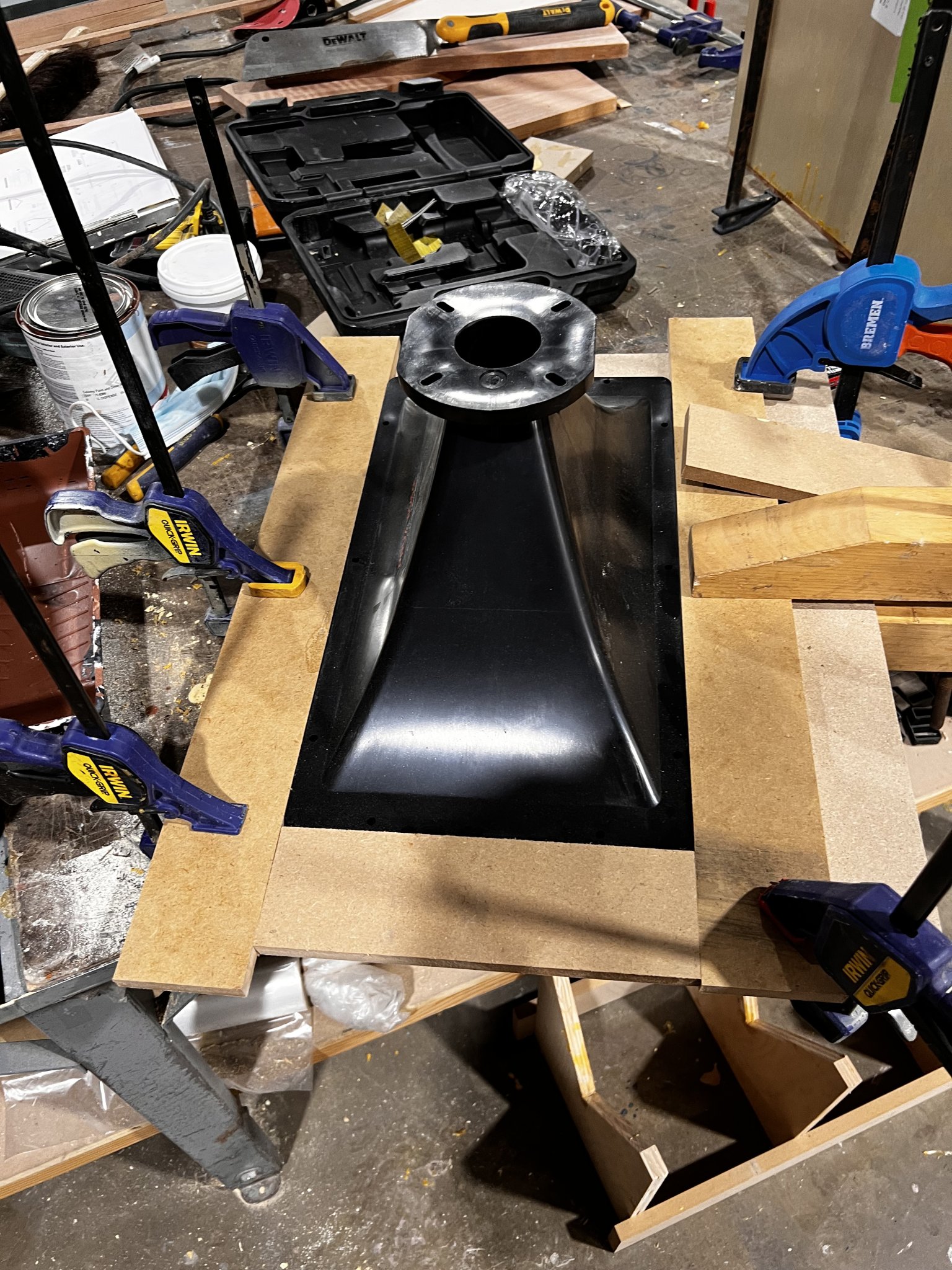

routed and mocked up with the waveguides in place:

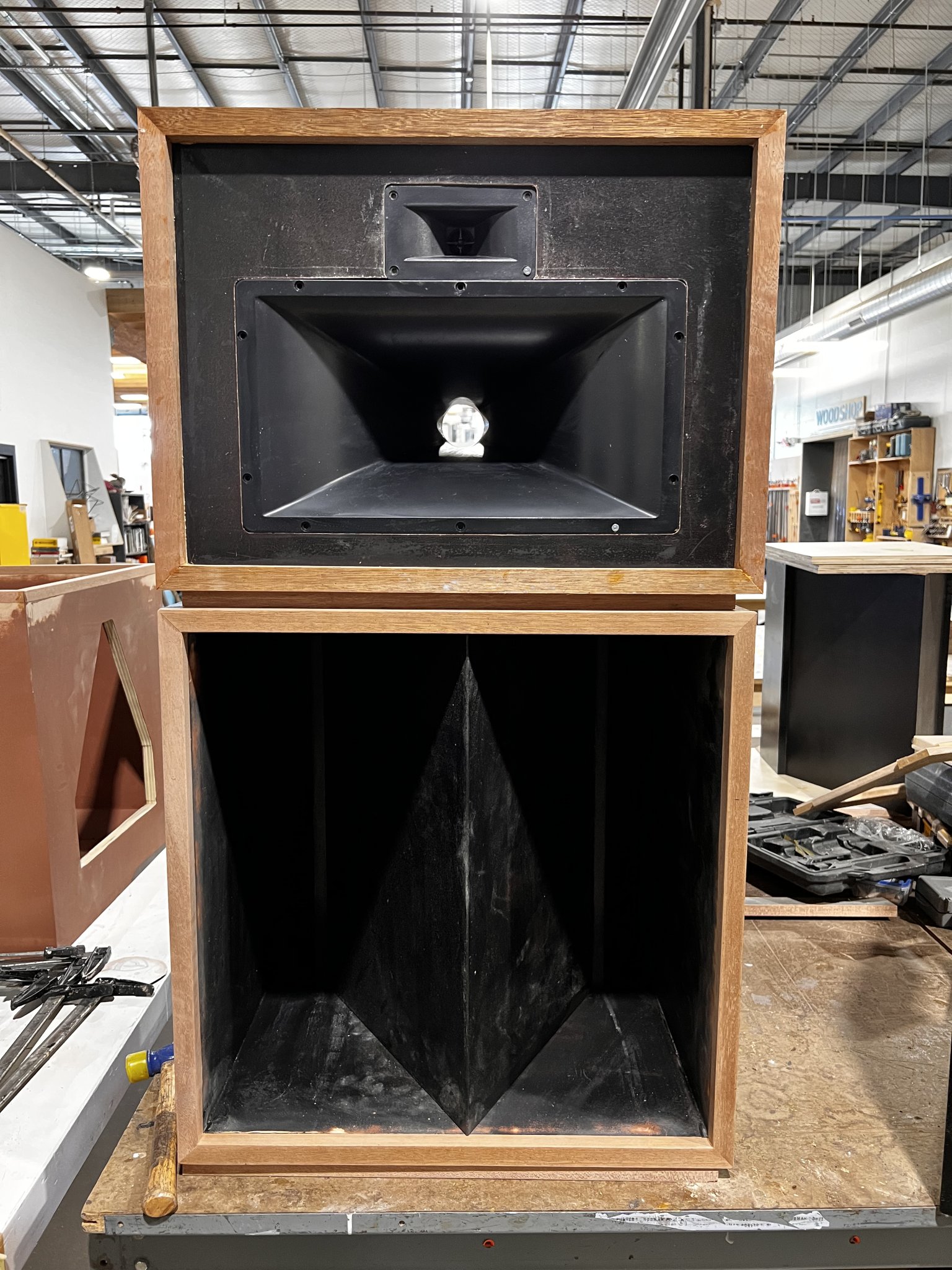

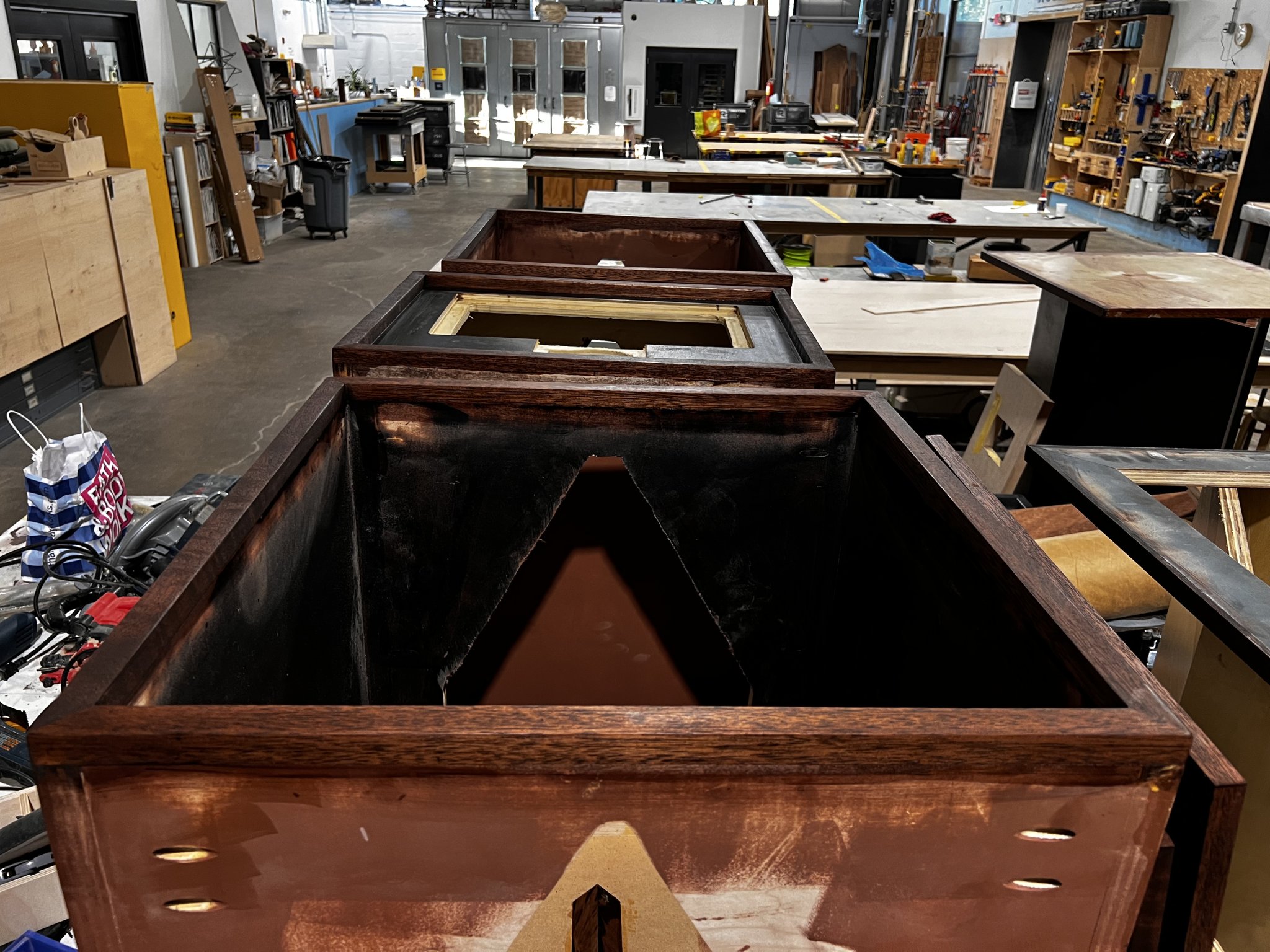

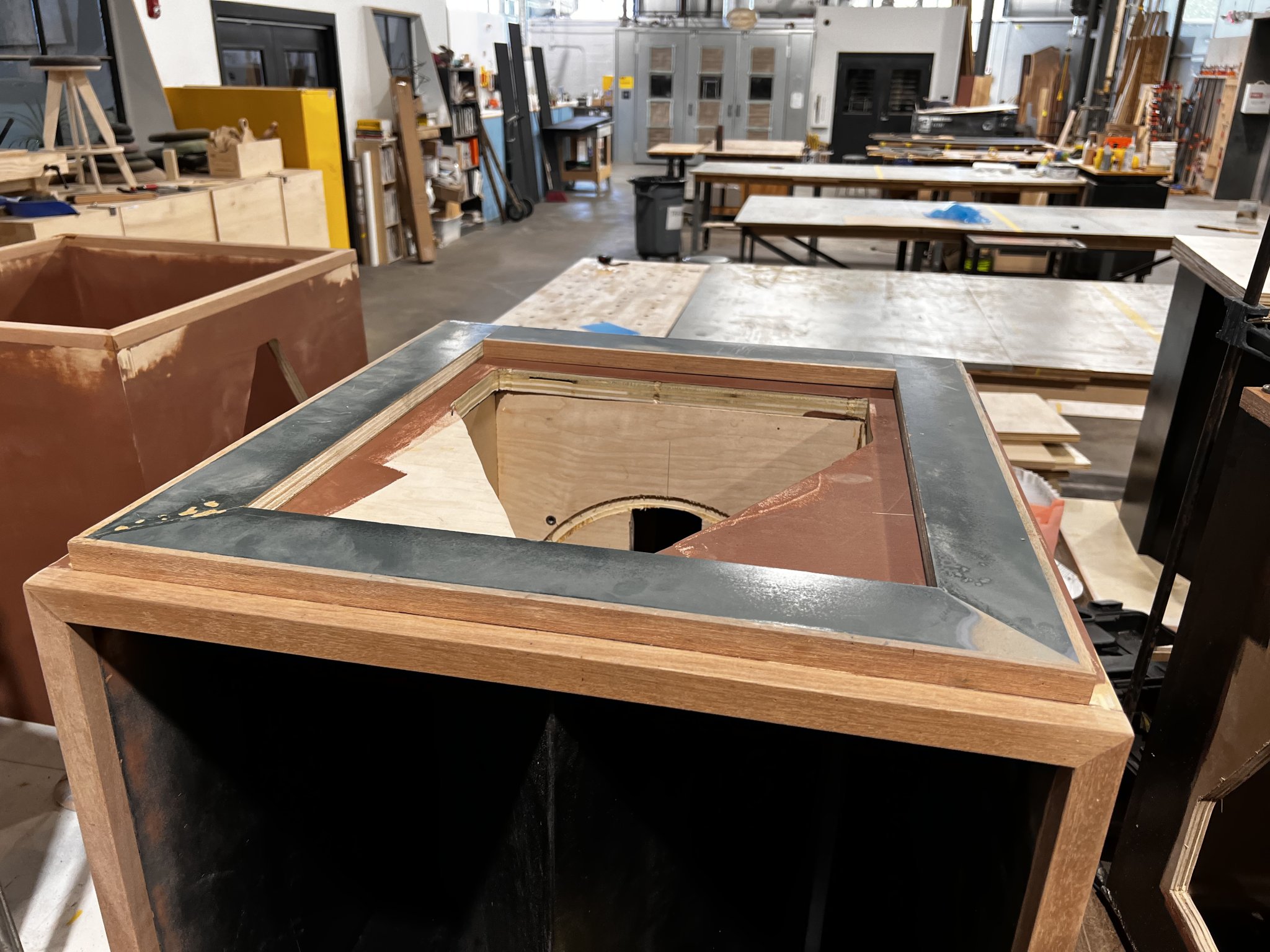

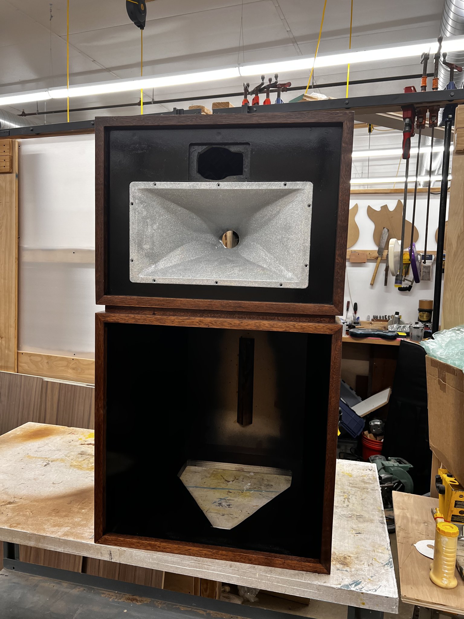

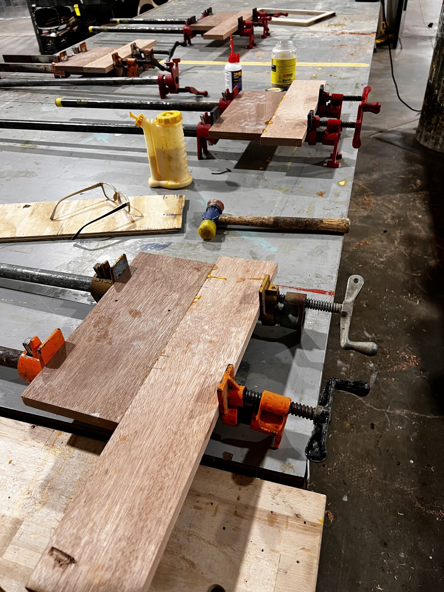

Now, it's time to start trimming them out. I'm using Meranti Mahogany for the face frames and spacers, here's one of t:
the bass bins:
a 3/4" spacer between the cabinets, with 1/4" Mahogany edge banding- I'm not a fan of veneer for edge banding, I don't think it's particularly durable. This works much better:
one of the cabinets completed and mocked up:
the bass bins:

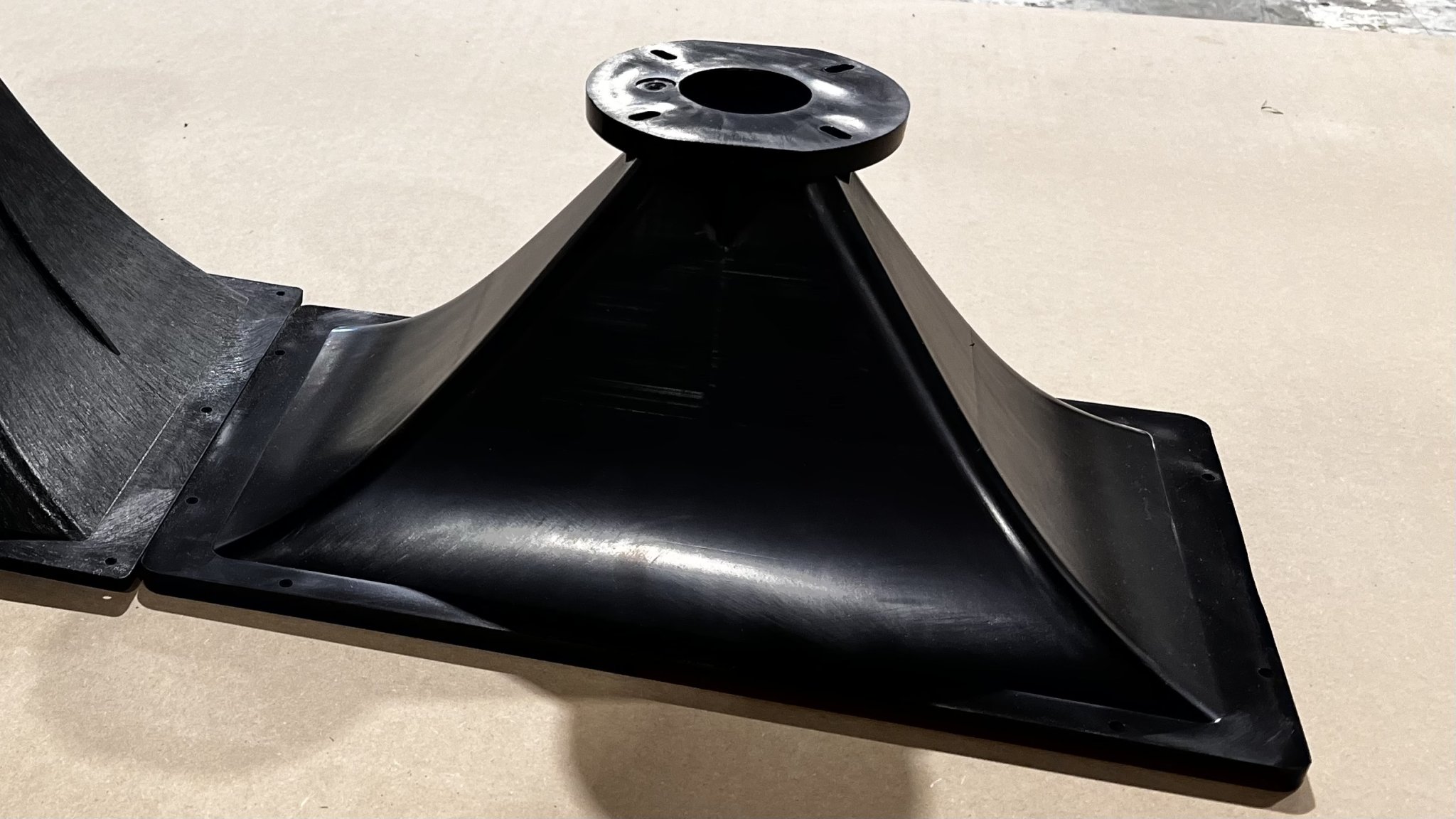

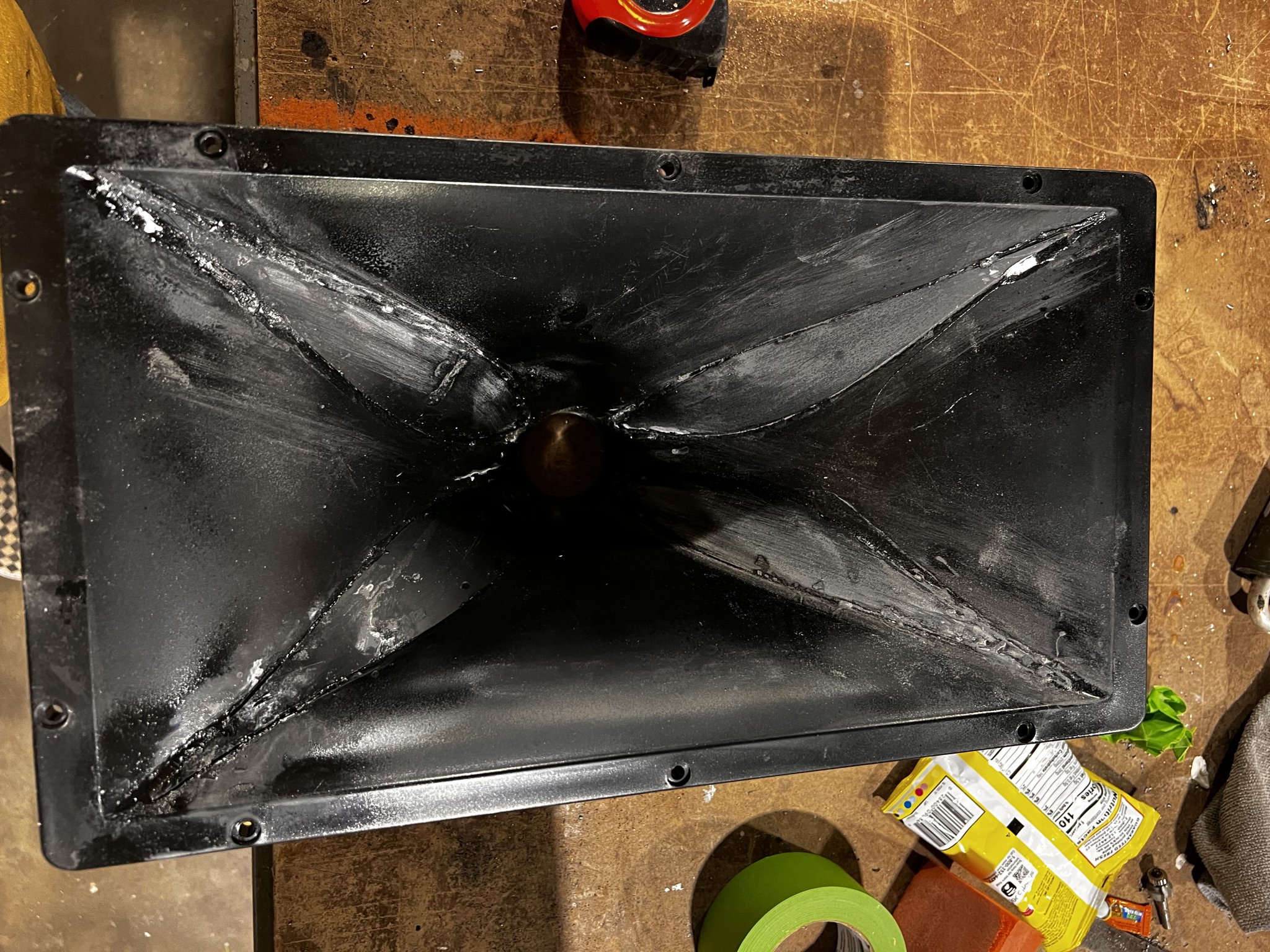

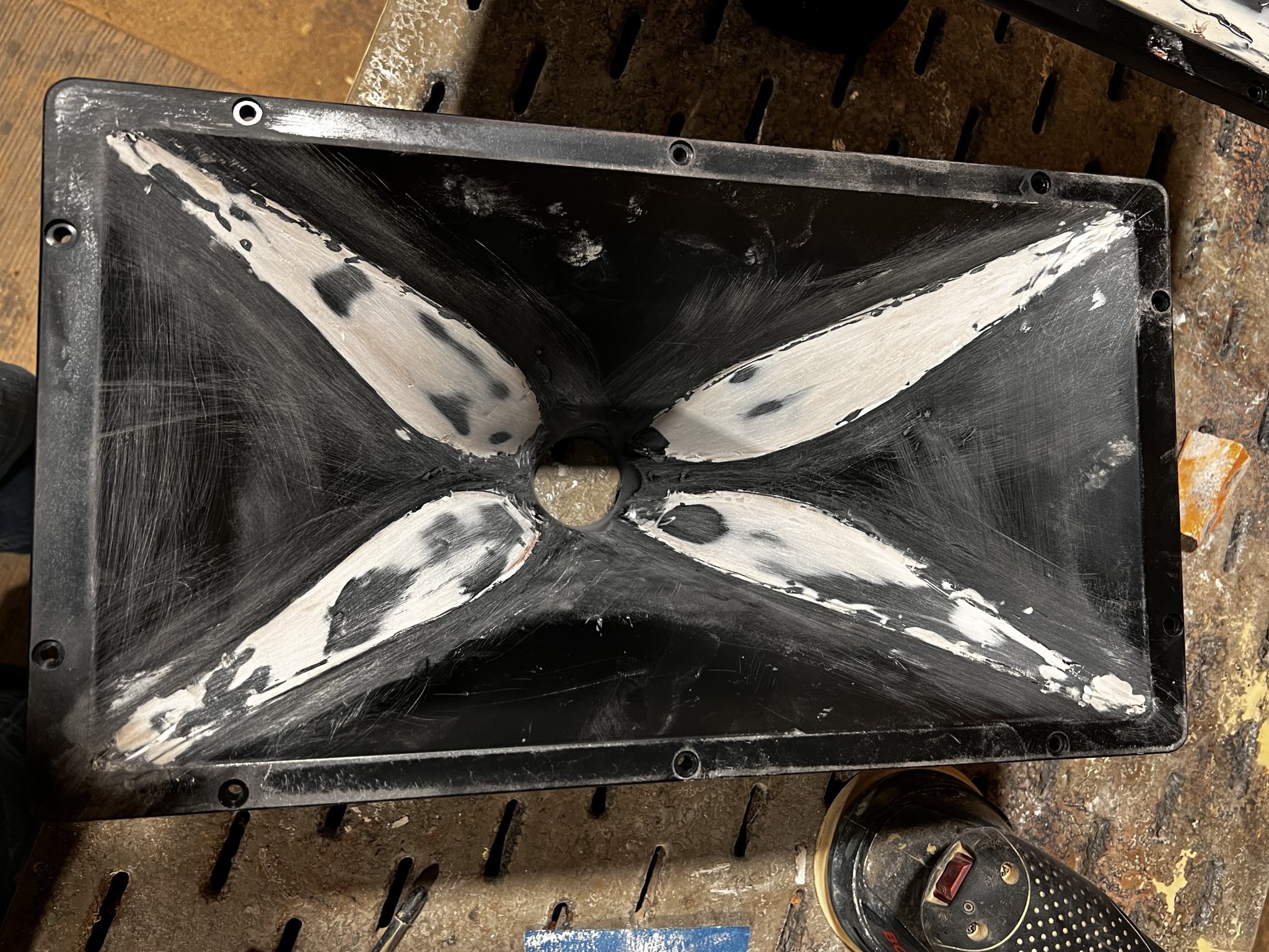

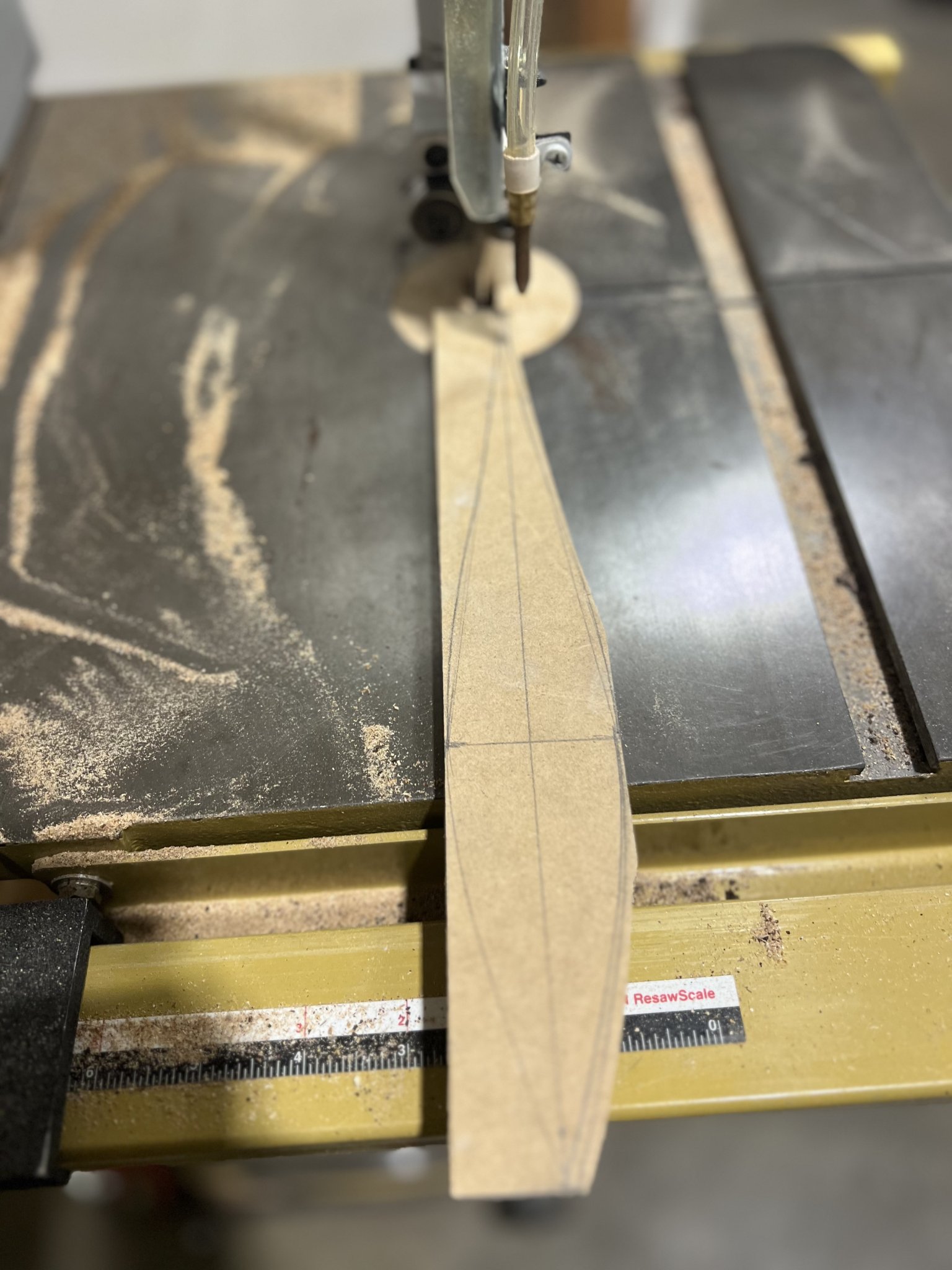

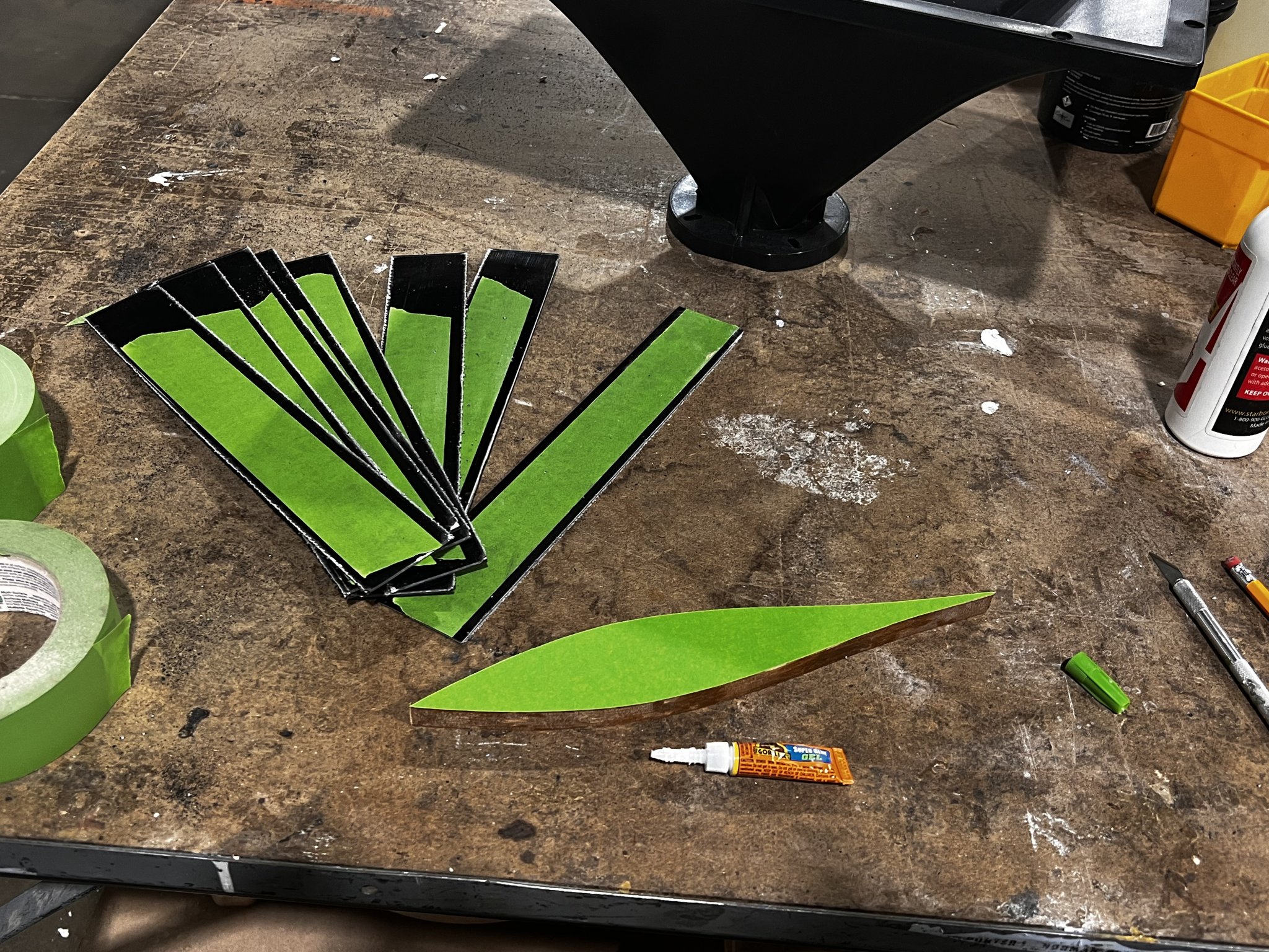

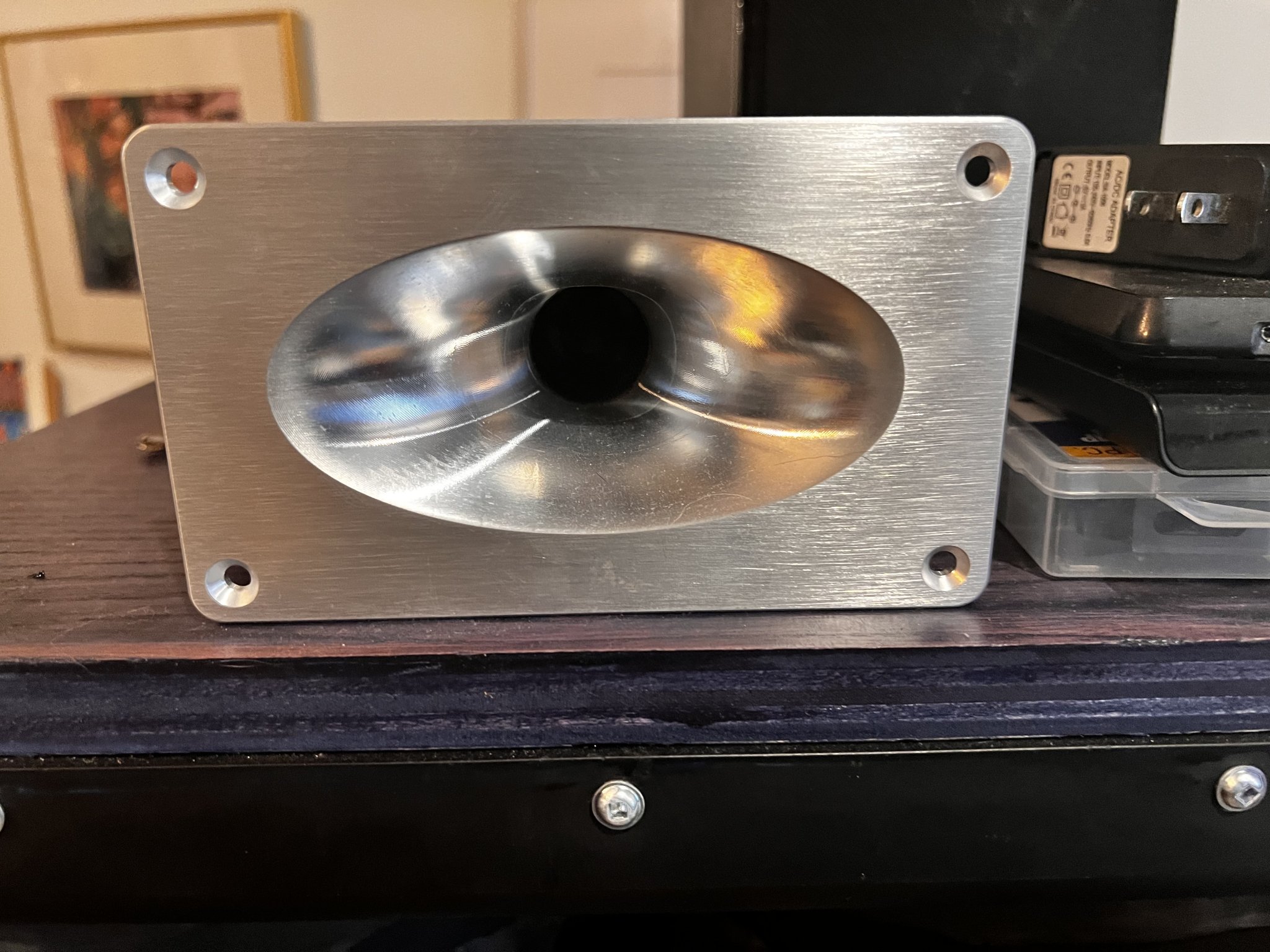

While the paint cures, it's time to give some attention to the squawker waveguide. One of the biggest, most valid complaints about horn speakers is their tendency to "beam": they'll can be hyper-directional and sound great only in a limited seating area. Klipsch's Chief Bonehead, Roy Delgado, had a brilliant solution while watching his kids blow bubbles outside and created diffusion flares, known as "Mumps™."
I played around with the diffusion flares with the K510 horns in the Frankenstein Fortes in the first post above, using plasticine and found it to be very effective in aiding the dispersion of the waveguide, however, while Sculpey clay is great for experimentation, it's not particularly presentable; the Mumps™ ended up looking a bit too organic, like the Mind Flayer from Stranger Things. These would need better flares, so I set out to make them out of plastic pick guard material. I laid out the shape by hand on 3/4" MDF and cut the rough shape on a bandsaw:

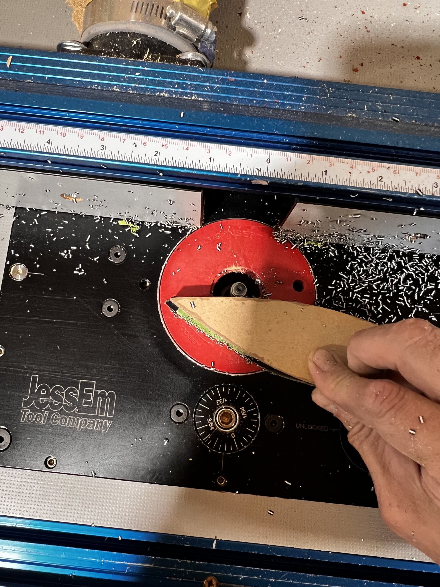

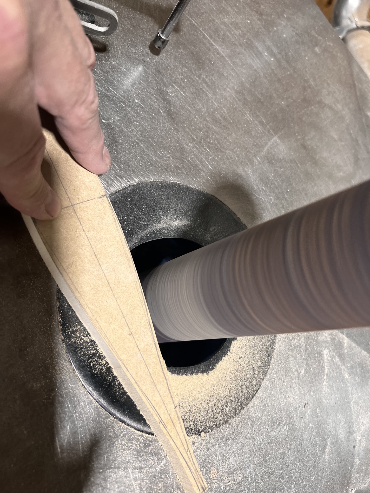

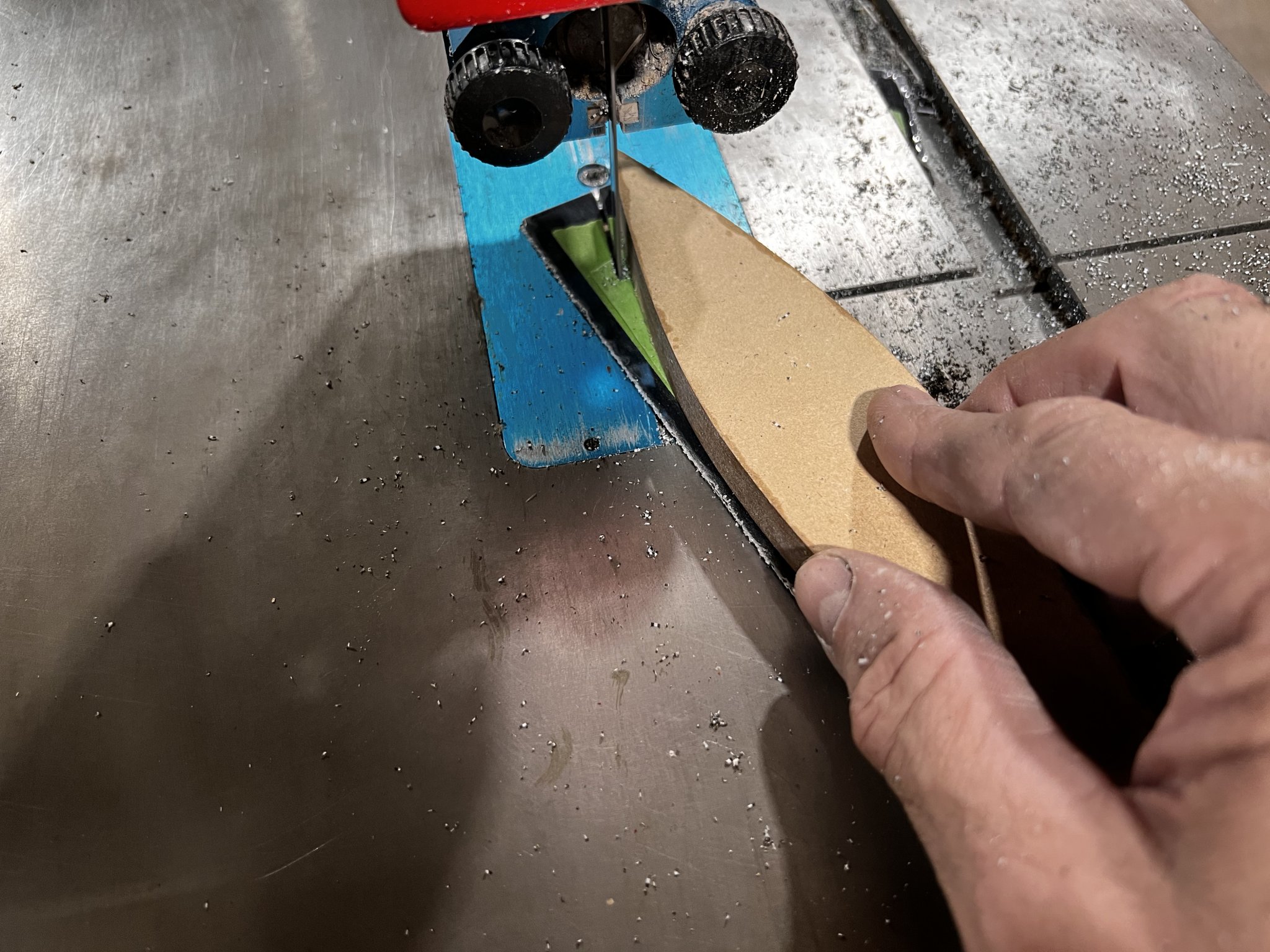

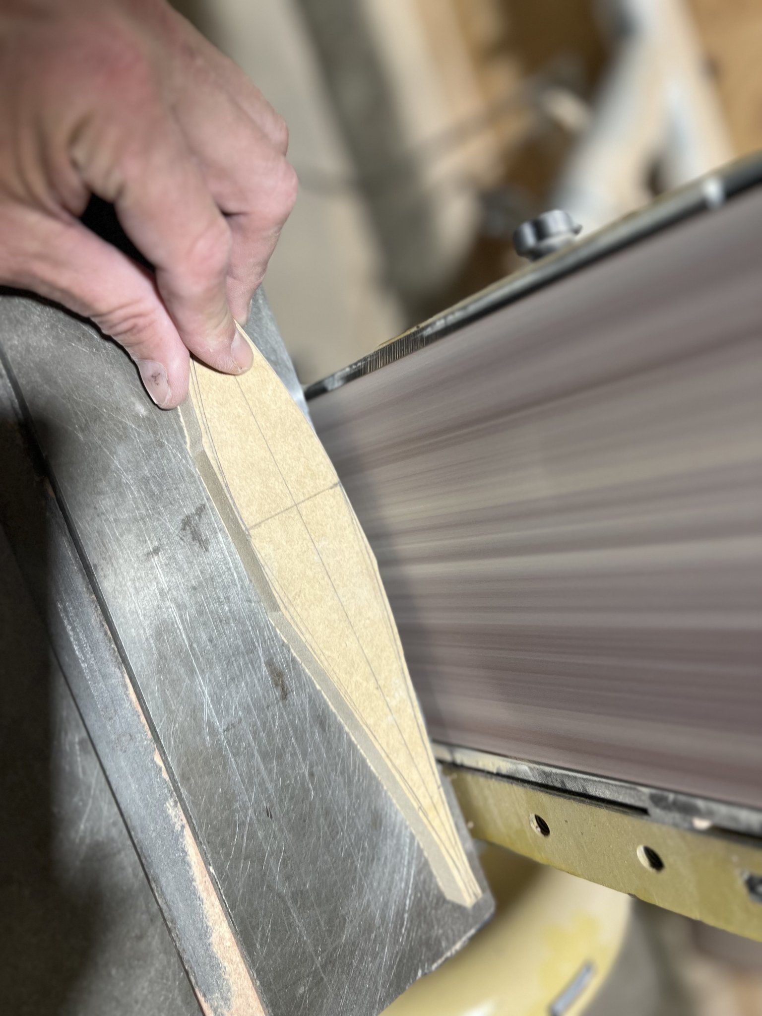

Next, I shaped them on a belt sander:
the area towards the horn throat has a slight recurve, which I formed on a spindle sander:

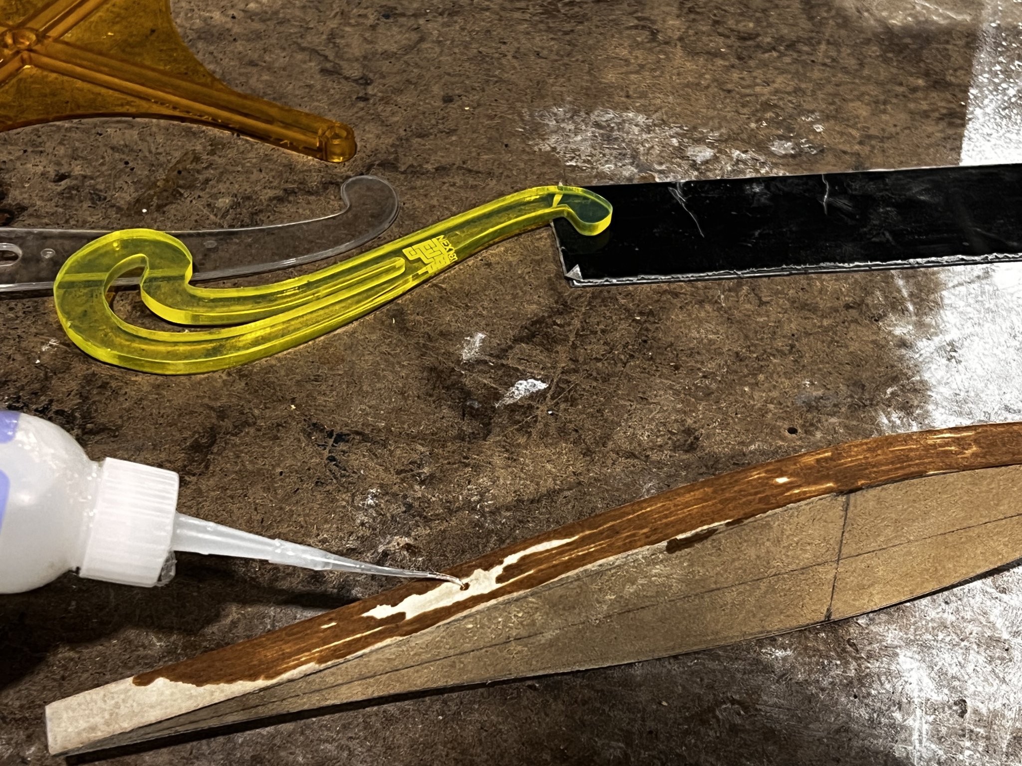

Next, I coated the edges with thin CA glue to keep them from blowing out on repeated passes on the router table:
there's a great trick for using router forms that I learned while making guitars: to attach the pieces to the jigs, you apply low-tack masking tape t both surfaces, then attach them together with super glue on the tape. This makes doing multiple pieces easily repeatable:
I cut the pickguard material into strips, slightly wider and longer than the jig/form and first, cut them to the approximate shape on a band saw:
Then I cut them to shape with a bottom bearing straight bit:
and put a 45º bevel on them

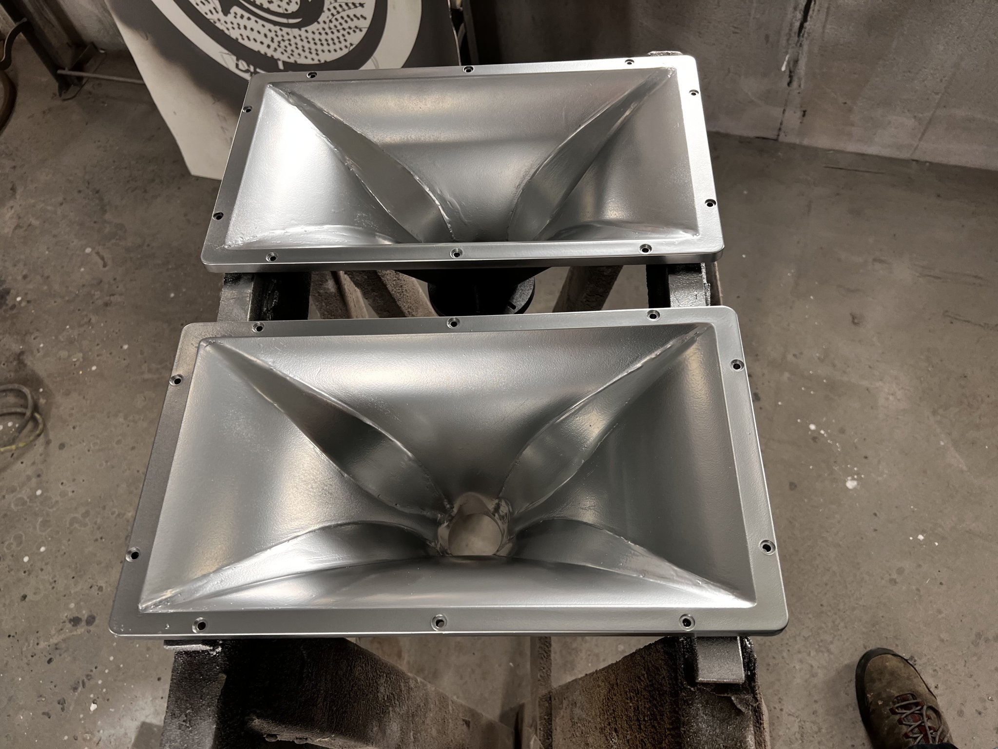

The pieces were then glues into the waveguides with thick CA glue:
I used more glue and accelerator to build up any gaps at the edges, then sanded them flush:
and gave them a chrome base coat:
One of my side hustles is doing glitter finishes on guitars, a skill I picked up during the pandemic- I do paint jobs for customers locally here n Philadelphia, Dipinto Guitars is a regular client and I've done guitars for Los Straitjackets recently. I figured that it would be entirely on brand to glitter the horns up, which would also cover any imperfections from gluing up the Mumps™.

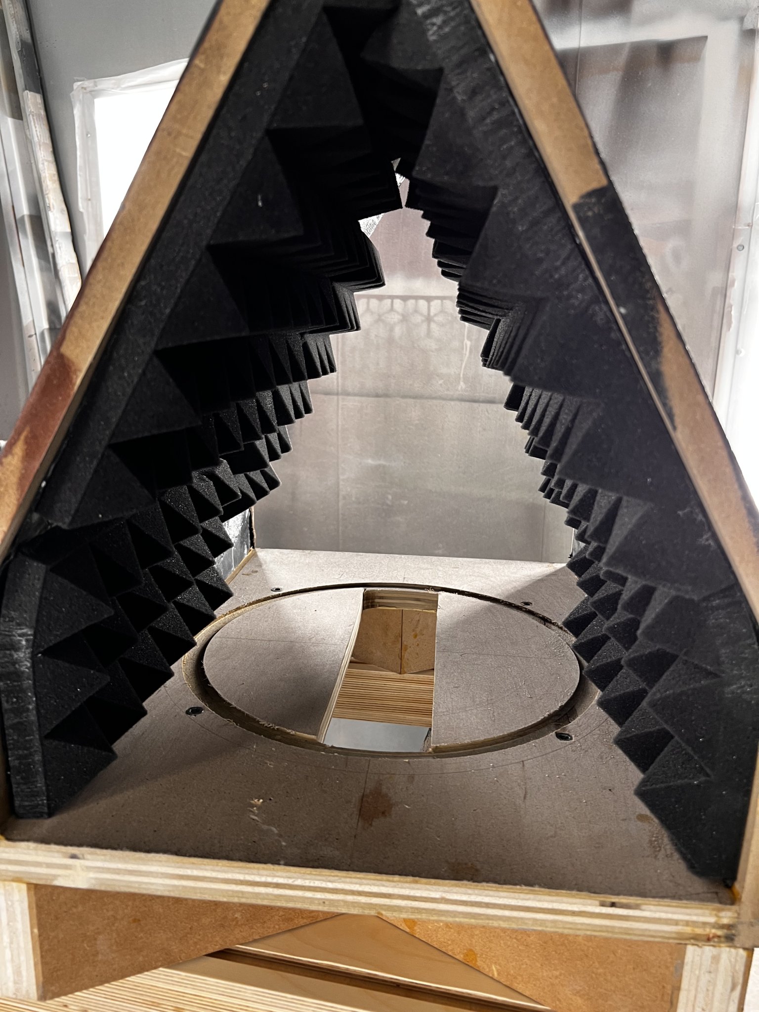

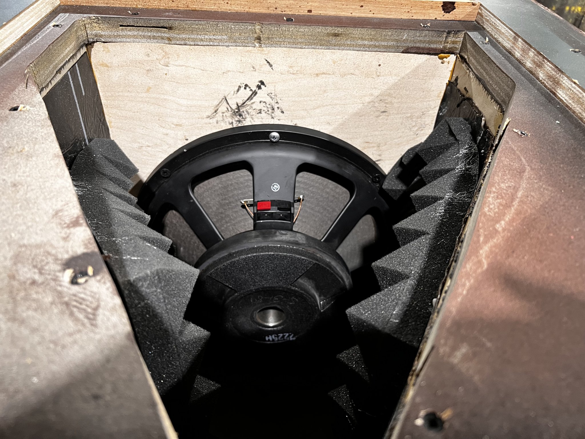

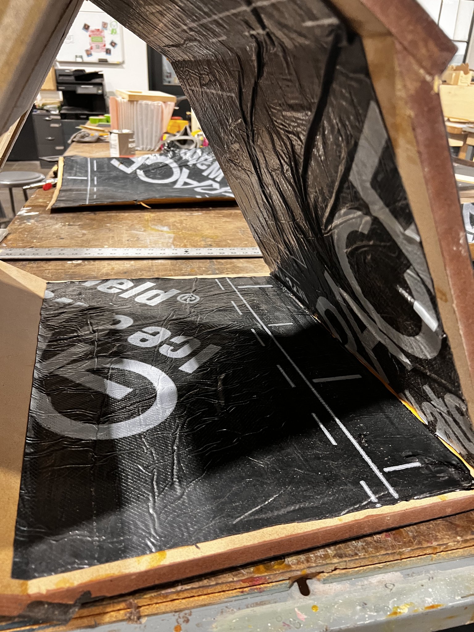

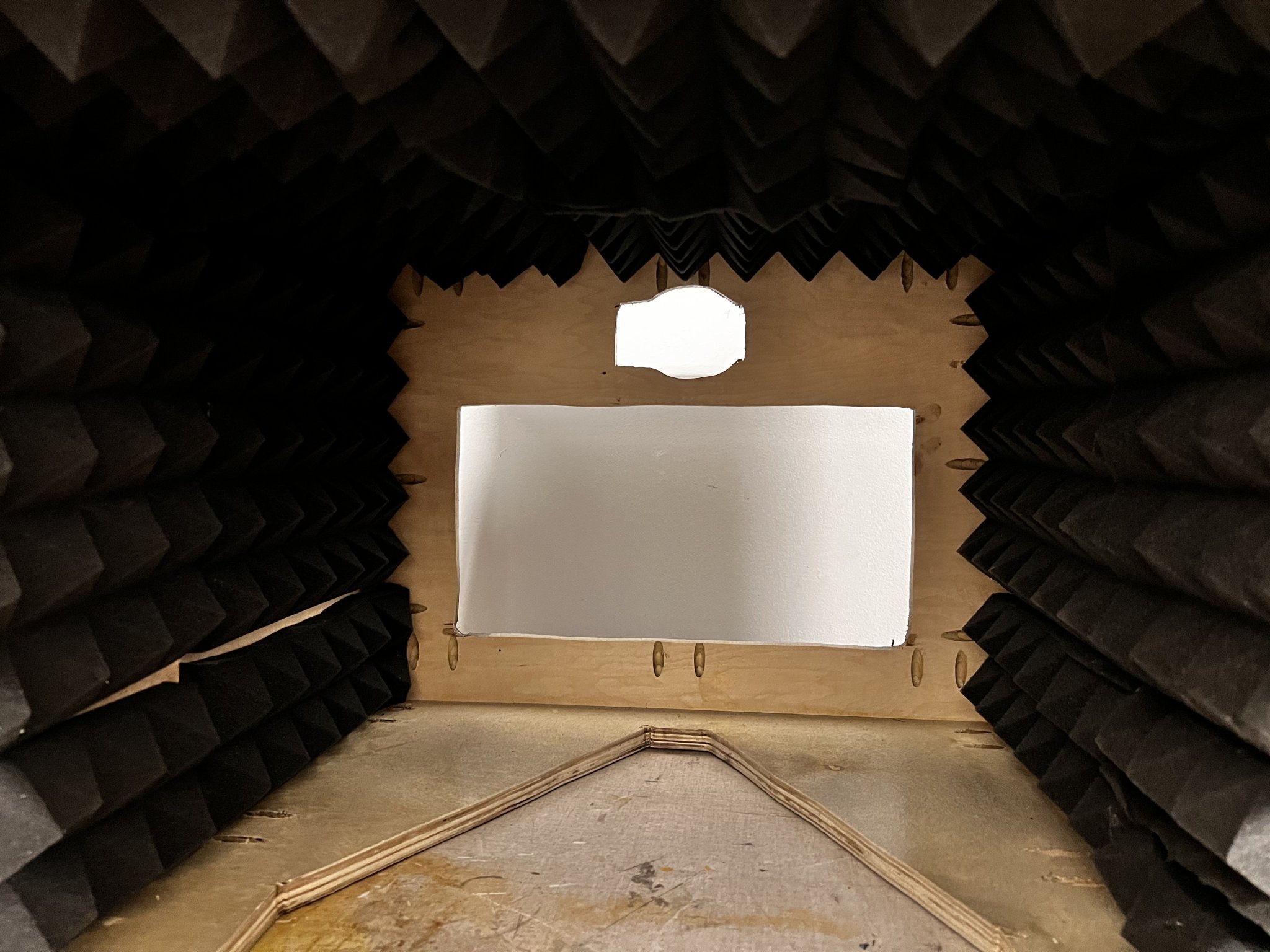

While the cabinets cured, I also took the time to firm up some unseen details. the insides of the doghouses got damped with Ice and Water Shield, which I had leftover from work; it's essentially the same material as Dynamat, but a whole lot less cheaper:
I also covered the insides of the cabinets with acoustic foam:
I also glued up the doghouse braces with scrap Meranti that I saved from the dumpster at work:

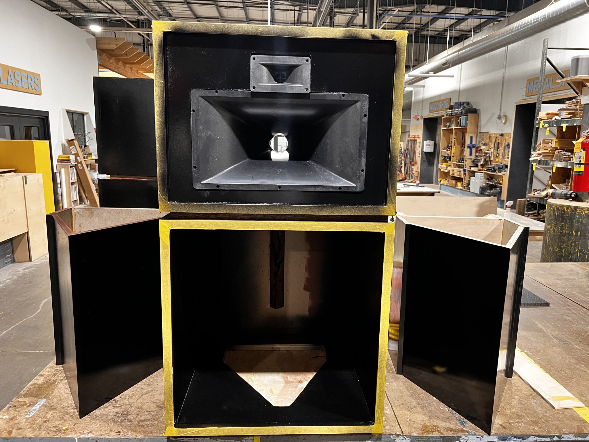

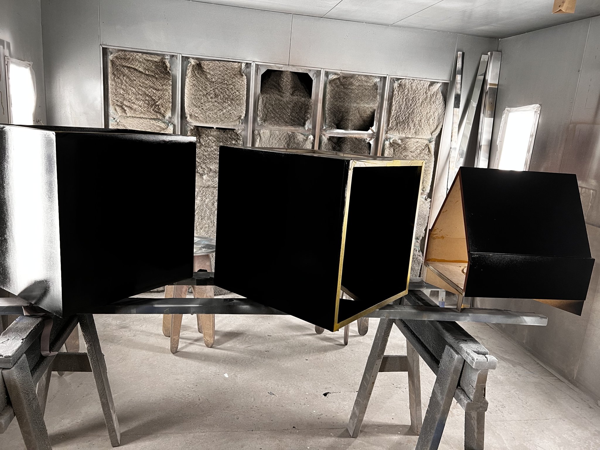

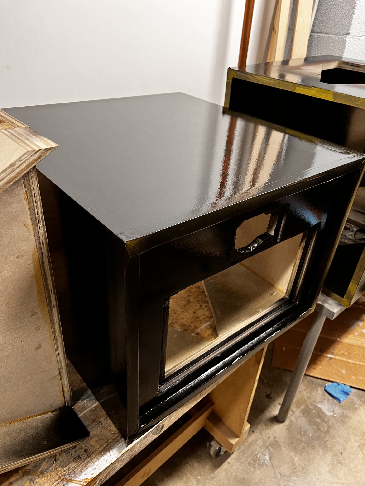

cabinets in the spray booth receiving clear:

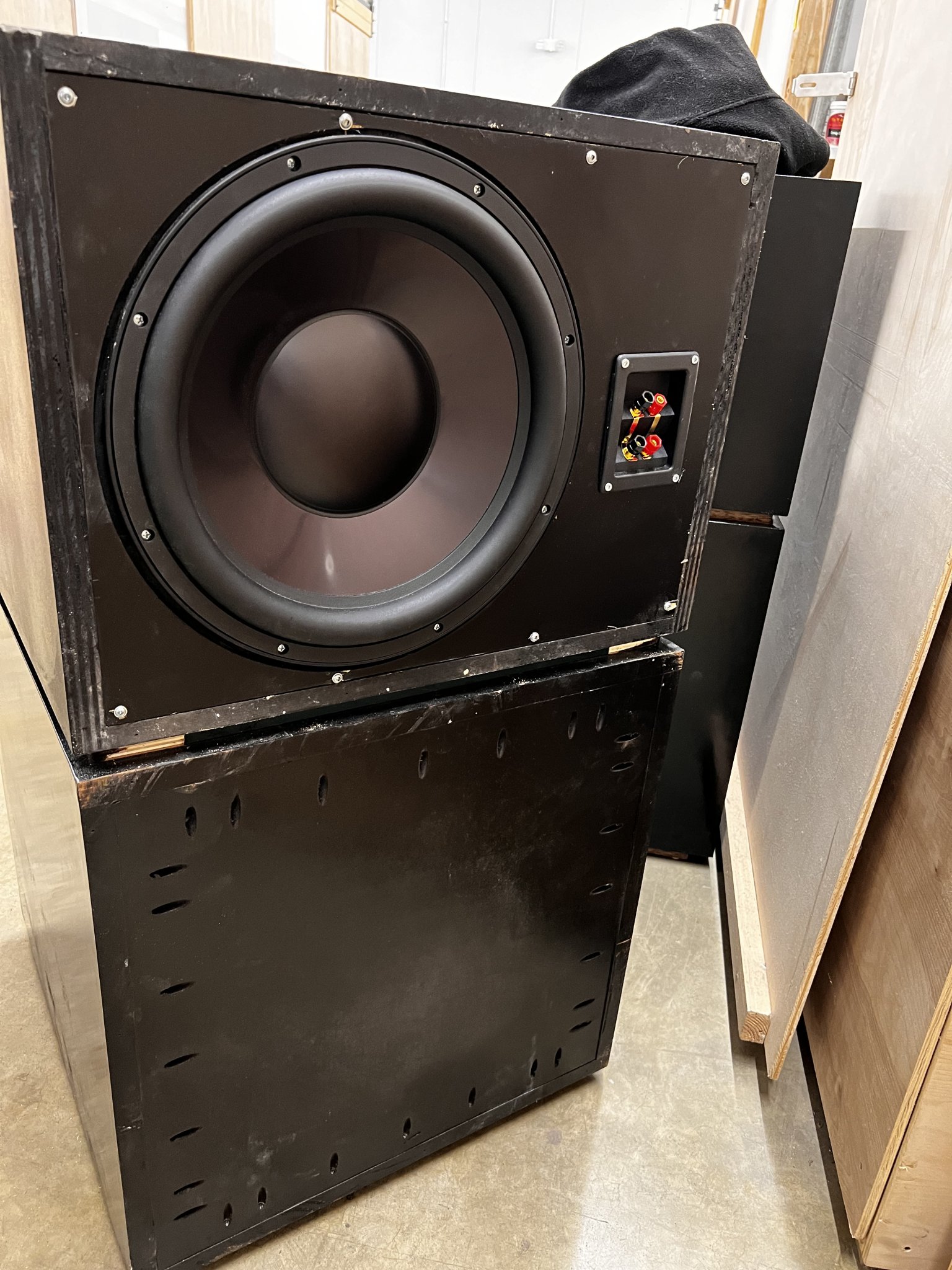

with the paint cured and the cabinets clear coated with 2k poly, it was finally assembly time!
I installed the woofers in the doghouses:
mounted the passives and terminals:
and installed the waveguides

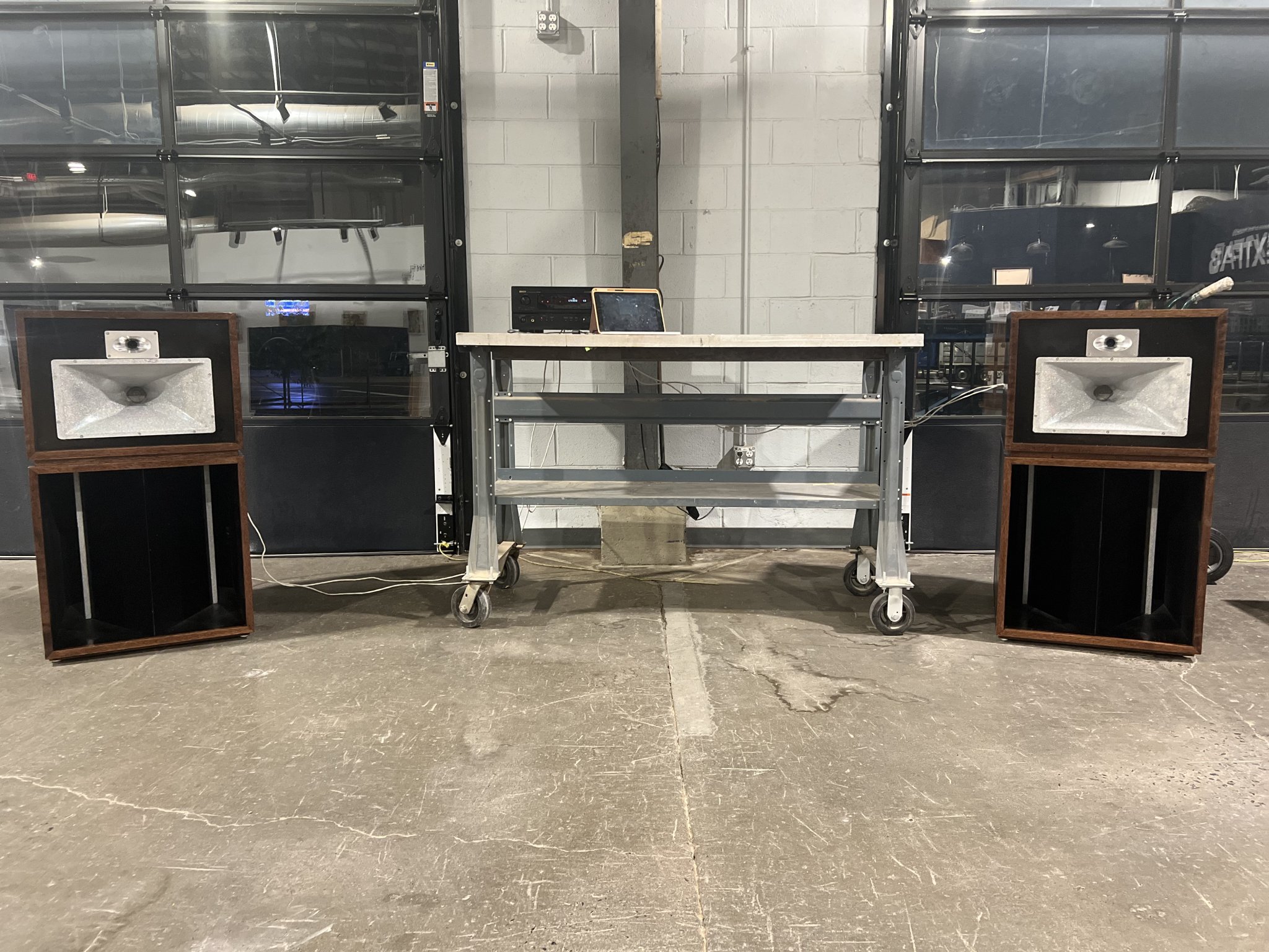

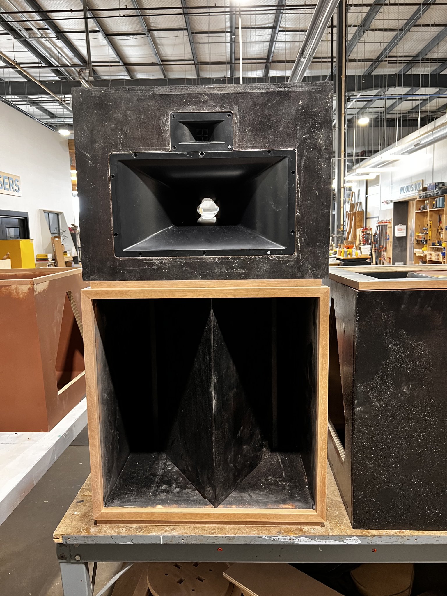

it took a bit to wrestle the doghouses into the enclosures, but once I got them in, I had to hear how they sounded:
first listening in a sub-optimal warehouse space was promising. Playing some bass heavy dub, they had no problem digging deep. While it's a far cry from using REW and a measurement mic, I checked the sound with an SPL meter app on my phone:
There's quite a bit of room gain on the low end- running through a receiver, the bass should (and is) be 3db attenuated from the upper horns, which is way different that what's represented above, but I'm using a phone, standing about 5m away in a very large and airy space.
Finally, they're finished and ready to go home for setup and measuring:

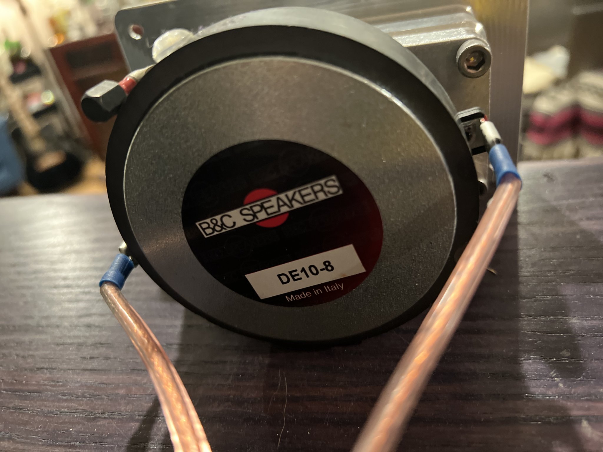

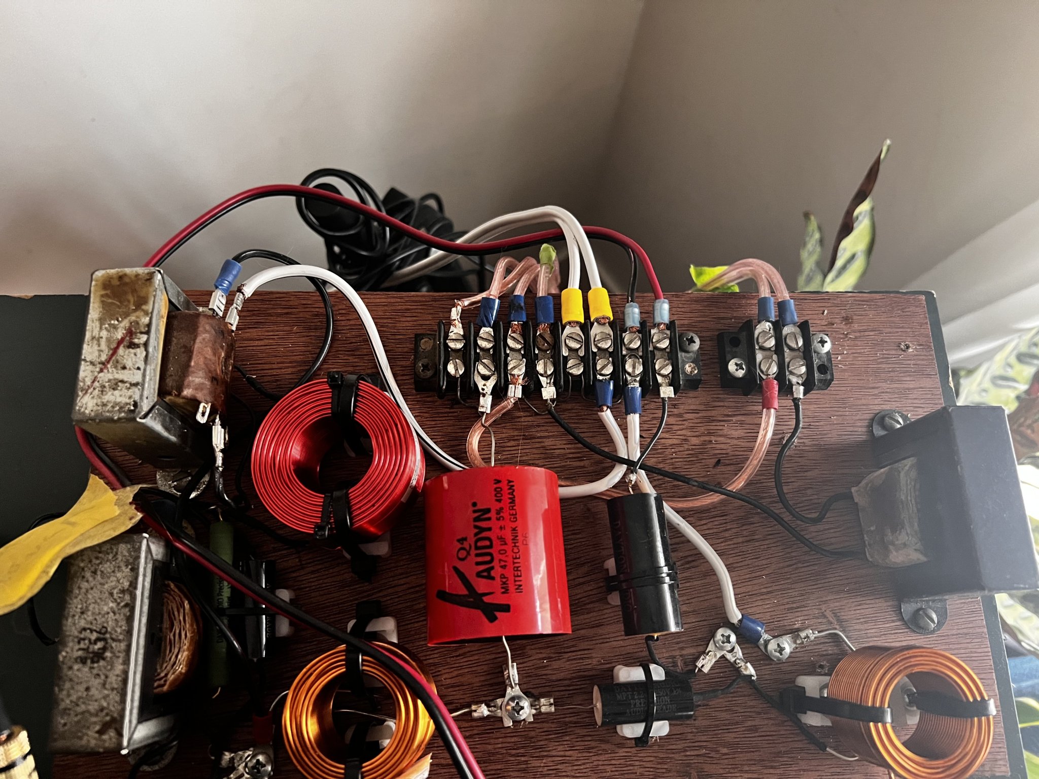

inside, the crossover is a modified ALK Universal, with primarily Audyn Q4 capacitors. The Bass/Midrange is crossed over at 400Hz and the mid/tweeter is crossed over at 6000Hz. I'm also using a Dayton Audio DSP 408, crossing over the woofer and upper horns at 400Hz, but with a 24dB Linkwitz-Riley filter. Additionally, I've added PEQ to smooth out the bass horn, copied from Roy Delgado's settings for the Jubescala:

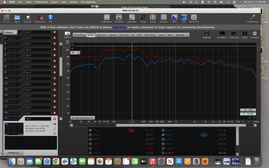

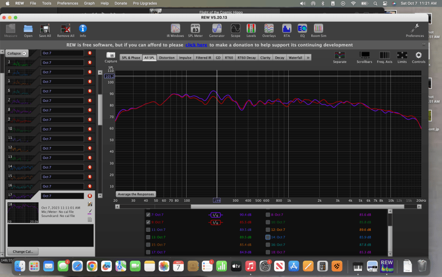

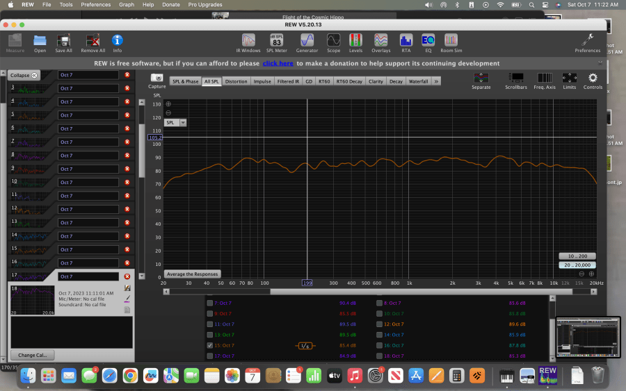

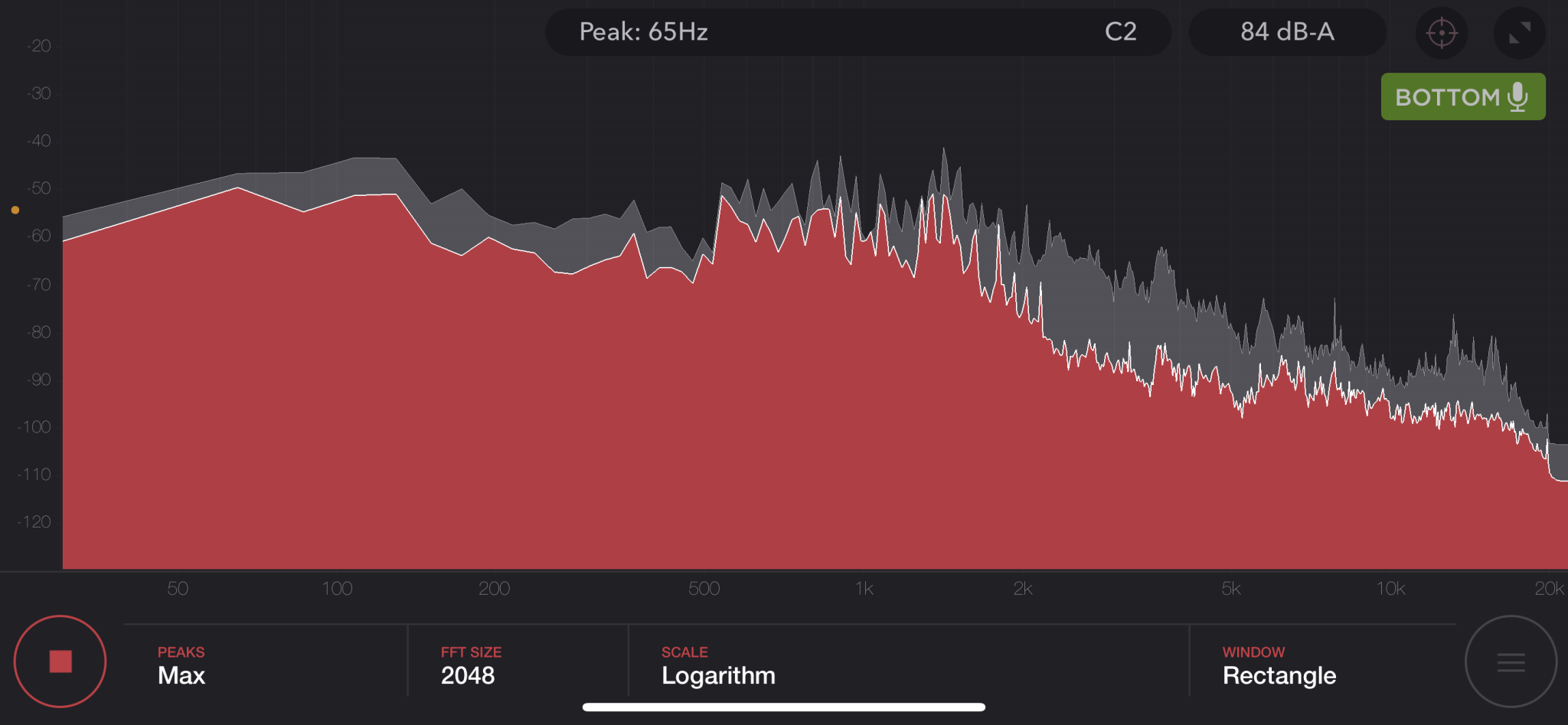

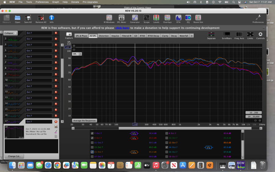

went to do measurements this morning and naturally, the laptop that I use for streaming and measurements, a 2014 MacBook Pro 13, took a dump on me, the trackpad wouldn't click on anything. Fortunately, my main MBP has REW on it, as well as windoze for running HornRESP and the DSP tuning software, so after taking a few moments to find the right cables and USB-C adapters, we were off to the races.

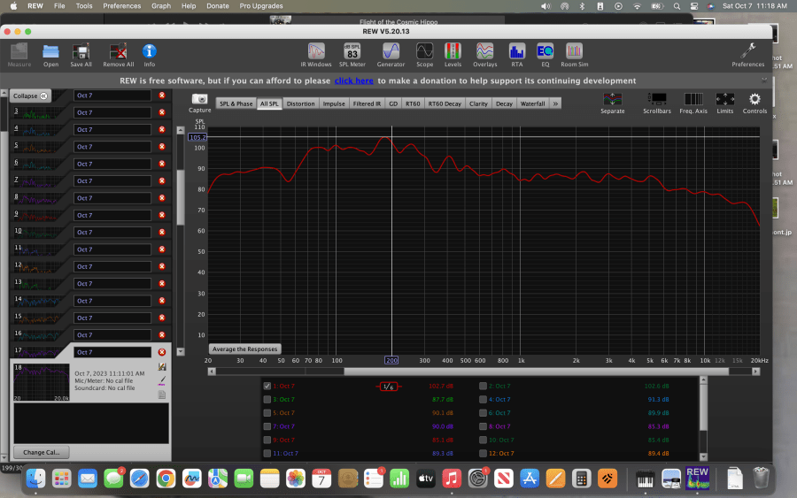

the first measurements showed that my amps were WAY out of alignment. I'm using my 15W Glow Audio Amp Two and a pair of 150WPC Alesis RA-150 in bridged mono mode. It sounded good, but after a week of listening, I started to feel that the bass was a bit much. I was not wrong.
I did a couple runs to align the amps and got somewhere in the ballpark:
I'd also lowered the SPL to annoy my neighbors less at 10 am... I also noticed a few nodes in the bass response that were worth addressing with PEQ. I started with the bump at 183 Hz

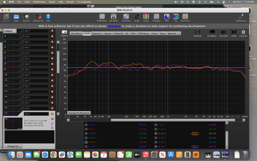

then I addressed the dip around 375Hz
I got that pretty smoothed out, here's the progression overlaid, with the final measurement in orange

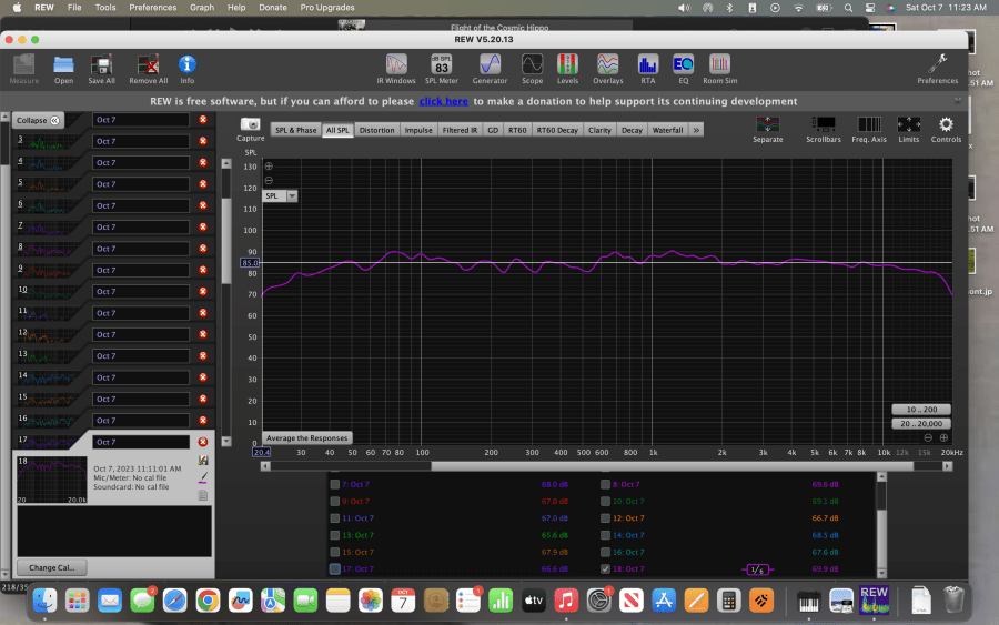

with that smoothed out, the low end fell off more than I liked after 70 Hz and there was a node at 58Hz that I found annoying. At this point, I had 231 grams of weight on the back of the passive.
I added another 77 grams and have a relatively flat response +/- 5db from 28hz to just over 17kHz. I am beyond pleased.
Final PEQ settings are:
55Hz: +11 Q 2.515
87Hz +5.1 Q 3.507
148Hz -4 Q 8.010
155 Hz +5 Q 2.515
183 Hz -8.3 Q 1.693
350 Hz +8.8 Q 5.541
Woofer Low Pass Filter Linkwitz-Riley, 475 Hz 24dB/Oct
Mid High Pass Linkwitz-Riley, 400Hz, 24dB/Oct
mid and tweeter is managed by the ALK universal passive network.
I'll have to admit that I don't really understand damping and Q-factor at all, so I left the settings for 55Hz and 155Hz at 2.515, which is default for the Dayton Audio DSP-408, so that will be my next focus of understanding.
one last thing to address is room response. The previous measurements were from my right speaker, which is more or less in a corner, tilted at 22º, the inside rear corner 3" from the wall and the outside rear corner, 12" from the wall. The positioning is not quite ideal, but that's what I've got to work with in my space. The left speaker has equal positioning, but it doesn't have the benefit of a corner. With equal attenuation and PEQ settings, it's a bit hot and it has a significantly bumpier curve, so I'll have to deal with that next.
