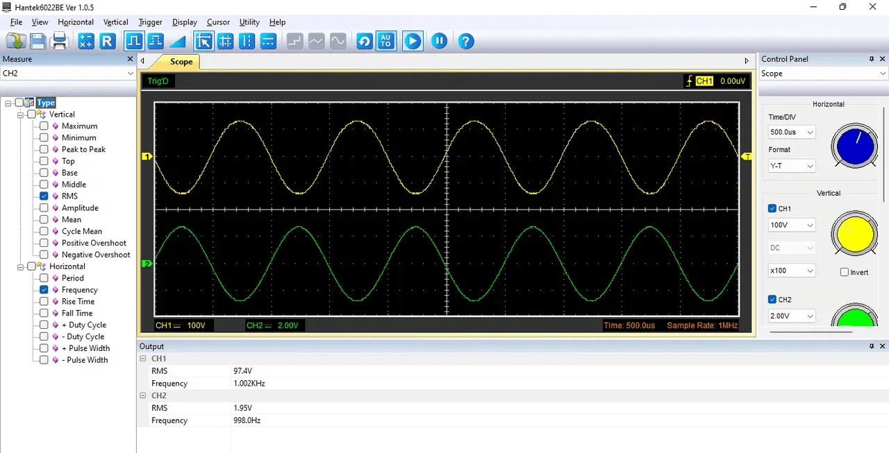

I've also done some experiments with an ixtp08n100d2 using 300V B+, 33k drain resistor, 600R source resistor. 47k gate leak resistor.
Here's a look if anyone is interested. Bottom trace is input, upper trace is output from drain. Not useful in a preamp but would make a good driver for a low mu triode output stage (strapped sweep tubes).

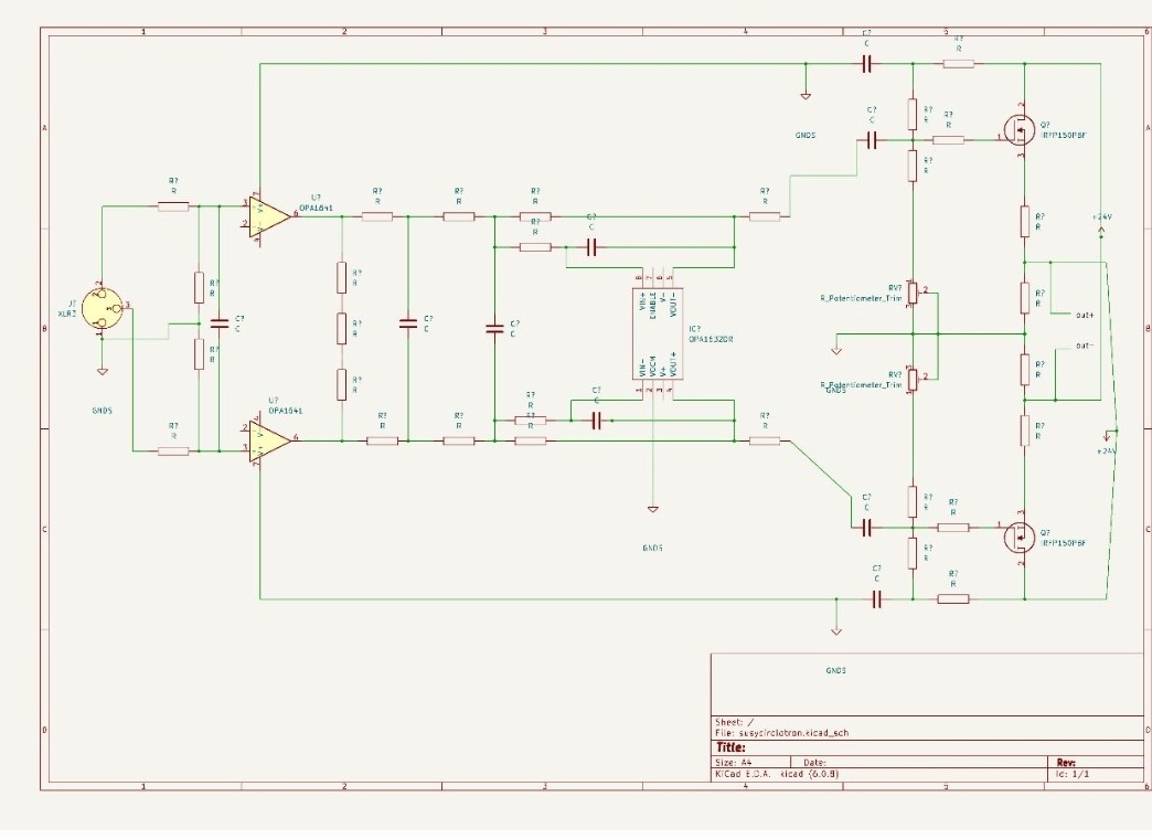

I scribbled something.. Still alot of mistakes but this is a rough idea what I'm trying to do. Since my dac and output transformers are all balanced. If I fail. Nah it's all fun. I just started learning to use the program pardon me if it look bad
