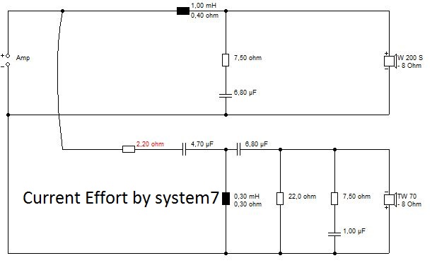

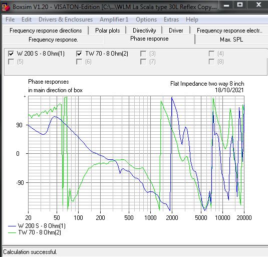

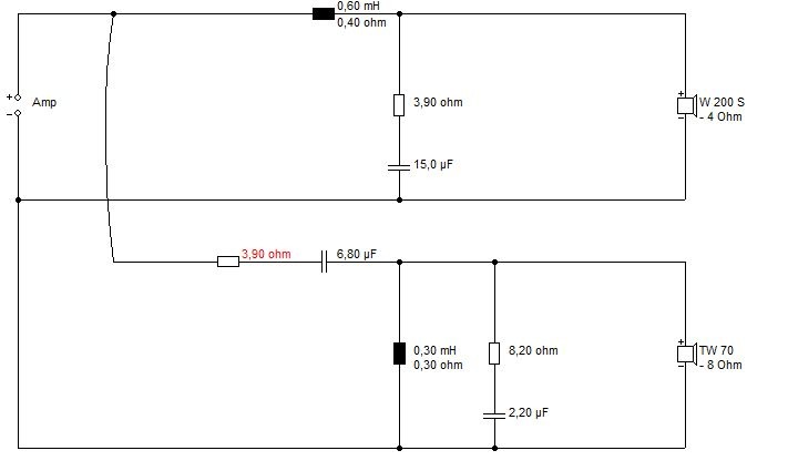

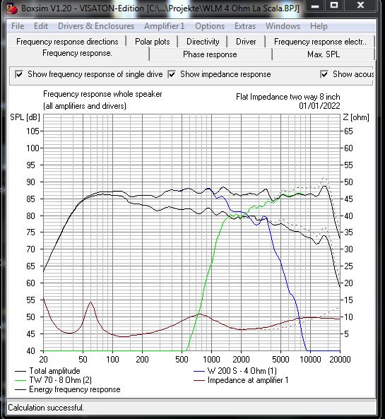

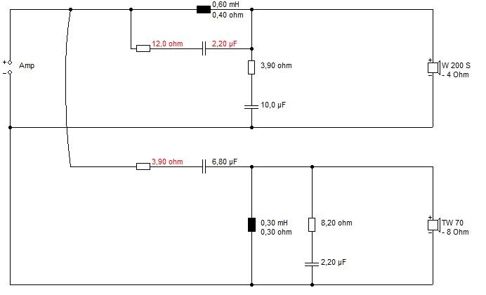

I think we decoded on the circuit below. I am slightly alarmed to find my current effort is third order. But actually models much the same, so I must have known what was doing. I fitted a Monacor HT22/8 tweeter because it fitted my box better. But also works much the same.
Phase might look a bit rubbish to the uninitiated, but is a 90 degree Butterworth style designed to fill the power hole at crossover that more foolish LR4 Phase-aligned designers get.

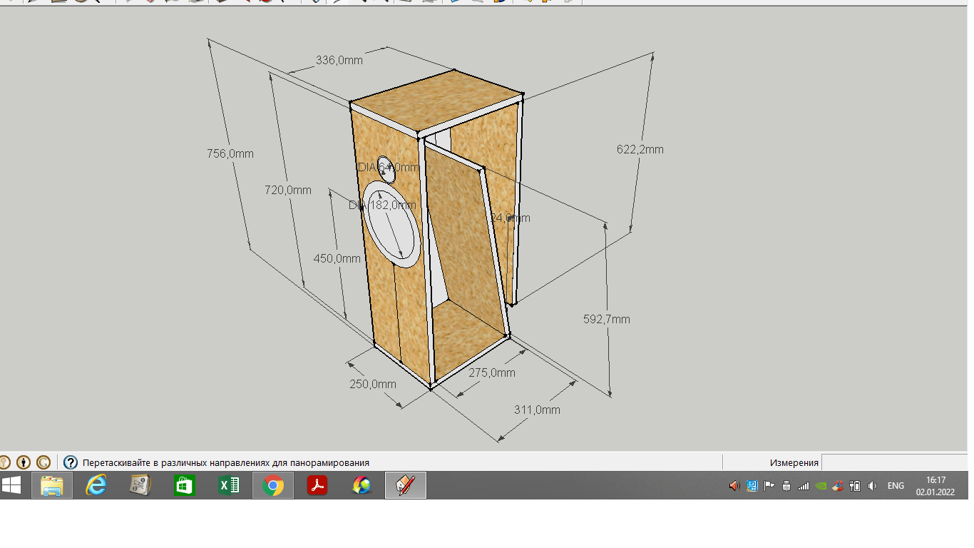

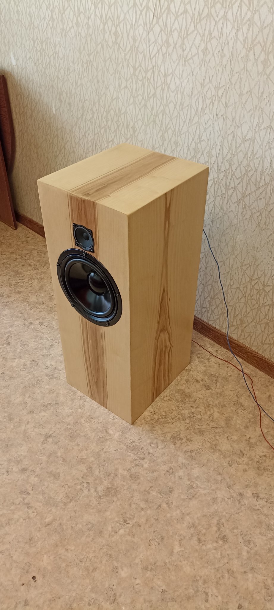

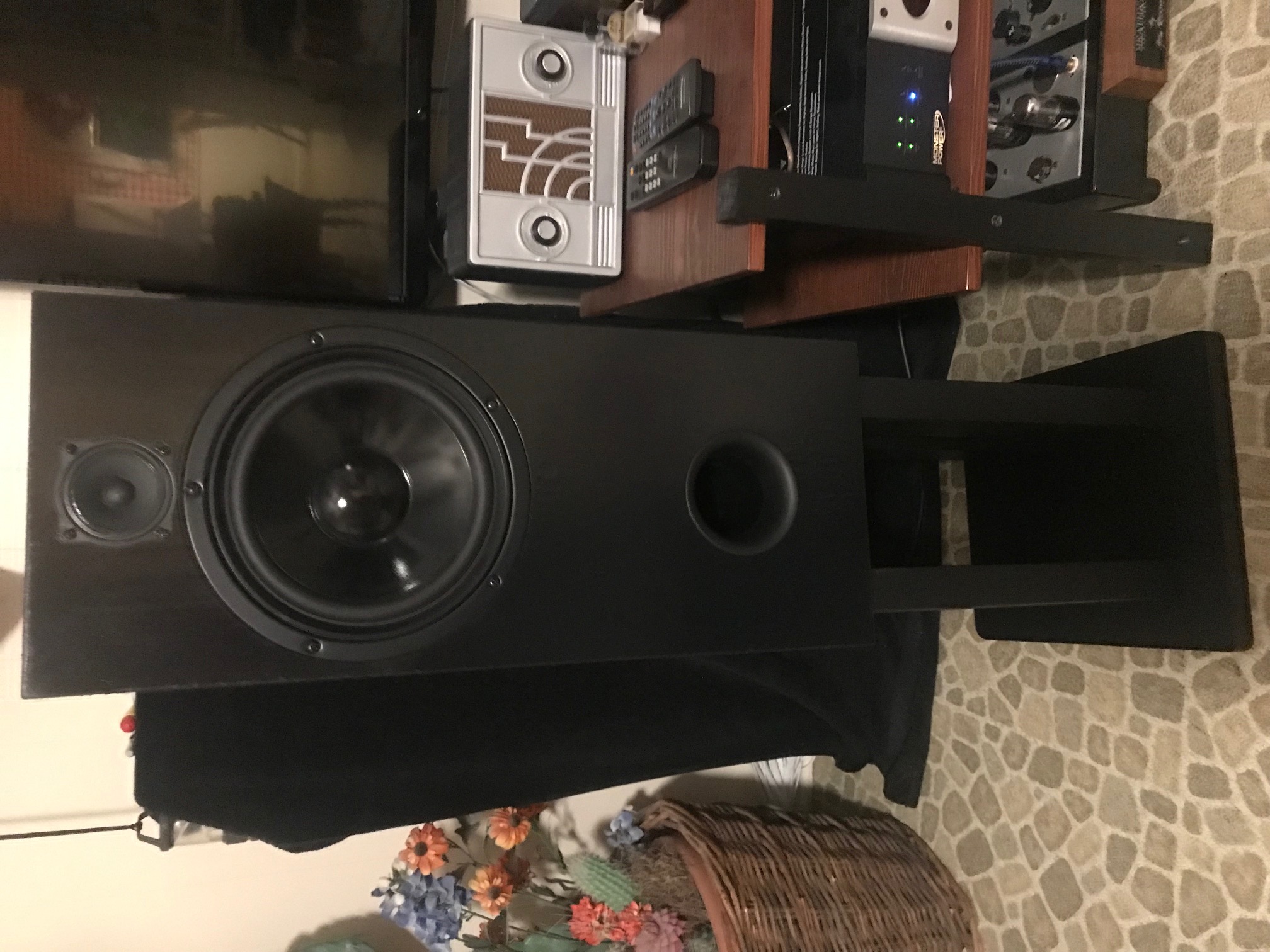

Special thanks to system7 for his help with my latest project. Visaton W200s and Visaton TW70 in a 32 liter BR. He used Boxsim to simulate XO and sent schematic. Sounds great! No measuring capability but I'm liking them. Such a helpful DIY community.
Nice!
Can you share the enclosure details?
Sadly, I didn't take pictures before I closed it up. Outside dimensions are 10" W X 12" D X 24" tall using 3/4" plywood. I'm try to stay away from MDF. I have one brace on all 4 walls about halfway down. Sides, top, bottom are lined with 1/2" felt automotive batting. Port is 2 1/2" X 5". I'm using an 8 ohm resistor for the tweeter adjustment because I don't like bright. It's not soldered in yet in case I change my mind. I used stick on foam strips to seal up drivers. I can't give enough thanks to system7. He spent WAAAAY too much time trying to help me figure out Boxsim and probably got irritated with my ignorance. He is a great guy in this DIY community.
Tweeter 2" from top. Woofer 8" from top. Port 4 1/2" from bottom. Everything is centered on baffle. If you use Monacor HT22/8 things will change because mounting flange is wider and you'll bump into woofer flange I'm guessing. Neither TW70 or HT22 were available in the USA but someone had a pair of TW70 on ebay for a great price. Nothing scientific about driver/port mounting locations other than trying to copy visually the look of the WLM La Scala. I think my tweeter/woofer spacing is even closer than WLM because they added some of cosmetic beauty ring to the TW70

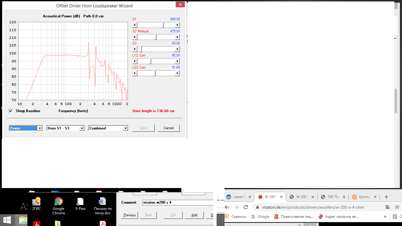

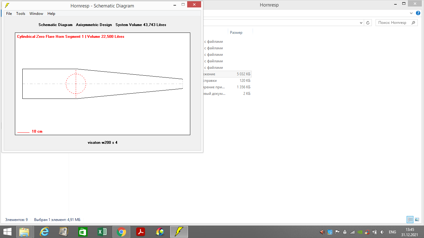

The drivers you used are rated around 88/89db and the graph above indicates a speaker efficiency of around 86db. Are you confident your clone has much in common with the original beyond size?

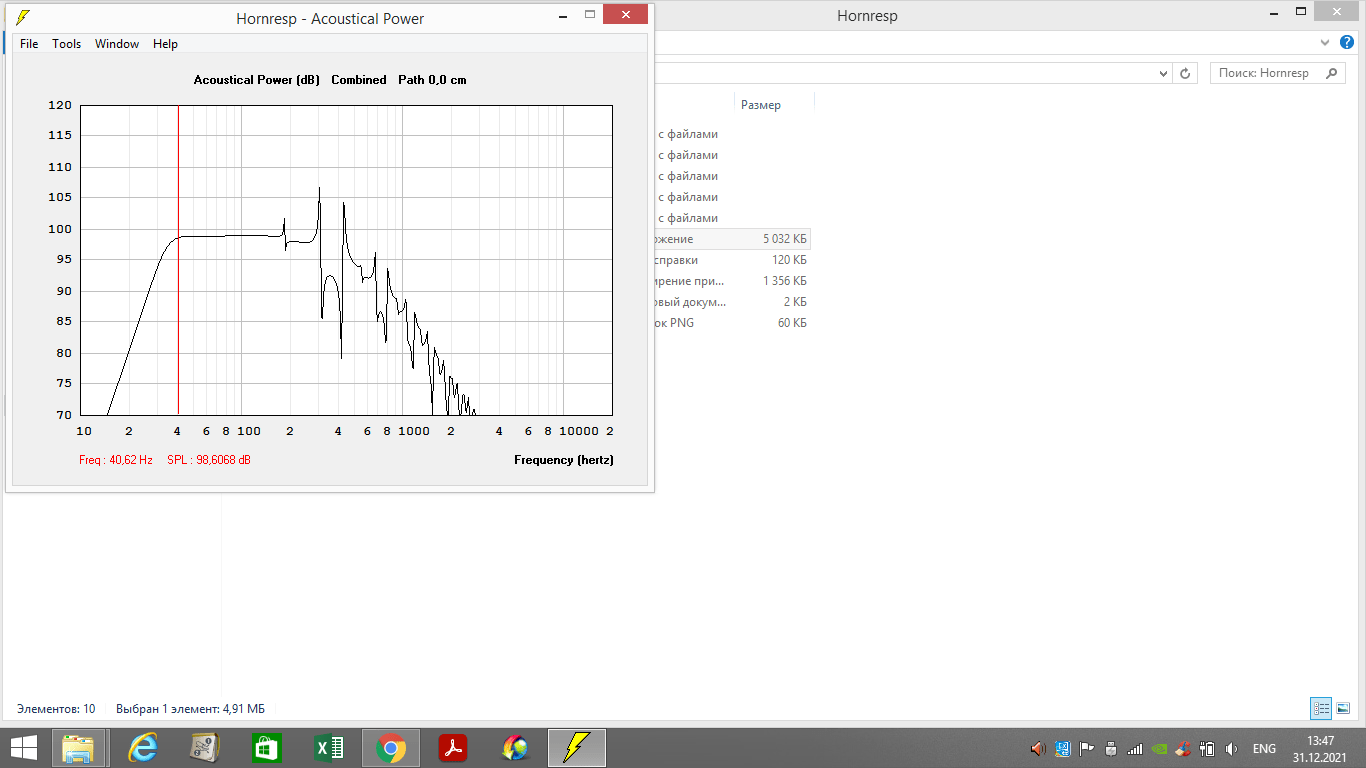

No, I don't have original speakers WLM, I took the parameters posted on the site (https://www.visaton.de/en/products/drivers/woofers/w-200-s-4-ohm), and used them in the program Hornresp.

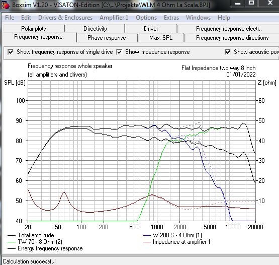

I can't figure out the program Boxsim yet, that's why I'm asking - maybe someone calculated the crossover for Visaton W200s-4 and TW 70-8.

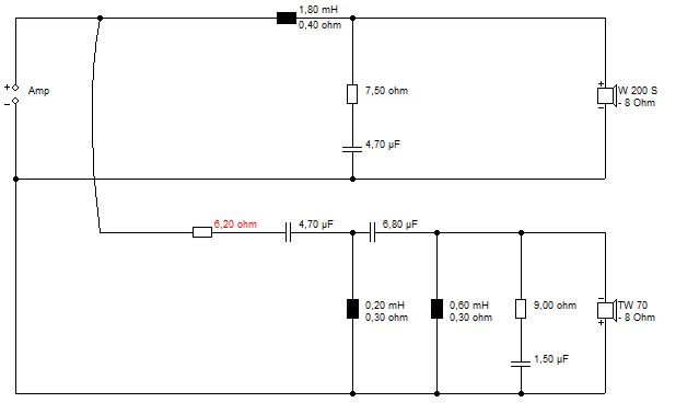

I didn't like that circuit much, as it goes. I think this might be better. The projekte file should work with either version of Boxsim, but the new driver files in 2.0 are different in some ways. Different responses and acoustic centres and maybe loudness.
https://www.diyaudio.com/community/threads/visaton-w200s-tw70.317015/page-3#post-5983380
Thank you friend! Happy New Year! I will collect acoustics using your circuit. This will be my second project, the first was tqwp, I listened to it and realized that I wanted something better. Your project is loaded into Boxsim, all that remains is to deal with the program, thanks.We had a thread about various approaches to WLM La Scala clones including the 4 ohm driver:
Happy New Year to you too. I was just mulling any possible improvements. I don't much like that little bump in the bass at 3.5kHz. That is breakup, and never sounds good. Also mucks up phase.
You can fix it with a cheapish tank notch at 5kHz. Worth trying. I'd also get an aircoil on the bass, since 0.6mH is quite small. Don't spend silly money on capacitors. They all sound the same to me!

Good day! There is no limit to perfection, the frequency response is looking better and better, thank you for your time. Now, having chosen a project, I will buy speakers and assemble a speaker system, I made the final decision thanks to your help in calculating the crossover. As soon as I rolled up the body and counted it in Hornresp. As the production progresses, I will make small reports.
