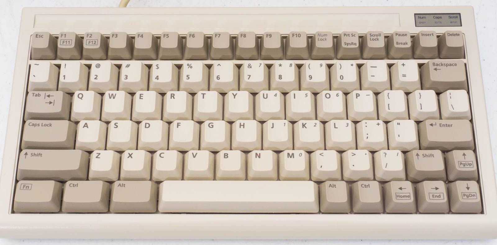

I found a miniature keyboard that is 11" wide which can be used for the odd time when I modify a setup and wish to save it. Most of the time, I expect to recall a setup and just tweak the generator output level. I may be able to stick it in a space to the right of the stack of equipment for storage.

The niftiest keyboard for the UPL - at least for me - is a BTC-5100 with the AT plug. It is 88-keys and fits right in there. They also feel great to type on since they were clones of the IBM F. The only thing is the "misplacement" of the up arrow key - it is not an "inverted T" arrangement like the venerable but outrageously expensive IBM Spacesaver. It's close enough for me.

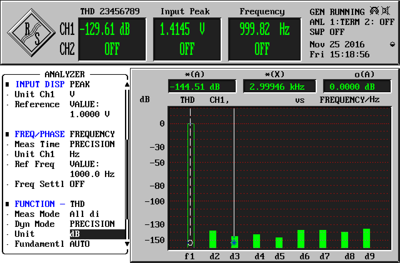

For audio, the one option that makes a UPL truly worthwhile is the B1, the analog Low Distortion Generator. While an equivalent feature is standard on an AP SYS-2722 and accounts for its excellent spec of -117dB THD+N, this feature is an option on all R&S analyzers - the UPD, UPL and UPV. The standard R&S generator is digital. The B2/B29 AES/EBU and B3 second generator options may also be interesting for some but the B1 is the cat's meow.
The attached THD of a 1kHz 1Vrms signal generated by my UPL with B1 speaks for itself. The analyzer was configured unbalanced and without passing through a notch filter. It translates to 0.0000331%. THD+N is in the 0.00025% range.

I paid $2100 for mine (but due to shipping damage, seller offered $800 refund). B4, B10 options. It's superior to my Tektronix AA501 and SG5010 analyzer/generator, in terms of distortion levels. But rarely does a customer amplifier hit the dot triple-ought digit distortion levels. Well, maybe a Hafler power amp, or a Accuphase moving coil preamp.
