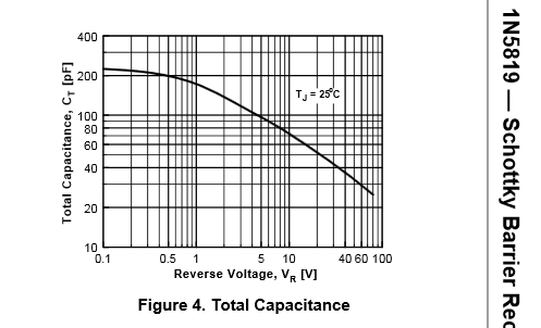

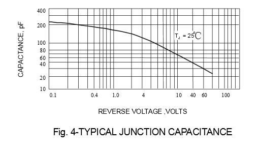

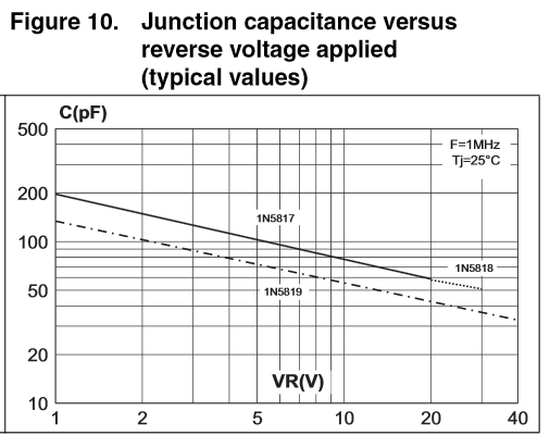

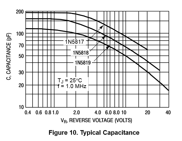

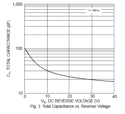

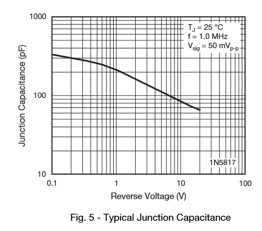

Hi Ed, member Kiriakos says in post#10 that he is measuring an 1N5819 diode, not a 1N914 or 1N4148. I attach the capacitance-vs-voltage curves from several different manufacturer's 1N5819 datasheets, below. To find out which mfr's datasheet corresponds to which image below, hover your mouse over the thumbnail. The mfr name is in the image name.
These (Schottky) diodes are about 100-200pF at zero bias. And their transit times, being Schottky, are incredibly small.
