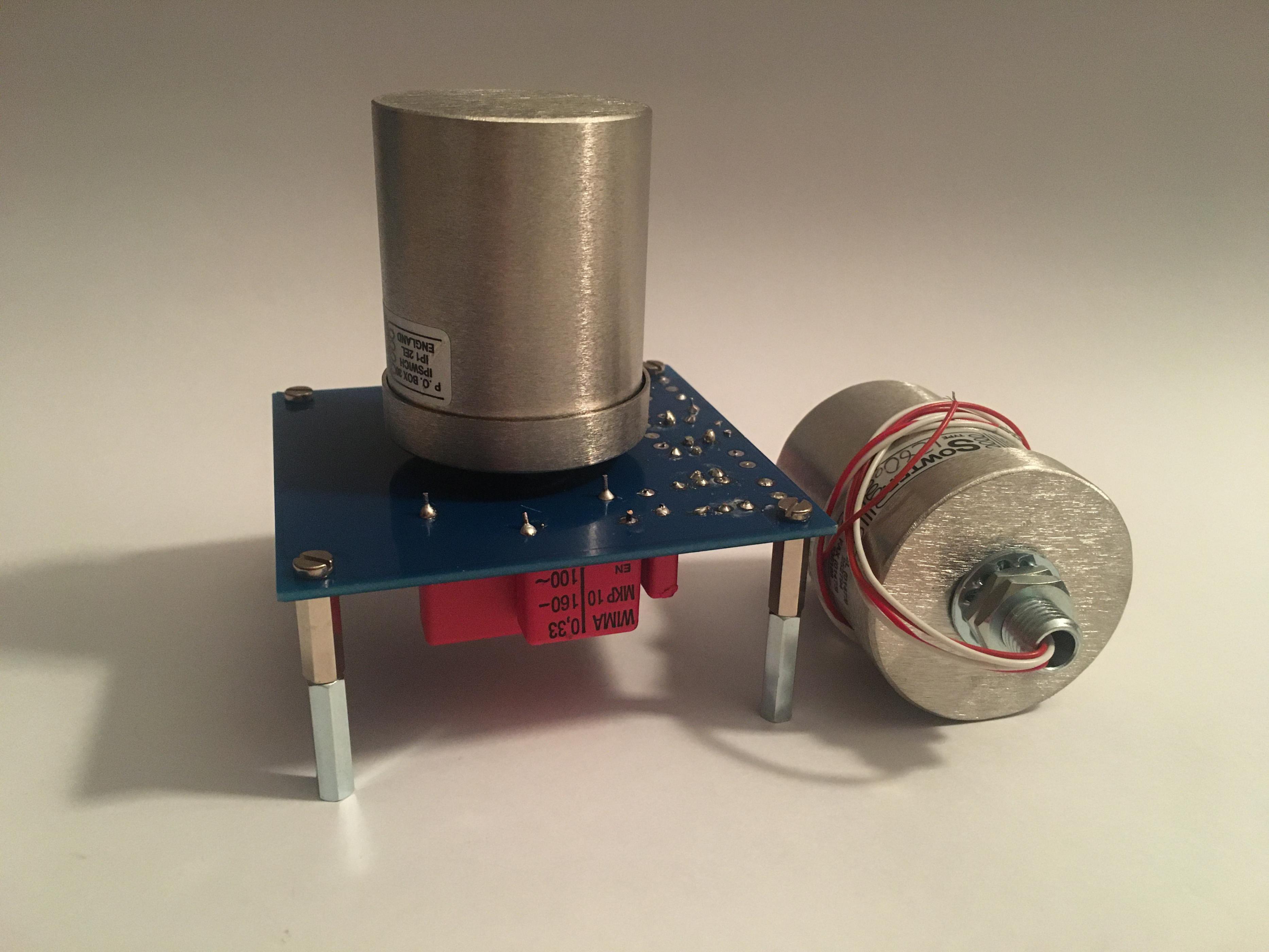

Hi
I am writing some article on Audioreview magazine in Italy about LCR
The first two part are done.
First of all I suggest you the Shishido diagram. It works well. The gain is not so high, around 32-35 dB but the perfromances are fine.
Another solution Is the use of 5965 with same diagram (just to trim the bias point) , this tube has a higher gain of 6922.
Before the writing of article I have done four different proto with different circuits.
ALL are tested on LAB, non simulations, as usual you can find around the world.
The four protos was done with original Tango stuff EQ-2L.
Then I swap to Sowter 1280 who has the two inductors inside with the same value of Tango. And are easy to buy.
In photo the pcb with 1280 and all components for the LCR stage.
It will be a kit soon.
Then I developped a pcb for a full circuit with LCR that now I am working on it to finish and test on lab to write the third part of my article.
The fourth part will be a full trafo LCR with the possibility to work with two types of tube.

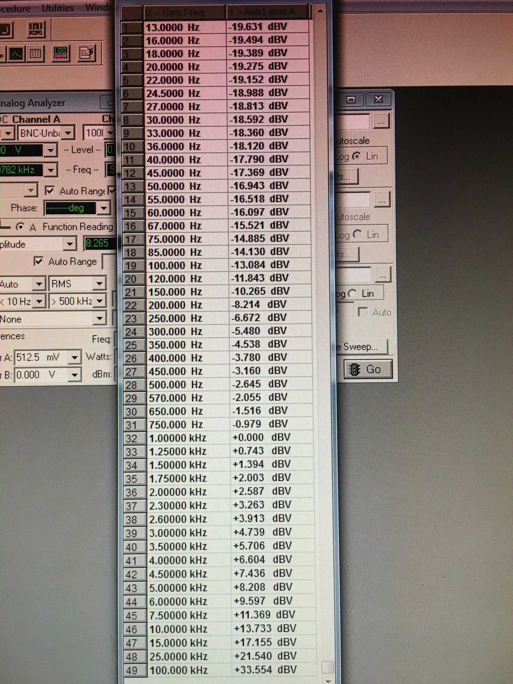

In attach the answer, real answer, of a Tango LCR only, following the indication of Tango about the Zsource and Zload
In case I can send other real test.

The Riaa test I use is done by Audio Precision ( I have two Audio Precision in my lab, Sys One and Sys Two) and it is perfect.
Because it was wrote by software.
So I can use both 20 ohm and 600 ohm without any change on frequency answer; in some case I have adapted the Zsource for different test
In attach the table.
