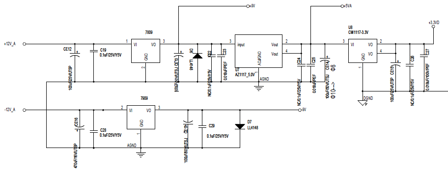

Here is a partial schematic of the power supply of my CD player.
+/-9V are for I/V and LP stages of the DAC. 5V and 3V are for PCM1795.
Would you add some LCRs / ferrite beads between 9V and 5V regulators and between 5V and 3V regulators to better isolate noise?

Definitely not. This is not working at RF it is DC.

Words of warning might/would be that three terminal regulators are prone to 'hooting' if you do not use the 'right capacitors' in the right places. The 7809/7909 have low value decoupling at the input.
More importantly look at what is going on at the inputs and outputs of U7 and U8. It is hard to see from the picture but the original designer has added a pair of low value capacitors in parallel.
One is labelled PEF which might indicate a Polyester film. 0.018uf or 180nf. The others seem to be 1uF Y5V ceramics. Similar loss to X7R but dirt tolerance and therefore likely to be cheaper... You really need to look at the impedance curves.
The values and/or selection of dielectric type do not seem to be arbitrary.
Someone appears to have thought about this but of course if the OP knows better then they should get their hacksaw out and go for it. Do not under any circumstances look at the data sheets for the regulators concerned.

My thought was that due to finite impedance at regulator output the digital rails are far from DC and rail noise corresponds to the load from the digital circuit at higher frequencies. The current draw from the 3V regulator supply would then generate noise at the 5V supply output, and so on.
In other words, the LCRs / ferrites are not there to help getting rid of the ripples from the power source but to reduce the noise coming from the load affecting the upper stream circuits. The noise may come from spiky current draws or from capacitive coupling. Since the rail impedance is provided by the regulator and the capacitors, the LCRs / ferrites would not increase the rail impedance anyway so cause no harm.
Of course, I can be wrong because I have not done any simulations / studies / measurements, and my electronic knowledge is at beginner's level. My source of information and/or misinformation could have come from reading posts in this forum. 🙂
It is just a thought. If you can give me a good lesson then I can learn something from you.

I never assume that I know better than this (reputable) manufacturer. I question because I don't understand and I want to learn.
But in this particular case, I sometimes doubt if parts of the circuits of this player were contracted out to some graduates to do. There are dozens of parts that are not connected, indicating that they might use the same prototype boards for final production. For an example, the 0.1uF 25V Y5V ceramic after the 7809, the AZ1117_5V and the CW1117_3V regulators are not connected.
The manufacturer's datasheet for AZ1117 recommends 10uF tantalum at the input and 22uF tantalum at the output. These caps give a very smooth, flat impedance that don't get below 0.3R. They may be required for stability of the regulator. So why the schematic has those ceramic caps but not installed?
CE14, the input cap for the 3V regulator, is placed possibly 80cm away from the input of the regulator! Is that OK? I would put it right in front of the regulator. or am I wrong? why do we want inductance in front of a regulator input?
I do read the datasheets. Amazingly, while the datasheets indicate tantalum caps at the outputs, the player has 0.018uF polyester caps at the output as well as 100uF low ESR/impedance caps nearby, as well as 0.1uF X7R MLLC SMD at the chip on the same rails! and the player is working!

The output impedance of the regulator is already inductive, and probably more inductive than a ferrite bead.
The regulator provides DC. Dealing with digital signal currents is the task of local rail decoupling, not the PSU regulators. If you have a problem (and you don't know that you have a problem?) then you are looking in the wrong part of the circuit to solve it.

Thank you for your insights. I am now convinced that there is no benefit (or perhaps there is harm) to change the circuit.

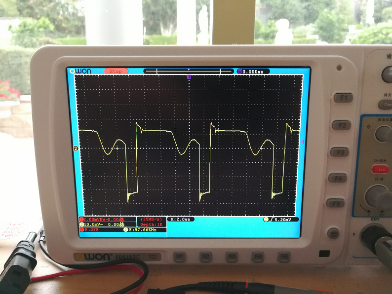

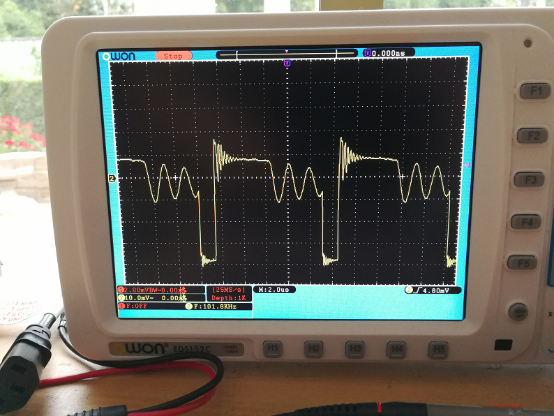

I like to play with things. Below are the two images of the SMPS power supply before and after my modifications on the Blu Ray same player. This is the stage before the cascaded linear supplies to the DAC. I did the modifications a couple of years ago. I am now doing it again on my second player and I hope I can do better this time.
Ooooh.... RC snubber on the primary of what looks likely to be a Flyback Converter. I wrote some embarrassing babble about similar on a Forward Converter...
Snubbing The Forward Converter
Your first ring at turn off is leakage inductance in combination with primary/switch capacitance. The second ring is primary inductance with combination with primary/switch capacitance.
You can also see ringing when the switch is on. That will be leakage inductance with secondary/diode capacitance when it is off... That's why I guessed Flyback. You might want to put an RC snubber across that one as well.
This is the sort of thing where you can make meaningful improvements without too much stress.

Would you be happy with the results of the damping of the first 2 ringings? Any further improvements could be made?
As for the 3rd ringing, there are multiple of secondaries. So I need to get all of the snubbers right before I can see the resonance(s) gone. I didn't know the exact capacitance of the diodes and didn't measure the leakage inductance at higher frequencies so I was unable to calculate the snubbers correctly.

Looks like you have nailed the important primary side one. The result does modify the lower frequency ring out but as suggested since they are on the same node you cannot really do much more.
In respect of values there is a way of getting quite good answers. I did derive the sums for this but that was some time ago and my brane has been addled with too much alcohol to try again.
