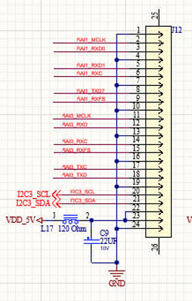

Today I've been working on a new DSP board that should allow for some really interesting new projects.
I have exposed the maximum audio and clocking I/O available on the i.MX 8M Plus QuadLite MCU - currently $38.
Target is low latency Linux kernel with custom kernel/linux DTS overlay config and an app to configure the audio I/O.

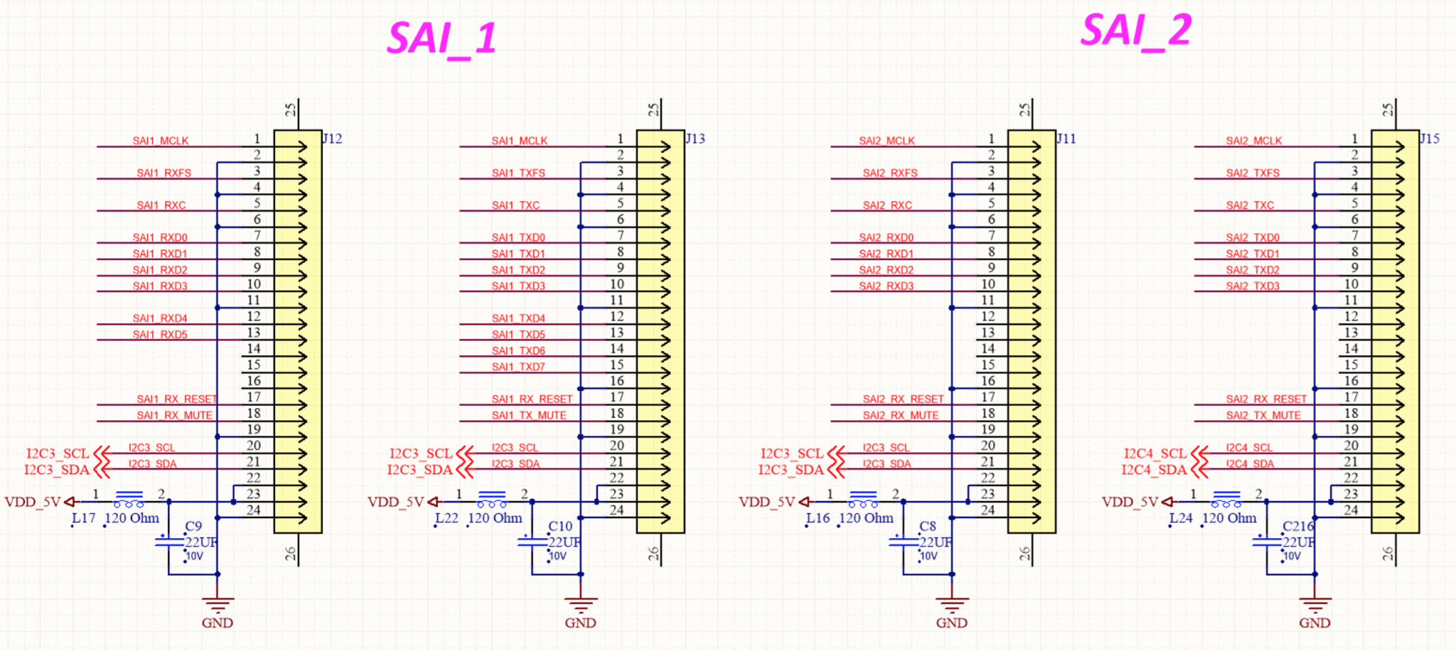

1). I have to use RMII to do this. SAI_1 shares some pins with ETH pins. No way around it other than use 100Mbit RMII interfaces.
The TI DP83826 seems on paper to offer very latency between transactions. It would be interesting to compare a round trip to RTL8211.
I have exposed MCLK i/o or SAI_1, SAI_2, SAI_3, SAI_7. These pins could tx/rx clocks to any of the SAI units.
2). I have the basic dts from the pin mux tool. I'd need to pad out the relevant fsl,pins in the dts with the new pin map.

At the moment six connnectors ( FH52-24S-0.5SH ) along the back of the board provide
J12 = SAI_1 TX - 16 ch
J13 = SAI_1 RX - 16 ch
J14 = SAI_2 TX - 8 ch
J15 = SAI_2 RX - 8 ch, SAI_7 TX RX 2ch
J16 = GPIO, I2C, SPDIF_IN, SPDIF_OUT
J17 = MCLK1,2,3,4
Each connector has a 5V 1.5A capabale supply rail & i2c from the boards DC-DC. For example.
Still working on the pin plans though...
