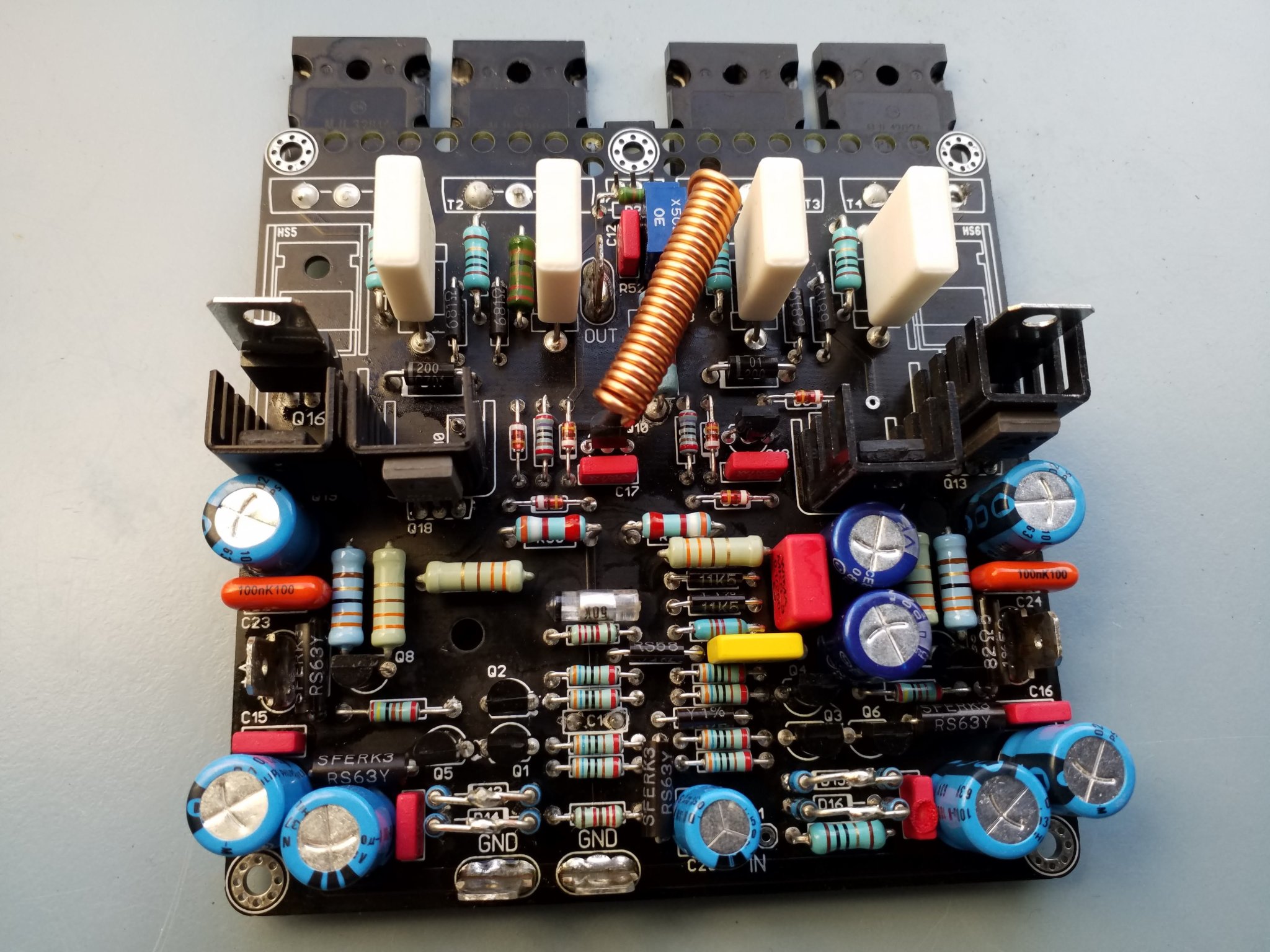

I built my Leach Amp with fast, modern power transistors NJL3281/1302. The Leach Amp was designed about 1/2 century ago and had to work with power transistors available at the time, that are much slower than what we have nowadays. Its negative feedback network was designed to have a crossover, so that the driver and the final stages are not encircled in the feedback loop at higher frequencies, in order to ensure stability. This means, however, there is intentionally less loop gain available to reduce the distortion produced by the driver-output stages at higher frequencies, where loop gain is most wanted.
I found that with modern power transistors that have high Ft, such crossover arrangement has become un-necessary. I have since simplified the feedback network in my build to have the feedback loop encircle all stages, and the amp would maintain a healthy stability margin (in simulation). I also experimented with Transitional Miller Compensation feedback topology with my build, with success. It seems to me that fast, modern power transistors greatly open up the potential of the Leach Amp.

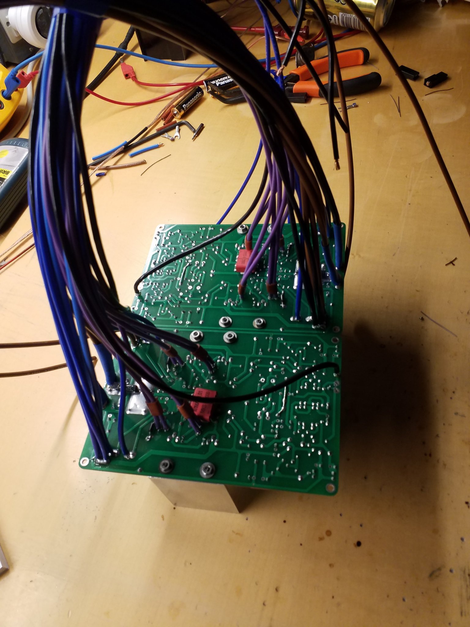

I retrofitted a dead Hafler DH220 with the version 4.5 Leach board and 4 pairs each channel of the NJL (I think? -- the 5 pin version with the built in bias diodes) and cranked up the bias. Verified with scope that no oscillation is there with the original frequency compensation values. Currently driving a set of MMG and I have to say I agree with maudio, it probably is not the best but really very nice to live with -- nothing glaring and it seems with the higher bias the bass got better.

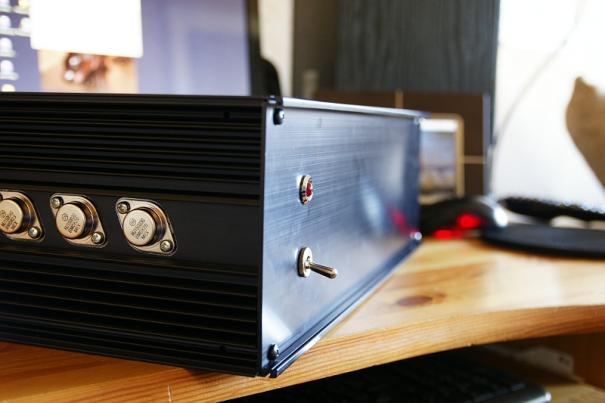

Both still perform well and I like the look of the TO-3 transistors.🙂

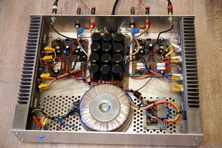

Here is mine, not a Leach amp but an Ed amp: http://www.edgrochowski.com/electronics-museum/stereo4.html
The symmetrical layout reveals its origins. 🙂
I estimate 0.015% THD, and one-third that at normal listening levels. That is low enough to be inaudible. Most critically, my amplifier has a dead silent background at any volume setting.

Built mine over 25 years ago and it is still in daily use. It's built to original specs but I omitted the overcurrent protection and added a dc servo, so I could bypass the electrolytic cap in the feedback network. It blew away quite a few other commercial 80's and 90's amps that we compared it to, Rotels, Nad, Arcam, Marantz etc.
It's been incredible reliable, never opened the case since it was built. It has proven rock stable in even the most demanding loads such as big plate stator ESL's.
