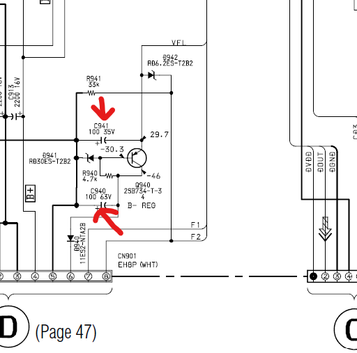

I have found in the service manual that there is a test point for display functions. Temporarily earth a point on the main board and it either lights up all the dots at the same time or goes into some sort of sequence. I haven't worked out quite how to control or trigger the test sequence so I'm reluctant to have a go just yet. In any event, knowing the major bits are not available for swapping out I probably won't bother with the test.
The manual actually seems to suggest you can do this via the front panel and initiate a display test.
I couldn't just see the bit you mention on grounding a test point. What page?
Whatever the issue, it will not be any of the chips, I could virtually guarantee that. More likely would be caps related to the display rail. The marked 29.7 volts looks in error in the manual and should be negative or -29.7v
The test procedure and test point is mentioned in section 5-2 Key and display check mode on page 14.

Thanks, I don't know how I missed that page. I think its 50:50 whether caps or the VFD itself are at fault. It might be worth leaving the display fully lit for a while and seeing if it improves at all.
I think the caps will be standard electrolytics. Substitution (or bridging them) is the only real test. They fail by developing a high E.S.R. (equivalent series resistance) that cause the rail ripple to increase dramatically. They will probably look fine.

I ordered the two suspect capacitors Mooley mentioned above from a source in Bulgaria and got them installed today. No luck I'm afraid. Made no difference but looking on the bright side, I didn't do any damage while I had the player to bits, and I did take the opportunity to replace all three belts. The door opening belt was already showing a bit of reluctance to work reliably.

They had to be tried or proved good but this is one where I suspect the display itself is tired. As you have two similar machines you could check all the voltages relevant to the display and compare them but it is really a job for a scope. It is not just the voltages that are important but also the way they relate to each other, for example the filament volts will be tied to the higher negative display rail but offset by a defined amount.

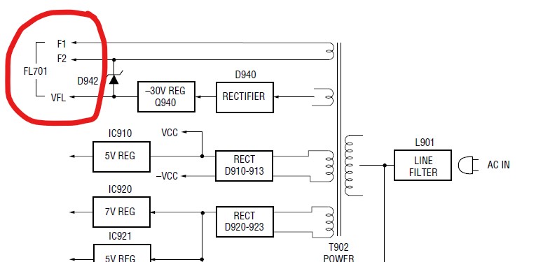

I thought it was a little odd that the caps I replaced were nowhere near the display board, they were on a completely different board diagonally opposite to the display board located at the back of the player. Any way, I have one last strategy. If I can find somewhere to place a "wanted" ad for a S/H display I might find someone who is breaking (parting out) a CX350 willing to post to France. There seem to be a lot of these players for sale in the US and some are being sold as spares or repairs. Buying a full unit at $100 or more + shipping + import duty would easily exceed the price of a good runner here in Europe but a small board would be affordable.
That is normal, all the power supply stuff that derive all the supplies needed for the player as a whole will be located elsewhere to where the those supplies are needed.I thought it was a little odd that the caps I replaced were nowhere near the display board, they were on a completely different board diagonally opposite to the display board located at the back of the player.
The block diagrams are good for showing how and where things are derived. The Zener diode is used to 'float' the filament (heaters) by a defined voltage relative to the -30 volt rail. Finding a good used example is probably the only option really. You might try tweaking that a little. Perhaps confirm the Zener has a voltage across that is close to the marked value of 6.2v Would going a little higher make it brighter... I'm not sure tbh. I think higher to increase the differential voltage between the two points.
