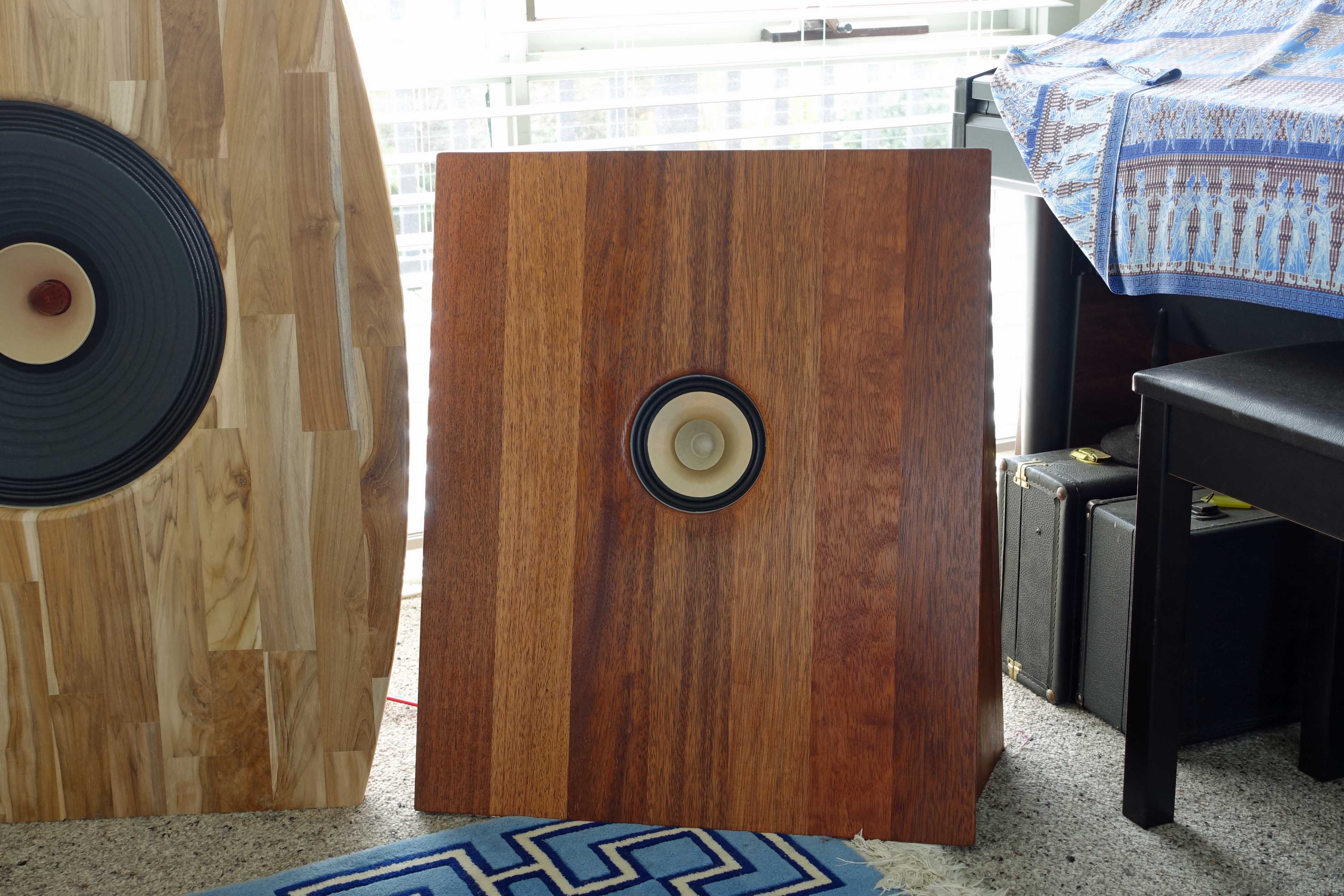

ljfont - I built some OBs with Lii Audio's predecessor to the Silver 6, their now-discontinued F6. Lii Audio sent me a pair of those for free while waiting on some bigger drivers. Anyway, these were my first OB speakers and I made them to test my carpentry skills and the OB concept. The baffle is 600mm wide and 720 high, built from 26mm thick finger-jointed merbau, with little hinged "wings" on the back, 200mm deep at the bottom and 75mm at the top, which double as prop stands.
I'm listening to Buddy Tate right now (Blueglow Kegger SE KT88 12 watt amp made during lockdown) and I reckon they're pretty good. Not bad for free (they used to sell for $60 - see here: Lii Audio Full range speaker 16 cm Diameter (6") F6 2 Pcs - Lii Audio, unique speaker, amplfier, quality and cost-saving parts for HiFi DIY.)
I'll admit that a listener, not a measurer, but these compare well with my Tannoy 15" Gold Monitors (my father bought new in the late 60s, in Lancaster boxes), my focal 714Ss, my Kef Q7s, and interestingly, my now-arrived Lii Audio F-18s in big Big Betsy style OBs.
If the Silver-6s are an improvement on these old F6s, then I expect you would not be disappointed with them on the right open baffle. But then again ... I can't too hear much above 10khz, so YMMV. Have fun and stay safe!

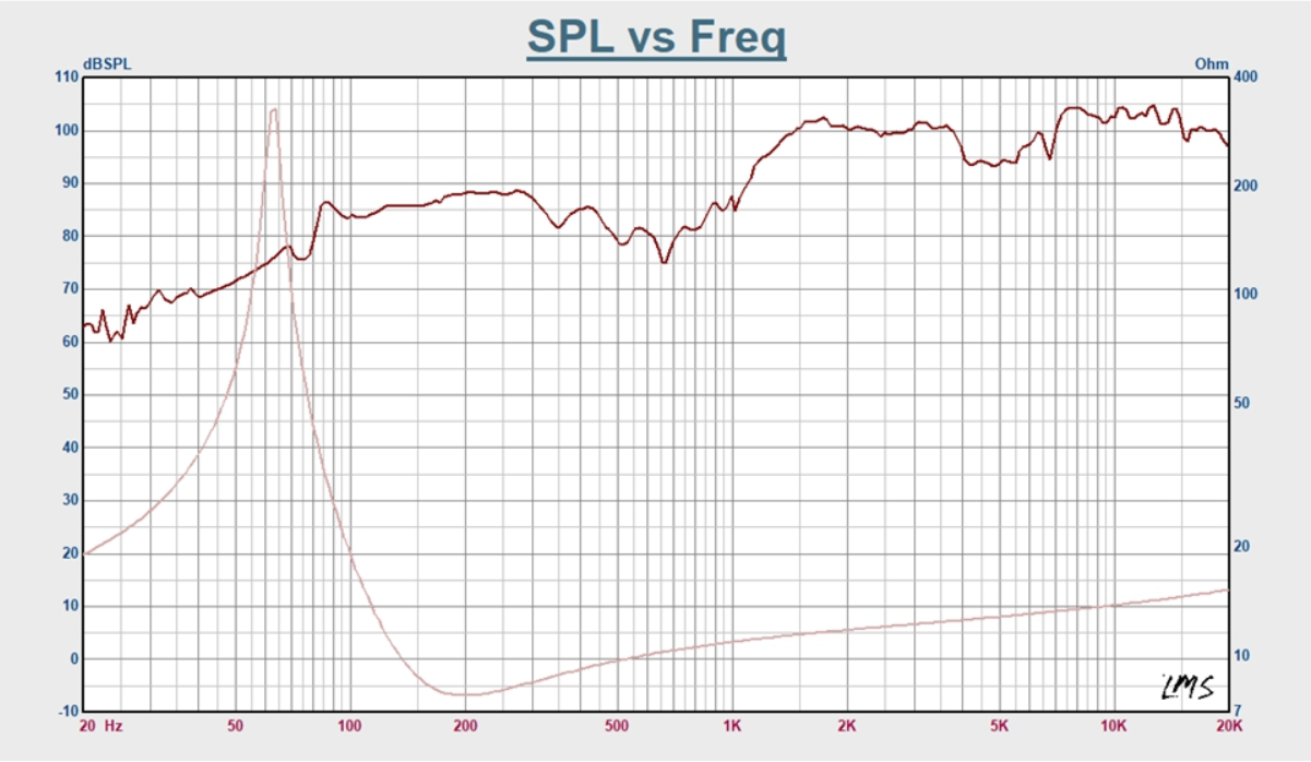

FYI/FWIW, the S6's cone with its regular, but non circular, flex 'rings' is radically different enough from any typical wide range driver's that predicting /comparing to others regardless of brands/models that I'm guessing an 'exercise in futility', ditto there's likely no frequency response because to smooth it out will require making it as useless as some of the pioneer's 'broad brush' hand drawn plots, ergo it's a 'caveat emptor' choice for me, at least for now.
To paraphrase Superintendent Hastings from Line of Duty: Jesus, Mary, Jospeh and the little wee donkey, that FR plot does not a pretty sight make. Assuming it's accurate (just assuming, without prejudice) it might make an acceptable large format cone tweeter above ~1.5KHz. Possibly.
Simon, Lii says "Superb Scale Soundstage with New Imaging" and "When this one is played, you will feel being submerged in music". How is it?
As an F15 owner, I feel compelled to ask.
For those curious, here's the aforementioned FR plot of that Silver 6
😱 Thanks! 'Shades' of Lowther, AN and their ~clones! 🙁
As I feared, lots of diaphragm critical mid band 'ripple'. 🙁
Worse, it 'ramps up' right in the critical 'whack', 'tinny' [1 - 2 kHz] BW: Interactive Frequency Chart - Independent Recording Network

jjasniew - I've just completed the F18's open baffle and mounted the drivers - I've not even oiled the timber yet, so its' early days. The baffles (pictured in post 4) are 33mm solid teak, 1000mm high and 800mm at the widest, leaning back at 6.5 deg; they have a solid timber base but no wings (I hope to experiment with wings later, as I think they might tighten up the bass a little) As presently placed (less than 2 feet off my window wall) the drivers are brand new and sound good. There are great highs (a nice surprise to me, up to my 10kHz top), a full rich middle where most of my music is - great voices, and a pleasantly strong bass, but not overly punchy so far. My SE amp has no tone controls and the F18s seem to work well with it and the mid century jazz that I like to listen to - making a ton of volume from it's 10 or so watts. They are less directional than the 6" OBs and fill the room better (but still with some beaming, but I mostly listen seated in the one spot anyway) - so yes, they're a bit like a huge pair of headphones. I am happy to give them more time ... So far, I'm comfortable with my $500 spend - and they certainly look the part! I bought them because - as my father said - "a good big speaker beats a good small speaker every time"!
