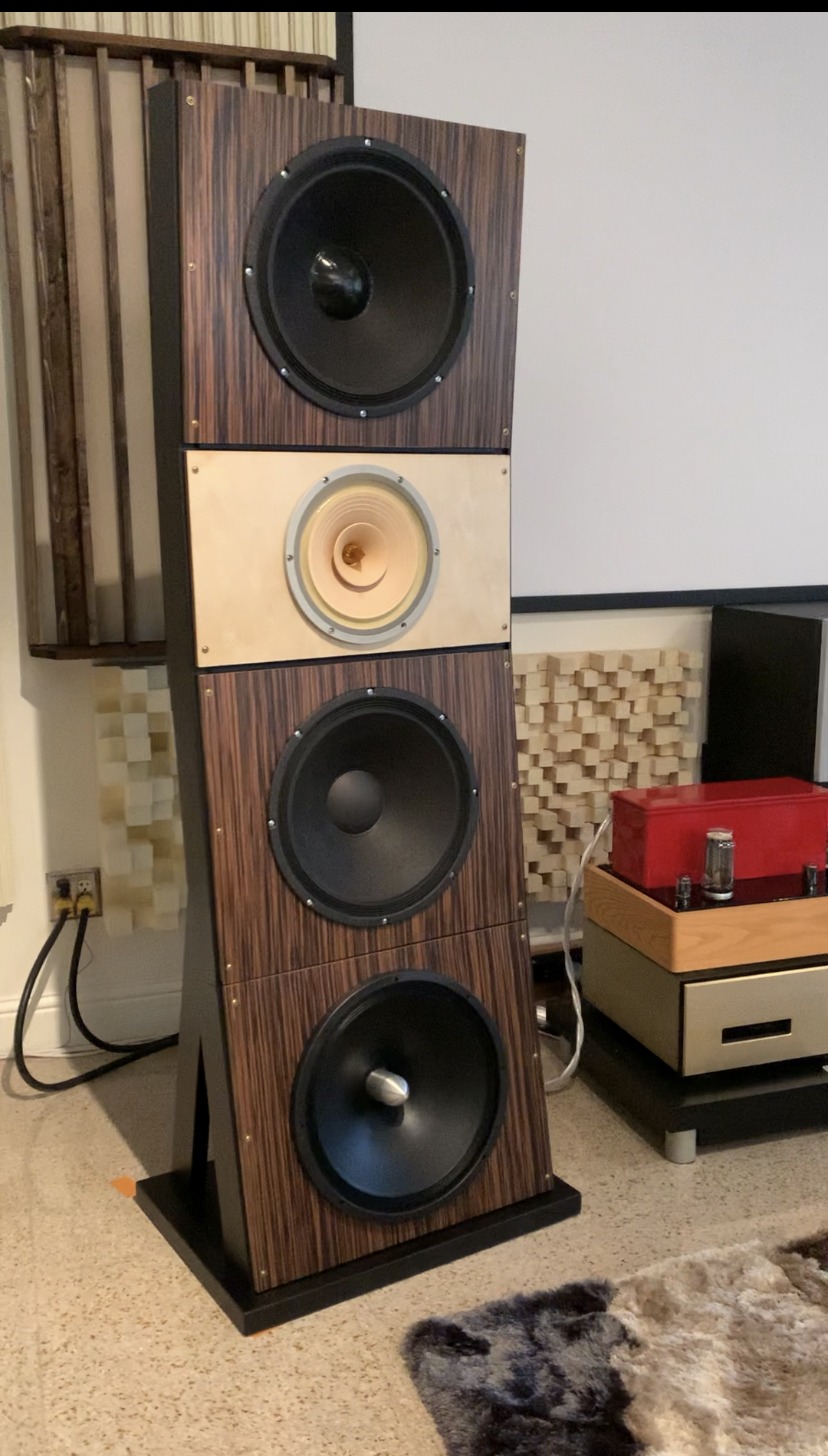

I have a pair that I made a PAP trio clone with. It’s a very quick and detailed driver. Needs a compensation for the rising hf but was very easy to integrate with helper/augmentation woofers at 220hz. I was bitten and upgraded to the Crystal 10’s and have been extremely pleased. The 10’s are smoother than the fast 8 and tick more boxes for satisfaction and balance for me. I’m selling my trio clones as I just finished my larger system. I think they are an insanely good value. I hear the cabinets are very good for the 10’s and the Decware crowd loves the cabinet implementation with the Silver 10. They have many versions too and seem to change specs frequently. I have a friend with the fast 15’s and it’s amazing how balanced they are as well.

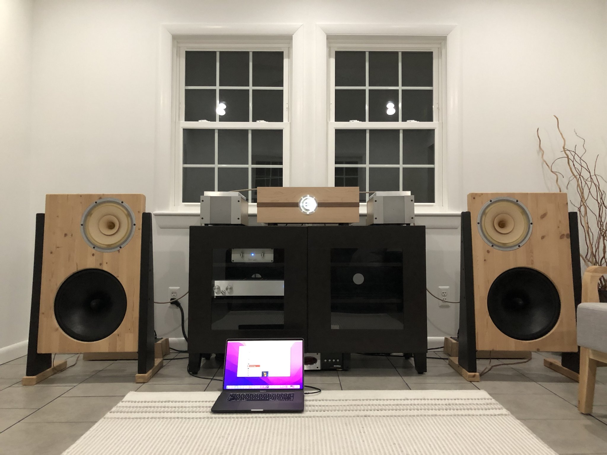

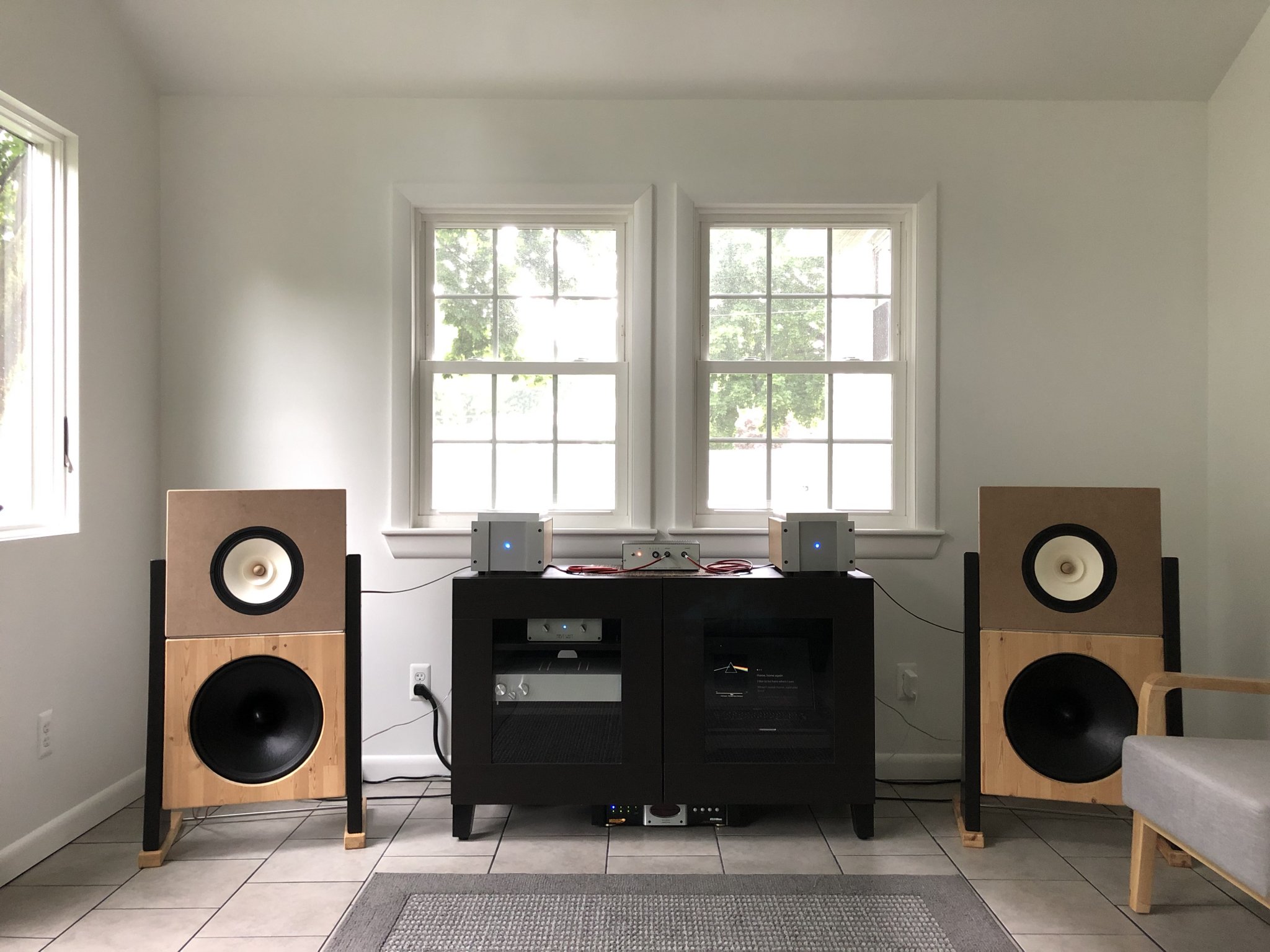

Enjoyed my Crystal 10 for quite a while in my OB.
Recently went through another renovasome Sonido FC that were too reasonable to not to try.
Changed over to a modular upper panel and pushed things to mimic Leonidas dimensions and design a bit more.
This was a project I built with scrap wood and IKEA shelves I found out to the curb several years back. It keeps evolving and getting better.
The Crystals will make an encore on a bigger upper panel like the Sonido.
