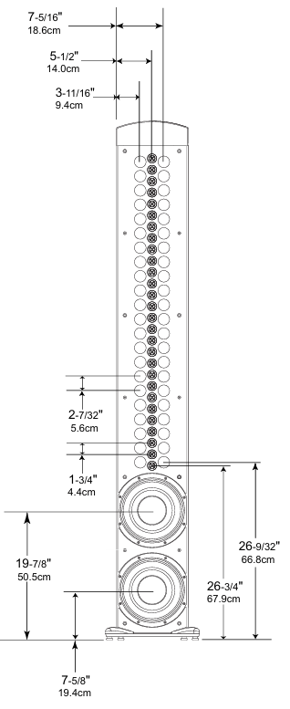

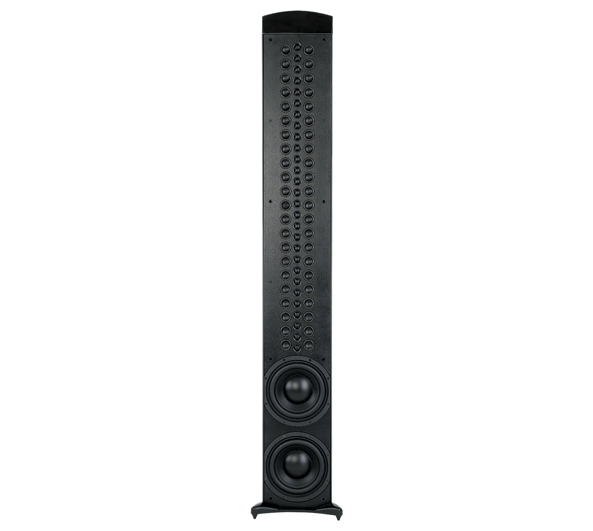

McIntosh XRT1K
"Two columns of twenty-two 2” black titanium midranges flank a column of twenty-eight 3/4” black titanium tweeters forming a tri-column line design."
"CROSSOVER FREQUENCIES 250Hz & 2kHz"

Macintosh avoids the most severe interferences by placing the drivers extremely close to each other and crossing the mids over very low (250Hz is a challenge for a 2" mid dome). There is still lobing because they failed to xo the tweeters low enough. They have learned from that, their current models got only 1 tweeter and 1 mid line, which reduces the lobing and they try to avoid it to be too noticeable by the positioning guide. If you don't follow it (ie switching the left and right speaker), it sounds a lot worse. You can still measure the horizontal lobing/interference. That shows that a big name (MacIntosh, JBL, Klipsch etc) does not grant speakers which are that perfect like the ads promise.

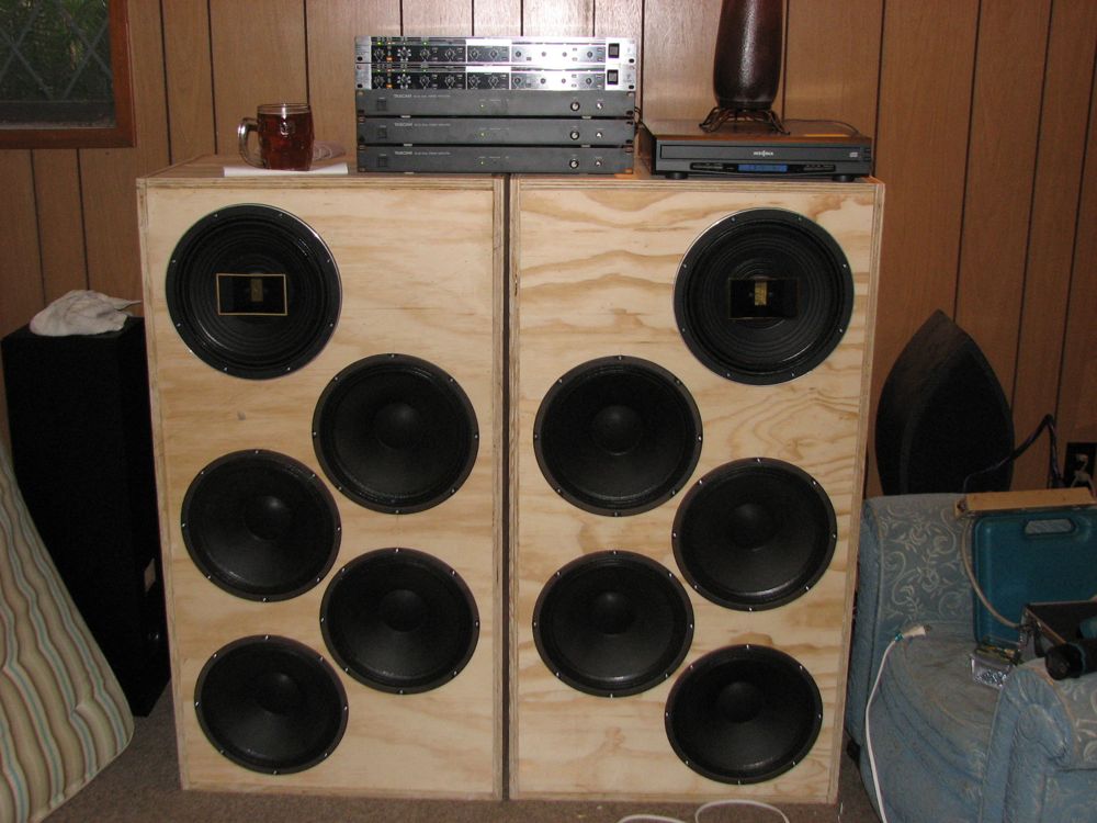

If that were presented to me, I might suggest you stagger the drivers so along that one row, you place the next row in between the set of drivers, so you end up with a zig-zag effect. Something like this, but on a small version of course. Either way, it's only a means to an undesired end, really. With woofers, it's not so bad. The higher frequency you go, the less you will like the effect.

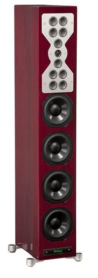

McIntosh XR100their current models got only 1 tweeter and 1 mid line
https://www.mcintoshlabs.com/products/speakers/XR100
"Midranges: Eight 2” Inverted Titanium Domes
Midrange Tweeters: Two 2” Inverted Titanium Domes
Super Tweeter: One ¾” Titanium Dome"
"Crossover Frequencies: 300Hz, 2kHz, 8kHz"

On these, they applied what they've learned too. The lower mid drivers are side by side in a

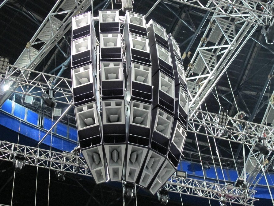

They can, if they have very precise controlled dispersion, like in the horn cluster picture. The MacIntosh do not have any dispersion control horizontally and vertically it's the properties of the array which controls the dispersion.

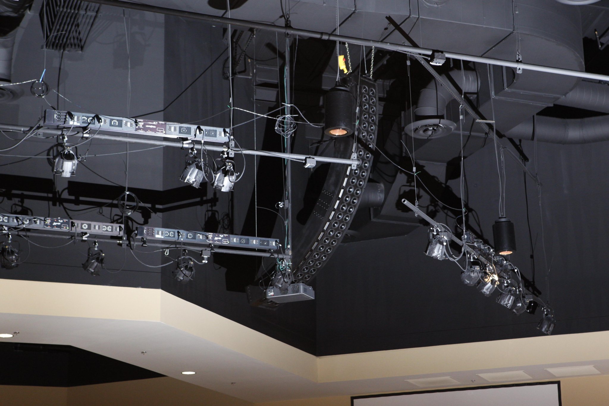

Here's a picture from Don Keele's official website. Perhaps you could explain what's going on here with the double row..
That looks like a CBT array with horizontal lobing (which most LAs have too). Just because someone of reputation does it does not make it automatically great. Audio is about compromises, whoever did that had very likely other problems or priorities. Or just ignored it.
Alone the fact it partly disperses directly into the metal air duct and lowered ceiling should show that installation is anything but perfect.
