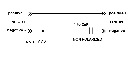

Try add a capacitor on the amplifier line-in negative side.Do you guys have any idea how can I fix this or what is going on?
The negative of line-in should not connect to ground, it is a differential Input stage.

@chrisng from what you say, I think your suggestion of using a capacitor is to isolate the signal right? I just didnt understand how should I connect the capacitor... I should connect it in series with the line input GND? If so, which leg of the capacitor should point to line input ? The negative or the positive leg of the capacitor?
If that is the case, my suggestion might not works!I double checked right now, I disconnected the mini amplifier from everything (PSU and line in cable) and the GND of the line in is connected to GND of PSU (0 ohm resistance).
However, I think it's worth trying, the capacitor should be bipolar.
If you don't have a bipolar cap, you can use two electrolytic caps in series
"-"+"+"-" to form a bipolar cap, two 2.2uF cap in series will give you 1.1uF.

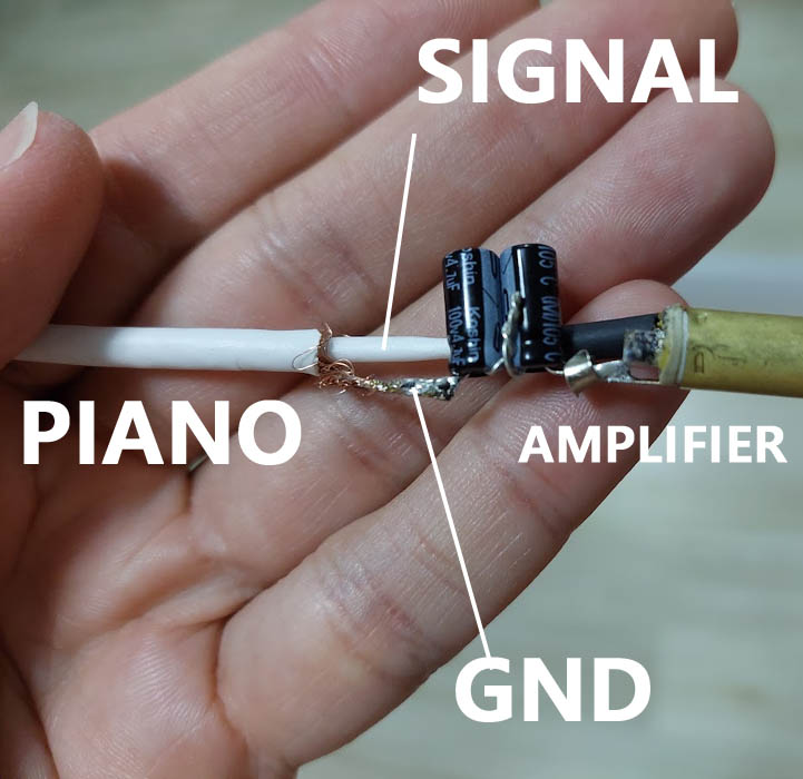

I did what you said and it worked!!!!!!! UHULL!!! Using just one power supply, everything worked. However now I have lots of humming/noise on the speaker connected to the mini amplifier.
I didnt have a 2uF bipolar capacitor, so I took 2x 4.7uF electrolytic capacitors and connected them in series with the GND of the line in and line out. Image below. Do you know why I am having lots of noise? Thanks!
