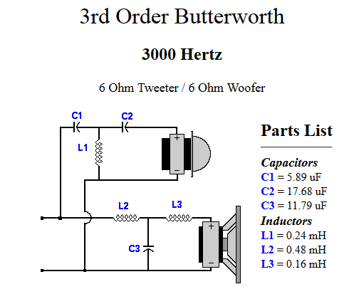

I been trying to calculate Butterworth 3rd order PLLXO LC.
The approach I am using is standard filter tables to lookup L and C values.
Typically for these are: 1 2 1.
Then denomalize for frequency and input/output resistance.
I can verify that my calculations are correct using various filter calculators and other examples.
Things get funky when I compare results with crossover calculators, they seem to be using different normalized values as a starting point: 0.5 1.333 1.5555 in this case.
What am I missing here? is there something special about crossovers that I am not considering, I suspect it something to do with dissipation factor?
Thanks,
Rafal

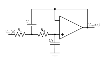

Why not take a standard opamp circuit?
Trying to keep silicon out of signal path as it is all tube system. I am using miniDSP with JMLC alignment and are happy with the results so would like to try it with passive crossover.

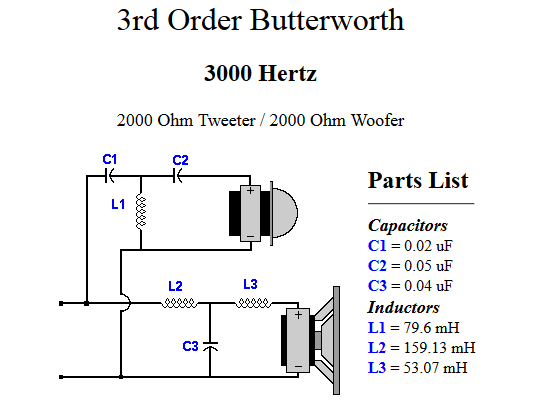

I just ran the idea of passive filters into, say, a 2K input impedance of an inverted op-amp. It's ludicrous values for chokes! 😱
2-Way Crossover Calculator / Designer
160mH is going to be about the size of a car-battery. And dubious on linearity. Never mind that it will probably act like a radio antenna. You'll be picking up the BBC's Radio 2!
I used to build op-amp audio filters about 40 years ago, so excuse me if I am a bit rusty. I used to use TLO74 or NE5532 devices with a few smallish capacitors and the usual resistors. No coils at all needed.

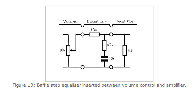

I think it's OK to use line-level bafflestep correction which is just an RC filter:
...160mH is going to be about the size of a car-battery.
10k minimum is more realistic, but even the Marchand ones use a 5k termination on the board (meaning you need a really low Z output on the pre. Because they need to handle very low current, they can use very skinny wire and be cored. A look at the Marchand chokes will give an idea of what is possible (XLRs on the box will give a sense of scale). It might actually be cheaper to buy this than to get a set of 1-off chokes.
An OpAmp uses feedback. An RC only PLLXO is possible but with no FB 2nd order is kinda droopy, and really needs a HF amp with high input Z (>50k or so). 1st order is very doable. We use it often.
