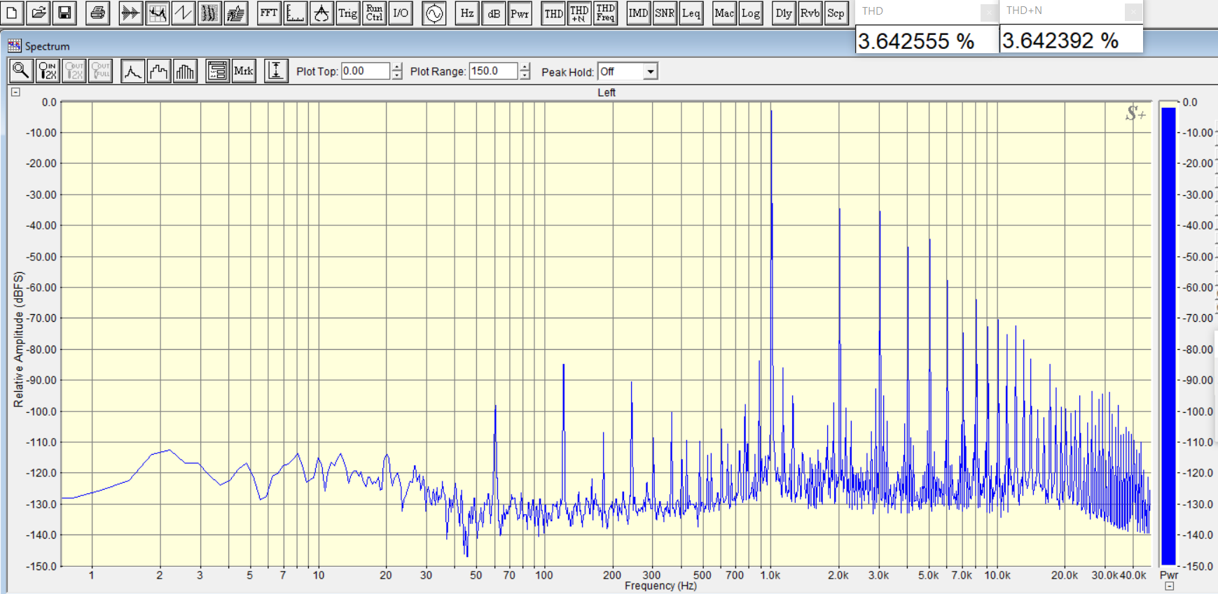

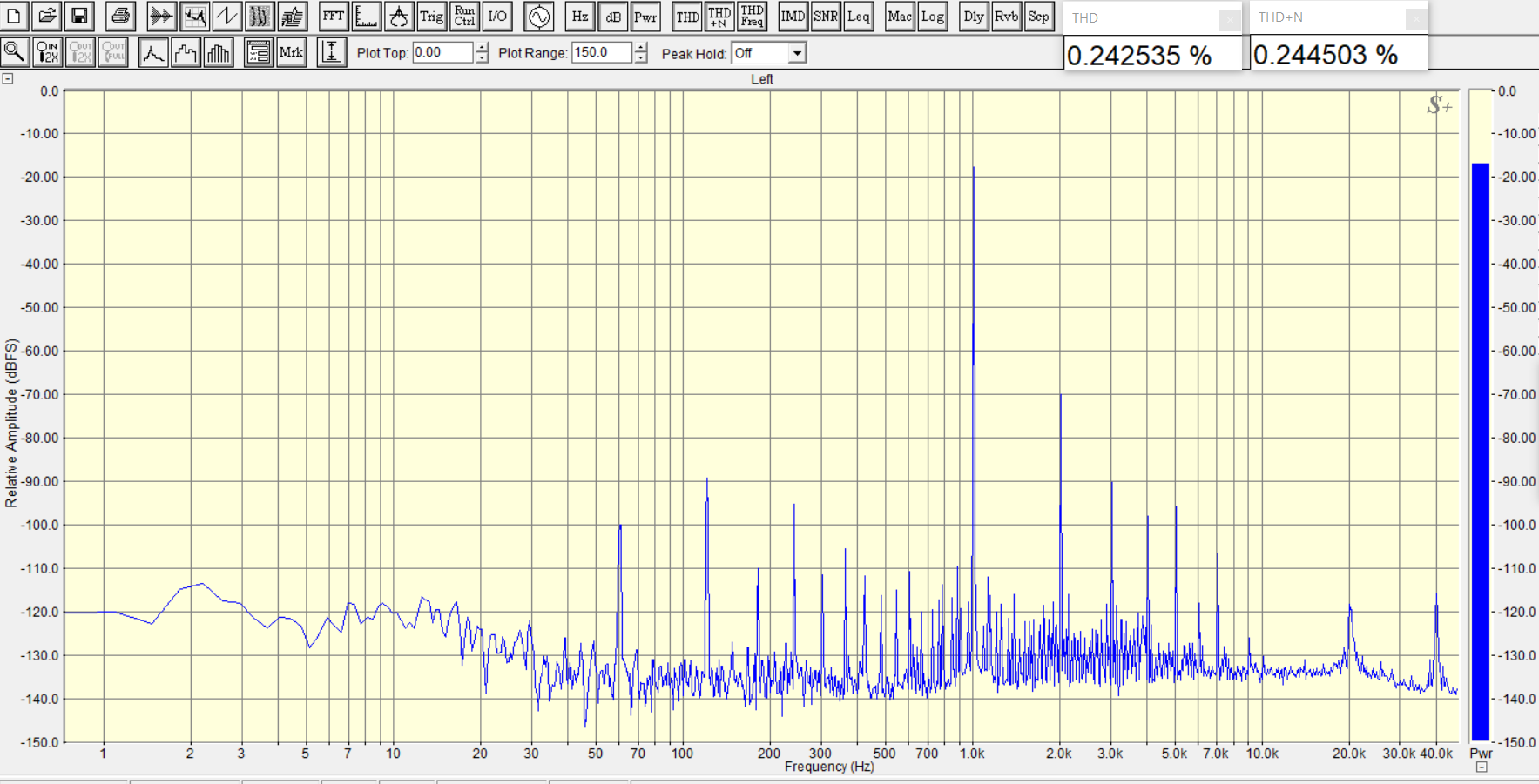

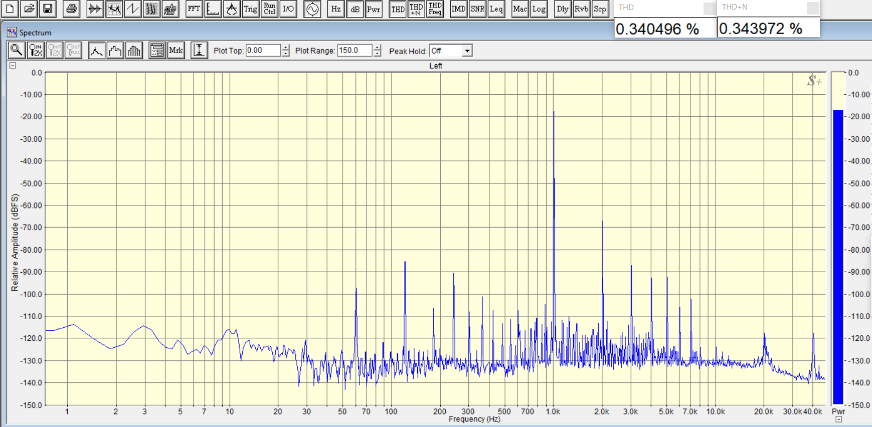

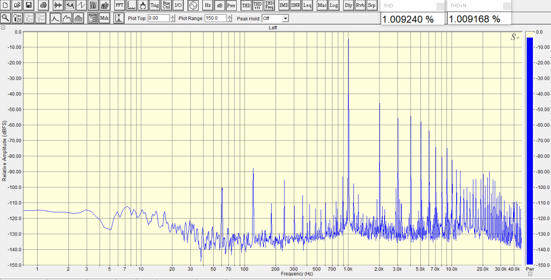

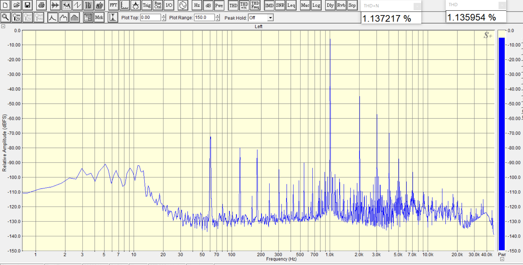

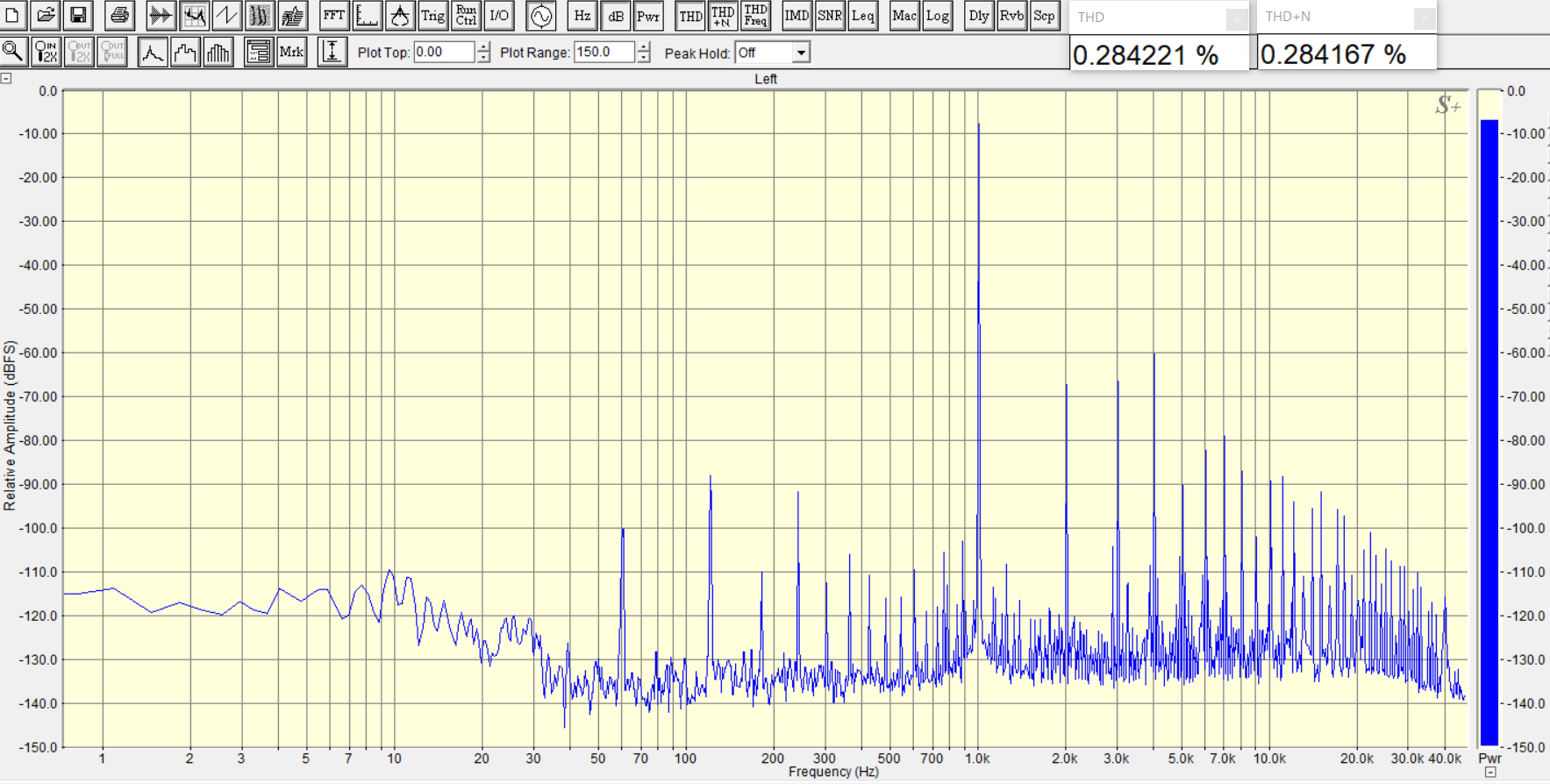

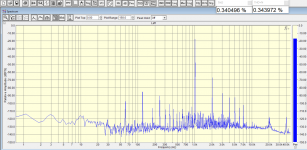

After few days I took the amplifier from my listening room and put it on my work bench. There was time to measure and try to improve the sound. On a side I entered circuit into computer Spice simulator (I use MicroCap 12) which allows me to experiment with circuit adjustment before taking soldering iron and thus save the time by avoiding non-workable changes. For measurements I use EMU-0404USB audio interface, which despite being 10 years old is still the best D/A and A/D interface under $500. I use SpectraPlus SC, which allows all kinds of measurements utilizing standard ASIO capable interface. I had to make a special 20:1 balanced probe to allow me measure amplifier output, which can reach 20 V RMS or even more. I also checked shape of signal in circuit with Siglent SDS 1104X-E oscilloscope. For measuring at high voltages I have 100:1 probe that can handle over 1kV. I have an active balanced probe which I tried otuse, but found it unusable for audio measurements due to high level (-60dB) of spurious noises. That is why I had to make my own balanced probe for EMU, for its balanced XLR input.
Despite all my efforts to minimize the noise level in measurement chain, it still picked up something that was not at the amplifier output. But generally I was comfortable with measurement results. Though on spectrum plots you can see some things which should not really be there. At some day I will by Audio Precision gear for my home lab, but today I cannot justify that investment with amount of work I do in audio.

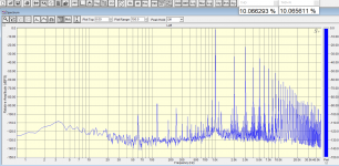

I started measurements with 1kHz tone at 1W (I used 8 ohm output loaded with 8 ohm high power resistors for almost all my measurements). With feedback at lowest setting THD is about 0.34% mostly from 2nd harmonic (See Pic.3). All other harmonics are much lower and spectrum shows classic triode exemplifier pattern when each higher order harmonic is smaller than lower one. That usually correlates with clean perceived sound. From noise perspective, highest component is 120Hz at about -70dB level. You can hear that when put ear close to speaker, but not from listening position. Of cause with very sensitive speakers you will have less luck, but then you will likely use a different amplifier. When I increased feedback to second level, distortion dropped to 0.24% and 120Hz hum component dropped 6dB down (Pic.4). Feedback clearly does its job to reduce distortion and noise.

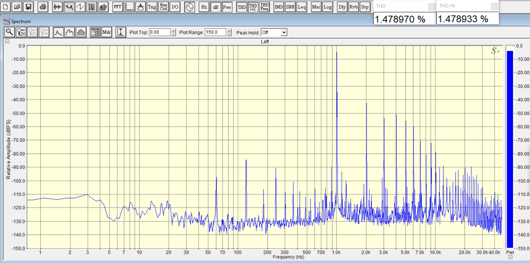

At 5W the overall picture is the same with 2nd harmonic highest and higher harmonics all trending down (Pic.5). But at 10W (Pic.6) 3rd harmonic is equal 2nd and now highest is 4th. This is what you are dealing with getting into class A2. Again applying feedback (Pic.7) drops distortion, though keeping its pattern, and noise. For comparison I show distortion spectrum from amplifier with 845 tube running in class A1 without feedback (Pic.8). There distortion is higher, but pattern is still the same as at lower power. It keeps that pattern up to the point of clipping.
But with 805 tube we see that higher order harmonics are higher, and 4th is playing a very important role. That results in perceived sound differences between class A1 and class A2 triode amplifiers.
At 20W (Pic.9 for low feedback and Pic.10 for some feedback) we getting above what is possible while staying in A1 class. Here we again see that 2nd harmonic is the highest, and 4th is a second to it. Overall distortion is still relatively low, especially with some feedback used.
At 30W (Pic.11) third harmonic is again equal to 2nd, but we clearly see a picket of high order harmonics. Feedback (Pic.12), helps but not much. Amplifier is a on verge of clipping.

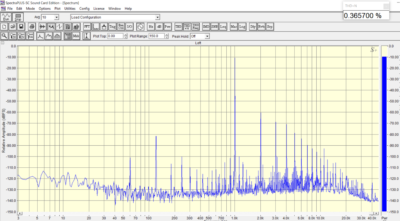

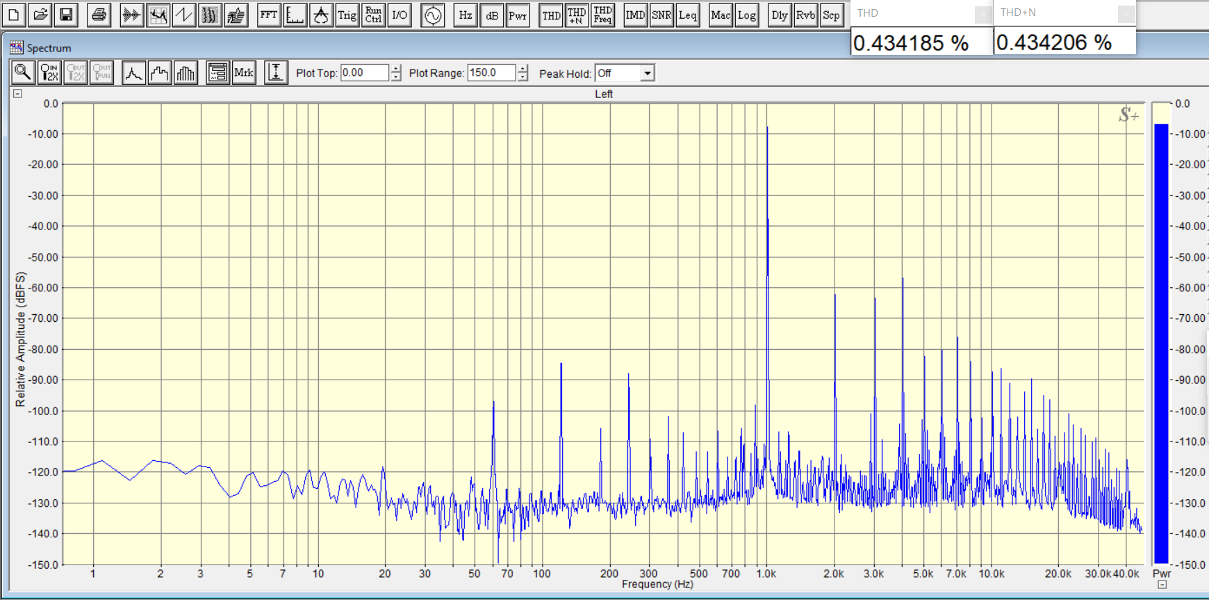

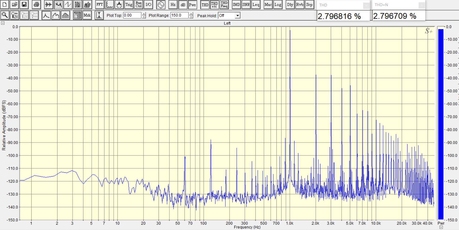

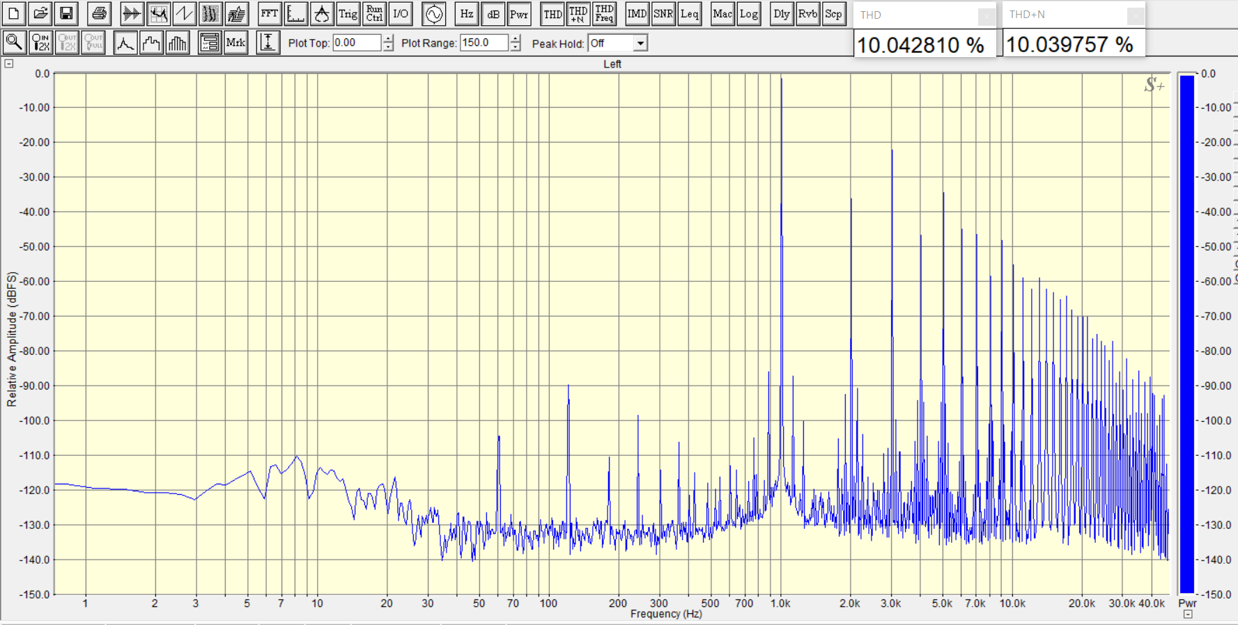

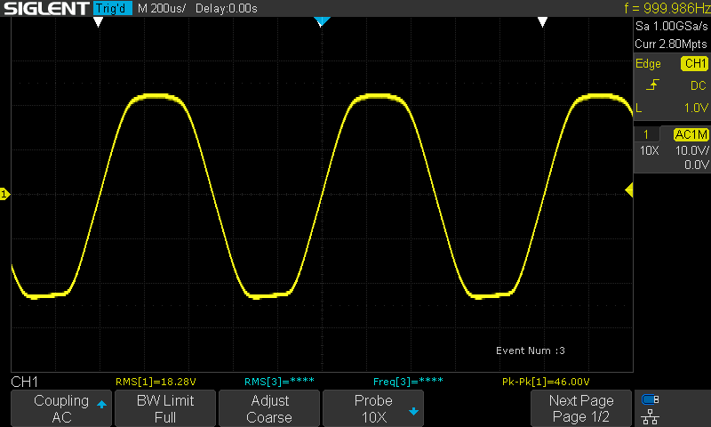

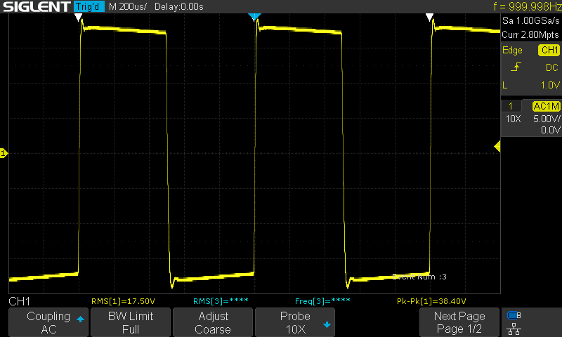

At 39W amplifier reached 10%THD (Pic.13) and applying feedback (Pic.14) does not help at all. Feedback is NOT a solution when amplifier already clipped. Pic.15 shows how output looks on oscilloscope at that moment. Thus we are 9W short from official power output. But I didn’t keep line voltage at 220V as it should be. When I measured it, it was 210-215V. That could affect the result. But in any way, 10% distortion is NOT a point where you should use amplifier. But real power with distortions below 5% is somewhere in 30-35W range. This is still twice more than usable power from A1 class amplifier (around 18W).

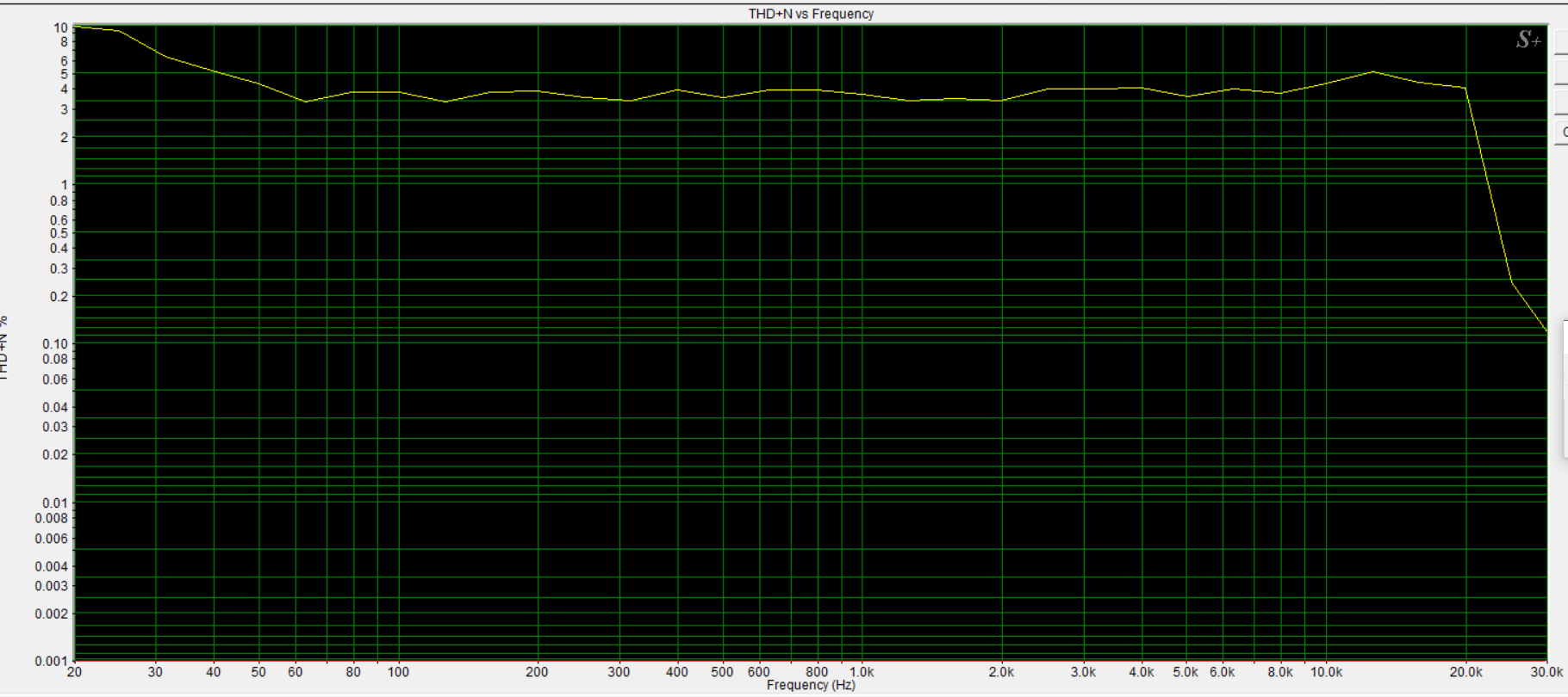

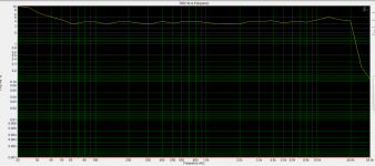

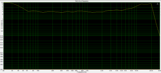

When I measured THD vs. Frequency, I noticed that when use lowest feedback, it is relatively flat with little raise at low and high parts of audio band. But when I apply feedback, although distortion in mid-range gets lower, at low and high frequencies distortions raise to much higher level. This is a trade off from using feedback. That may explain why many prefer low or no feedback amplifiers, even though they have higher THD on paper (which is usually measured at mid-range). Pic.16 and Pic.17 show THD vs Frequency at 30W with lowest and second from lowest feedback settings.

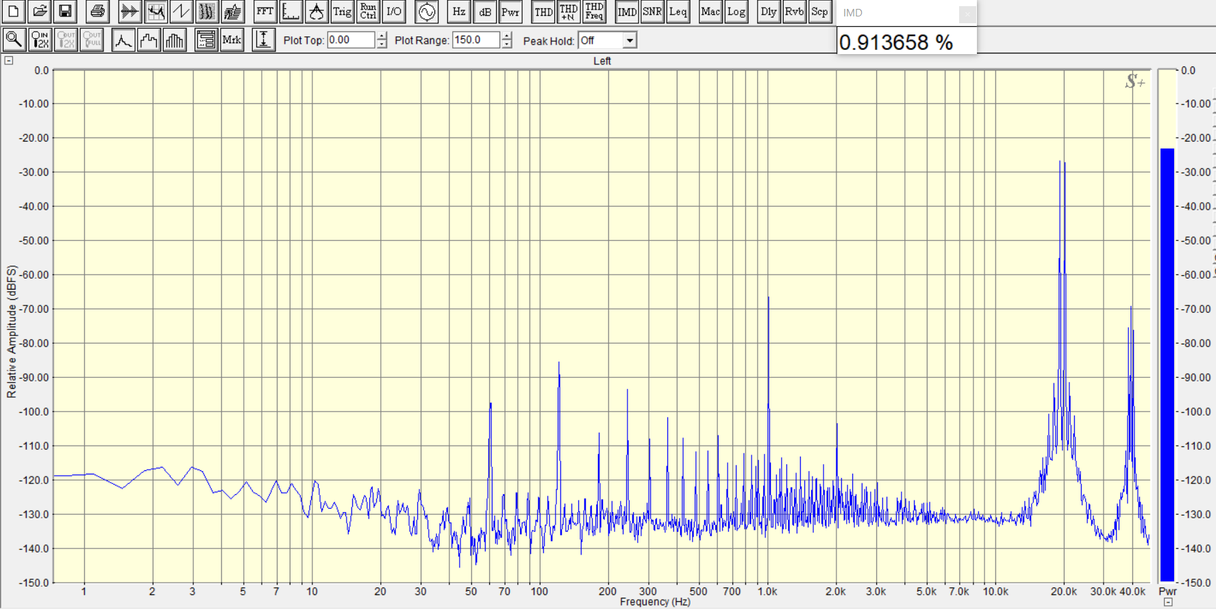

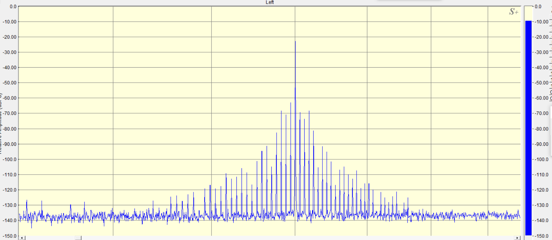

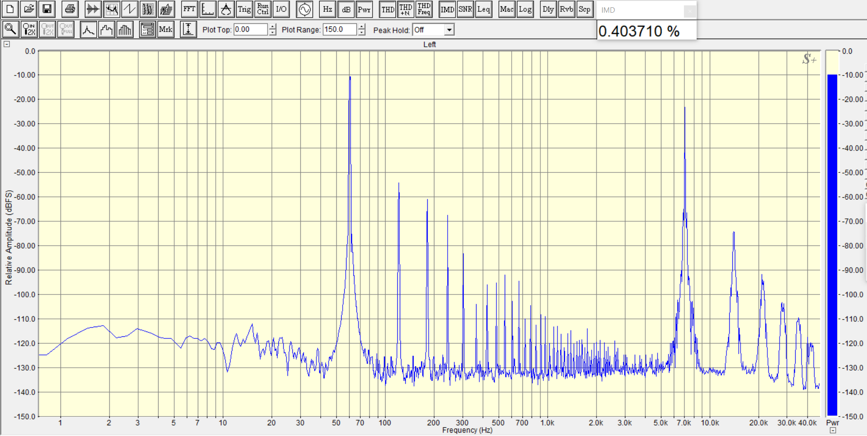

This amplifier has relatively high level of IMD, if measured with equal 19 and 20kHz tones. Even at 1W IMD is close to 1% (Pic.18), and applying feedback does not improve picture much. I suspect that this is because of slow slew rate that causes increased distortions at high frequencies.

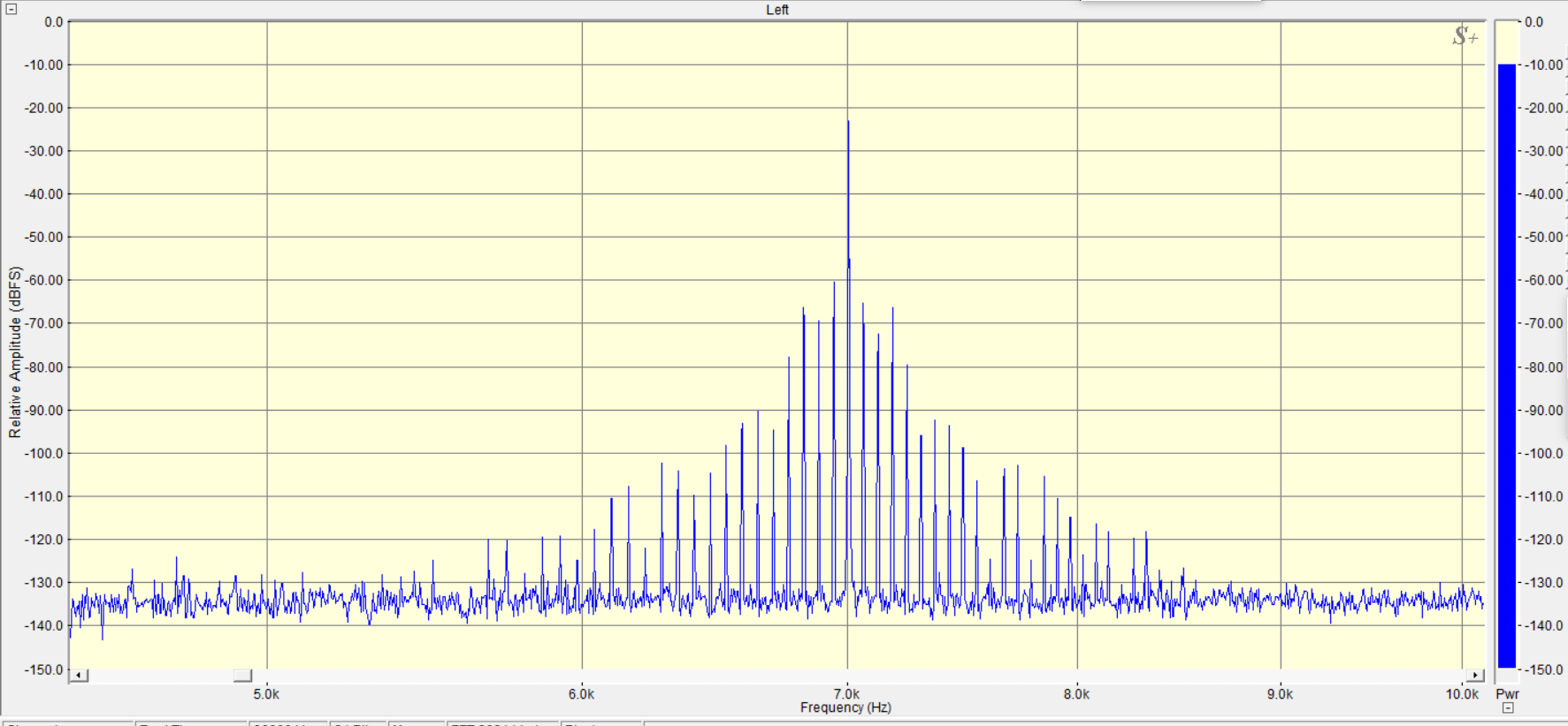

I also did IMD measurements using 60Hz/7kHz 4:1 signal. That gave more reasonable results (Pic.19) at 20W. Pic.20 and Pic.21 show distortion components around 7kHz point with lowest and some feedback respectively. You can see that though feedback reduces distortion component amplitude, it also broadens the spectrum by adding higher order components (but they are low in level).

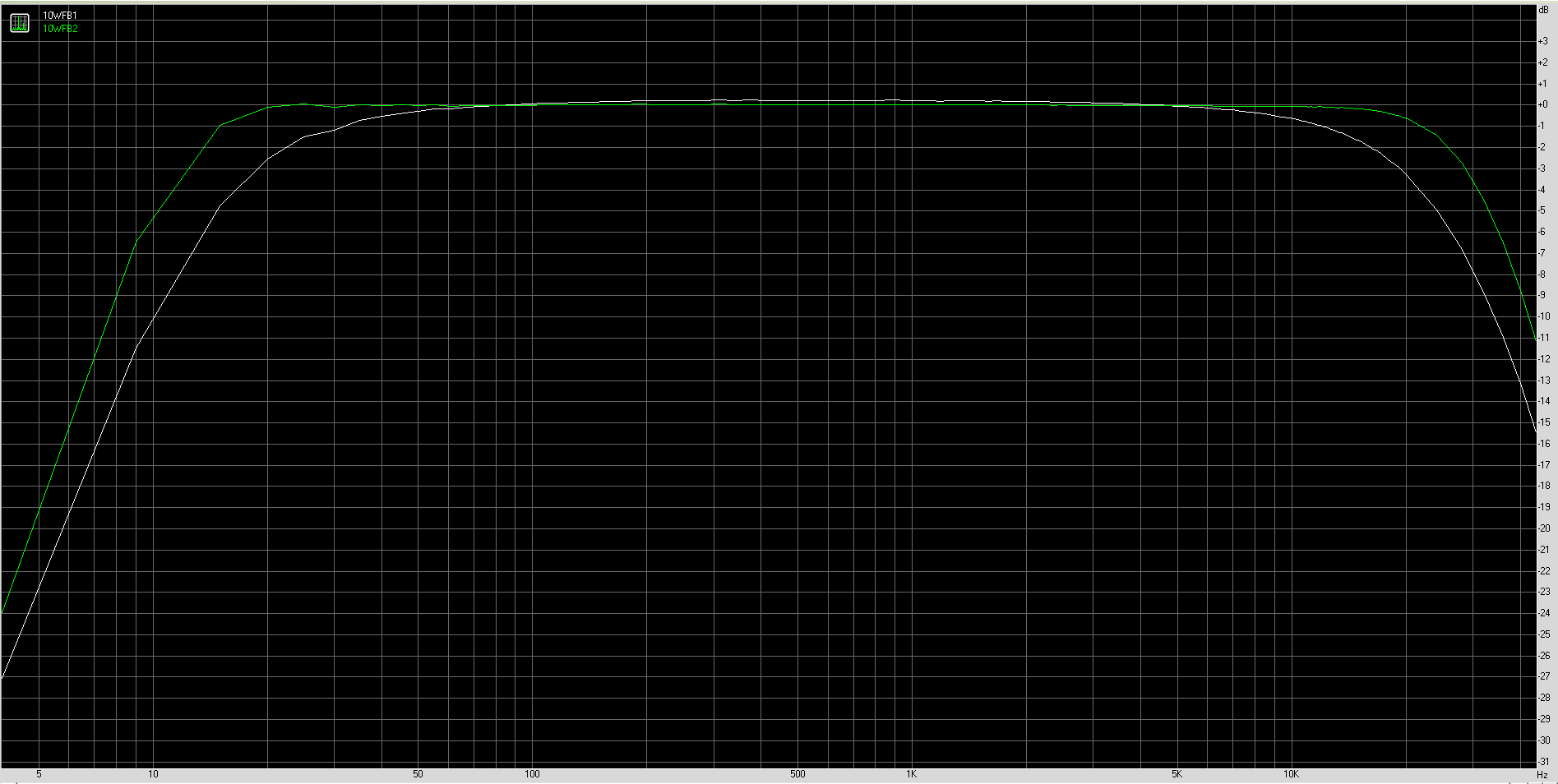

Considering that I had to use feedback to get acceptable bass, I measured output impedance. The results was 6 ohms at 8 ohm output and lowest feedback. When I increased feedback a notch, impedance reduced to 3.5 ohms. Of cause when I use 4 ohm output, this value is lower again. When I tried to use 8 ohm load from 4 ohm output, distortion at low level reduced a bit, but clipping condition occurred at power of less than 30W. Though clipping with 4 ohms load at 4 ohms output occurred at around 40W. It means that for best results one needs to use proper output that matches speakers.

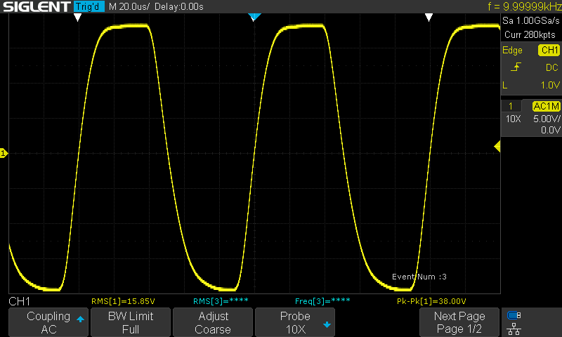

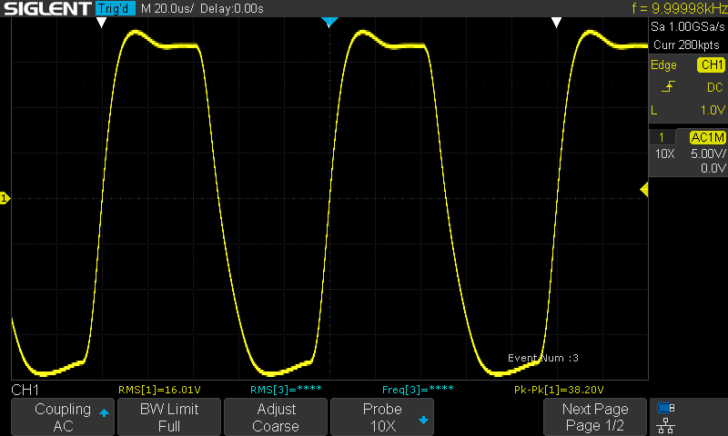

Feedback settings also influence how amplifier handles high frequencies. When set to lowest feedback low and high frequencies are rolled off a bit reaching -2dB at 20Hz and -3dB at 20kHz. With feedback set to second level response is effectively flat between these two frequencies. (Pic.22). When I increased feedback further, I observed a slight bump centered around 25kHz. Amplifier does not have any feedback compensation and this bump is likely a result of limited stability margin. It is possible to add frequency/phase compensation in the feedback loop, but it won“t work very well with simple variable feedback setup. Square wave response is also changes with raise of feedback. At lowest level fronts are not as sharp, but increase of feedback causes overshoot and some ringing. Pic.23 shows square wave response at 1kHz and lowest feedback. Pic.24 and 25 show response at 1 and 10kHz with second feedback setting. Clear seen ringing appeared when I tried feedback at 3rd and 4th level. That is why I stopped at second feedback level for all other measurements and listening sessions.
