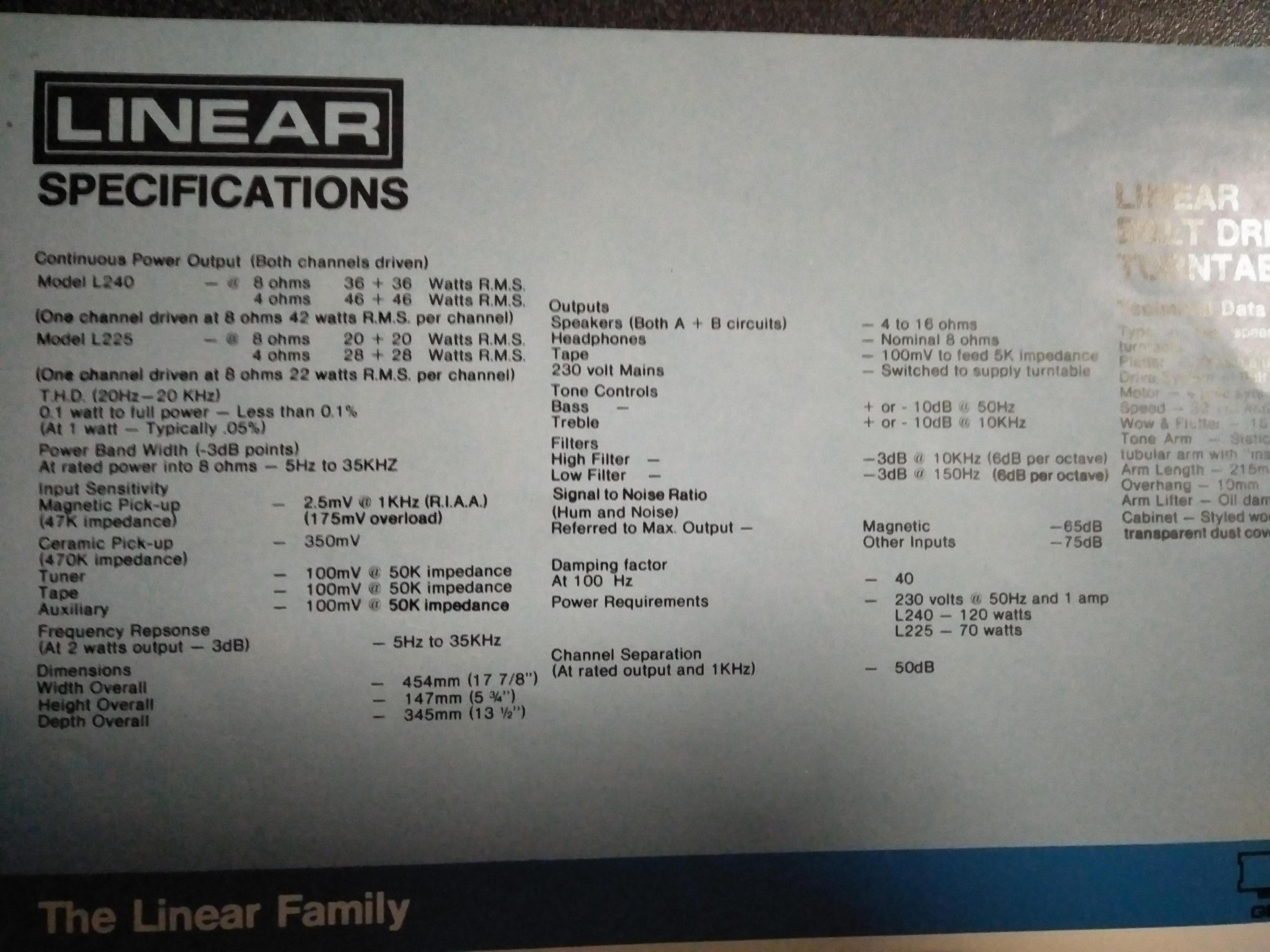

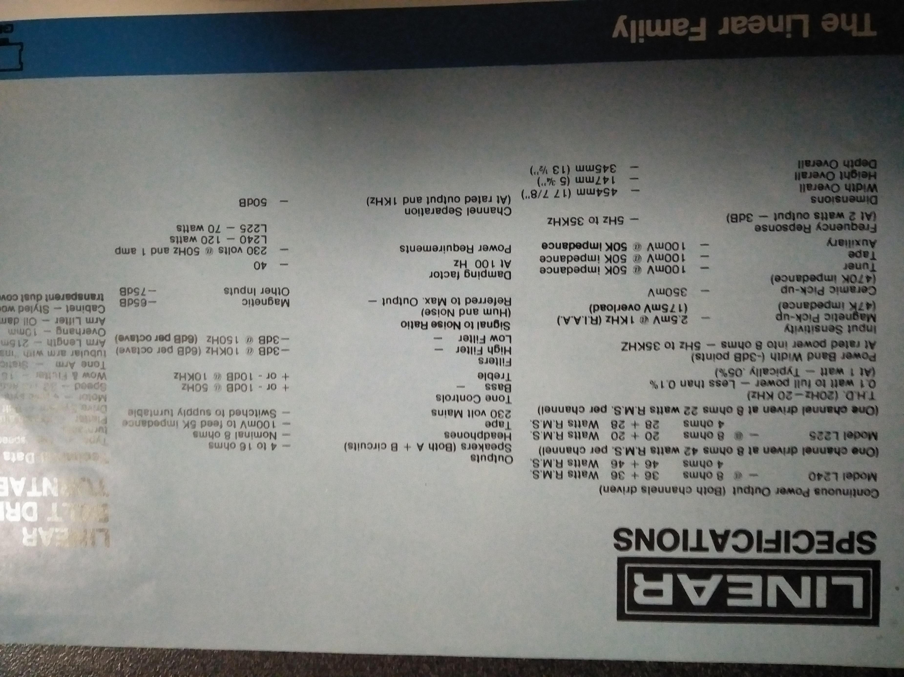

Apologies for the upside down pic. I have 3 of these amps in varying degrees of condition. Bit of nostalgia as I grew up listening to one, which then became mine. Sadly that one was wrecked at a party when I wasn't about. One I haven't seen and is still in a box packaged up at my parents house, off trade me. Supposedly working but I'm poor physical condition. The third, I have here and is working as it should, in good condition but prob in need of a recap.
This integrated shares a striking physical resemblance to Sansui AU4900, and from memory the specs were very similar (I may have wrong Sansui model here).
Have also tried myself to research these but there is literally nothing out there apart from the link mentioned in the original post.

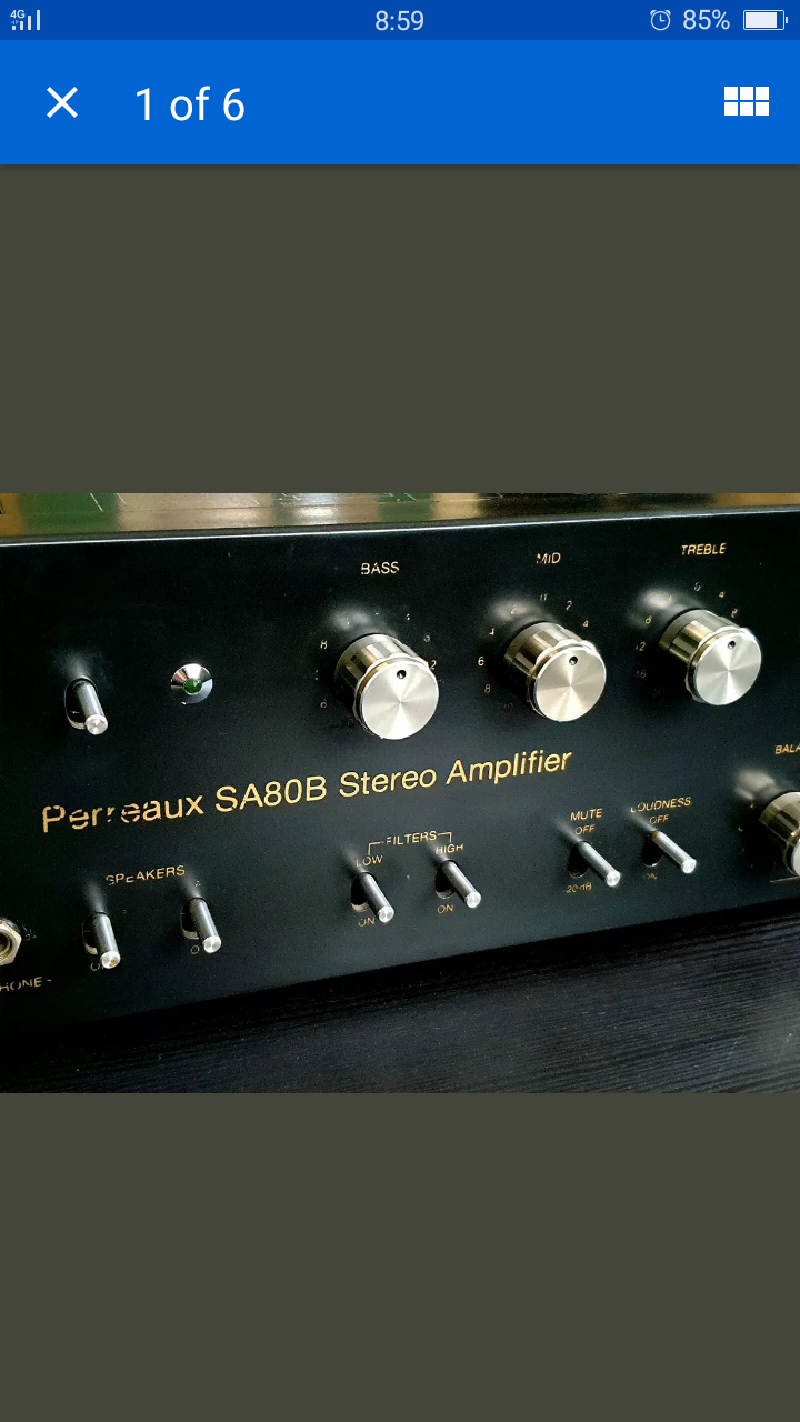

Check out this Perreaux that also looks similar, but I guess the look is typical of that era. In past research I've also associated these Linear amps to the Rait amplifier brand from Christchurch, but that was only based on visuals of some of the internals of his gear. Whether there is a connection I'm not sure.
There was quite a bit of similarity between units that were designed and made here in NZ in the 70s and 80s.
I suspect a degree of copying went on - a manufacturer would style their design based on the lines of another's machine - much like all the Japanese cars of the 80s all had the same square lines.

Thanks for the upload of the Linear user manual!
