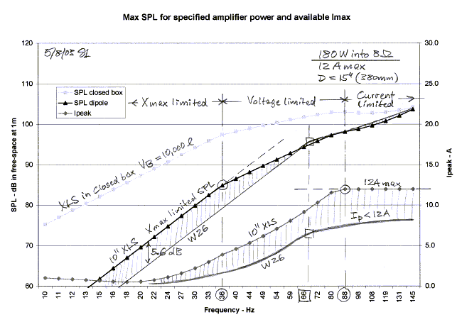

A woofer in an open baffle, unless it is really, really wide, is well known to suffer from cancelation from the back wave going around the baffle. Between the 12 dB/oct roll off of the woofer below Fs, and an additional 6 dB per octave below the baffle width frequency, which is ??? 200 Hz ??? for this speaker, just guessing. So at 28 Hz the attenuation is going to be large and the woofers will be hitting Xmax with little resistance, leading to lots of surround flex sound, ie "Whiff Whiff" and not a lot of output. It's just physics / acoustics. Design decisions were made with full knowledge of this. Linkwitz illustrated it on his website. No need to get all bent out of shape over it. https://www.linkwitzlab.com/Amplifiers-etc/SPLmax.htm Go model the speaker with VituixCad or other program and see what the SPL max is at 28 Hz.
Just looking at the tiny baffle around the upper woofer or is it a lower midrange, that driver will need low frequency boost to compensate for baffle step / cancelation to make it flat to 120 Hz. There's a good reason the crossovers in this speaker used active filters or DSP.
Heres one plot, as links have a way of not working years down the line.
