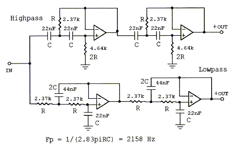

Hi all,
I have simulated a standard 4th low pass Linkwitz Riley filter as part of an active crossover at 500Hz, but at about 80kHz it levels out and then begins to rise again.
Is this normal for The LR Low pass filter ?

Not normal for the theoretical transfer function, can you post the schematic and response curve?
Maybe it's measurement error, since by 80kHz the signal is very far down, in a 500Hz LP filter.
Can you link to a web site showing the schematic that you used, is it this one?
Active Filters
Active Filters
Hi again, I used ESP - Linkwitz-Riley Electronic Crossover - this is the site and diagram.
I use R= 1K2 & C= 188nF [4 parallel 47nF caps]

This often happens with Sallen Key topology. It's an effect of non-negligible output impedance of the op-amp. Other topologies, like MFB, do not have this problem. See page 6 of the attachment and esp. Figure 8.

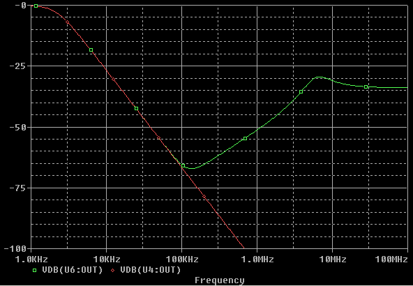

The math assumes the opamp is perfect, with zero impedance to infinity.
Opamps we can buy have some output impedance, reduced by NFB, but open loop gan falls, so output impedance must rise. Meanwhile the capacitor from input to output is decreasing impedance. At some point there is more signal short-cutting around the opamp than through.

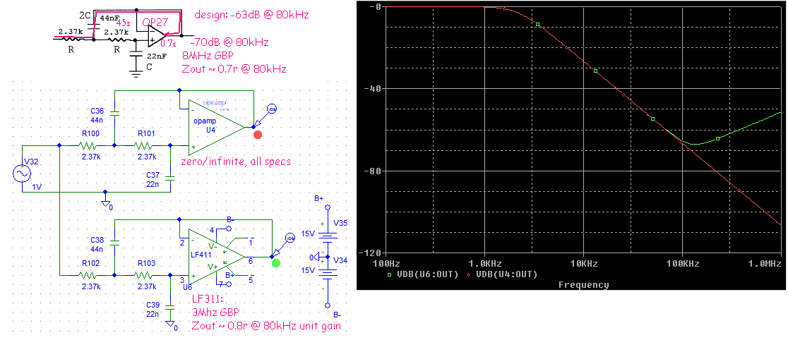

The general result is correct, either from common sense, old books, or (I was bored) old simulators.
Top-left sketch shows opamp with plausible internal impedance and gain. Counting on thumbs, path "2C" against opamp output will tend to flatten-out near 80kHz. What happens beyond depends (Zout is likely to rise).
With an Ideal opamp U4 the filter slopes-off forever.
I ate all my OP27 long ago. This sim had a LF411 which is a pre-TL07x BiFet of modest performance. It absolutely shows a bend, in this case a bit above 100kHz.
And then what?? I tole my sim to run to 100MHz. Peak near 5MHz then flat beyond. None of this can be trusted. The opamp model was only intended to go a few MHz and some parasitics will come into play past there. And we know ALL amplifiers go to zero at infinity. But we are warned the good response to 100kHz is followed by increasing errors as we go higher.

This is very interesting - I used the OP27 because it is one of the few that I recognized in the LT library.
Later, I tried two others: LT1028 which is reputedly 'high end' [very expensive here in RSA], it showed the same leveling out then rising characteristic, but surprisingly not at a very much higher frequency.
Then I tried the very old TL082 op-amp - which did show a markedly sub-optimal performance.
