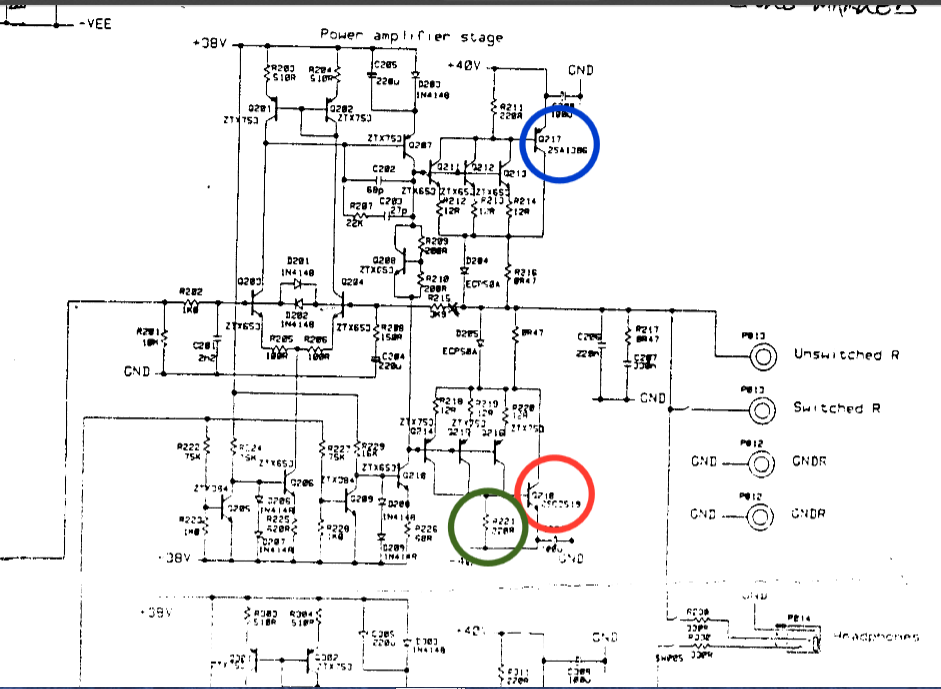

I have been using my Linn Intek as a pre in an active tri-amped system I'm running to great effect. Whilst enjoying some John Martyn the other night the sound cut out, there was a crackle and pop from inside the amp and I could see something catch fire. As I dove across the room to hit the power the sparks went out and the sound came back briefly before I turned it off.
Upon further investigation I found that one of the output transistors had failed (and taken the other with it). This puzzled me as I hadn't even been using that part of the amp. Then when I did some schematic hunting I found out that I was supposed to separate the power amp from the pre amp internally before using the pre out / power in combined sockets on the back. So this made a little bit of sense as I was running quite a hot signal out of the back of the pre amp into the +4dB input on my crossover and the power amp would probably have been running into clip most of the time. Although my initial reaction would be that as the amp wasn't under load this wouldn't affect it but I suppose the proof is in the pudding.
I have now disconnected the power amp board from the power supply and am quite happily running the amp as a pre amp again (if anything sounds better). But I would like to be able to get the power amp working again in case I want to use it again, I very much liked the sound of it.
Apologies for the lengthy pre amble, HERE are my queries!
I have sourced some replacement output transistors and intend to replace both channels for consistencies sake. Now I find that one of the emitter resistors was taken out when the transistor caught fire. I know it is 220R but I need to know what sort of power handling I should look for in a replacement, they don't look very substantial compared to the big ceramic emitter resistors I'm used to. Here's a photo of said burnt resistor next to the culprit transistor (it's was a TO3P case) for size reference:
Should I replace all of the emitter resistors with whatever replacement I find?
Also, I have read a lot about people replacing the driver transistor at the same time as the output transistor. I have a rough understanding of what the driver transistor does but can somebody explain to me how to locate it? Is it a wise move to replace this at the same time?
Here's an annotated schematic (sorry about the quality). Ringed red is the burnt out transistor, ringed blue is the transistor that is now open, ringed green is the burnt resistor.

That certainly was some failure, though I don't see how leaving the power amplifier connected internally to the preamp is going to affect it if the load is disconnected - perhaps instability? 😕
The resistor is probably a half-watt metal film type, by size comparison with the T03P transistor. You could use either 1, 0.6 or 0.5W MF types for the drivers of most transistor single pair output stages. They are not as common as the ubiquitous quarter-watt MF types but major distributors like Farnell, CPC, RS, Rapid will have them. Don't try to buy small numbers of parts on the net/Ebay. You don't know what you will get and I have even seen production rejects passed off as good parts.
Unless you are concerned about aesthetics, you don't need to replace parts unless they show signs of stress.
The 220 ohms will never normally see anything over 0.8 volts or so (they are across the B-E junction of the outputs) and so a 0.125 or 0.25 watt is fine.
You need to check the 0.47 ??? ohms that are in the collector circuit of each output.
Edit...the drivers are the two pairs of three paralleled devices. I would advise you power this up with a bulb tester after repair to save any disasters and blowing of devices.

After finishing a long struggle with my Intek: Yes those are 220 ohm 0.6W metal film resistors. When any of the outputs fail, they usually take some - or all - drivers with them, + the emitter resistors. Check the small ZTX drivers (6/channel) clipped to the small U-shaped heatsink, also ALL emitter resistors, sometimes they fail without any visible mark. A warning about the ZTX series transistors: they are so called low saturation voltage types, which means they open at a lower E-B voltage, than common (BC, BD, 2SA, 2SC series)driver transistors. This means, that you can substitute them with any decent 100V 1A driver transistor, but then you will have to replace both NPN and PNP side devices, AND readjust idle current, which is not so easy, since it is done in the Intek with two fixed resistors plus a transistor (Q208, R209,R210 on the left channel). ((After my Intek killed a few woofers on various occasions, I finally added a TA7317 based protection circuit to it, that works for shorted outputs, DC on the outputs, +overload protection, excellent little circuit))

While I am at it--- Repairing and Intek can become a quite nightmarish experience, even for someone who does this for about 30+ years. Check the thermistor related circuit too, that can cause random muting sometimes, also see that the main transfo AC connecting 3 pole plugs are OK, because they can become loose, or even have burnt contact prongs- I replaced mine with similar sized PC solderable 3 pin screw terminals. Last but not least the 2 sided PC board's numerous interconnecting points can have bad, intermittent contacts, so check those too with a continuity checker on your multimeter. Other than that, after some substantial mods I like the sound very much, it is clean now, without the "Linn blur", have good authority, and much wider frequency response than the original......

I have just checked the drivers and they all appear to be operating normally with a hFE of around 240 for the PNP's and around 190 for the NPN's, also the emitter resistors seem ok. Is there anything else I need to look out for before going ahead with the repair? I don't want to go and blow another pair of power transistors straight away, they aren't cheap!
Well, there are a few more things you can do when you start up your amp, first check the idle current (all this without load on the speaker terminals), on the emitter resistors, it should read 55-60 mV between the two outer legs, the DC on the outputs should not be more than 10-20 mV. Let it run like this for a half an hour, then recheck, if they don't change much you are likely OK to try it with load. (If you have a scope, see if there is no HF oscillation on the terminals).

I would recommend using a bulb tester to power the amp up initially. If you apply a short circuit across C and E of the vbe multiplier (Q288 ??? diagram is blurry, the one with the bias resistors) then that will force the quiescent current to zero. The amp should operate normally apart from slightly higher distortion. If all OK then remove the short and check the bias. The bulb should be very dim. If its bright you have a fault. Don't turn up the volume to high with a bulb fitted, the circuit could latch unpredictably.
You could replace replace the lower 200 ohm with a 470 ohm preset to give manual adjustment. Always begin with the resistor on highest eg 470 ohms to give minimum initial current.

It is Q208 and 308 respectively. Yes I forgot to mention that I've replaced the two lower 200 ohm resistors with a 500 ohm multiturn cermet trimmer.... If you google TA 7317 (or UPC 1237) you'll find dozens of applications for them in different amps.
Be careful with the bulb tester method on this amp, due to the thermal protection circuitry it can produce some strange behaviour sometimes, especially when pre and power stage supply voltages get far from their normal operational values (the power stage can latch, or worse: switch the negative PS voltage to the output- both variants happened to mine more than once....)
