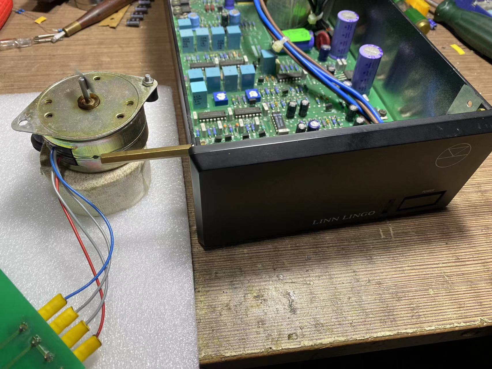

The other day I repaired my antique LP12 motor because it was difficult to start at 45RPM. I removed the spring and ball at the bottom of the shaft, and everything returned to normal.
The LP12 motor is rarely damaged. If you think it is broken, you can buy it online according to the part code. Maybe the price is about 60 dollars. There is only one manufacturer of this motor from the UK, but the origin may be different, including the Netherlands and Belgium.
Moreover, the belt is unlikely to slip because the torque required for starting the rotary table is too small. The belt needs only a small amount of friction.
I think you should suspect that there is something wrong with your drive power supply. I have a first generation LINGO that cannot be used at present. I have been trying to repair it, but it has not been successful. There is also a second generation LINGO, which is used normally. Or you can use a 220V to 100V isolation transformer to drive, which will be quieter, that is, 45RPM will be lost.

Linn made a snap-on cap to replace the spring gadget.The other day I repaired my antique LP12 motor because it was difficult to start at 45RPM. I removed the spring and ball at the bottom of the shaft, and everything returned to normal.
That was a very early update, about the same time as the first suspension spring update.
