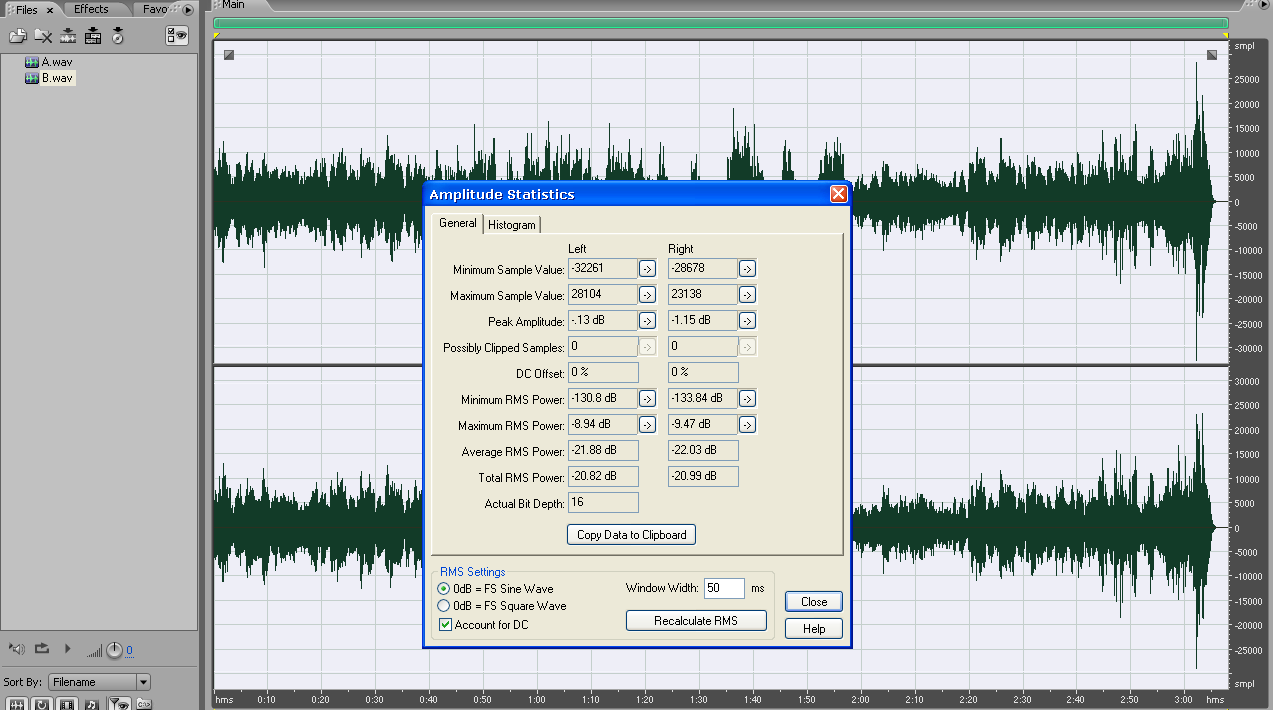

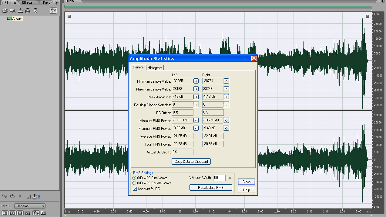

Recording the files.
Each file was recorded in its entirety. This is important. The files are NOT COPIES of each other. After each file run, the connections to the cap networks were removed and remade, also swapping the networks if the random key denoted a change. All the files were then cropped to the same bit length and all have had the timestamps equalised. This means the files will look identical if you right click them and check the file properties.

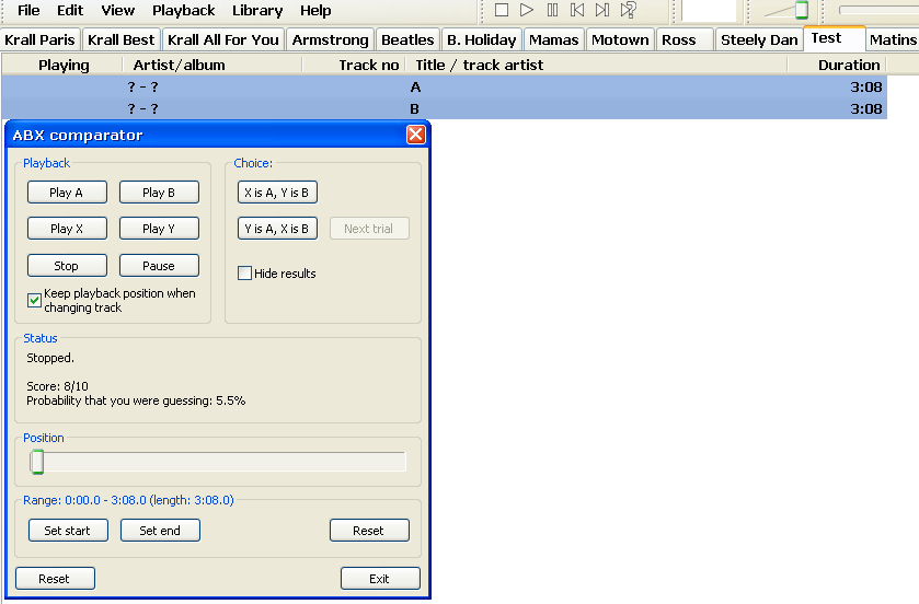

I gave it a very, very short try. My flat is being reconstructed. So I have only ONE speaker in my small office. The floor-standing speaker stands 50 cm from my left ear, but is driven with my hi-end preamp and power amplifier :D. I am listening to left channel only. This is my result, 1st take, no repetitions, no re-tries.

Hi Pavel, so your final answer then, you still have phone a friend or ask the audience :D
Firstly and seriously though, thanks for taking part, and I must say that is a mighty impressive ABX result... but what we would really need to do now is follow that through and see if the audible differences you hear are as easy to pick out in the random files. It is on that result where a test such as this "stands or falls".
Great result though. I hope that encourages others to give this a try.
