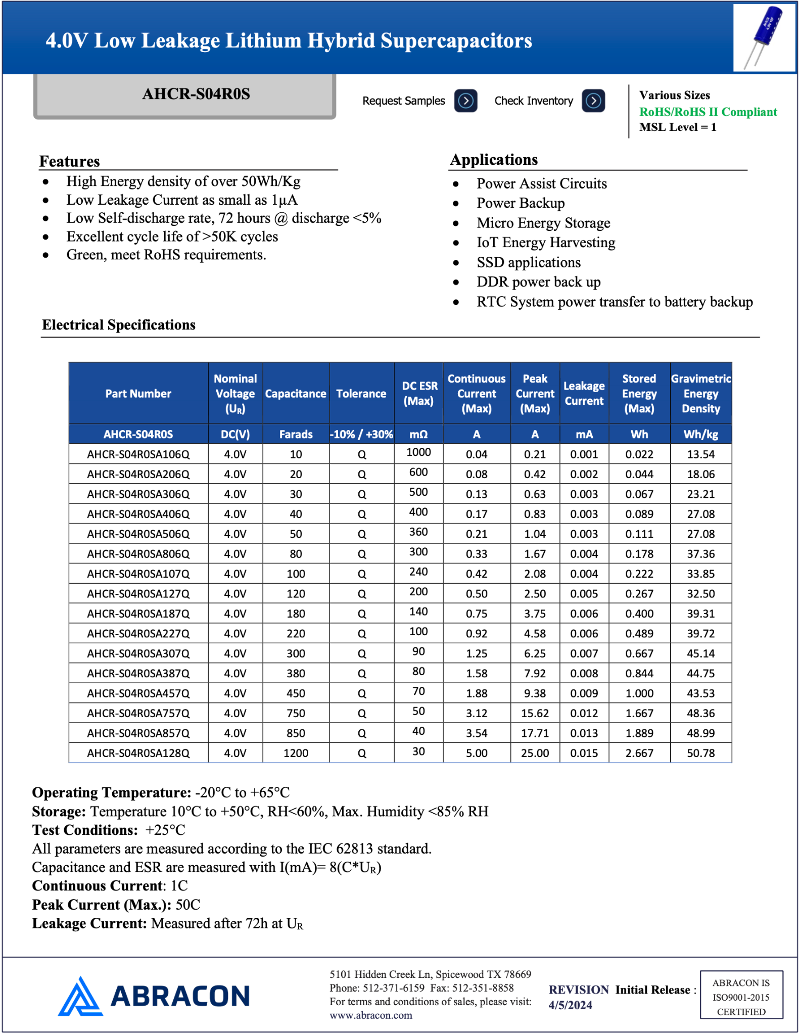

Abracon make the Lithium Hybrid cells. Not sure how many joules of energy (in Amps) one can get out of them before they destroy themselves.
Only 4volts (fully charged) but fairly innexpensive.
They don't need a balancing chip, they behave like capacitors, not batteries.

i think balancing is needed, even for supercaps and mentioned in this paper: https://en.cda-cap.com/wp-content/uploads/2023/08/CDA_LIC_USER-MANUAL2303171.pdfThey don't need a balancing chip, they behave like capacitors, not batteries.
looking at these discharge graphs there isnt much capacitance left if you limit the possible voltage range, so it might be a good idea to use a regulator and some more cells if i really wanna use lithium caps (possibly 4 cells for 10V minimum, which can be regulated to 9V)
i was looking at these: https://www.lcsc.com/datasheet/lcsc_datasheet_2212271830_CDA-LIC1840Q3R8507_C2826903.pdf 500F since these are available at lcsc.com
another idea i got was using this in parallel with lipo cells (3V - 4V), tho its usually not recommend to mix up different capacitys, is this maybe different with this lithium caps + lipo batteries?
