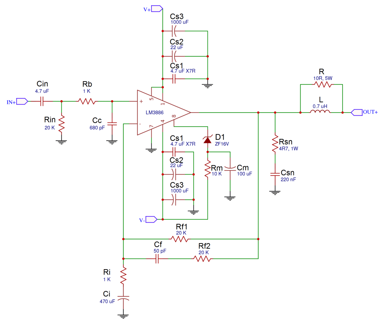

LM , TDA chip amps very weak bass, but best mids and highs, very weakly produce low frequency.
lot of experiment doing improve bass, but not good result

Maybe, test lm3886 with lg 7inch 3.6ohm oem sub, concrete flow shake, bass not hearing but flow shakewrong speakers? 🤣
test sony 6ohm 6inch 120w woofer with lm3886 very weak bass , but stk and toshiba 5200 with good bass
Test tda7294 with infinity subwoofer not produce low 40hz to 60hz, hearing 100hz bass
you say wrong speakers , why 5200 and stk with bass , lm tda without bass
As these monolithic power amplifiers don't feature any LF roll off at the lower audio band end (why should they?), I ask you why a chip amplifier should have some poorer bass respionse than, say, a discrete power amplifier or a STK thick film hybrid module operating at the same supply voltages?

thermal problem, limited bw, low power with high out,
but why 20hz to 20khz support manufacture say
You need to post the whole circuit for each, not just the part number of the chip.you say wrong speakers , why 5200 and stk with bass , lm tda without bass
The problem could be due to other components such as an input coupling capacitor that's too small, etc.

perhaps the different dumping factorYou need to post the whole circuit for each, not just the part number of the chip.
4700uf × 4 panasonic cap for power supply, 1000uf cap 100nf near chip
input cap 47uf 16v nippon, bs cap 100uf 16v
That's not a schematic..... if you really want help you need to provide more info.
what is the input impedance? and so on4700uf × 4 panasonic cap for power supply, 1000uf cap 100nf near chip
The STK modules lack output safe operating area protection, so they are likely to blow up if used for high level deep bass
the serial output R (10R 5W) is Problem! worsen the dumping factor strongly! and this is clearly audible in the bass rangeCi 100uf 16v
Cin 47uf 16v
Cs1 not add
Cs2 not add
in+ in- add 220pf
