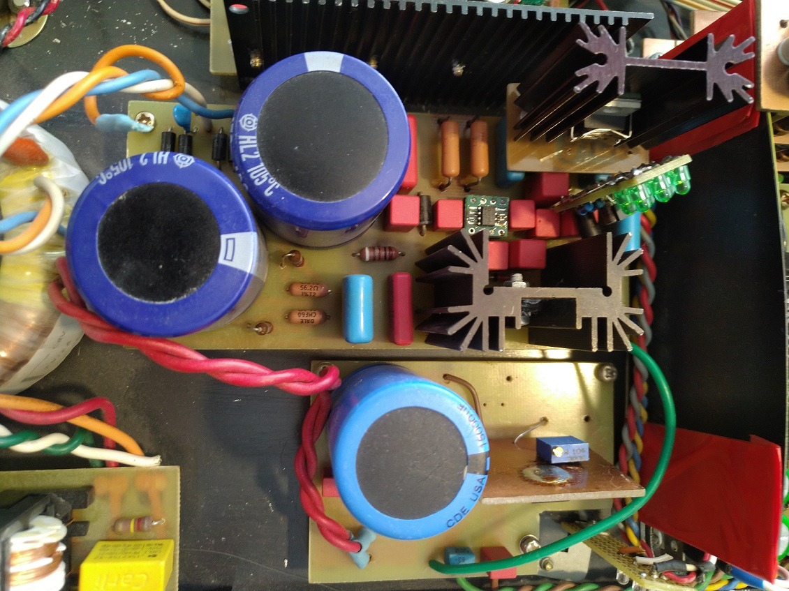

So far, I have made a pair of HV regulators from Audio Research LS25MKII and I am very satisfied with them and they are much better than the classic solutions and other regulators for HV. The same regulator can be improved by replacing the LM329, op amp and adding two new current sources. You can see the difference in the pictures, measured in my DAC while all digital is working, 260V, 100mA.

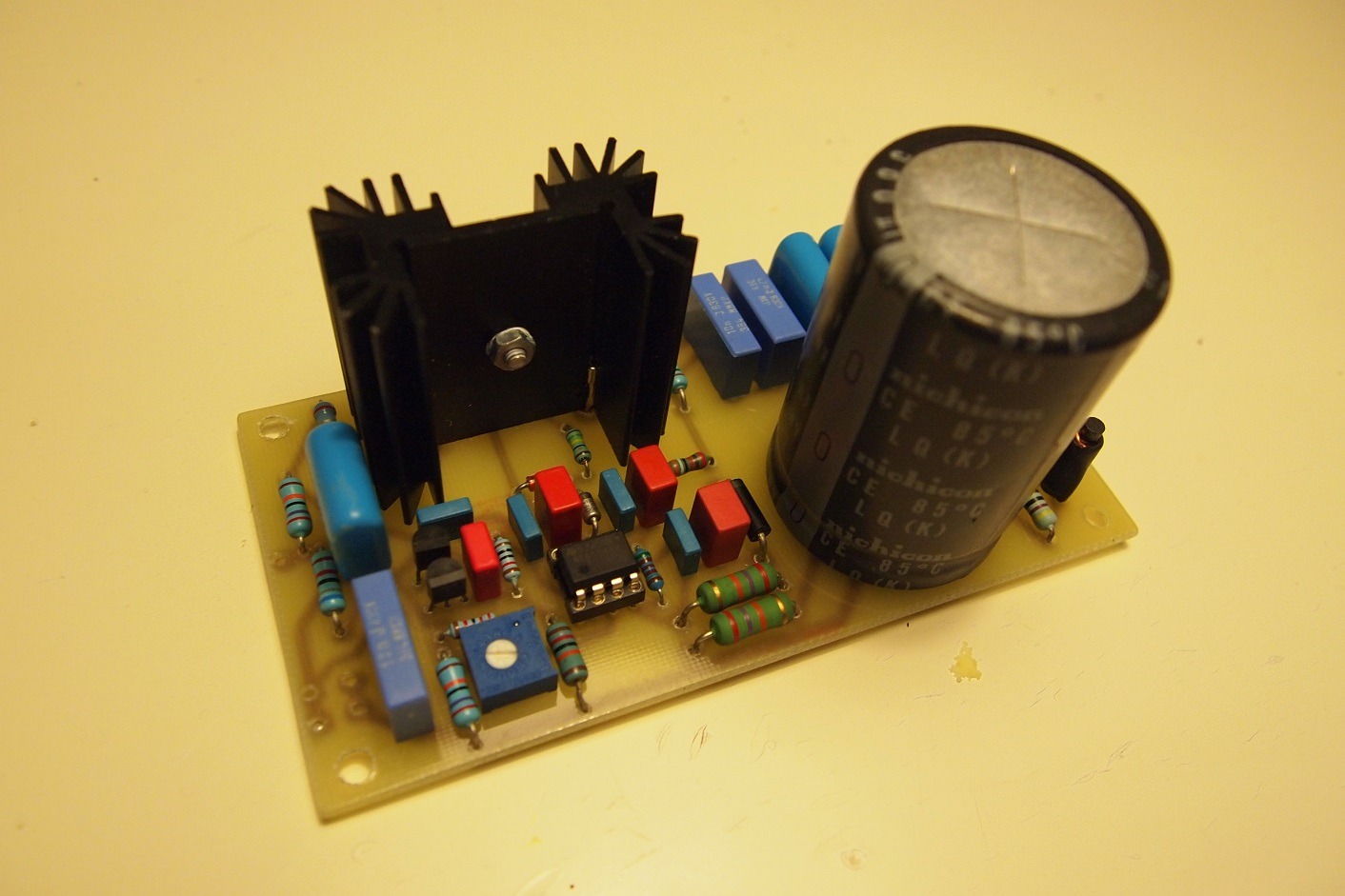

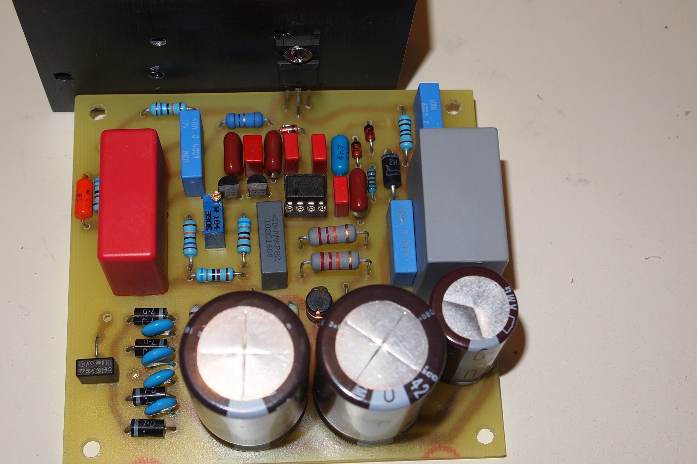

Personally I have had best results with regards to low noise and DIY PSU's with LM723 but I regret it is not LDO. The noise numbers are way better than most modern 3 pin LDO regulators. Opinions are opinions but facts are facts. As usual: many won't like it that granddad finishes the 2022 Tour de France as second or even first.
Component count is higher than we are used to today, an external pass transistor is also unusual today. It surpasses most 3 pin regulators easily even when the layout is off. With a handful of parts one can DIY a relatively simple ultra low noise linear PSU that operates stable without nasty sideffects for decades. A hard to beat and usable PSU that is. Given it is not LDO one should always calculate losses in heat. Low power applications seem most appropriate.
Let's put it this way: chances are high that a DIYer can build a stable well performing ultra low noise PSU with this IC even without a ton of measuring equipment or a lab. It won't have output peaks at power on, it will not oscillate, it will simply give clean power.

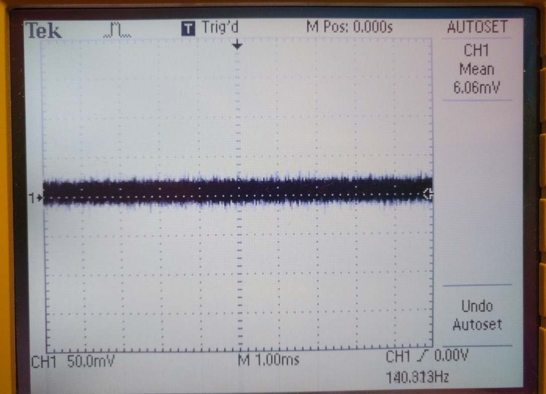

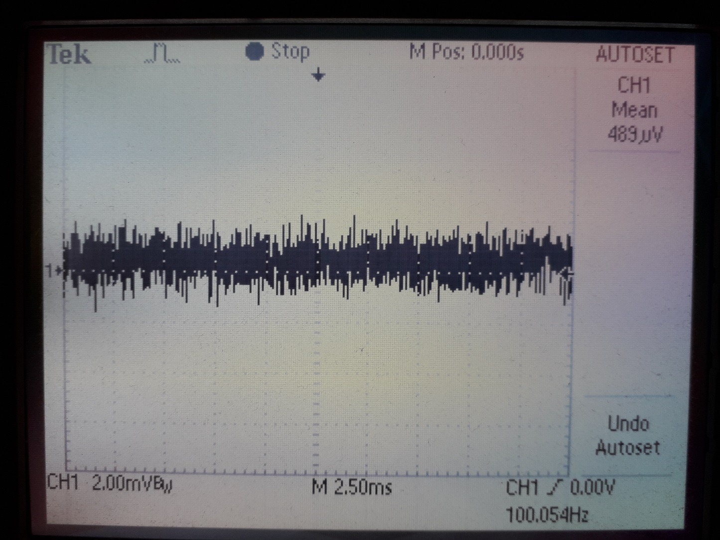

Hi, I used it in a few designs and one of those was measured by a member here. It had lowest noise of all tested PSUs then and it had no side effects. I did not see a need for trying to improve as it already had best of class numbers then.

In reality a simple low power LM723 PSU design, so not just the IC itself, can be below 20 µV of noise (often lower but it depends on brand/pass transistor and load current). No trickery, just datasheet schematic of course with Cref.
