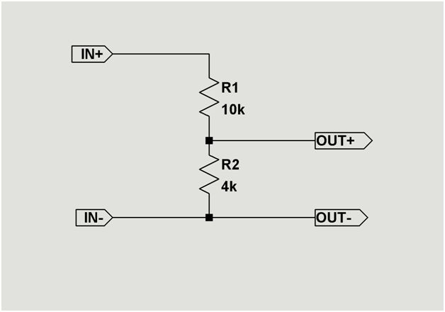

I picked 4k and 10k for the voltage divider, connected them properly (wikipedia) and for testing i plugged in 9V battery. Checked the voltage of 9V battery - 9,12V, the voltage after divider was 8,85V What's wrong? According to calculations (both mine and the ones I found in internet Circuit Design Tutor) i should get about 2,5V.

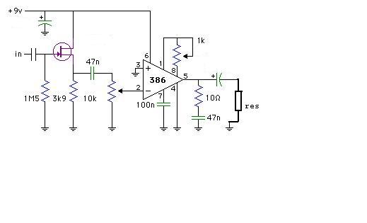

have you built this amp and does it work?
there should be no dc - volts at the output.........
suggestion: build in a res at the output (1k.......10k or so ) so that the dc - path is closed.
if the output of the ruby is too big for the power amp,change to a trimpot at the output...

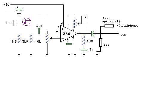

I've built it, tweaked it a bit. Now the only thing I want is a line out (which I would also use as headphone output)

You should put the two resistors in series, from your voltage source to ground. The output is the voltage from BETWEEN the resistors to ground, NOT the voltage across both resistors.
The ORDER you put them in matters, also.
With the 4k first then the 10 k between the 4k and ground (and 9.12 V connected across the whole thing), the output should be 9.12 * (10k/(4k+10k)) = 6.5V, across the 10k resistor.
With the 10k first them the 4k from there to ground, the output should 9.12 * (4k/(4k+10k)) = 2.6V, across the 4k resistor.
It sounds like you measured across BOTH resistors, to get 8.85 V. That would mean you were just measuring across the battery terminals. The resistors being connected probably just caused the battery voltage to sag from 9.12V to 8.85 V. You might also have had the resistors connected in parallel, instead of series.
The "output" is ONLY across the SECOND resistor (the one connected to ground).
Note, too, that you would need to measure the actual resistances, and THEN calculate what the output should be.
Thank you guys. I simply connected 500 ohm resistor in series with ground to headphone ground. If i connected any less i had it too loud and too risky( my headphones can take up to 500mw and when i connected 10 ohm (as suggested) i measured about 300mw at about half power. Also, it was impossible to use as headphones cause it was damn too loud.

so...... if the headphones are way too loud..........try to leave out the 1k pot (between pin1 and pin8).this should bring down the gain to 20x(26db).
No way i'm gonna do that! This is where i get my overdrive! And even if i took it away, it would still deliver enough power to blow my ears and my headphones as well.
The 500 ohm resistor does a great job. But now I am trying to figure out why is there so much noise when i connect the amp to another amplifier? I cant describe that noise, but maybe I could record it 😉

........yes,it is only a question to get some hints what could be wrong.
bigger gain gives more noise, so try to keep the gain low. the lm386 is a cheap and a little bit noisy opamp........

I will measure a little bit later because i have amplifier put in box and etc. The weird thing is that when I connect it directly to a speaker there is little noise (very audible, but it is caused by guitar pickups). The problem arises if I try to use it as preamp to another amplifier.
