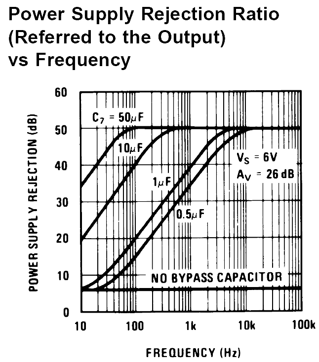

Hi All - since this thread is active and comprehensive, maybe someone could help me understand exactly what the value of the capacitor at pin 7 affects. I'm really green at this sort of thing. Anyway, I'm making little guitar amplifiers using these (with 9v batteries) and one example schematic uses a 47uf cap, while another uses a .01uf cap. My understanding is that this pin is to filter out noise from the power supply side, and would essentially act as a low-pass filter. Is that correct?
I'm not good enough at electrical engineering to figure out what the cutoff frequency would be for these different values, or if it even matters that much (e.g., if it's just trying to dump high-frequency noise on the supply voltage side, then maybe the value isn't that important?).
Thanks in advance.
Thanks in advance.
It is in the datasheet!!exactly what the value of the capacitor at pin 7 affects.
Ah.... sorry.... get an OLD datasheet. The new kids at TI have totally botched the LM386 sheet. Here's a Jan 2000 copy:
https://www.futurlec.com/Datasheet/Linear/LM386N-1.pdf
Top of page 4.
Since you usually have 100/120Hz junk on the power rail (if wall-powered), you want more than 10uFd. 22u and 47u are often the same price.
Also this is bypass for the gain-setting network. The gain is simple when bypassed but less-simple if you omit the cap.
Thanks for that info! I've looked at the data sheet a bunch but never realized what PSSR was or that this graph related to the pin 7 cap.Also this is bypass for the gain-setting network. The gain is simple when bypassed but less-simple if you omit the cap.
Since I'm here, I'll keep asking questions until I overstay my welcome...
What does it mean to "bypass the gain setting network"? Does it mean that it's a way for power supply noise to "bypass" the gain network?
