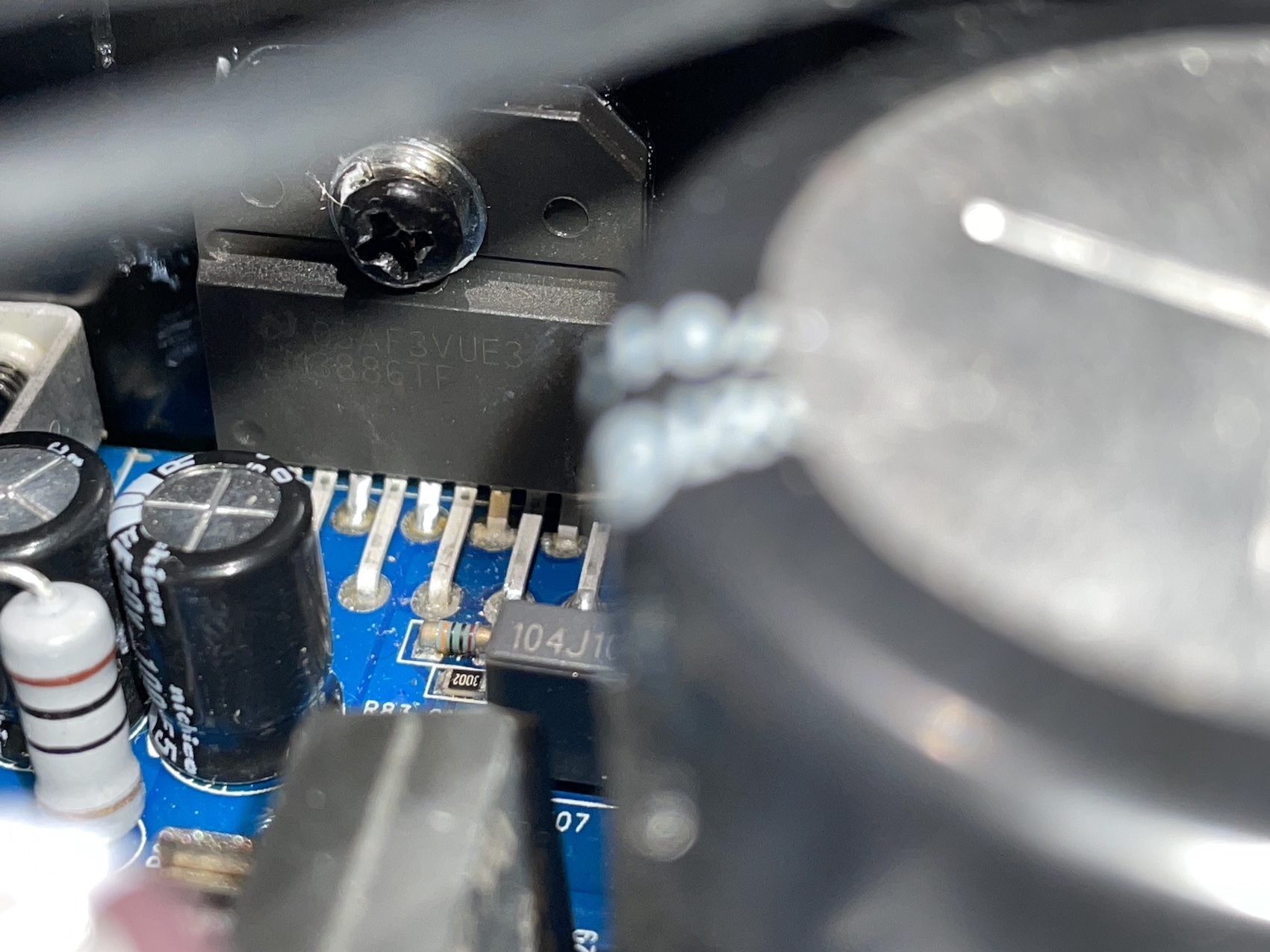

There is some discussion going on here about supplies and authenticity of the LM3886 IC.
Could you, if not too much effort is involved, post pictures of the ICs?
And a general one of the entire innards?
Some help to us all, as to the current state of British design and outsourced manufacturing as well.

I've attached a photo of one of the LM3886's.. It's in a tight spot so sorry about the poor image quality. The label is really hard to make out in the best conditions.

I think the T version is metal tabbed and the TF fully insulated and so beware, the T will not work without insulating washers and bushes.

The LM3886 looks legit as far as I can tell. It would be exceptionally unlikely for a reputable outfit like Quad to use fakes.
