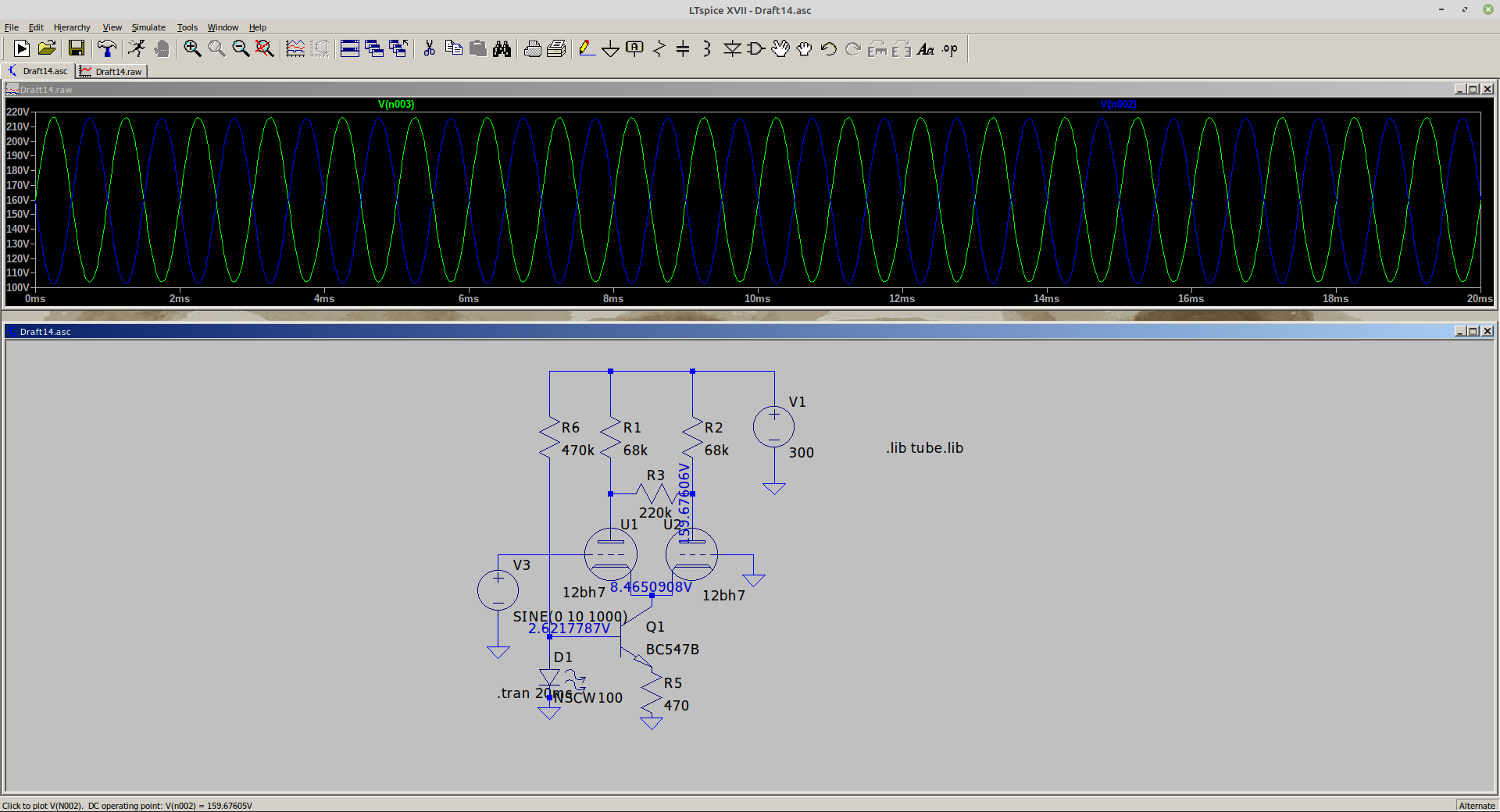

Does the standard rule of thumb for plate load resistors (~2x the plate resistance) still hold true when using a CCS tail?
I ask the question as most of the reading I've done tends to gloss over on the exact details of designing a LTP with a CCS. Most writers say to use one for best balance between outputs, but then proceed to explain how to design one for a guitar amp using a smallish tail resistor.
I've got one on my bench that is working fine, but the values of my plate loads were arrived by looking at other designs and a little trial and error rather than a general understanding of the theory.

Yes the CCS does not change the plate calculations or the voltage swing you will get. The plate can get up to CCS and normally runs at half CCS.
If you use a resistor then when the voltage drops the current in the resistor drops causing the in balance you mention. If you use a CCS then the sum of the currents in the plate loads is always equal. If you do use a CCS then make sure you have enough voltage across it. This may mean running the grids above 0V or using a negative supply for the CCS. Of course you can tie the tail resistor to the negative supply if you have one to improve balance. I tend to use LTspice to experiment there's plenty of valve models on diyaudio.
Well, when you have set the current, draw a horizontal line across your valve curves and then decide what combination of bias and anode voltage you want for your operating point; this determines the load resistor.
A horizontal line is constant current. The tubes in a normal LTP do NOT operate at constant current. To operate at constant current you need one CCS in each anode and a resistor in the tail.
I'm talking about choosing the static operating point, in the absence of signal, just as you do with a SE stage.
You actually have to draw a line for the anode resistor in parallel with the next stage grid leak for AC analysis.
If you want to complicate things further, you also have to account for internal resistance. Changing as the slope of the valve in question transitions over its operating curves.

Ok decide on how much drive into you load you need, and the gain you require. This will determine whether you use a 12AX7 or a 12AT7 for example. At full CCS the grid must not go positive into conduction. So for a 12AX7 choice CCS for max 1ma say. Then you know .5ma goes down each plate, so pick plate resistor to give static voltage of around 65% of HT. So that would make the plate resistors say 180k.
If you really want to split hairs, you have to account for the output impedance seen at the cathode of tubes. Sometimes designers use resistors from each cathode to the CCS. To swamp the output impedance of the cathodes.
You can see this in transistor long tailed pairs, i beleive the output impedance of a emitter follower is IC/25mV but i could be mistaken.
65% of HT is a good rule of thumb that will give slightly higher overall gain before clipping due to the fact, that some tubes are limited by their internal resistance in how low they can pull the anode resistor.

Morgan Jones is very good on LTPs; as a former BBC engineer, balanced operation seems to be his preferred method.
v4lve, do you really draw a AC loadline when you are choosing your DC operating point?
I only think about AC conditions after I've got my stage set up.

A resistor in the tail of a long tailed pair (differential amplifier) will have the effect of making a voltage divider, because the grid of one half of the tube is normally connected to ground. one tube gets the signal from the other tube through the cathode. In which case its attenuated by the impedance looking out of the cathode. And the impedance of the tail resistor.
One common misconception about long tailed pairs is that they increase the gain, which they don't really do that much. But they do increase the common mode rejection ratio of the two inputs.

Oh that depends on the choice of valve. 12BH7 about 10x, 12ax7 maybe 50-100x. Cascade LPT 2sk170 + 12ax7 about 400x.

Not really, Im too lazy for spice, what i normally do is just current source the tube. and draw another line that is the loadline for the grid resistor. Once i am done with that. I use the MK1 eyeball.
The 65% percentage mark on HT for anode in quiescent is excellent as a rule of thumb.
