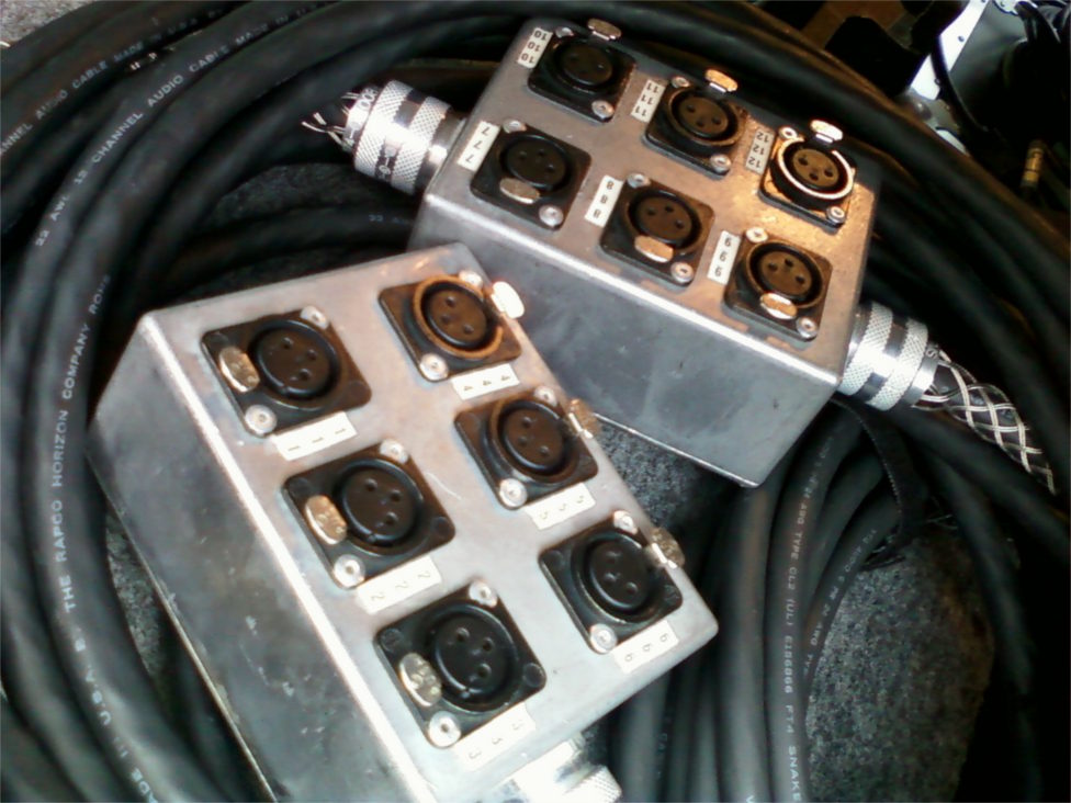

Sub snakes/ stage snakes go a long ways in cleaning up a stage, I have various lengths and channel count.
I also have made up a couple of stringer snakes with a box at the mid way in the snake, and have power drop
stringers as well.
The cable ramps in the link go more in high traffic areas.

Call me old fashioned but for on stage snake and cable runs I like good ole copper multipair with xlr connectors for a robust connection. I use heavy duty ethernet cable with ethercon connectors to the remote stage box.sub snake ? good idea ! I switched to Dante but for two or four links, cost is heavy. It may answer easily some cases...
