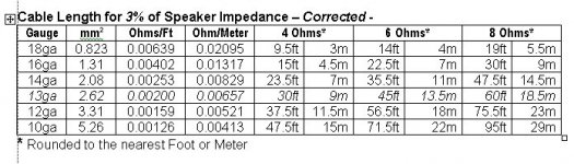

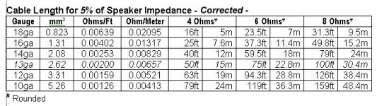

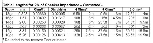

Here are charts for Wire Length based on Gauge and Speaker Impedance for various Percentage of Signal Loss. Keeping in mind that up to 5% Signal Loss is considered acceptable.
You can look up the proper lengths for RCA cable. If you are using decent cable, I don't see roughly 20ft as a problem.
As to speaker wire, I don't see 20ft as a problem. When you get closer to 50ft, the Inductive Impedance starts to trim away at high frequencies though. So on general principle, nothing over 50ft is recommended.

Now that the charts are on line, it makes it easier to post full sized versions -
In Europe the common wire is based on Cross Sectional Area and is 2.5mm², which is closest to 13ga (2.62mm²).

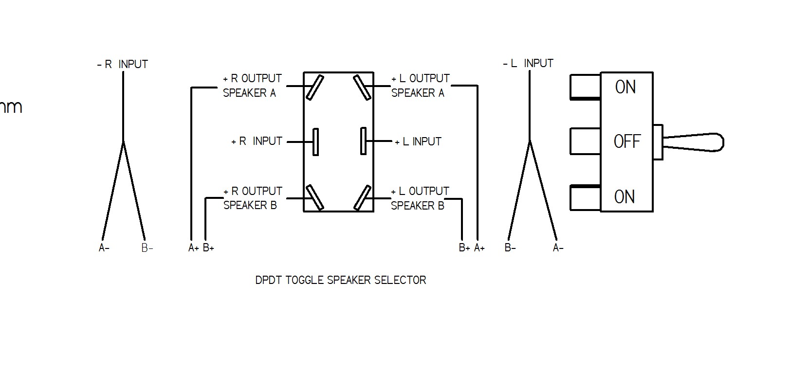

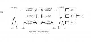

The switch and wires will be in a small chassis and I'll probably use Speakons for connections. Does the attached sketch make sense?
Thanks,
Henry
Looks generally good. Signal come in the center posts and goes out on either end depending on which speakers are active.
A few cautions, though minor and probably not actually a problem.
Break Before Make - there are two type of switches -
- Break Before Make, which is what you want. In this case, the old connection is broken before the new connection is made. This is the most common type.
- Make Before Break, which is much less common. In this case, the new contact is made before the old contact is broken. There are applications that require this, and this would not be one of those cases.
Your switch drawing says ON-OFF-ON, so it is a three position switch with a position in the middle with no contact? If so, then you can be sure it is a Break Before Make.
Next - Slide vs Points
- Slide contacts are what you want. In this case, when the switch is toggled, the contacts slide across the switch and make contact on the other side.
- Point contact have a tendency to bounce. These are like the points in a car's distributor, if you are old enough to remember that. Inside the switch is a rocker with Point-type contacts. The Rocker pivots from the middle like a see-saw or teeter-totter and when the switch is toggled, the points are pressed down on one side or the other. These will work, many household electrical switches are like this. But they do tend to bounce and they can arc if the voltage or current is high enough. We don't care about the fidelity of household electricity, but the arced switch points could degrade the sound quality.
Also, Point Contacts are the opposite ot the toggle, that is, when the switch is toggled to the right, the contact is made on the left.
The Slide switches tend to not bounce, and each time the switch it toggles the contacts tend to wipe themselves clean. And because there is no bounce, there is really little to no tendency for the contacts to arc.
Make sure the switch is overrated for Current. A 100w/ch amp can have about 50v available on the outputs, if we push the full 50v into an 8 ohm speaker, then the potential Current is -
Current = SqRt(P/R) = SqRt(100/8) = SqRt(12.5) = 3.54 AMPS
So, you probably want a switch rated at about 6 amps to 8 amps to give you some reserve.
Also make sure the voltage rating is sufficient. If there is a potential for near 50v, then you probably want at least a 100v rated switch.
Just a few thoughts but overall the switch should work.
I notice you are only switching the hot or red leads of the speakers. That's OK 95% of the time, because inside an amp, all the Grounds, input and output, are common to each other. They are all physically and electrically connected.
However, some amps aren't Stereo, they are Dual Mono, in which case, the grounds of each channel are not connected, or potentially are not connected.
Use an Ohm Meter and test for continuity between the two amp output Grounds, it there is virtually ZERO resistance, you are good. It you do measure resistance or an open, then you might want to consider also switching the ground wires.
On this last issue, I'll leave it up to others to confirm or deny, but that is my take on it.
Generally, though I think you are good.
