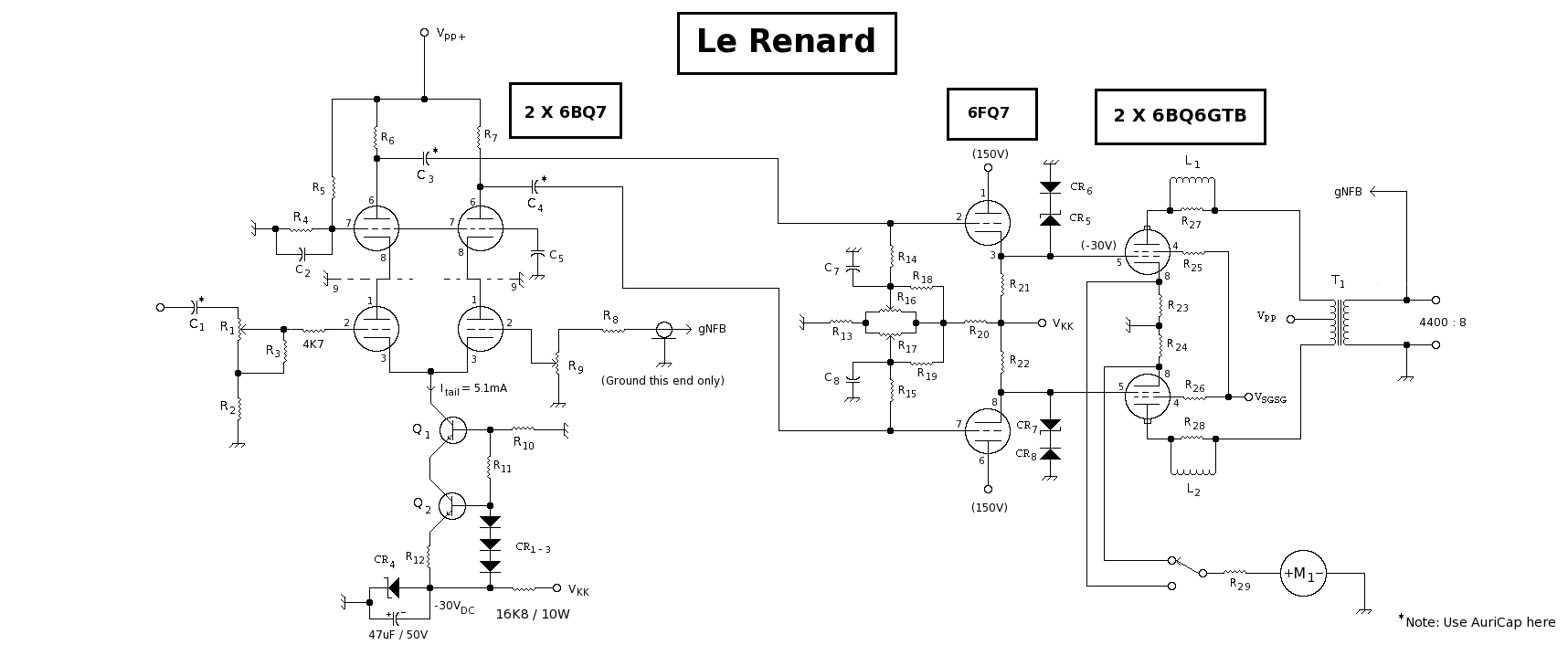

Hello. I'm new here and I'm looking for some design help. I'm designing an amp and in the phase inverter (typ long tail pair) is where I'm introducing negative feedback from the output transformer. Think very typical fender/marshal arrangement.
For some reason, when I connect the NFB (I'm using a connector to make it easy to switch transformer taps) it appears to be grounding out the power tubes. I'm not positive that that's what's happening but I notice the blue glowing cloud between the plate and cathode of each power tube disappears which to me says the tubes aren't conducting but I could be wrong about that as well.
Everything appears to be grounded correctly. My negative grid bias is pretty conservative right now putting the tube into about 60% of max dissipation. These are two EL34s in push-pull.
The amp works perfectly without the feedback. It obviously isn't going to have the correct sound I'm looking for without it tho.
Another possibility (instead of the tubes being grounded out) I'm considering is that the secondary of the output transformer is the opposite phase of what I think it is thus making it positive feedback. This feels right because when powered up with the NFB connected, the electronics hum at an increasing pitch til it reaches a maximum pitch which takes just a few seconds. Note this is the electronics humming, not the speakers. This happens without speakers connected. I don't have a scope, so I'm not sure on this.
If this is the case, what ways are acceptable to reverse the polarity of that signal? Should I change how I connect the secondary of the output transformer? For example, make the 8ohm leg the new common, the 16ohm will be the new 8ohm, the 4ohm would stay the same, and the common would be the 8ohm? This would change the polarity of the 4 and 8 ohm legs allowing me to use one them as NFB. The 16 would still be the same polarity but I just won't use that one.

I don't think you can use GNFB injected on the cathode of the LTP. Both cathodes are common so you would have positive FB on the non-inverted half. Also you must keep in mind that coming straight off the secondary with FB you will have a low impedance path to ground through the tranny that will then reduce the LTP cathode resistance since it is paralleled. You must have a FB resistor in the circuit or else the driver bias will then be out of whack.

Both Fender and Marshall did this. The FB is connected to the grid that is not fed by the preamp, and some of the FB also goes to the cathodes. A knob affects the amount fed to the cathodes (the Presence control).
No just swap the two plate leads. Leave the secondary alone.

Have you check if the 0 (zero) wire of secondary is connected to ground?
Only in this case you can send back (by resistor) a FB signal from one end ( 4 or 8 ohm tap).
This FB signal, normally, goes to the cathode of the first stage and not o the LTp and must be in phase; as written , you can swap the anode connection of the power tubes to get the right configuration.

Since you have a multi tapped output transformer, you shouldn't reverse the secondary. You can reverse the primary at the output tubes, the grids of the output tubes or the output of the phase inverter. Only reverse the phase at one place.
The feedback connection to the bottom of the tail resistor makes that resistor look more like a constant current source. This helps balance the phase inverter, which is of questionable value in a guitar amp.

Without an actual schemo, it's hard to tell much. If it's anything like this (attached) I can tell exactly what happens, since Mr. Murphy initially wired it for positive feedback. When advancing that feedback knob from zero, for awhile, nothing happened at all. Then, a small level, sinusoidal oscillation at about 1100Hz appeared: the phase neutral frequency. Adding more feedback first made it increase in amplitude. Then it became a slightly distorted sine.
Enough feedback caused it to oscillate like a Royer: distorted suqare waves at about 20Hz that brought the 8R test load resistor to red heat in about a minute. Here, the frequency determined by the volts/turns ratio of the OPT.
That meant switching the plate connections to the primary side of the OPT to reverse the phase of the feedback from positive to negative. Then, no more problems.
