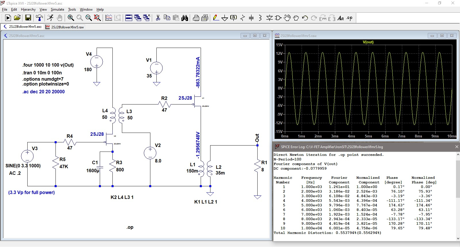

My first version will be 2SJ28 driving 2SJ28. I also have some 2SK180ES and THF-51S for outputs and some Russian 2P926B for voltage amplifier. The larger SITs will require a bigger driver voltage swing for full power; that will need some experimentation.

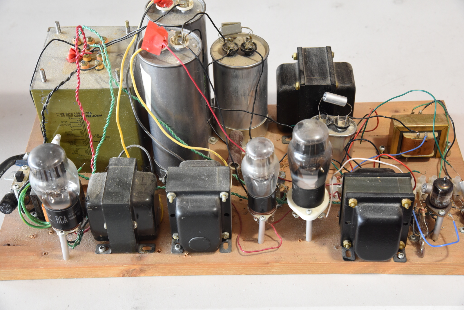

A couple of photos below show my breadboarded 5842 IT 45 tube amp monoblock with its LCLC power supply, interstage transformer, and output choke and parafeed transformer. The interstage transformer is shown in the last picture.

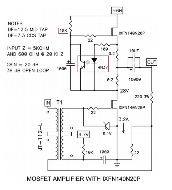

To accomplish the goal of "no coupling capacitors", bias voltage source V2 needs to be a circuit with very low output impedance, AND it must be capable of both sourcing and sinking the audio signal current (coupling transformer secondary current) which charges and discharges the gate capacitance of the output VFET.

Oh, now I understand. When you said V2, for some reason I was thinking in vacuum tube terms and thinking about the second VFET in the amp. You mean Version 2. Think of me as the Karate Kid and you as Sensei Myagi. I'm a step behind you.
For Version 2, my thoughts are that I would replace the 2SJ28 source follower with a 2SK182ES follower and adjust Vds, Vgs, and transformer load and go from there. I would use a separate power supply for fixed bias. Now, I will look at the operating voltages and think about what you said.

what I was saying, and Mark complemented is - your V2 ( SIT Bias voltage source) "must" have as final element some sort of voltage follower ( be it emiter or source follower), obtaining low output impedance in DC domain
not necessary, but handy to have - in both AC and DC domains
observe how Papa made big Schade mosfet amp , arrangement of xformer secondary and biasing of mosfet
there low impedance is not a must in DC domain ( see 10K ) but for AC domain there is big elco, as low impedance path to GND
all this - simply because SIT gate is somewhat less predictable beastie than mosfet gate
while I was making Singing Bush, I was thinking about these issues - and result is biasing of input JFet buffer, while SIT gate is DC connected to JFet buffer output and - with hefty 20mA of buffer Iq, SIT gate is pretty much taken care of
Low AC impedance, something like a good size capacitor for example...

Then that capacitor is in the audio signal path as well as any series cap, isnt it?
How about an op-amp configured as a voltage source? That could sit at 8V and both sink and source current in its effort to keep the node from deviating.
