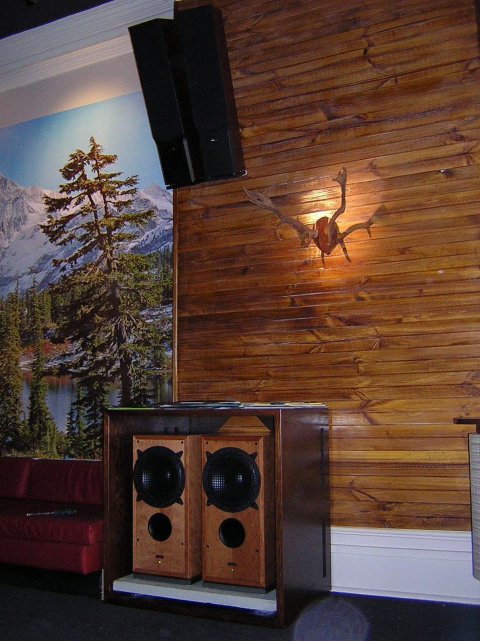

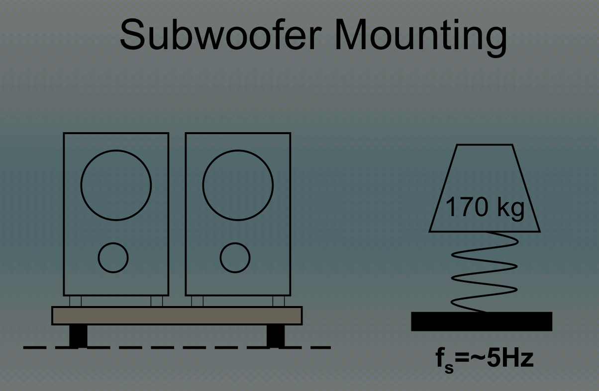

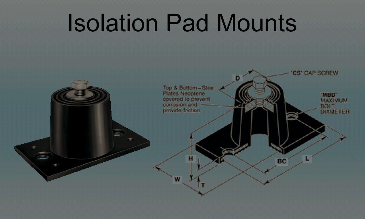

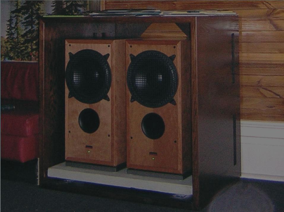

I had a need to isolate subwoofers for a small nightclub. The basic principle of isolation is mass on compliance. Hence to increase the isolation the objective is more of both. In this case I suspended a precast concrete paver on industrial vibration isolation mounts, chosen to give a natural resonance with the subs on the slab of ~5Hz. This forms a mass / spring / damper system which acts like a low pass filter, preventing the coupling of frequencies above resonance with a first order slope of 6dB per octave, or about 12dB at 20Hz, 18dB at 40Hz, etc.

In the example I posted above decoupling the subwoofers from the structure of the building made an extraordinary improvement to the perceived quality of bass - even live recordings of bands thumping away sounded extraordinary throughout the entire space. Speakers are in the reproduction business, but the room structure is not and benefits from being decoupled, rather than being allowed to be an uncontrolled auxiliary coupled resonance system.

Have look at this site Technical Info - AV Industrial
They have conical pads, for a couple of quid each, along with industrial mounts as per johnmaths comments.
(FYI, the AV stands for ‘anti vibration’ not ‘audio visual’)
