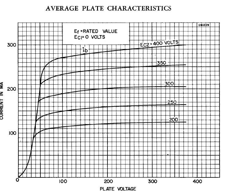

Just a heads up new Tung Sol 7591 does not have the full ability to deliver anode current as "real" NOS 7591 from the past do.
The charts on the new 7591 confirm this reality.
Same only more for the JJ version.
So best to temper expectations.

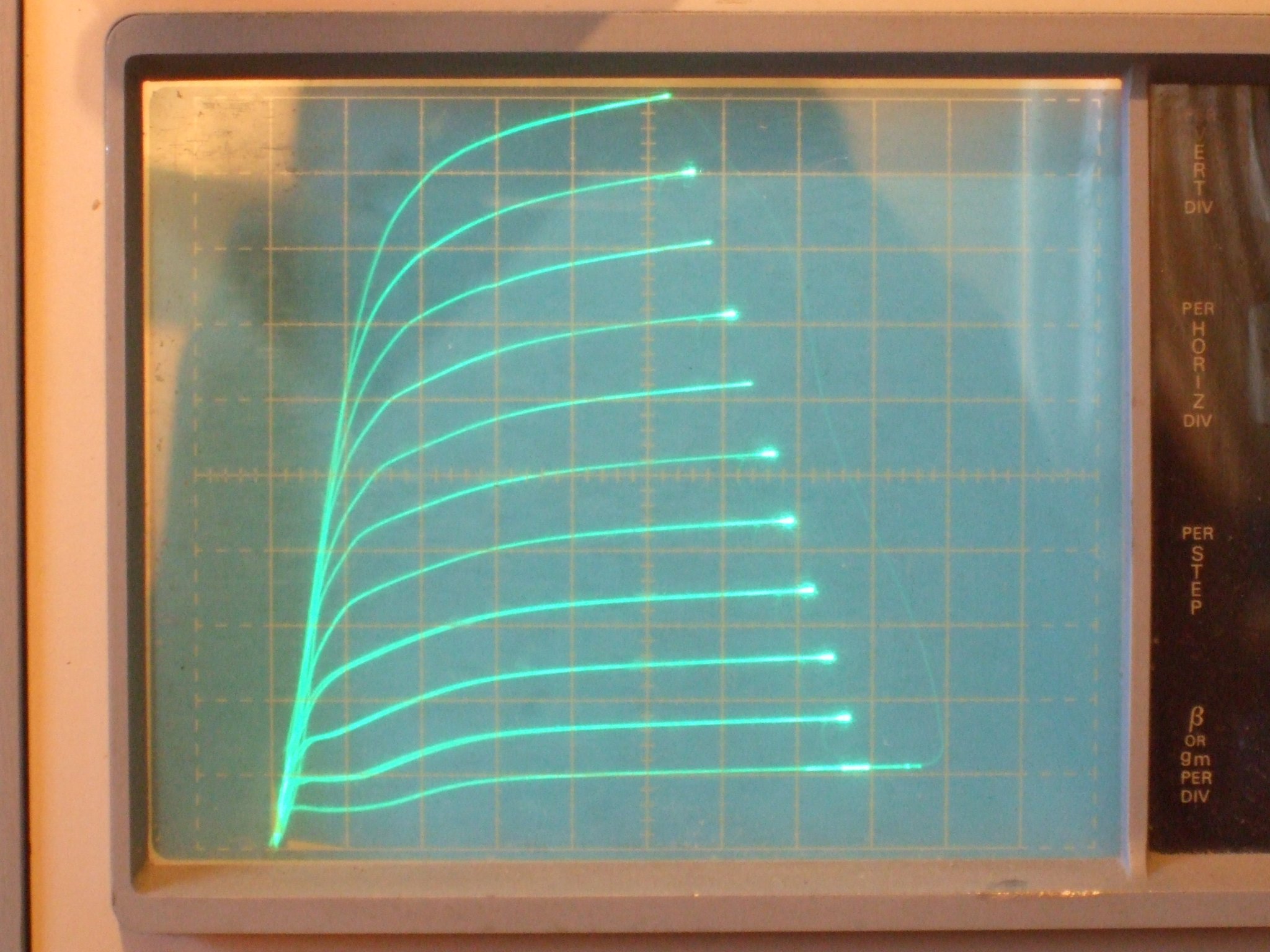

When a different set of tubes delivers the expected 25 watts with a given supply voltage and output transformer, and the 7591’s struggle to give me 15 it’s the tubes, not the transformer or the way voltage is being measured. I was asking for less than 200 mA of peak anode current and 7591’s should be able to do that without running the screen all the way up to 400.
Probably less than the specified cathode emission.
High screen voltage to get enough plate current, may strip away the cathode coating with time.
I remember there were some RF power tubes that can self sustain the cathode heating after the high plate current begins.
Do not attempt to do this with Audio Power tubes.
See "Eico ST40" thread posting on 2024-07-12 11:44 pm.Probably less than the specified cathode emission.

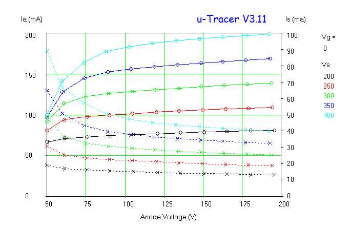

Current production 7591 tubes do not deliver the full anode current of NOS 7591s.
The result is except in lightly loaded circuits current production 7591 tubes deliver less power output sometimes substantially less than NOS 7591.
See chart below.
Really I feel current production 7591s should have a different part number as whatever they are they are not a 7591 by the 1960s data sheets.
Lots of people are tearing out hair wondering why their vintage amplifier has low power with a "new" set of 7591 tubes.
Myself was included in the hair pulling until I measured the anode current curves VS G2 and G1.
It then was very clear that full power was not going to happen with current production 7591 except in lightly loaded amplifier designs.
To compare a little 6BQ5 with 250V on its screen can deliver more anode current than a JJ7591 can with 300V on its screen.
No I am not saying to plug in 6BQ5s in place of 7591!
That looks about right for the EH, too. No, maybe you can’t just drop in 6BQ5s into a 7591 circuit but you could build just as big an amplifier with them as you could new 7591’s.
A set of 4 6BQ5 (two in parallel on each side as P-P) delivers pretty much what a pair of old school 7591s delivered in terms of performance and with lower screen voltages.
