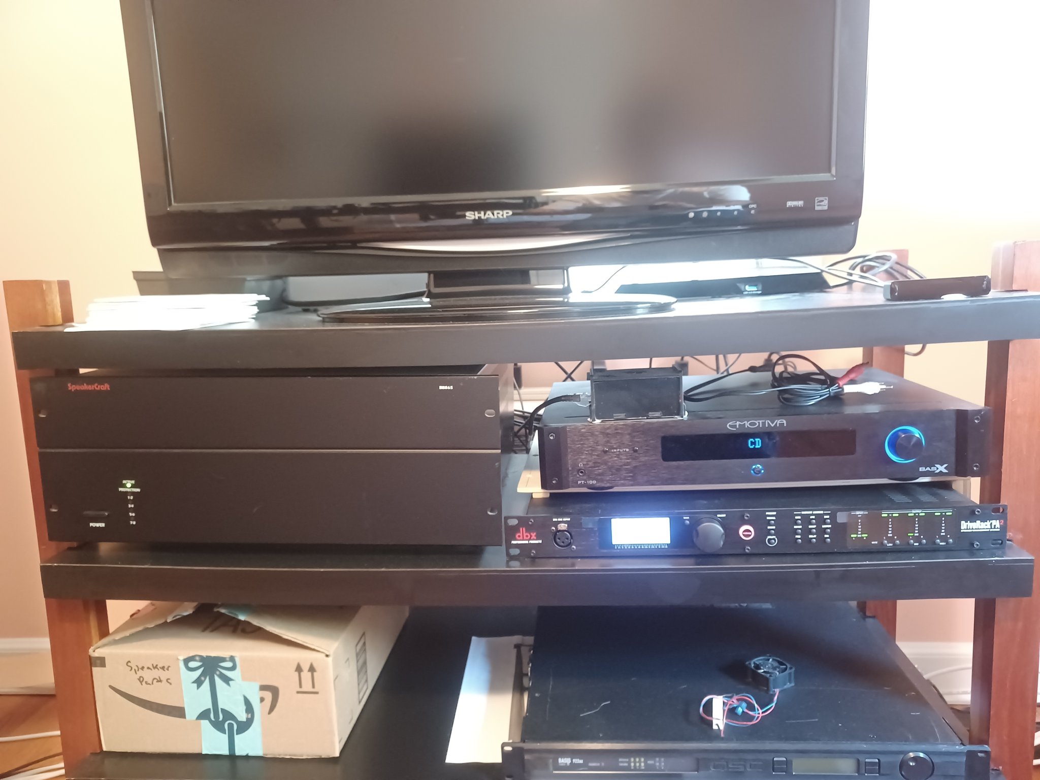

I received the dbx Drive rack PA2. I Spent an hour or so figuring out the PA2 Control application. Here are my first impressions in no particular order.
Here it sitting in its new home.
- Mark100's opinion is spot on, the QCS is vastly for configurable and I wish I was willing to spend more and get one.
- It doesn't have Bessel crossovers or any way to make a custom slope.
- The delay has 20uS steps which limits my ability to precisely time align my drivers
- The two items listed above made me give up on creating a Harsch crossover, so I just made an LR24 and called it a day
- I love the AutoEQ, this made up for all the things it lacks vs. the old QSC it replaced.
