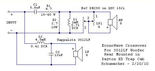

Looking for old Econowave schematic
A couple years ago I bought crossover components for a 2 way Econowave design using the B&C DE250-8 driver and a 15" Altec woofer. All I have are the parts values for the 1.1 Zilch circuit board I also bought. If someone kept up the schematics and could find this one, I'd very appreciative. I may have R1 and R2 switched.
L1 1mH
L2 4.5mH
C1 5.6uF
C2 12 uF
R1 2.7
R2 4.7
