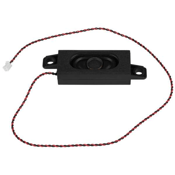

There are a lot of speaker modules for laptops and LCD monitors/TVs that might be useful. You might be able to fit multiple drivers in the case to increase output.
I'm not suggesting this is necessarily the best one, but something along these lines includes the enclosure for the speaker, so part of the design is done for you already.
https://www.parts-express.com/5-8-x-1-1-2-2W-Speaker-4-Ohm-78G311-503-YL-69-289-2070
