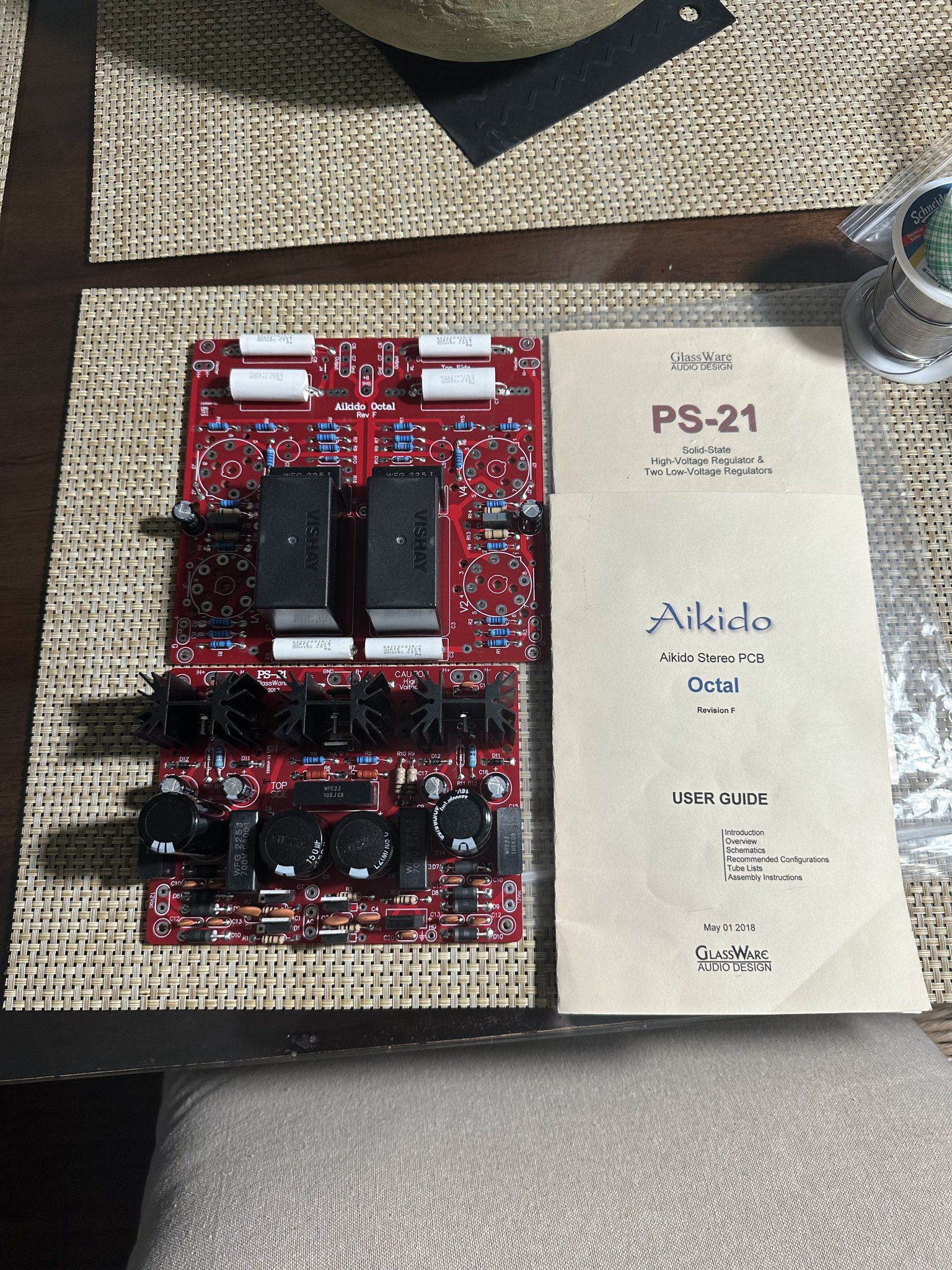

will this work for my heaters? I have decided to use Broskies ps-21 power supply.

A 1182L12 should be fine.

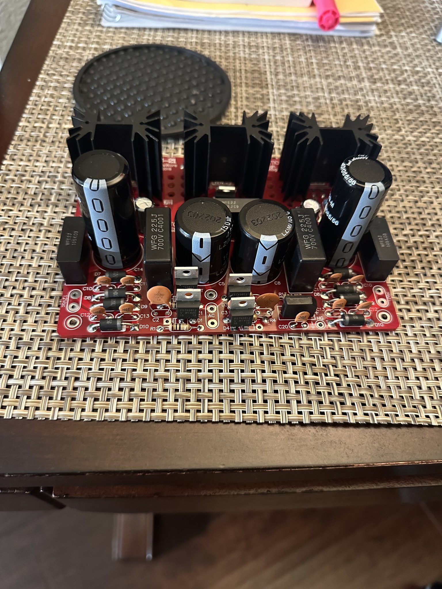

Some things about the PS-21 you should be aware of:
1. C14 (x2) as supplied by Broskie might be 16 volt-rated caps. The raw rectified filament DC that the C14s see might run slightly higher than 16 volts. As a safety measure, replace these with 25 volt rated caps.
2. Unlike some of Broskie's other supplies, the filament negatives aren't tied to a portion of the B+ supply through a two-resistor dividing network. The divider is to float the filaments above ground potential and make life easier on the tubes. You might have to implement this yourself or if you are using 6SN7 tubes the floating arrangement might not be necessary. I have little experience with 6SN7s, others should comment.
3. Make sure you put the components on the correct side of the board. The correct side is the one that has the PS-21 and CAUTION High Voltage stenciling.
4. As a safety measure, I like to put a layer of Kapton tape on the board where the traces might might "interfere" with the heat sinks. This primarily around the B+ 'sink.
5. Don't forget to buy some heatsink thermal compound to use when mounting the regs to the 'sinks.

Hi, thanks for the reply. c14 is rated at 16v. Increasing these will make them even taller. I considered using a low-profile case for this or possibly making holes to accommodate the taller caps. I will be using all 6sn7 tubes as I am trying to make it a line amplifier. I also forgot to put grease on the supplied micas. .🙄...Can you recommend a starting point for the r12 resistor? I am not sure about that so I left it out for now. this is the single secondary transformer I am going to use.

I might have an earlier version of the PS-21 than yours. The R12 on mine sets the filament voltage and is between the ADJ pin on the LD1085 and ground. If this is the same on your board Broskie usually supplies 3 resistors for each reg. Assuming you are wiring two 6SN7 filaments in series (therefore 12 volts) you can choose 12 volts (1.07K on mine) or 12.6 volts (1.13K on mine). Under-running them at 12 volts, instead of 12.6, could extend tube life and the circuit will run virtually the same as at 12.6 volts.
The Hammond should work fine. Other good choices are similar transformers form Triad (from Mouser) or perhaps there might be something similar from Antek.

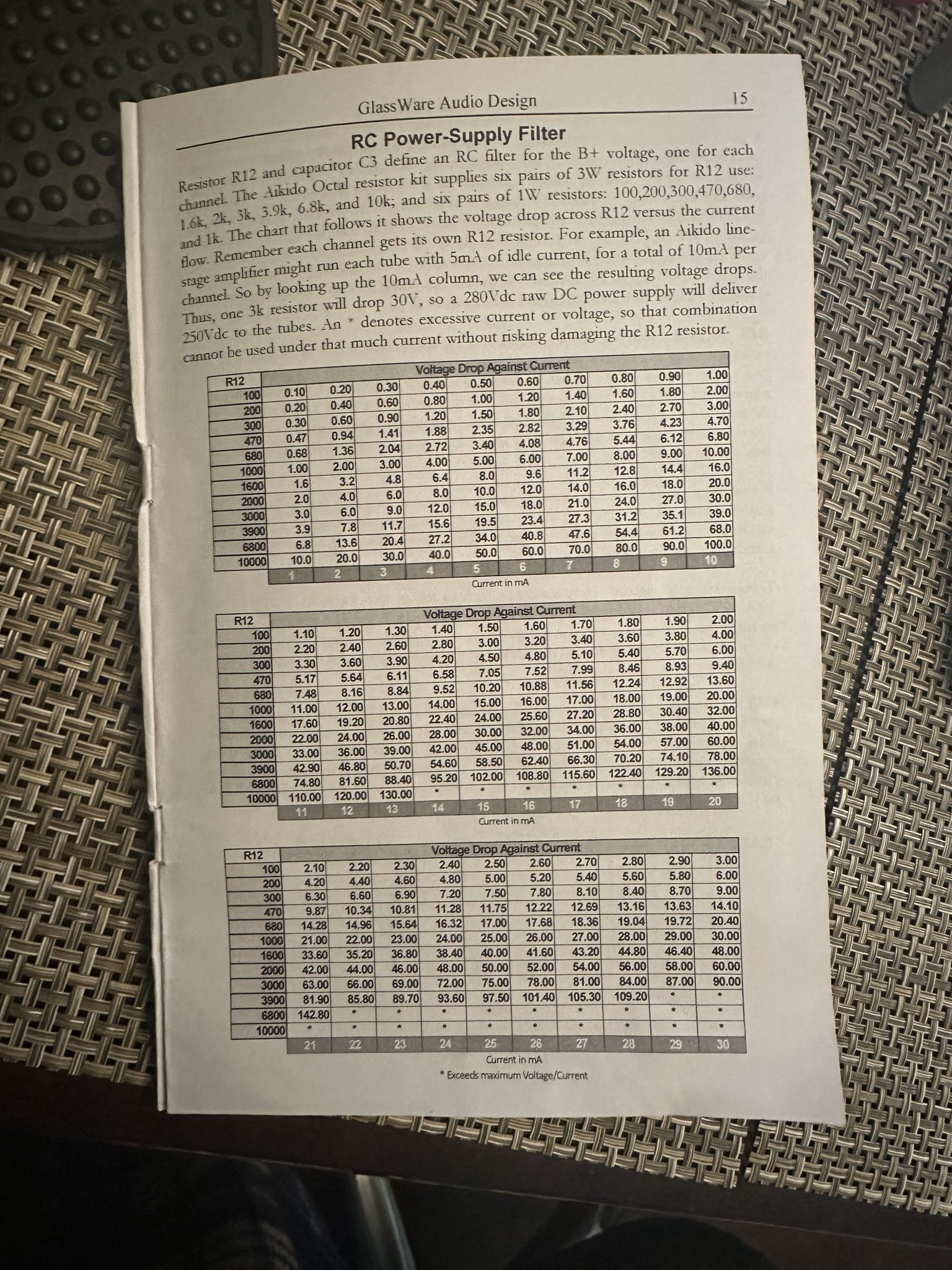

2. Page 8 shows what he recommends for transformers and page 15 shows an RC power supply and a resistor for setting up the b plus.
I am confused about the r12 resistor on the octal board on page 15

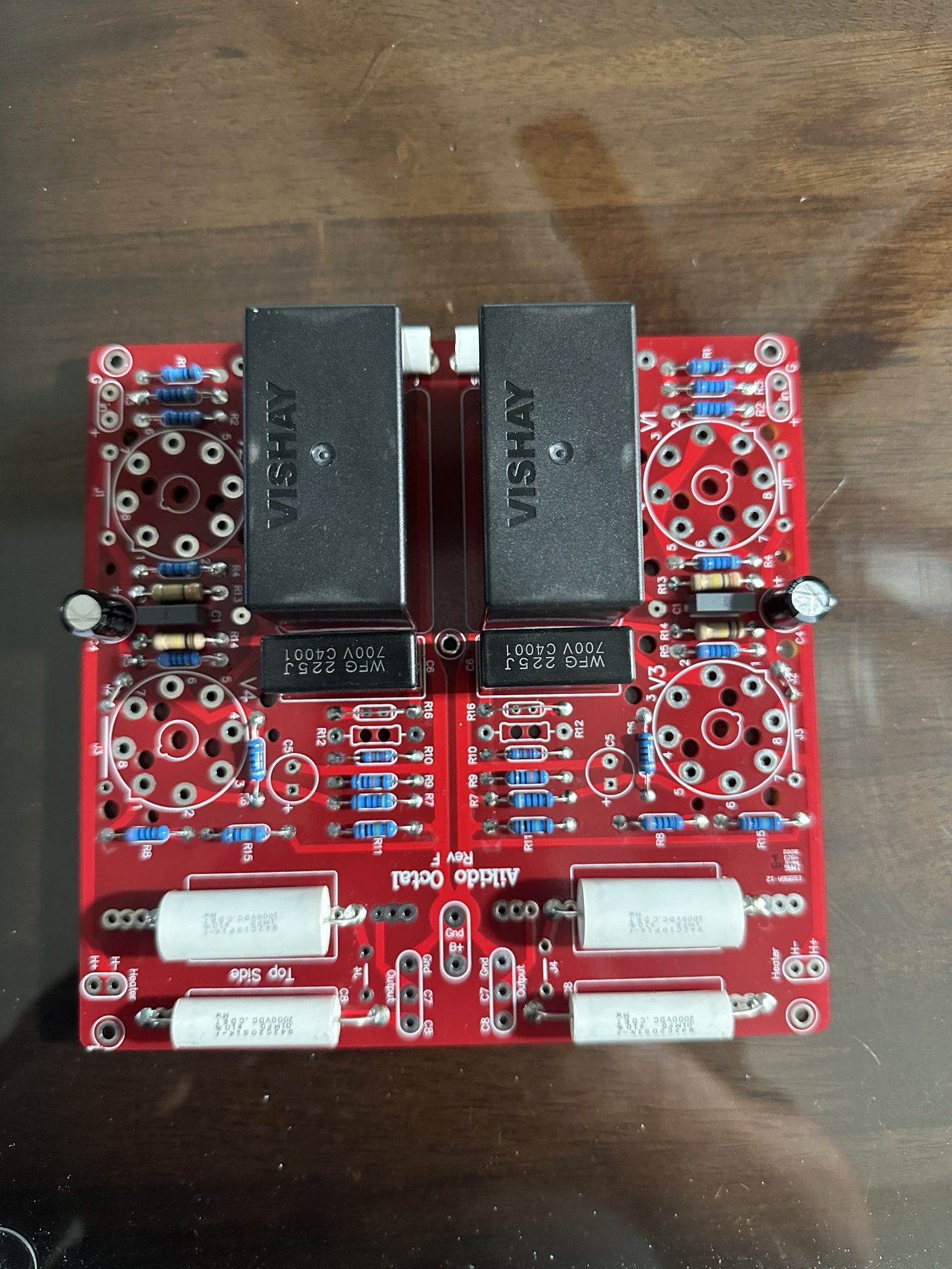

You need two separate 12v windings.. I use two small toroids, a dual 12v and a 115-0-115 to give about 280v pre regulator, and 220v to the Aikido.
The R12 on the PS21 is not the same as R12 on the Aikido. You can omit the one on this if using a PS21 unless you want to lose some HT volts.
HI, leave the r12 resistor on the octal board out?
