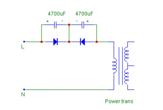

The DC blocker also seems a must with many toroids. Another common made mistake is to sandwich the toroid between 2 metal plates that are in connection with eachother. There will then be a shorted winding.
IF the VA rating is right, a DC blocker is used and the hum persists... one could think of potting the toroids but only if it is mechanical hum by the windings and the transformers don't heat up (so overdimensioned a little).

How would I measure any DC component in the mains supply?

A plethora of sources pollutes today's AC power mains with all sorts of trash. 😡 Disposing of any DC bias is easy enough for a DIYer. Use "Da Blok"!
Another thing to do with toroidal power trafos is placing ferrite beads on the primary side connections. Toroids exhibit a large bandwidth and can pass crud into PSUs.

Like SMPS have a false good reputation at the dark side of audio toroids also have a false good reputation with audio DIYers. Truth is that they are not the best and that they're much too wideband and much too sensitive to DC component in mains voltage.

Anyone can when it occurs en when the right equipment is there but not many have a scope that is safe for mains measurement use. Mine is the required differential one and I still have sweaty hands when measuring straight on mains lines. Anyone that is professionally in electro has followed at least 1 course where the DC part is discussed. Same at short circuit theory and practice where a large DC component occurs.
So, one can deny facts 🙂 but then why do the DC blockers work?
Sometimes it maybe is better to accept knowledge and get along with the newly acquired wisdom.
