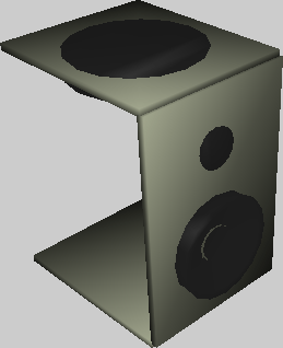

General design :
The speaker consists of the sides needed to house the woofer/midrange, tweeter and the woofer on the upper surface (1 speaker only). The lower side is for support, these speakers can be placed on a desktop or possibly wall mounted. Open baffle speakers are best not mounted directly on the wall: a space of 20 cm or more between the rear of the driver and the wall improves sound considerably.

an open baffle/dipole speaker will have a very deep null at 90deg off-axis, usually parallel with the edge of the baffle.
that's the purpose actually, to reduce unwanted reflections from off-axis radiation.
if you mount the woofer horizontally that null will be directed right at your ear.
Yes thanks. so then where to mount the woofer, and more importantly, is there a mid/woofer plus tweeter combination in an open baffle that will sound great with proper equalization? That is the question here.
It's hard to design a tiny open baffle speaker. The physics of the design push you towards 3+ ways and large bass drivers to overcome the cancellations that increase rapidly with lower frequencies. And 20cm placement from the walls might be acceptable with the mids but will play havoc with the bass response.
If you want desktop small, I would consider a sealed sub-bass module and a separate mid-woof/tweeter on an open baffle. You could look at the Aurasound NSW2 wich is a 2" full-range with a unique magnet that is open to the rear, unlike most "normal" tweeters. And it could cross very low (well under 1000Hz I think) to a 6" or 8" woofer. Are you planning to use active filters with DSP or passive crossovers? Active makes an open baffle design much easier.
Also, check out the Pluto design from Sigfried Linkwitz. Not an open baffle but an omnidirectional that might give you the open and spacious sound you desire in a desktop friendly package if you make the mid-woofer enclosure small. Lots of DIY builds that use that design principle. BTW, it uses a woofer placed horizontally like you have proposed but it is in a sealed enclosure.

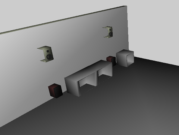

The problem with satellite sub-woofer systems - I was listening to one in the store the other day - is that it is inconvenient to place the woofer on the floor. Two speakers will work out fine, each mounted on a wall with the correct height and angle, but where to place the sub-woofer - in between?
I came up with the idea of two speakers - the satellites speakers - mounted on the walls - these could be full range or mid-range + tweeter, and the sub-woofer mounted directly below, also on the wall, as it was a part of the main speaker, connected by a sort of invisible tower. The weight of the satellite speakers is a concern, by separating them from the heavy woofer cone, they can be mounted easily higher up.
One sub-woofer box could be used, the other one a dummy - a space for storing CDs or DVDs or other things.

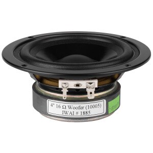

A 5" woofer combined with the tweeters I already have would be the best design for my purposes. I looked at full range speakers, however a dedicated woofer with a tweeter will give me the best chance of approaching the performance of the bookshelf speakers I have. PC speakers by themselves are capable of producing good music but not bass, so this is where the woofer will improve the range and performance of the system.
So we go on to Parts Express > woofers and sort by price: Shipping is the same cost for 1 or more items so better order more stuff...
https://www.parts-express.com/speak...anges-tweeters/woofers?order=pricelevel12:asc
4" Treated Paper Cone Woofer 16 Ohm
22 Reviews
BUYOUT$5.80
In Stock
Part# 299-320

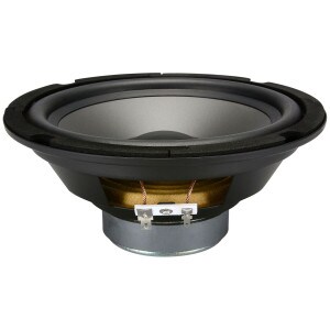

6-1/2" Poly Cone Midbass Woofer 4 Ohm
248 Reviews
$6.98
In Stock
Part# 299-609
SHIPPING $8.95
Additional Shipping Options & Tax Calculated At Checkout

Placing tiny open baffle satelites on the wall is a mistake. Too many reflections interacting with front signal. Small closed bookshelf would be better, but still with lots of compromises.The problem with satellite sub-woofer systems - I was listening to one in the store the other day - is that it is inconvenient to place the woofer on the floor. Two speakers will work out fine, each mounted on a wall with the correct height and angle, but where to place the sub-woofer - in between?
Not sure what you are after.
You obviously do not understand the concept of satelites and subwoofer. Once proper crossover for subwoofer is selected and its high pass filter is proper slope, you will not be able to localize, or hear, where the sub is.
Theoretically you can place it anywhere, but each placement will have different response. Mainly due to wall reinforcement.
Neat trick is to place the sub in your listening chair and then crawl around the room and find the most natural sounding bass, and place the sub there. Reciprocity.
