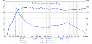

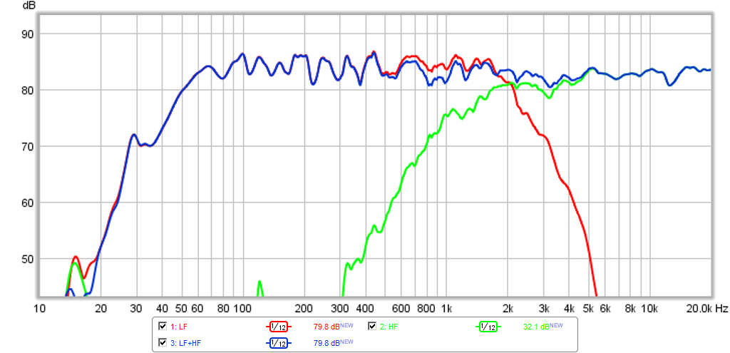

Frequency response showing XO profiles:

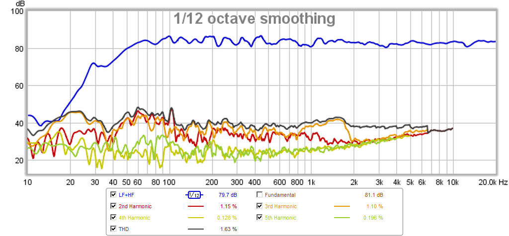

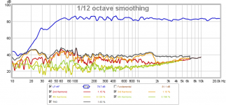

Harmonic Distortion:

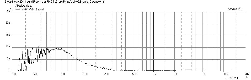

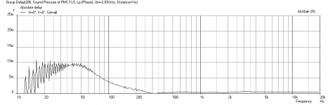

Group Delay (with 1/2oct smoothing for clarity) is about 6.7ms at 50Hz:

XO plot:
Phase - +/-23deg over 150Hz to 15kHz :
Harmonic Distortion - about 1.4% at 50Hz at normal listening levels:

Group Delay (8.6ms at 50Hz - increased 2ms due to BW1 HPF at 32Hz):

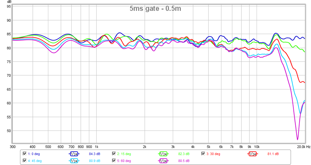

Edit 10/31/15: Polar data shown has tweeter rebated and brillo pad diffraction reducers installed
![512027d1446305118-low-cost-pmc-inspired-tl-monitor-dc130a-dc28f-pmctl4-2khz-polar-rebate-brillo.png](https://www.diyaudio.com/forums/attachments/multi-way/512027d1446305118-low-cost-pmc-inspired-tl-monitor-dc130a-dc28f-pmctl4-2khz-polar-rebate-brillo.png)

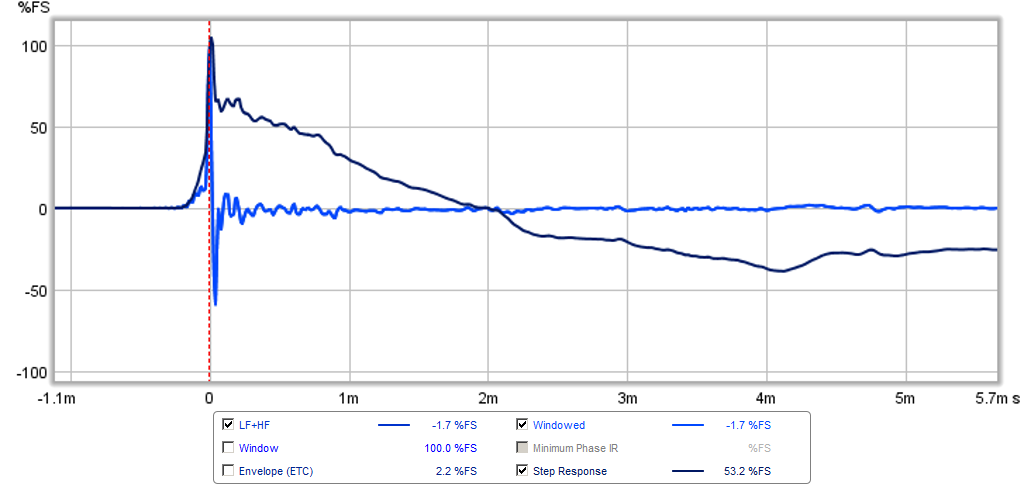

Impulse Response/Step Response - very nice:
![512034d1446307612-low-cost-pmc-inspired-tl-monitor-dc130a-dc28f-pmctl4-2khz-ir-sr-rebate-brillo.png](https://www.diyaudio.com/forums/attachments/multi-way/512034d1446307612-low-cost-pmc-inspired-tl-monitor-dc130a-dc28f-pmctl4-2khz-ir-sr-rebate-brillo.png)

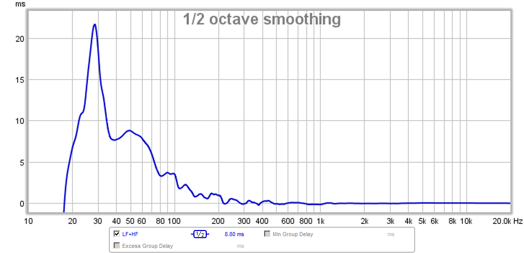

![512035d1446307612-low-cost-pmc-inspired-tl-monitor-dc130a-dc28f-pmctl4-2khz-gd-rebate-brillo.png](https://www.diyaudio.com/forums/attachments/multi-way/512035d1446307612-low-cost-pmc-inspired-tl-monitor-dc130a-dc28f-pmctl4-2khz-gd-rebate-brillo.png)

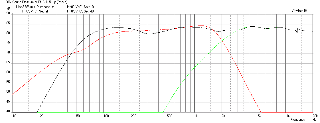

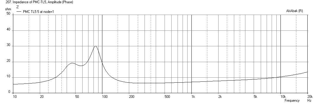

Good choice! That was my backup driver and have simulated it as well. Very good performer for a TL. Let me see if I can dig up the sims for you - it might be a drop in replacement for DC130A.
TL Design for 5FE120
This driver is basically almost a drop-in fit for this TL design. Just change the internal width to 5.5in (from 6.0) and you are good to go. About the same sensitivity vs the DC130A-8 but with 5mm of xmax so ultimate SPL should be higher. Nice driver - I hope to try one someday soon.
Here is predicted frequency response with moderate stuffing, 67Hz f3:

Here is the impedance:
![511865d1446237844-low-cost-pmc-inspired-tl-monitor-dc130a-dc28f-pmctl5-5fe120-impedance.png](https://www.diyaudio.com/forums/attachments/multi-way/511865d1446237844-low-cost-pmc-inspired-tl-monitor-dc130a-dc28f-pmctl5-5fe120-impedance.png)
I say go for it!

2kHz XO
So I decided to try moving the XO point to 2kHz. The responses on both drivers is quite smooth so it was an easy matter to just go in and nudge the electrical XO points upwards. I ended up 1900Hz BW4 LPF for the DC130A and 2500Hz BW1 HPF on the DC28F with a 0.40ms delay on the tweeter. I also put a BW1 HPF at 32Hz on the woofer to limit over-excursion and reduce HD at the low frequencies. This had a +2ms penalty on group delay at 50Hz, ending up at 8.7ms but I think is worth it. The acoustic XO is exactly at 2kHz.
Measured Frequency Response and Acoustic XO plot:
Measured Harmonic Distortion - note increased HD at 1.7kHz due to woofer - but a good trade-off for better overall sound:
Measured Group Delay (increased 2ms due to 32Hz HPF:
Measured Phase:
![511900d1446260177-low-cost-pmc-inspired-tl-monitor-dc130a-dc28f-pmctl4-2khz-hd.png](https://www.diyaudio.com/forums/attachments/multi-way/511900d1446260177-low-cost-pmc-inspired-tl-monitor-dc130a-dc28f-pmctl4-2khz-hd.png)
![511906d1446260448-low-cost-pmc-inspired-tl-monitor-dc130a-dc28f-pmctl4-2khz-gd2.png](https://www.diyaudio.com/forums/attachments/multi-way/511906d1446260448-low-cost-pmc-inspired-tl-monitor-dc130a-dc28f-pmctl4-2khz-gd2.png)
Measured Phase:
![511901d1446260177-low-cost-pmc-inspired-tl-monitor-dc130a-dc28f-pmctl4-2khz-gd.png](https://www.diyaudio.com/forums/attachments/multi-way/511901d1446260177-low-cost-pmc-inspired-tl-monitor-dc130a-dc28f-pmctl4-2khz-gd.png)
Measured Impulse Response and Step Response - pretty much this is as good as it gets for a basic eyeballed Harsch XO.
![511902d1446260177-low-cost-pmc-inspired-tl-monitor-dc130a-dc28f-pmctl4-2khz-ir-sr.png](https://www.diyaudio.com/forums/attachments/multi-way/511902d1446260177-low-cost-pmc-inspired-tl-monitor-dc130a-dc28f-pmctl4-2khz-ir-sr.png)
The time alignment now is excellent and I can hear it when playing the percussion on the jazz tracks as you will also hear when you listen to the clips. I really like the XO much better here at 2kHz despiite the increased HD bump from the woofer at 2kHz. The woofer handles much more of the mid range with real authority and it lets the little tweeter do its job with the shimmer and detail. Here are some sound clips of jazz piano/bass/drums, and female vocals. Change the .asc extension to .mp3 to play.

The little 19mm SEAS has IMO the advantage that it
doesn't need any padding when paired with the Faital.
That implies your ignoring diffraction/BSC, which is never good.
You can do a lot better than current with a proper x/o design.
rgds, sreten.

Polar Measurements
I tried a polar measurement with the tweeter just surface mounted no rebate and it looked terrible with sawtooth diffraction. So I added some foam core sheet trim to flush mount it - like it was rebated. I also added some pieces of Scotchbrite scouring pads glued around in a rectangular pattern a la LS5/3A. The measurements now look outstanding. I was using some EQ before to get the on-axis flat response but off-axis the diffraction was still there. So now there is no EQ except for a very mild +1.5dB Q=1.2 at 5100Hz. The data was collected with a 0.5m mic distance and gated 0.5ms before and 5ms after.
The variation is about 5dB up to about 13kHz and mostly less than that. It also shows that the tweeter XO frequency integrates very well with the woofer at 2kHz. Walking around the room it sounds very uniform and I imagine in stereo, the sweet spot would be pretty wide. These budget Dayton DC28F's are very nice performers.
The legend shows values for the cursor at 6kHz.
