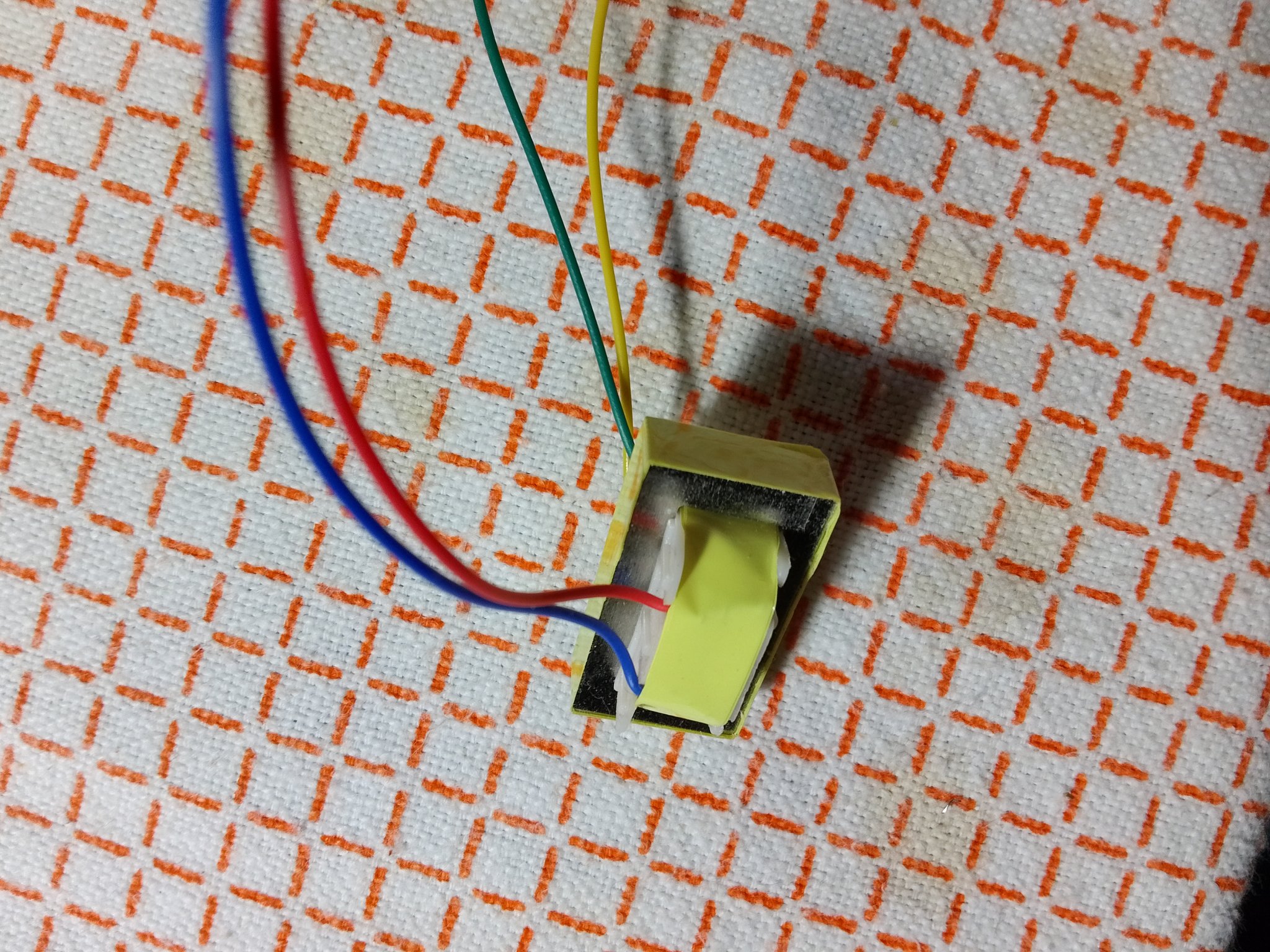

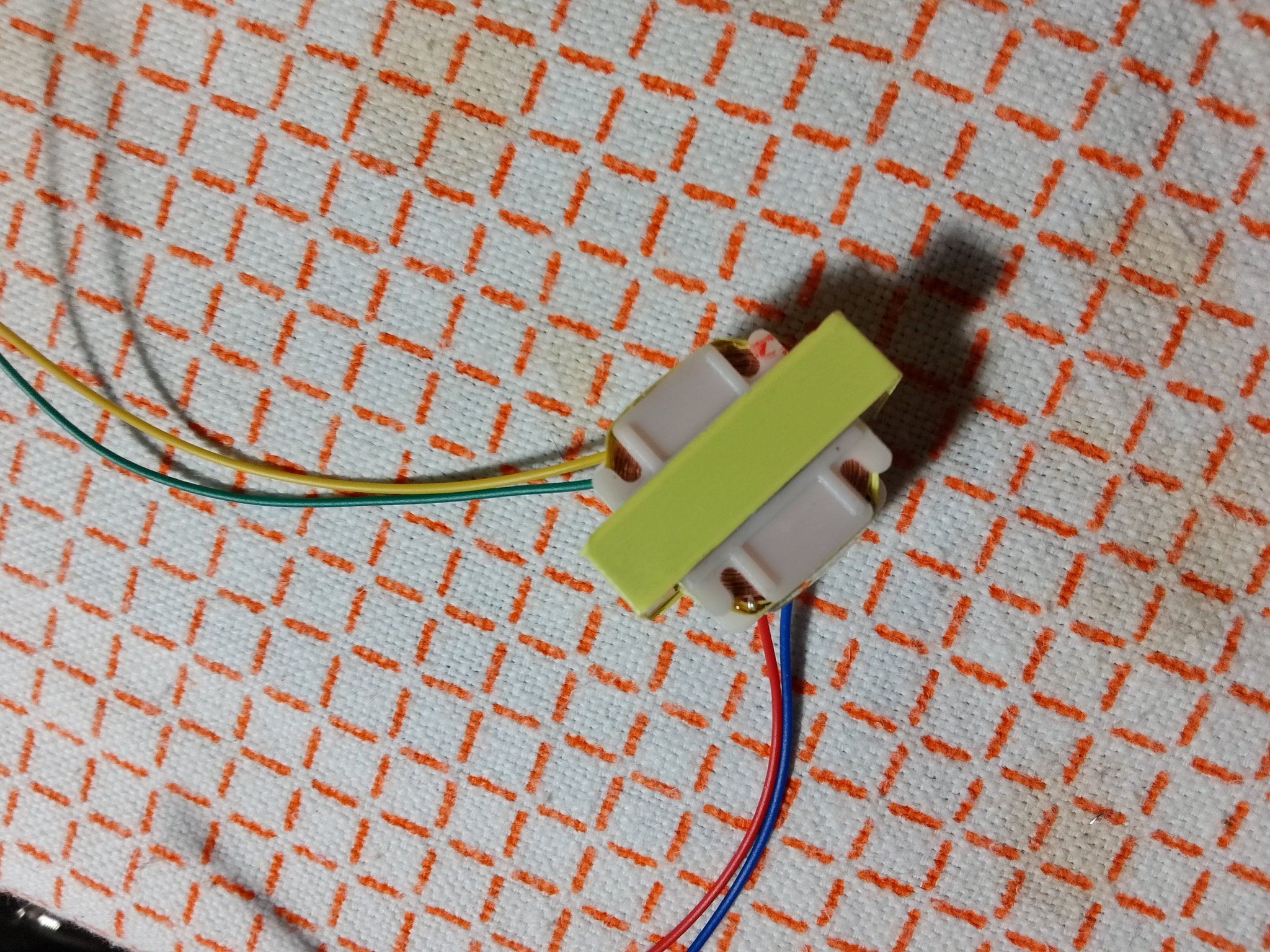

Has anyone ever tried transformers as used in these 5$ - electrical mosquito-killer racket inverters?

are they ferite or can you post a photo?Has anyone ever tried transformers as used in these 5$ - electrical mosquito-killer racket inverters?
