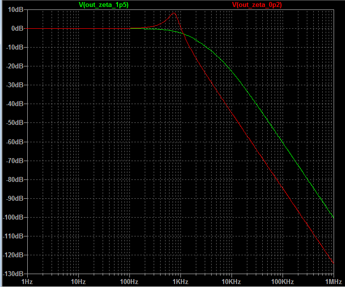

Here are two second order lowpass filters, see Figure 1.

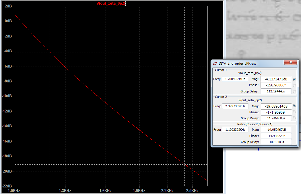

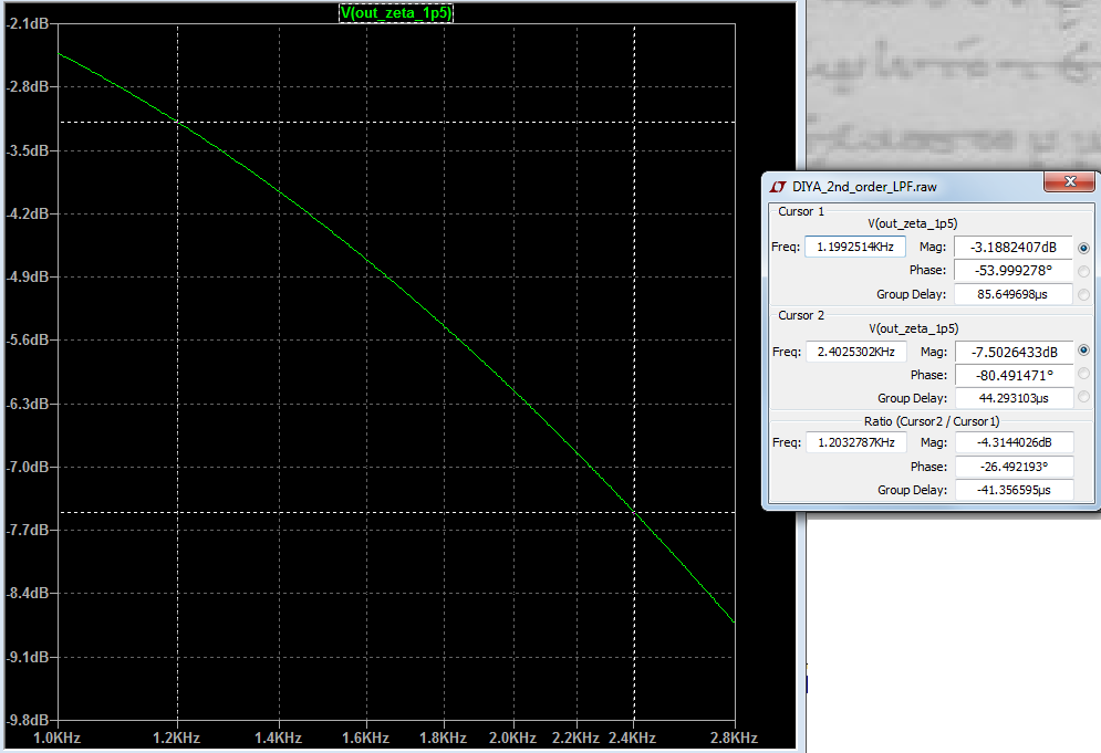

Both have a -3dB corner frequency of 1150 Hertz. Just barely below 1.2 kHz. See Figure 2.
The filter plotted in green, has a quality factor Q of (1/3), namely a damping factor zeta of 1.50.
The filter plotted in red, has a quality factor Q of 2.5, namely a damping factor zeta of 0.20.
For the filter plotted in green, (Vout_2400_Hz / Vout_1200_Hz) equals -4.31 dB. A factor of 0.609. See Figure 3.
For the filter plotted in red, (Vout_2400_Hz / Vout_1200_Hz) equals -14.95 dB. A factor of 0.179. See Figure 4.
If Vout_2400_Hz = 4.0 volts, then Vout_1200_Hz is either 2.436 volts (green), or else 0.716 volts (red).
