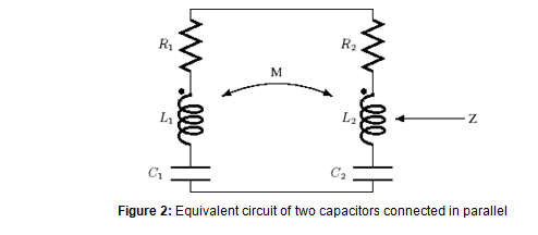

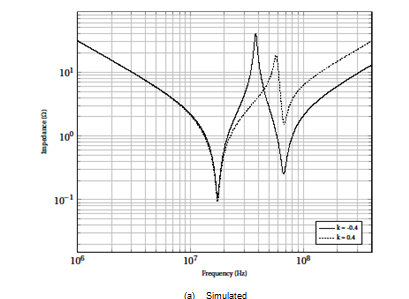

If you put two capacitors in parallel, they each have an ESR (equivalent internal series resistance) and some inductance due to the capacitor construction and the PCB traces or planes connecting them in parallel, so you get this:
If you squint a little bit, it is apparent that while the capacitors are in parallel to filter the power supply, to study how they will resonate, they appear as being wired in series. So, this is a series RLC resonant circuit, with:
L and R = sum of all the inductance and resistance in the loop
C = both capacitors in series, so if one is much larger than the other, it'll approximate as the smaller one.
So you can calculate its frequency response and damping factor (the formula for damping factor is in the link), and if there is not enough damping, you can get pretty nasty resonance peaks like so:
In the time domain, these peaks translates into ringing.
Note this is a high frequency example between ceramic caps, but it's the same in audio circuits, the capacitors have larger values, but the inductance is also much larger, since traces are used instead of power planes.

Then, having heard something from the internets, he replaces one of the "not gold plated enough" electrolytic caps with, say, a Panasonic FC which has super low ESR, or even worse an enormous audiophile film cap which has like 1 mOhm ESR and an inductance as huge as its size.
And that low ESR nukes the damping and creates a high Q resonant circuit with the wiring inductance and the other caps, and that throws a nice burst of 1-2 MHz RF every time one of the rectifying diodes (or the output power transistors) switches which kicks the butt of all the analog circuits in the box.
And then the dude posts "I don't like Panasonic FC they sound harsh".
So yeah, if you don't know what "series RLC circuit damping factor" means, you should of course use high quality caps that will last a long time, preferably 105°C in hot places, but DO NOT use the LOW ESR/LOW Z caps or yuge audiophile film caps unless you do the math 😀
I have made some experiments on this:
< http://www.hoffmann-hochfrequenz.de/downloads/experiments_with_decoupling_capacitors.pdf >
Gerhard
Gerhard
