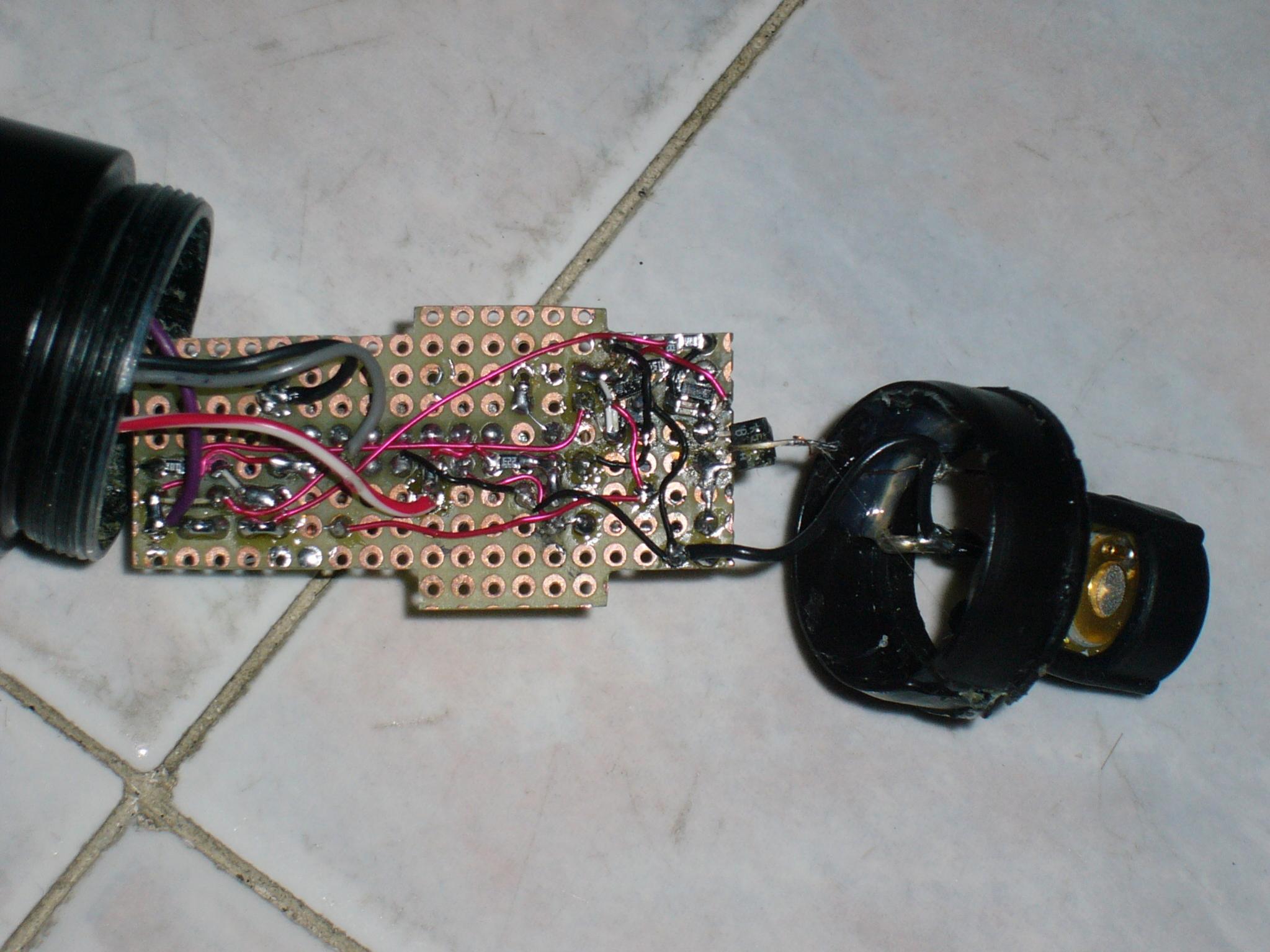

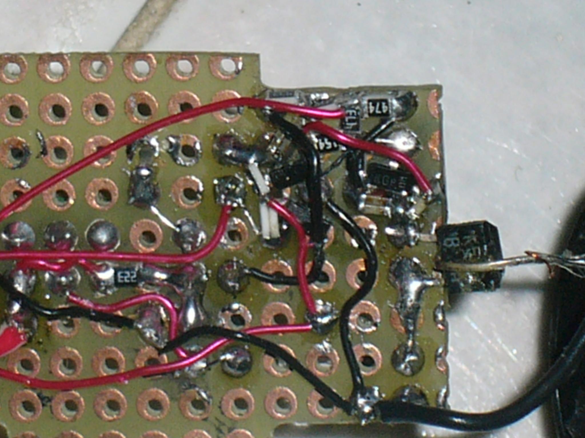

I am rebuilding an electret microphone in which many years ago I used a replacement capsule for Shure SM94. Now I have built a smd circuit on the solder side of a prototype board, but noise is very higher than in the old circuit. At that time I selected 2N5087 among other types a the best ones. Now I used BC860(smd). Do you think BC860(smd) could produce higher noise than 2N5087? BC560 have the same noise?

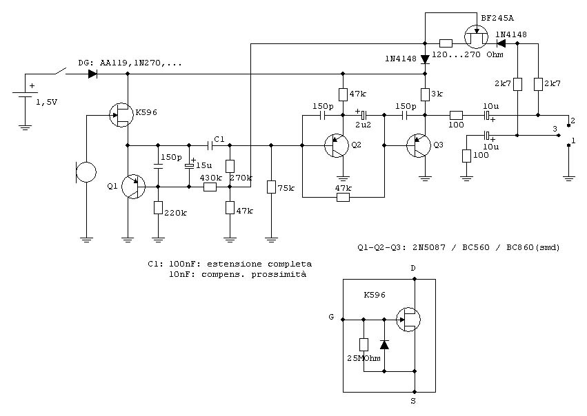

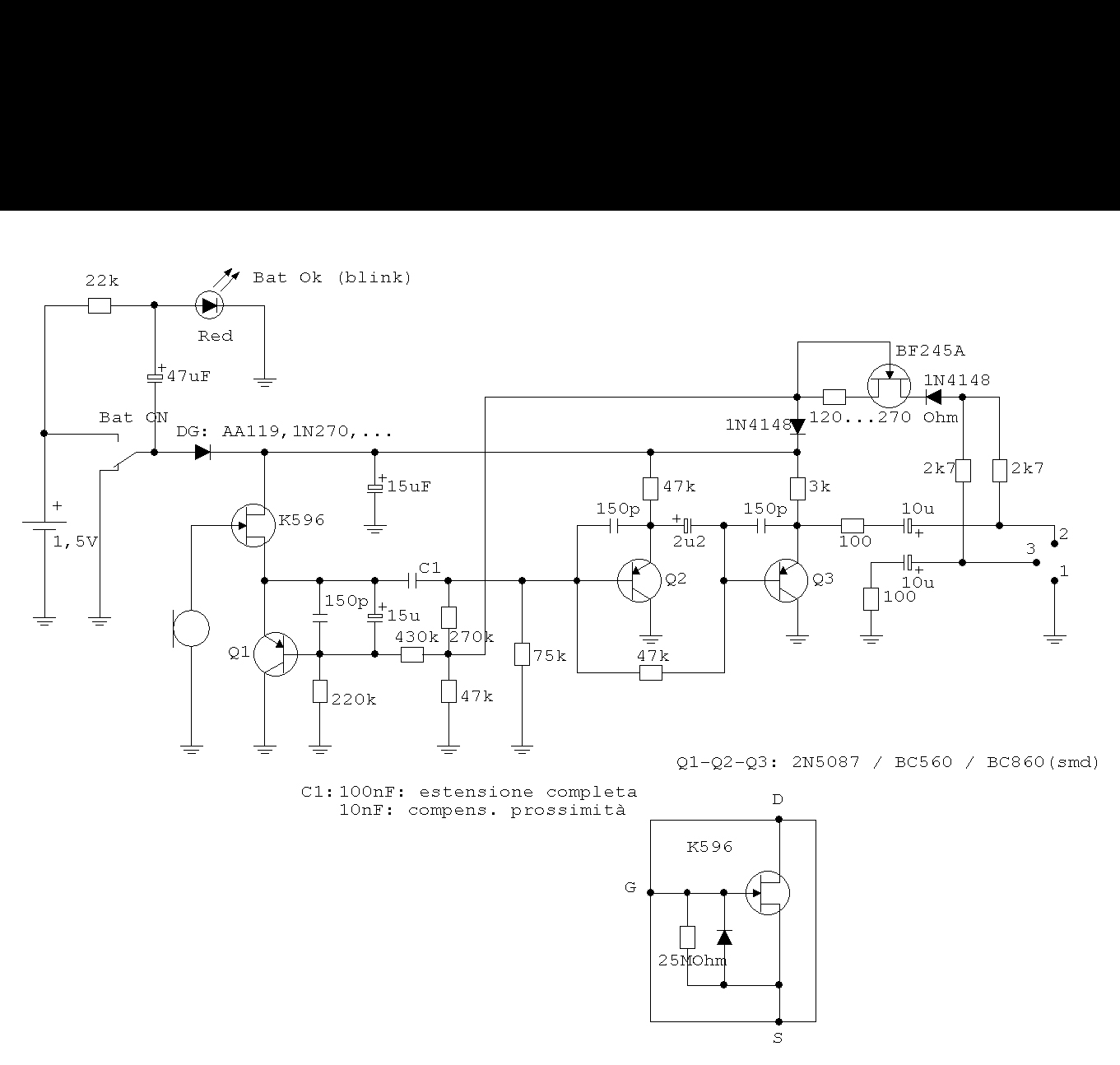

This is the schematic of my version:

Complete schematic, better quality (I can't edit first post anymore...):This is the schematic of my version:
The circuit just looks a little "odd" tbh. Have you tried to draw the circuit out from your old one.
Does it actually work OK apart from the noise ?
I have built the old one identical to the schematic I had drawn from the SM94. It had no more noise than SM94.The circuit just looks a little "odd" tbh. Have you tried to draw the circuit out from your old one. Does it actually work OK apart from the noise ?
Today I bought 3 2N5087. I'll replace the 3 BC860 smd and i'll let you know.
Datasheets say BC560 (they should be identical to the smd version BC860) have low noise for source resistance of about 2kOhm; 2N5087 for about 20kOhm... It's very hard to evaluate only on the sheets which one among two transistors will be quieter in a specific circuit...
LED is added by me; 47uF is a one-time voltage doubler making a flash at power on if battery is ok. No visible LEDs can be turned on directly from 1,5V and current drawn by a LED would be much higher than the current drawn by the amplifier.
Q1 is an active load for the FET. His Vce is regulated by supply voltage. Higher voltage gives more dynamic range. 15uF between b-e makes Q1 like a current generator for audio signal, because Vbe, then Ic, is independent from audio signal on the emitter. Q1 is a stable voltage source for polarization, but it has a high impedance for audio signal.
Q2 and Q3 are emitter followers to lower the signal impedance. They are in series for audio, but they have the same polarization (depending on supply voltage).
The BF245A (a current regulator field effect "diode" 1N5304 in the original circuit) with the 270 Ohm resistor is a current regulator set to 1.8mA. Note that required resistor value is different from a single FET to another, first of all because Idss can be very different from one to each other.
Thanks for the explanation... obviously try the other transistors and see.
I'll tell you what puzzled me... and I'm not really familiar with powering mics via a phantom supply but anyway.
Q2 and Q3, it seems really odd to bias both from the same point, Q3 and the 47k tie the base to the same audio input that Q2 is receiving. That's odd 🙂
That was one thing, the other is the 1.5v battery. The fact that it's there I guess means the circuit is intended to run off just that if needed, the Ge diode giving low forward voltage drop. So with no phantom supply the bias for Q1, Q2 and Q3 and their operating point is very transistor dependant as the bias is provided by just a simple "resistor to ground" and not a network setting a defined bias point.
- Q2 and Q3 are AC-coupled, then they can be biased at the same point. Audio from Q2 via capacitor has low impedance, then it is stronger than the signal via 47k.
- Drop is 240mVThat was one thing, the other is the 1.5v battery. The fact that it's there I guess means the circuit is intended to run off just that if needed, the Ge diode giving low forward voltage drop.
- It works... 🙂So with no phantom supply the bias for Q1, Q2 and Q3 and their operating point is very transistor dependant as the bias is provided by just a simple "resistor to ground" and not a network setting a defined bias point.
Anyway, there we go 🙂
a little odd is that pin 3 is not driven??
I'm thinking the 1.5 battery is the on/off switch... not sure how that works though.

In the original there is a transformer, without the two 2k7 resistors. In my version output is only "impedance balanced", driving only the "+" output (2). "-" output (3) has the same impedance, but there is no signal.a little odd is that pin 3 is not driven??
The two 100 Ohm resistors will be differene, because on the driven side there is also about 40 Ohms output impedance.

The best way to know about different transistors and their noise is by looking at their data sheets. The 2N5087 is an old device, more than 40 years, and was pretty good for its time, but I doubt that an even quieter device would make much difference in noise, as it is probably set with the capsule and input fet.
EUREKA!
It works...
Now, with 3x 2N5087, noise is the same of the original SM94.
A 2-position jumper switches 3 values for C1:
11nF ("Cut", no jumper), 250Hz
61nF ("Mid", pos.1) [11+(100series100)], 50Hz
111nF (Full", pos.2) [11+100], 25Hz

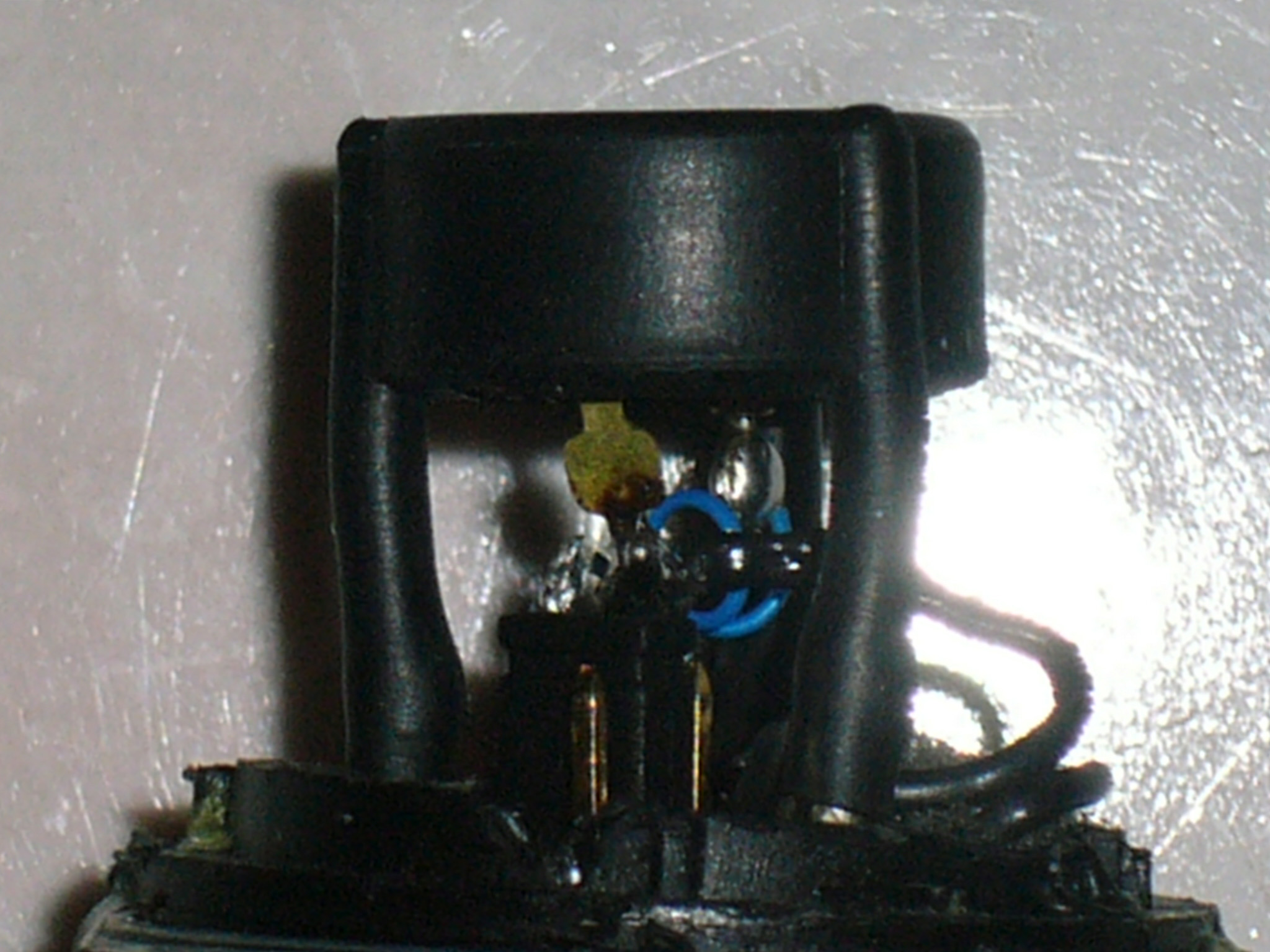

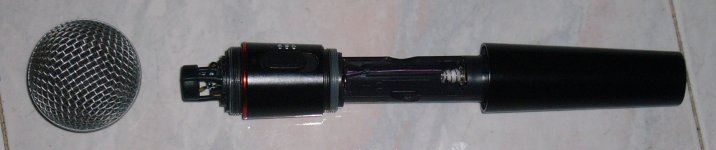

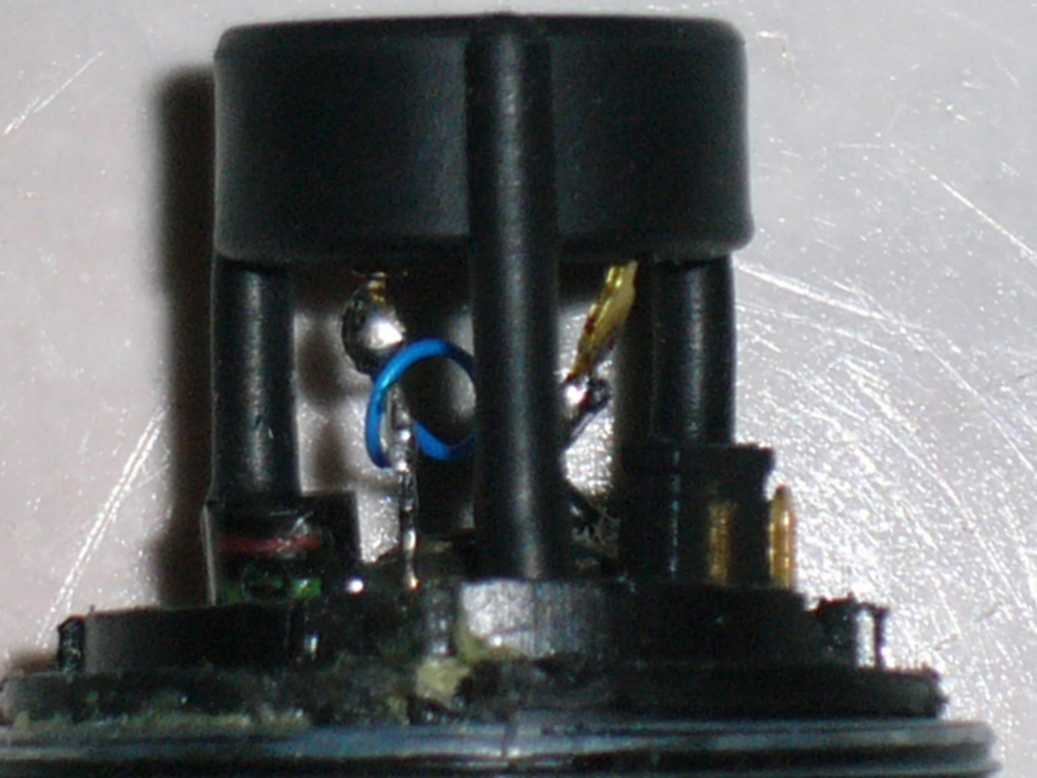

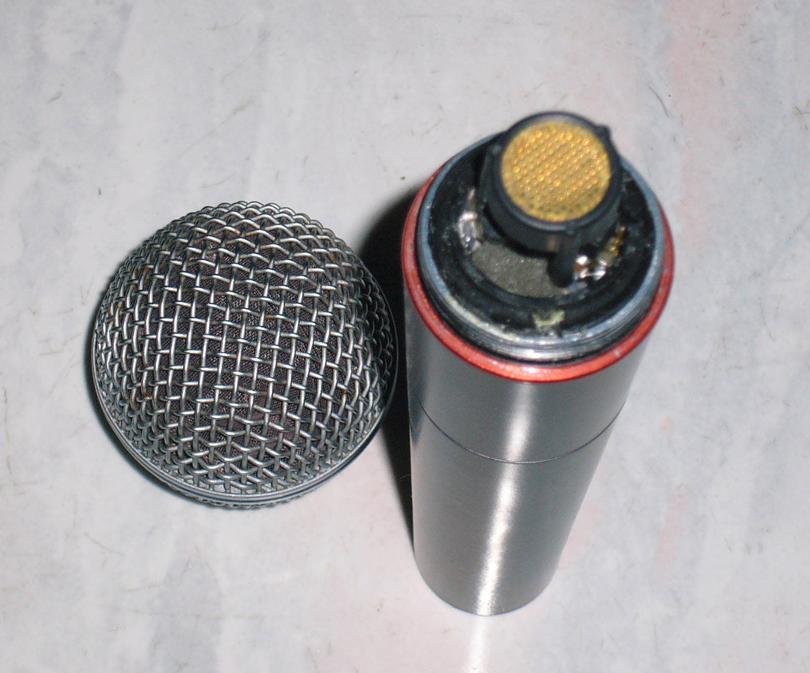

In the first two photos you can see the board with the three BC860 smd, before replacing with 2N5087's.

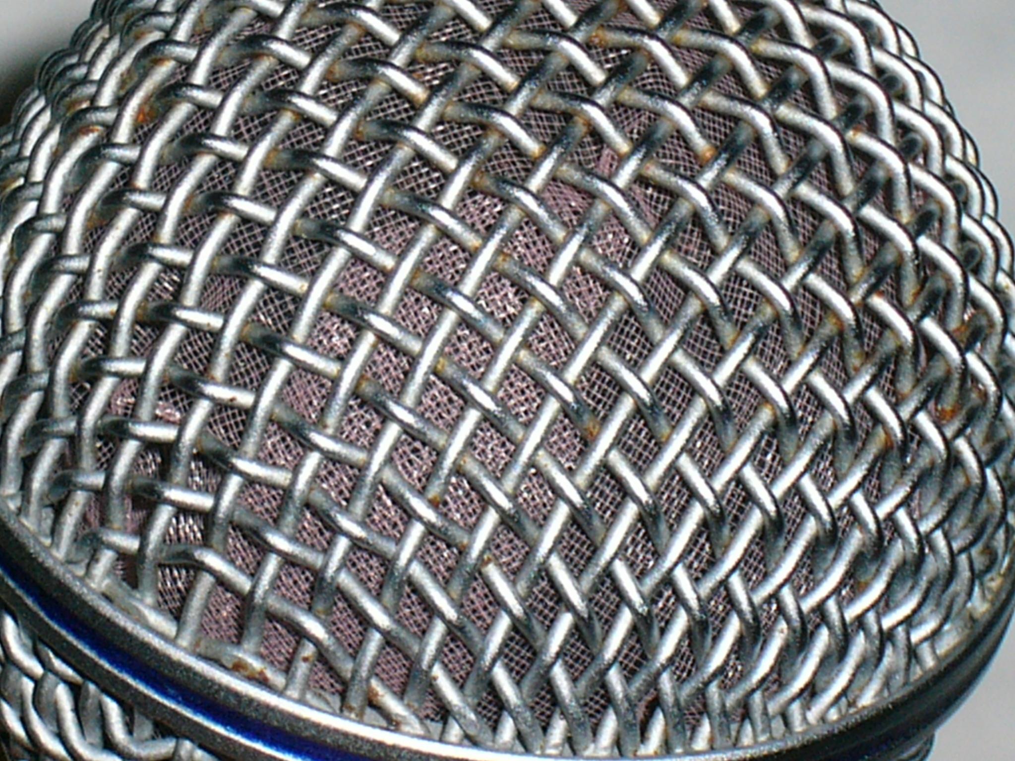

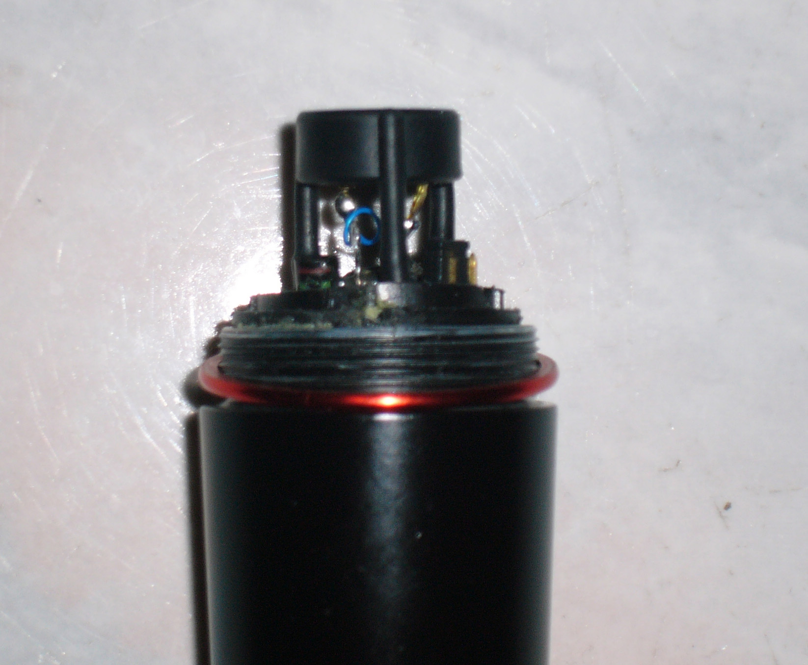

As you can see in the last photo I have added some tulle inside the grill (it's a Shure SM58 grill) to try a better anti-pop. It's hard to put properly the tulle. I have cut it like a Malta cross, but I'm not so satisfied... The best would be a metallic tissue like the one in Sennheiser mics (MD431, MD21, MD421, ...).

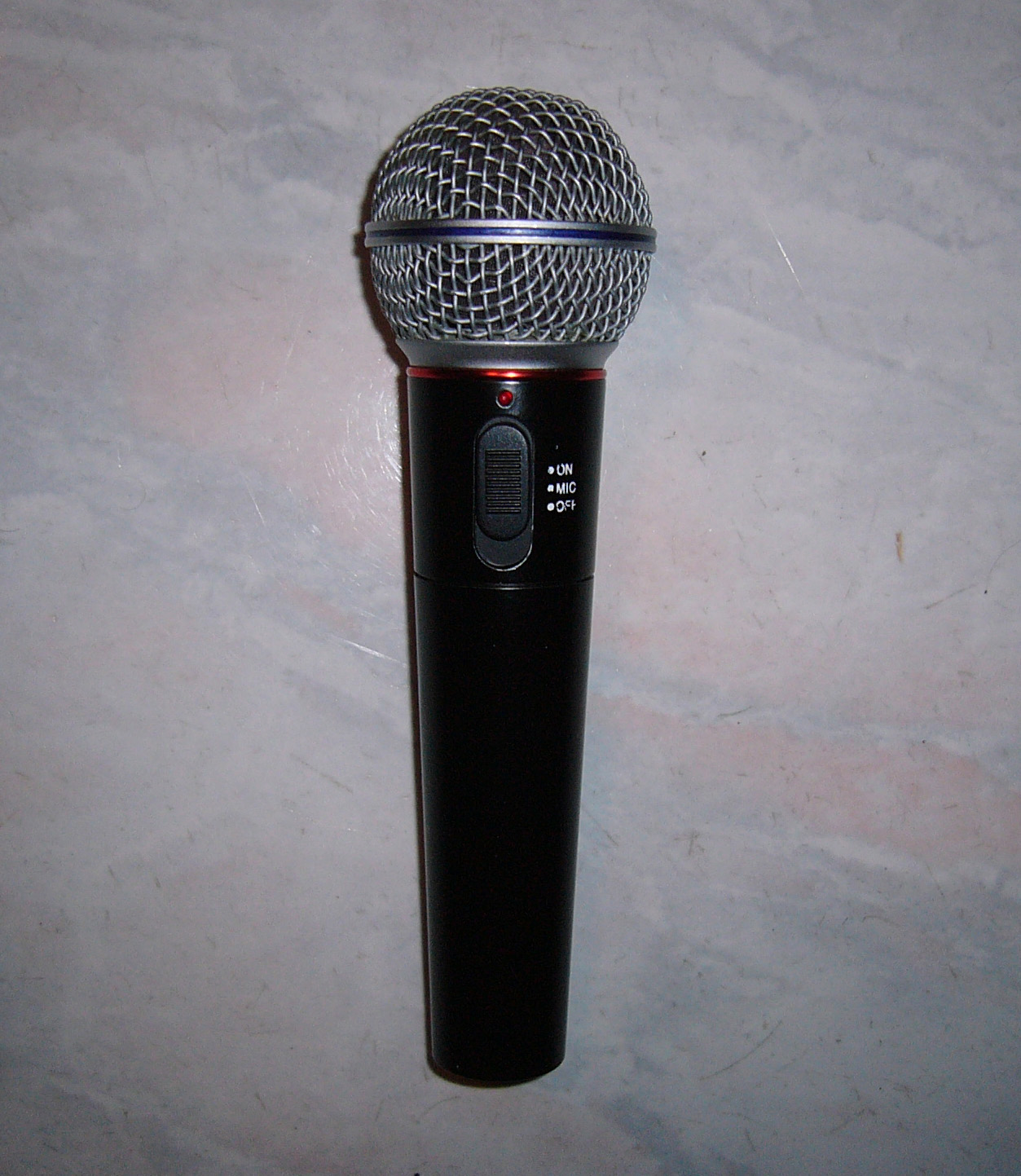

Oh... Before you ask: 🙂
Cotton in the "-" battery spring is to dampen resonances if microphone body is hit or "tap"-ed without a battery in the compartment.
