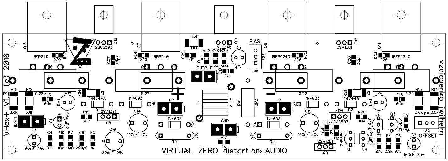

Hi Marcelooms,
I recommend a rather simple cool amp - VHex+, excellent at low volumes.
You can find a number of very good reviews here on the forum.
More info >here[/U]<.
Available as PCBs, kits, tested modules or fully built amplifiers - depending on the desired level of involvement 😉
