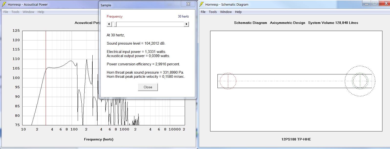

With a B&C 12PS100 in a simple tapped pipe with a small coupling front chamber you get a solid 30 Hz response with a quite decent efficiency.
You don´t need more then a few watts to rattle your bus.
This kind of non-expanding tapped pipe does have a nice physical and tactile character for home theater and EDM usage.

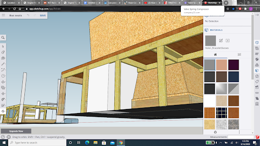

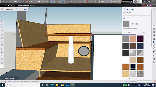

As for the last, I'm still determining that. It's quite likely I could build it into the angled (16.9 degrees downward facing) toe kick/base area of our raised U-shaped bench in the rear. The space behind is ~2.6sqft in area and I might be able to go 18 inches of depth before my girlfriend kills me for taking up too much storage space, that's 3.9cu ft/110L - woofer displacement but already built like a sub enclosure and would only require internal bracing and maybe a double baffle, the bench is already going to be 3/4 birch ply. That is my ideal space for it, though it will require some convincing. Otherwise I have two promising locations of around 3.1cu ft/~87L, although this one could only be maybe 6-7in in height and a flat, rectangular shape, and 3.3 cu ft/~94L in a single seat bench base, each not accounting for material and woofer displacement that could each fit a 12in woofer.
This is the space I'm considering. It's roughly 14 x 14 x 22 (inches), with the front triangular area measuring 16H x 4B x ~17 hypotenuse and the same 14in depth. That's roughly 75L/2.65cu ft, I can probably go a bit deeper for a larger enclosure.
