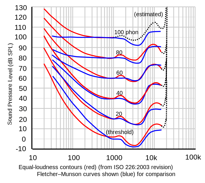

I'm unclear on subwoofer design with regard to our perception of low range frequencies. Our lowest audible frequency is around 20hz. The lowest musical note, an A0 note, is 27.5hz. Most of us lose the ability to locate a frequency source around 80hz. By definition, sub-bass frequencies are 20hz to 60hz.
In addition, our hearing is more sensitive to lower frequencies than higher frequencies, especially at listening levels that don't cause hearing damage. Fletcher Munson Curves - Teach Me Audio
Apparently, we both hear and feel bass as frequency decreases. At some frequency range feeling will become more important than hearing. I haven't seen a graph that describes this transition yet.
How would you design a subwoofer frequency response in this context? Is there a point where you'd cut off low frequency reproduction from the speakers and cross them over to bass shakers?
For example, should you design a subwoofer to reach an A0 note at 27.5hz and then let a bass shaker take over from there because it's no longer a musical frequency from that point. And should you design the frequency at 27.5hz to be flat with higher frequencies at typical listening levels?

You can load audio into Audacity (free software), and calculate the frequency content spectrum. You'll likely find for most of the music you listen to, there is little below 35 or 40Hz. Maybe others listen to cooler music than I do, but that's what I concluded. HT may be different.
Starting to look to me like it's a good idea to tune a musical sub at or above an A0 note and then cross to bass shakers below that for home theater.
For typical listeners, it looks like you can easily get away with a musical sub well above 27hz.
