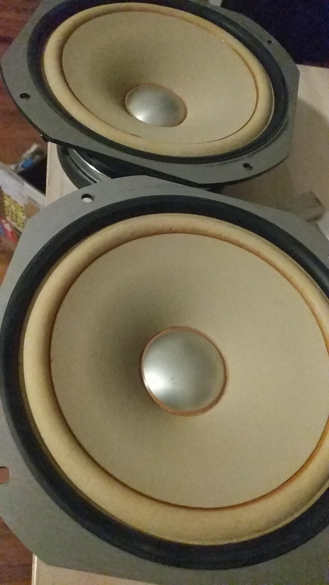

I got a pair of vintage full range speakers. I haven't tested them sonic-wise as I want to build cabinets first to have a thorough evaluation of the sound.
The units are visually in good conditions, but the Ohm meter reads 5.2÷5.3, while they are rated for 8 Ohm.
Shall I expect any quality degradation from this lower impedance?
Thanks,
gm

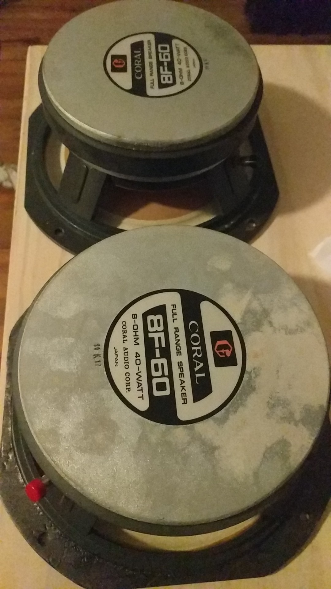

They are a pair of Coral 8F-60, which I had been hunting down for quite some time. As you can see, the back of one of the magnets has some stains and I thought that they may have been stored in a humid environment, and that the voice coil may be affected, hence the lower resistance. But if that's fine as you say, the speakers look in great condition otherwise. I just don't have a pair of the same model to do a comparison.

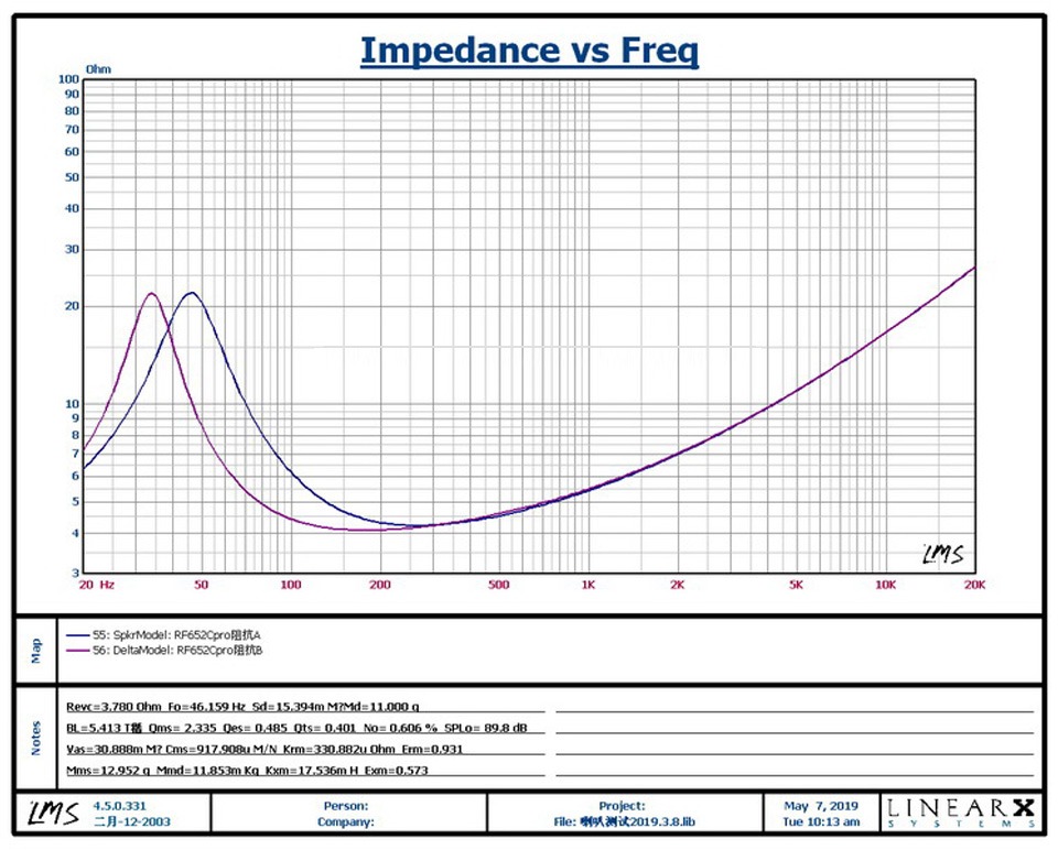

As a rule of thumb, if you measure the DC resistance of a voice coil then add on one third of the reading, you will have a good estimate of the nominal impedance of the loudspeaker.
Suppose a DC reading of 6 ohm as an example. Add on 6/3 = 2 ohm and you arrive at a nominal impedance of 8 ohm.
However, remember that the impedance of the speaker varies with the frequency of the AC signal, as the attached graph illustrates (the DC resistance being around 4 ohm for each of the two loudspeakers shown superimposed on the graph).
The mild steel forming the back plate of the magnet assembly is vulnerable to corrosion, so may be protected by a a surface treatment, e.g., a coating of zinc.
Such a coating is intended to gradually corrode, providing what is known as "sacrificial" corrosion protection of the mild steel.
It may be evidence of this protection in action that you see on one of your magnet assemblies, but it is light enough not to cause concern in regard to the operation of the loudspeaker.
